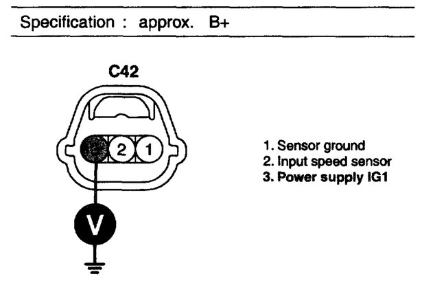

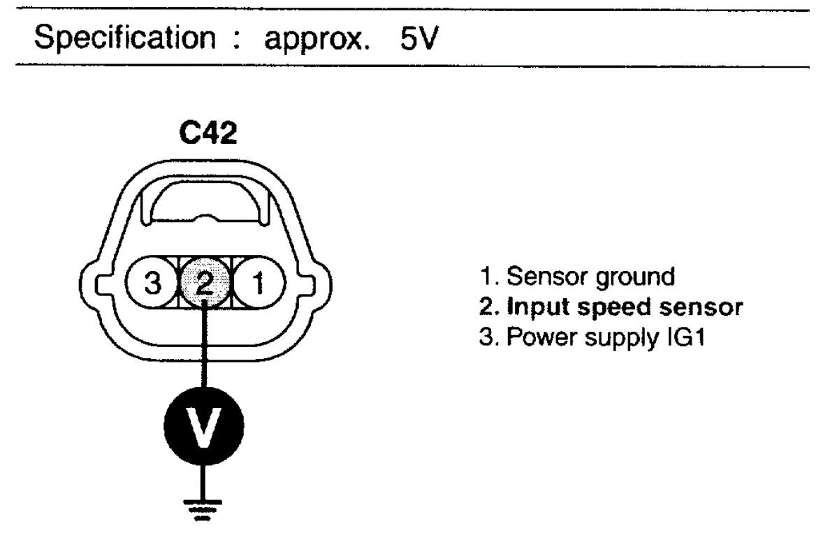

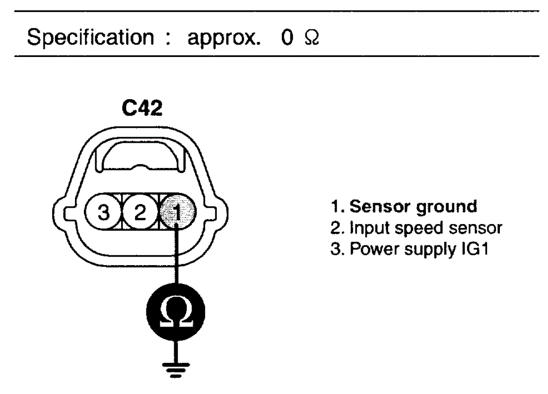

You have a lot going on here. Let's focus on the input speed sensor first. As far as the pins in the connector, they are as follow:
Pin 1 - Ground
Pin 2 - 5v reference
pin 3 - battery voltage
Are these the signals you are getting at the sensor?

Hi, first of all thanks for the fast response. I rechecked the terminals and i found no ground on pin 1 of the input sensor. Then i checked the output sensor ground and is present but weak.
Now it's clear to me, i have a ground problem and i want to check first the ground connection with chassis for this specific circuit before teardown the harness.

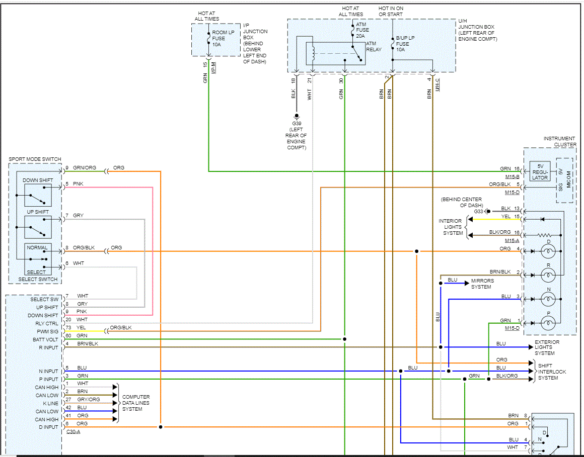

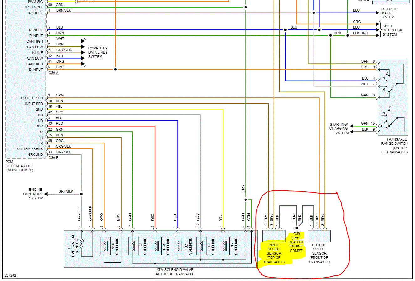

Yes, it is on the left rear of the engine (driver's side). I attached the schematic for the transmission below. I had to cut it in half to make it readable. I did overlap them so you can follow from one to the next.
In pic 2, I highlighted and circled the components and ground.
I hope this helps. Also, I have to keep these threads specific to one topic. Copy and paste some of your other questions to a new thread and that way we can get started on them at the same time.
