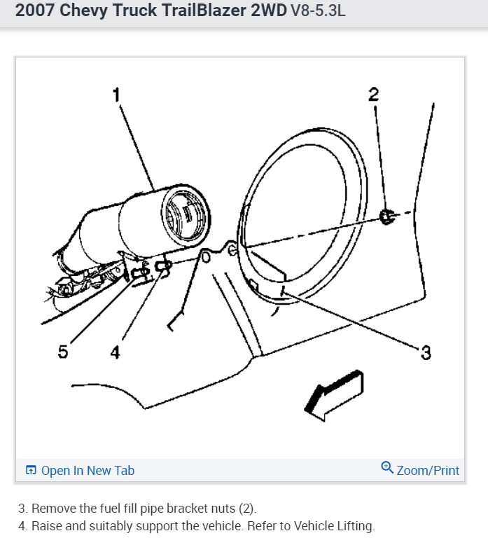

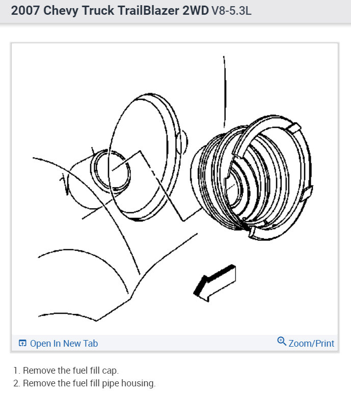

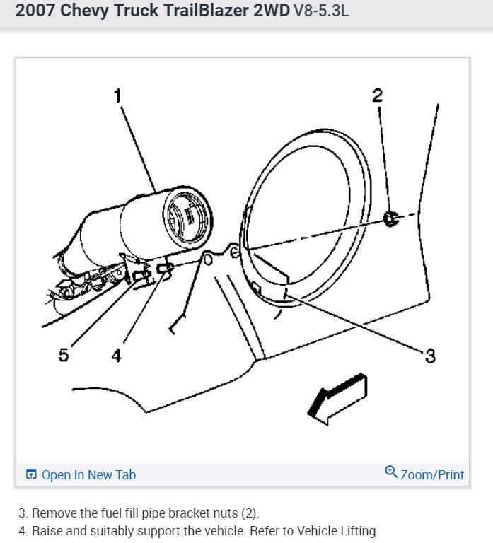

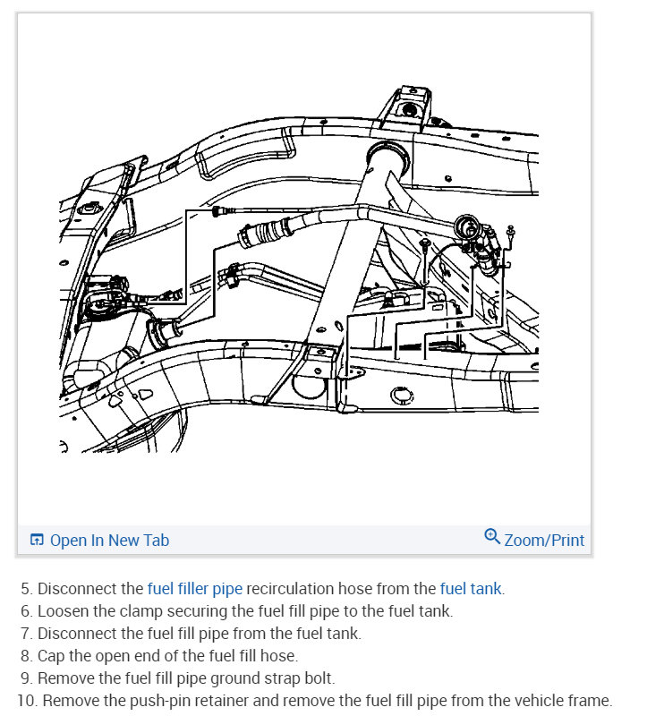

The only item that stops the fuel from entering the gas tank is the filler neck with its external vent. Can you tell me how you know the filler neck is okay? Here are diagrams to help us see what we are talking about. When the neck of off check to see if there is a roll over ball stuck in the fill of the tank. I would remove the filler neck to inspect.
Check out the diagrams (below). Please let us know what you find.
