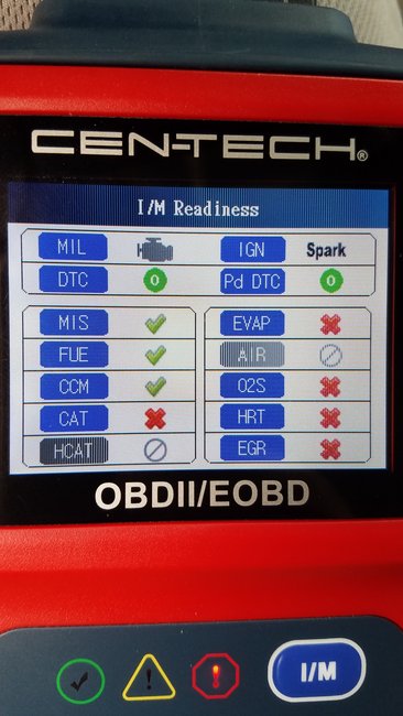

Ran codes nothing came up. This is the ready test results.

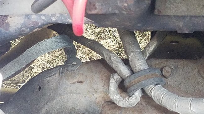

Also noticed these two ground cables hanging loose.
Jul 18, 2018 at 9:33 AM
  • 55,746 POSTS
Those ground wires can be causing all of your electrical problems they need to be connected. Where is the other side of the cable? Clean the cable connections before installing them. Clear the codes and try again.

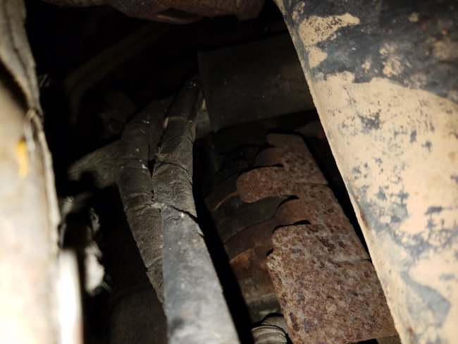

The one goes to the frame the other one goes to the engine. It looks like and they perfectly reach each other should I connect them together?
Jul 19, 2018 at 9:47 AM
  • 55,746 POSTS
The large one goes to the engine and the small one goes to the frame/body. Can you take pictures of the other end so I can see to be sure?

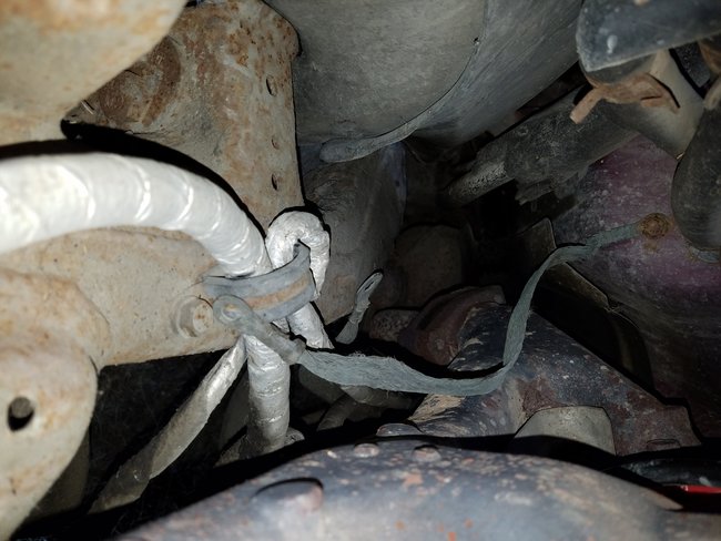

That is where the small one goes.

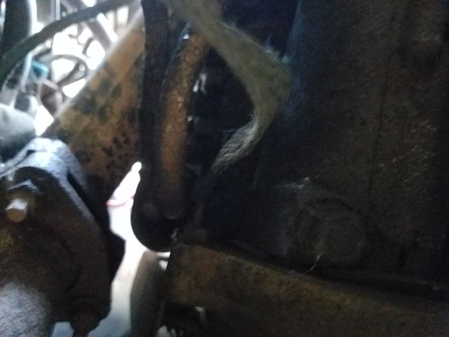

The large one goes into that tube towards the engine.

Also the large one.

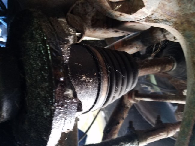

Also noticed this was wet with oily liquid.

Those are both grounds. One should go from the frame to the engine, the other goes from the engine to the body. In this case you have the middle point where both of those attach to the frame. Does not really matter where you attach them as long as it is a clean connection with no paint or rust and they can flex as the engine and body move around. Does not matter if the braid is oily, as long as the rings are clean where they meet the other parts.
With them loose as they are you will get many strange electrical issues as well as possible parts failures in what seem to be unrelated parts. This is due to the currant from the battery seeking to find a path to complete the circuit back to the battery or from the alternator though its circuit paths.
From the first picture they were either both bolted under the cable clamp or in the hole to the left. Either will work as long as you clean the rings on the braids and the spot on the frame.
