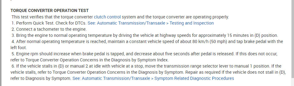

Hey, my vehicle starts in P or N just fine but when I put it in any other gear it shuts off . What would cause this ? Motor has about 264,000 miles on it but the transmission has over 500,000 and has never had anything done to it .
Jul 22, 2021 at 1:05 AM

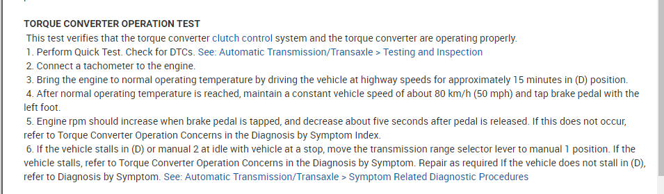

More than likely this is a torque converter issue. This is pretty common on these units but we need to test this just to confirm it.

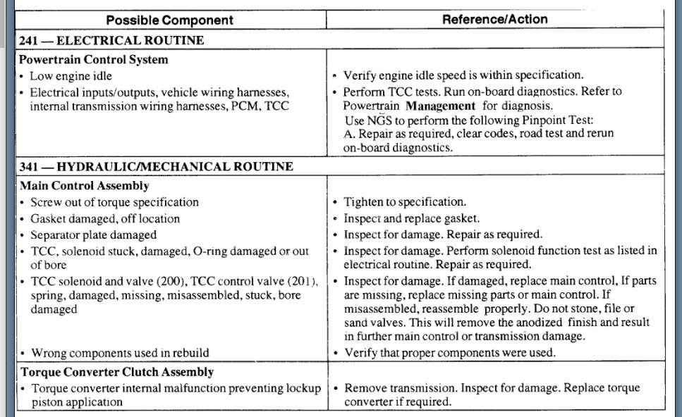

Just in case this does not prove out, here is a guide that will help with stalling at idle. Not all of these will apply but we need to run through them just to be sure.
However, please see the info below and let us know what you find. Specifically look at number 6 on this testing.
Jul 22, 2021 at 11:46 AM
