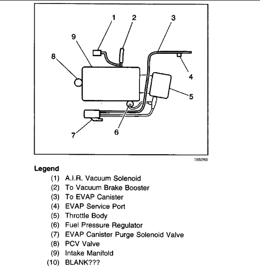

Car is misfiring after replacing spark plugs, spark plug wires, coil packs and base plate for coil packs.
Aug 21, 2023 at 2:24 PM
  • 110,244 POSTS

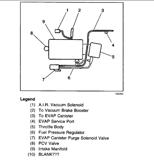

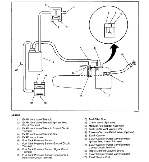

If you look at pics 1 and 2 below, they provide the vacuum information. However, I have a question. If the misfire started after the work, are you sure one of the new spark plug wires wasn't mixed up or damaged?

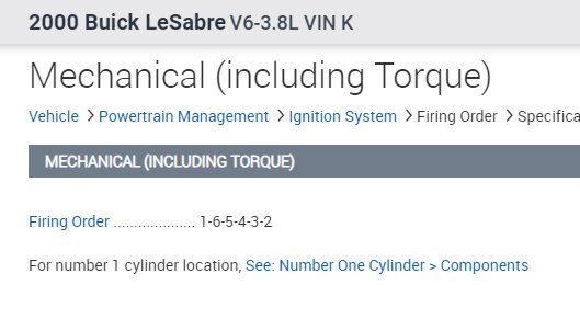

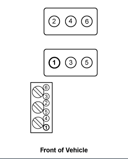

If you look at pics 3 and 4, they provide the firing order and spark plug wiring. Check to make sure they are in the correct order.
