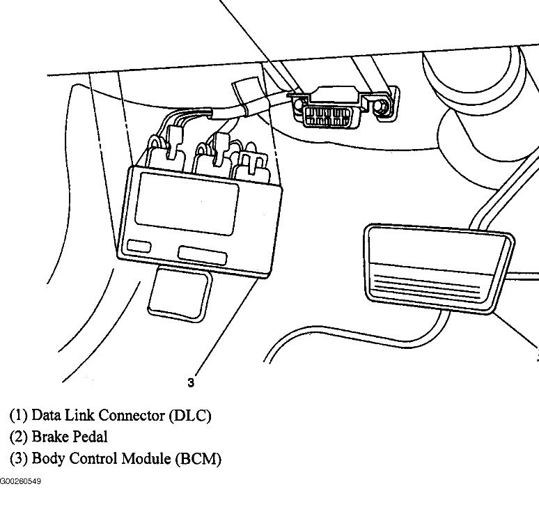

where is the computer diagnostic port in my listed above? It is the coupe model.
Jul 25, 2017 at 7:10 AM
HMAC300
  • 48,601 POSTS
lower left of dash near brake pedal. See picture. Check out the diagrams (Below). Please let us know if you need anything else to get the problem fixed.

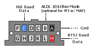

SHAGGY274
  • 7 POSTS
Car has Brand NEW Battery it will run, you can drive it, all the electrical componets work far as I can tell had the CHECK GAUGES and ABS warning light come on and it went off byitself I pluged my code scanner in to find out why and it said "(no power from vehicle)" checked fuses all fuses in fuse box under dash or good unpluged and plug back in the BCM and also unhooked both negative and positive battery cables and let sit for a lil bit then hooked them back up and got same message on code scanner.
Sep 10, 2020 at 11:18 AM (Merged)
DAN_K
  • 213 POSTS
A General Motors OBD-1 assembly line data link (ALDL) connector is not a powered connector like an OBD-2 connector.
(see picture below)
