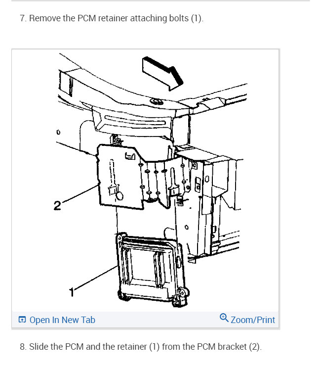

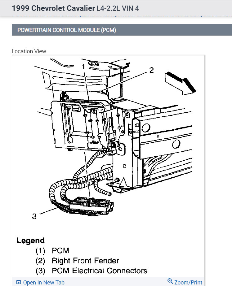

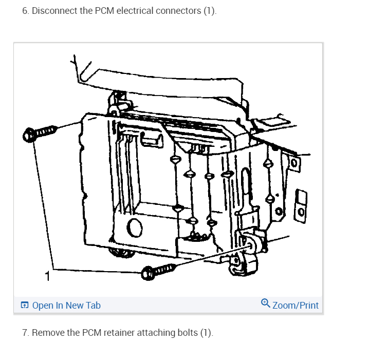

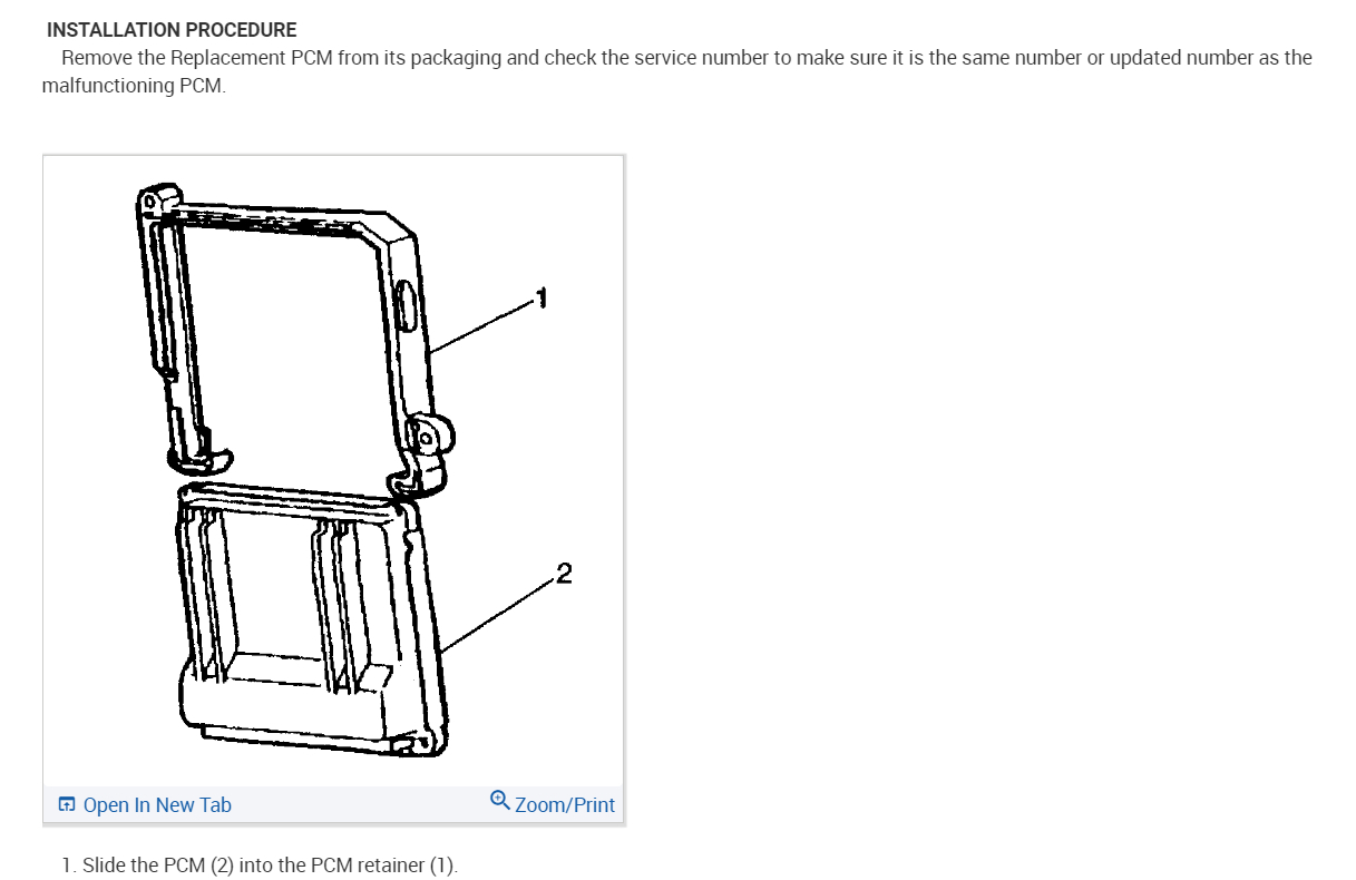

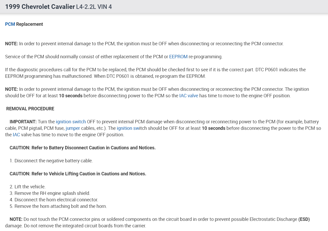

I just bought a new 'used' ecm computer for my car, do you know where this computer is located on my car? Thanks!
Mar 23, 2009 at 10:00 AM
BLUELIGHTNIN6
  • 16,542 POSTS

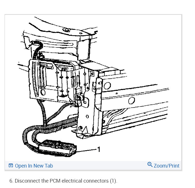

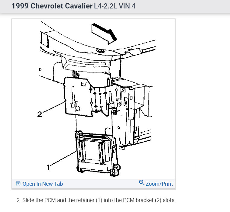

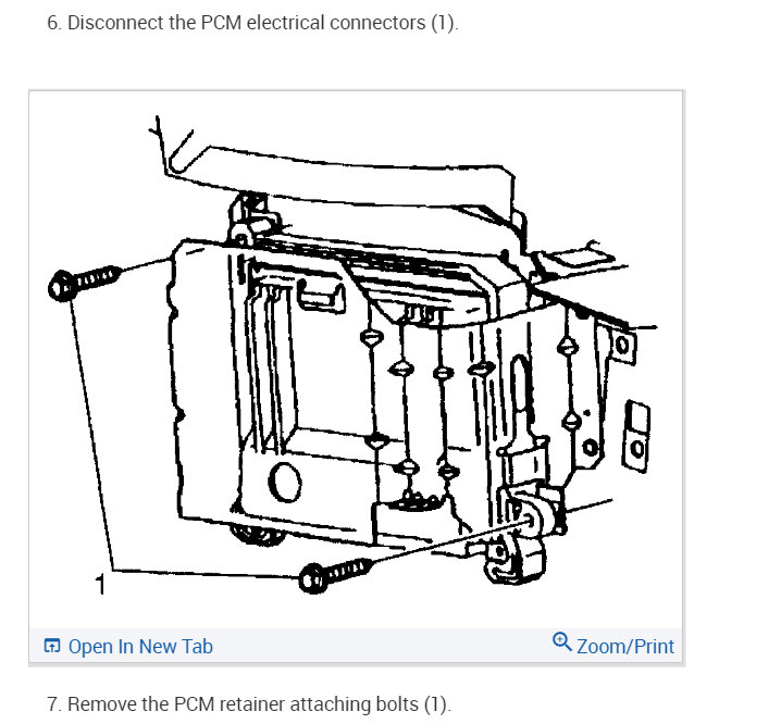

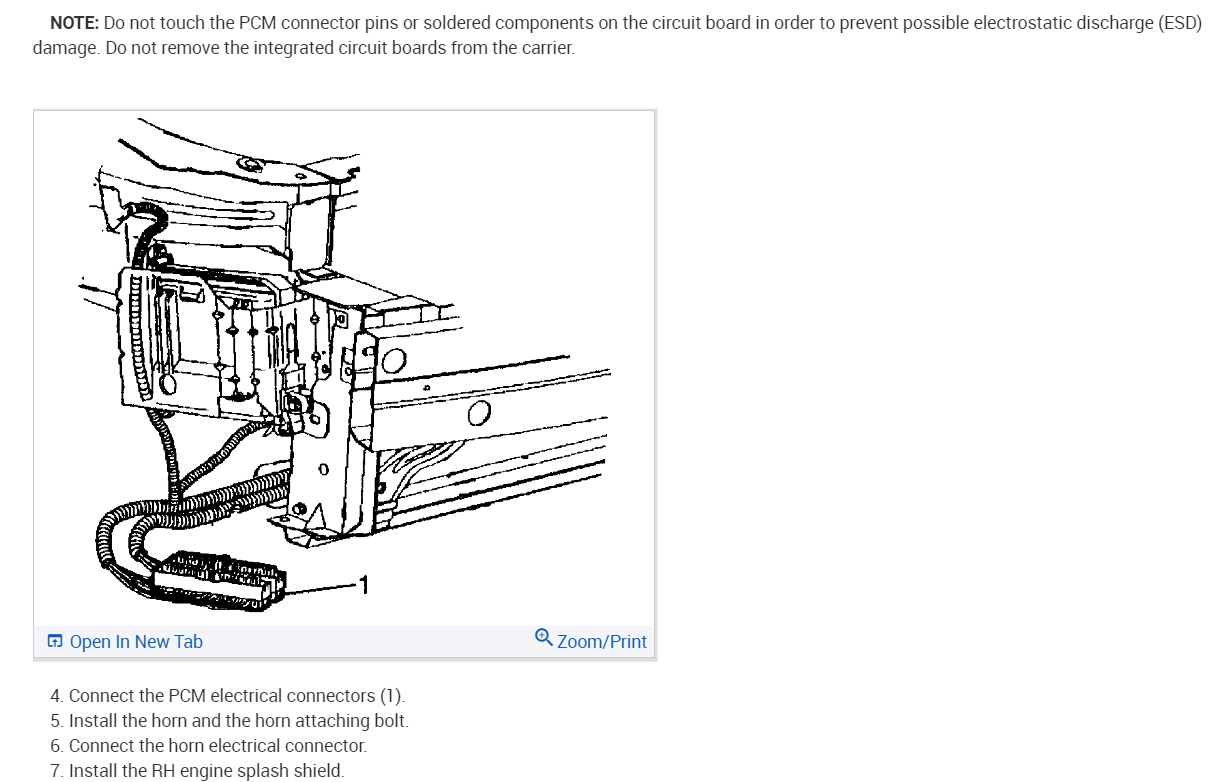

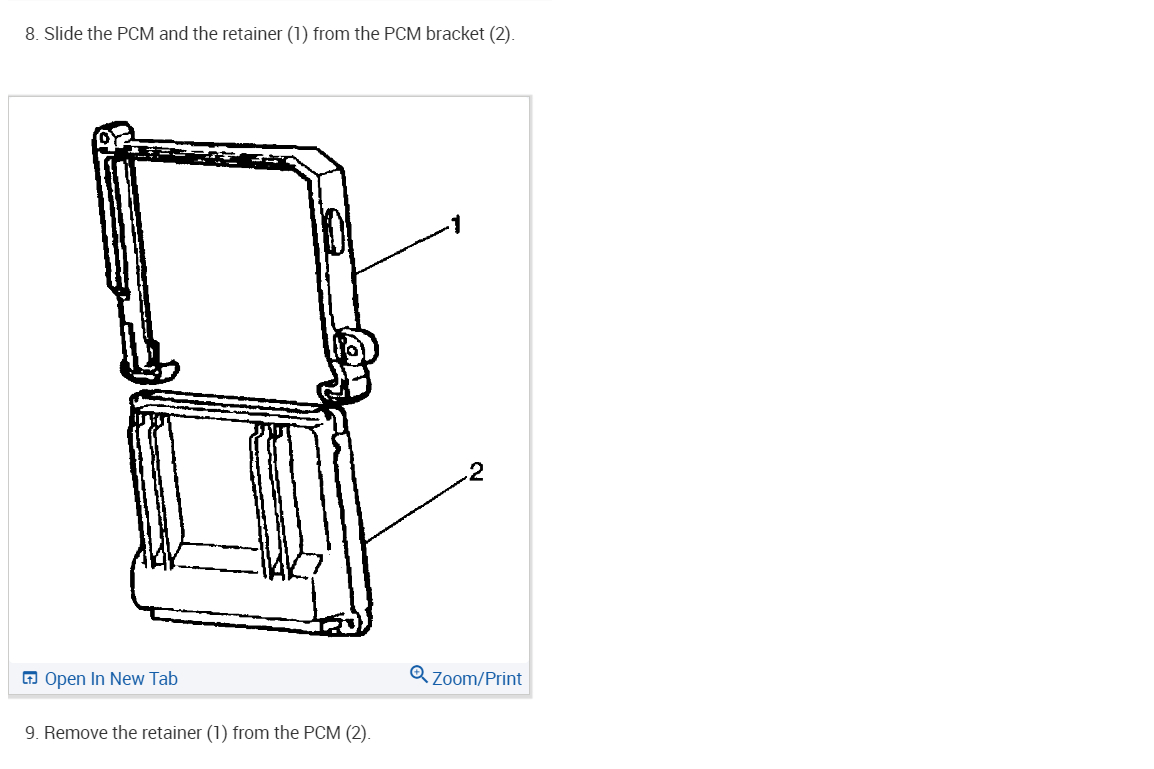

Your vehicle's powertrain control module ( AKA electronic control module) is located on the right front of the engine compartment. Underhood near RF fender, here are the instructions on how to change it out and it shows the location in the images below.

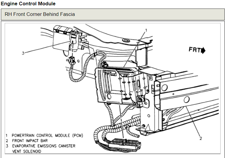

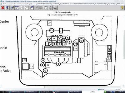

Behind the right front headlight, at C1.
https://images.2carpros.com/forum/automotive_pictures/62217_PCMa_1.jpg

where is the PCM ie. ECU located on this car?
Jan 13, 2020 at 12:45 PM (Merged)
CAR-MAN145
  • 321 POSTS
In the right front of the engine compartment on the frame rail.

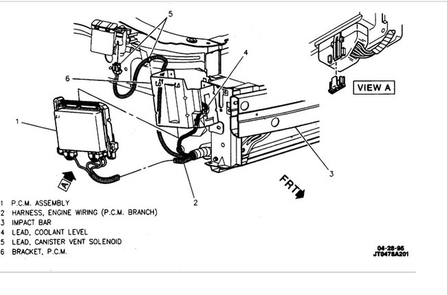

ALAN BIRDSONG
i was told i need anew computer my q is where it is located. i was told its behind the fender adjacent to evap canister. Is this right i cant see it and do i have to take the fender off? please help
  • 55,649 POSTS
It looks like it is down low in the front of the car, you might need to jack the car up before doing the
removal.
Here is a diagram on its location (below)
