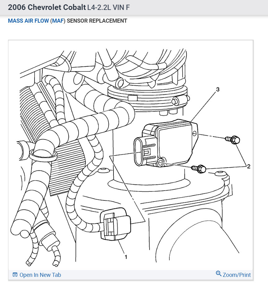

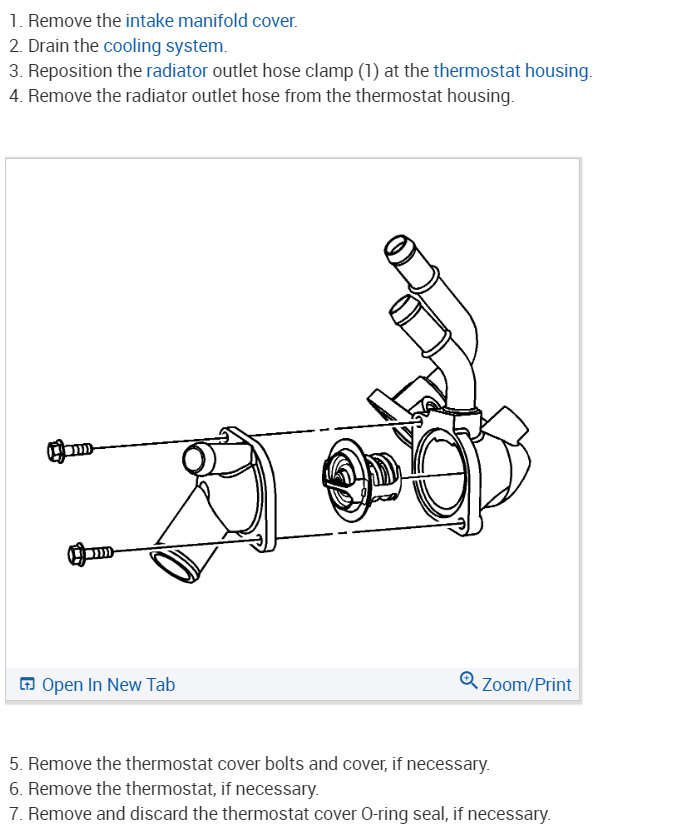

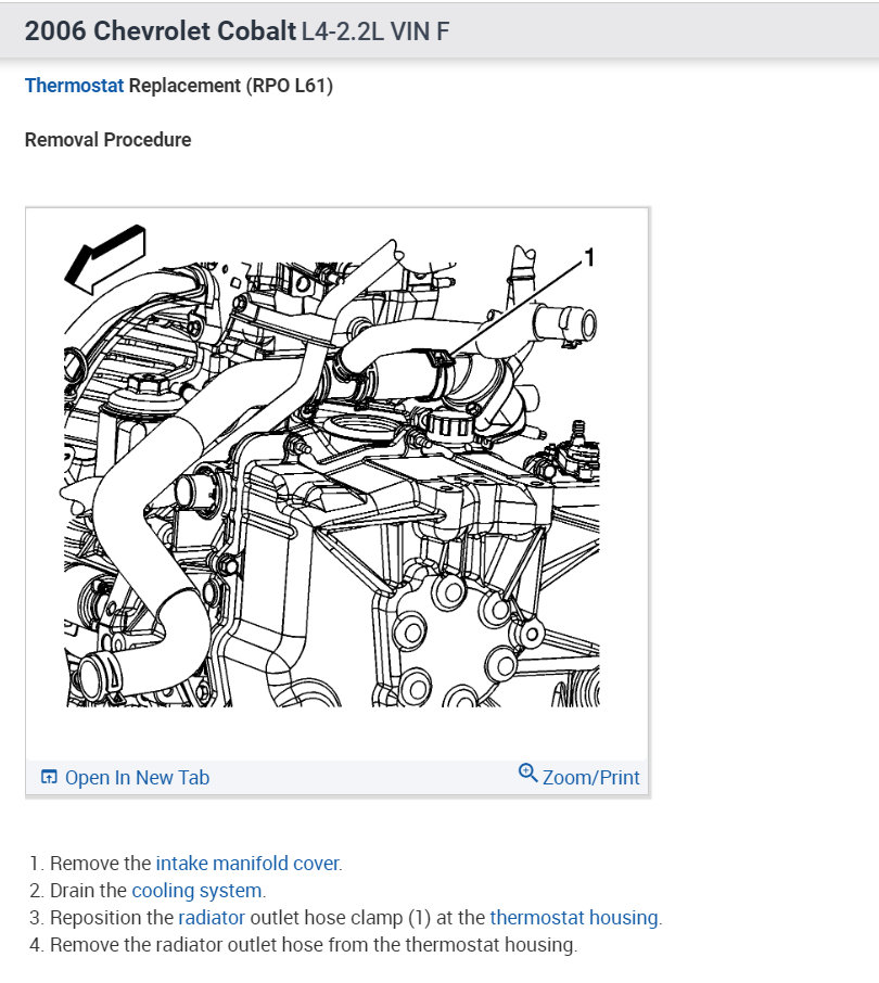

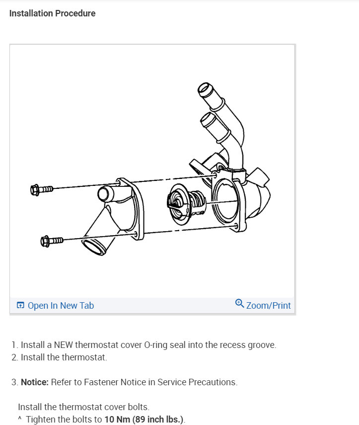

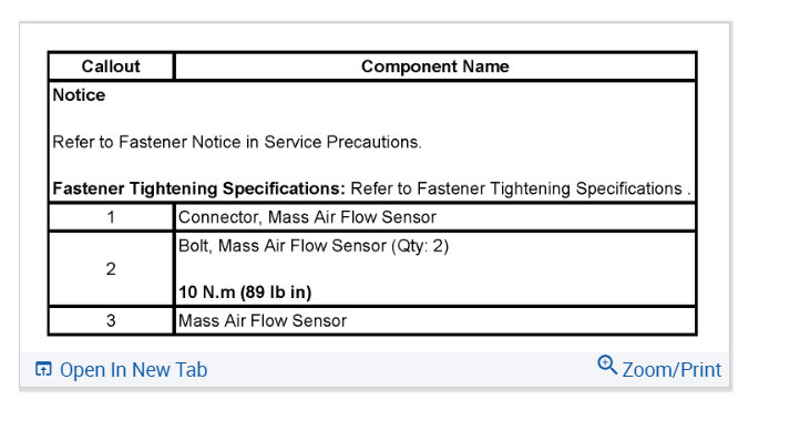

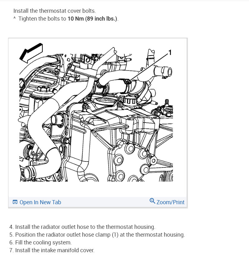

So, the p0128 code is the clue, the engine is not getting up to temperature so the computer does not know what to do, this is the first thing I would fix. Next, I would replace the MAF sensor because cleaning them doesn't work most of the time. Does the engine seem to have good power? Then I would not worry about the fuel pressure. Here is how you can change the thermostat out and the MAF sensor in the images below so you can fix the problem. Check out the images (below). Let us know what happens and please upload pictures or videos of the problem.

Okay, thanks for that. It is strange the p0128 comes and goes but obviously p0300 is constant. I also got to thinking. I have never had to put coolant in the reservoir since I been driving if. It is my girlfriend's vehicle, so I asked her if she or maybe her father had ever put any in and no, not a drop. So, I took the reservoir out and cleaned it. It was disgusting. Like the same nasty antifreeze has been sitting in there for God knows how lone. I made sure none of the lines were clogged or anything like that so yea, definitely must be that the thermostat is stuck closed I'm guessing. I've changed a MAF sensor and thermostat before on different vehicles so that shouldn't be a problem. Does the engine have good power? well, yes and no. The thing is this misfire comes and goes. I can tell just by the way the engine sounds and obviously performance gets extremely better for a while. Usually in the morning. I drive it to work which is only 5 minutes away from my home and sometimes it will just run perfectly. Check engine goes away. Great power. Everything is fine. Then suddenly you can hear and feel it bog down..lose power..takes longer to shift. Even the gas pedal feels different whenever it does this. Sometimes it'll go back and forth like it's trying but something is holding it back is the best way I can describe it. But more often than not especially lately the check engine light stays lit and like I said it's like it's being held back..like it's only running on 2 cylinders or something. Also it is using twice as much gas than it should be. I know it's probably not the best idea to be driving it and we do try to limit it but it is our only vehicle currently. Anyhow thank you for the feedback and as soon as I can afford it I'm going to get that new tstat and take your advice and get a new MAF sensor. I have an older model f150 and it is notorious for the maf to go out..and I guess the symptoms i had with that are pretty similar to what I'm dealing with now. I just didn't want to guess and throw money at it and be wrong so I thought I'd clean it and even tried testing it with a multimeter. Plus different opinions have me wondering which way to go so thanks again I will report back with progress.

Finally, was able to get a thermostat and MAF sensor. I checked my old thermostat by putting it in boiling water. It is working just fine. So, I put it back on. Put the new MAF sensor on and no change. I even made sure to clear the codes before I put it in. I'm still getting the same bad performance. Same code (p0300 is the code that is constant every time I run the diagnostic. Sometimes when I do it, I will get the p0128 and a couple of others. But like right now for instance it's only showing the random misfire). So, I don't know man I'm at a loss. I'm hoping I'm just missing something simple. Any ideas?

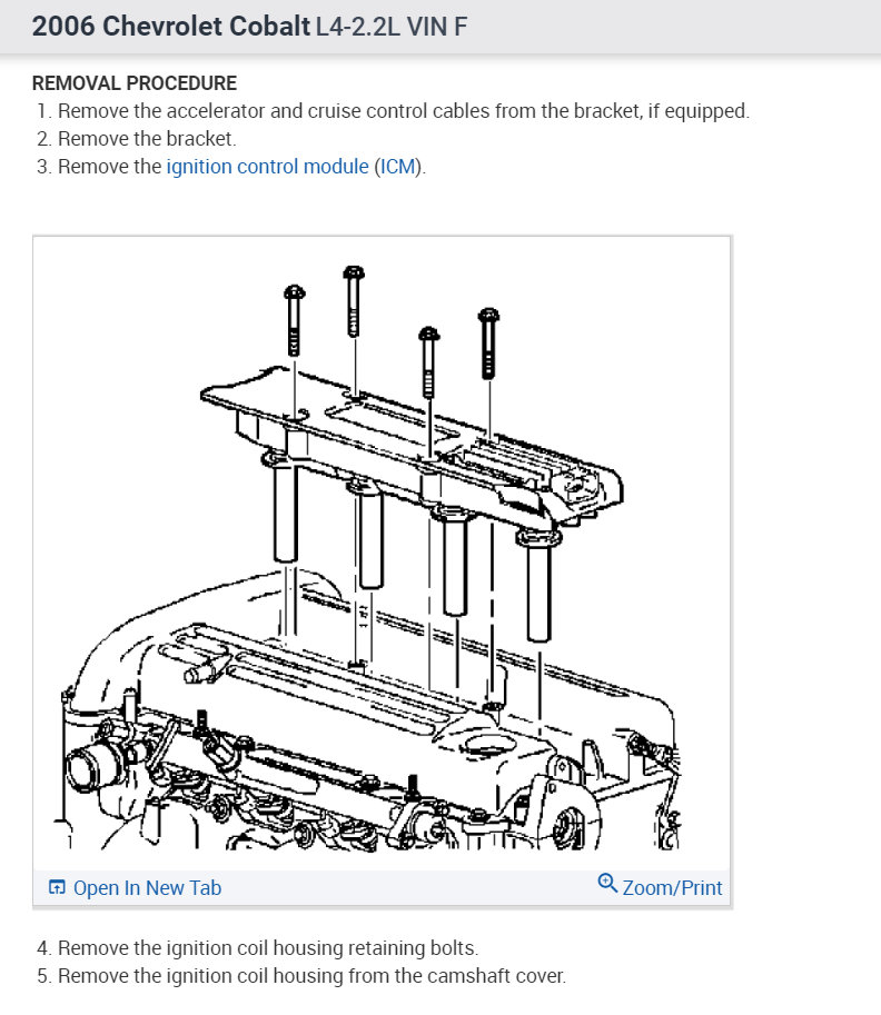

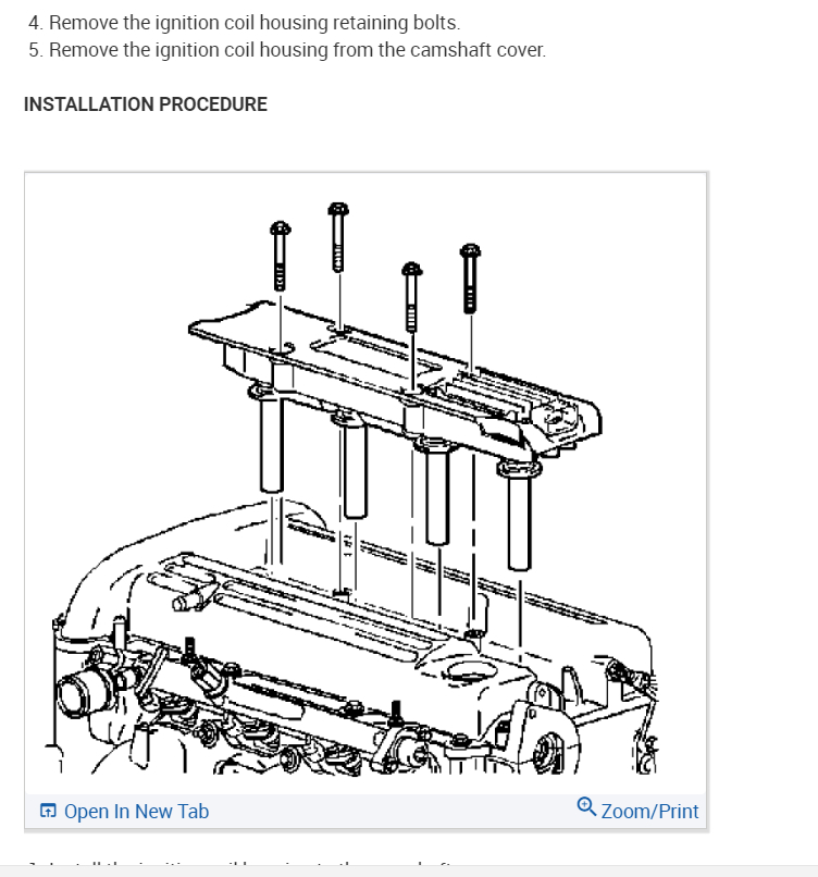

Yep, it could be the coils if they are arcing to one another or internally. Here is how to replace the coils. Check out the images (below). Let us know what happens and please upload pictures or videos of the problem.

Well, I decided to go ahead and buy a new coil pack and that did the trick! Car is running better than it ever has. That p0452 code (fuel tank pressure sensor) I was also able to fix just by unplugging it and cleaning it with contact cleaner. So, thank goodness no more working on that friggin car! Lol. Just wanted to let you know and wanted to thank you for all of the advice.
