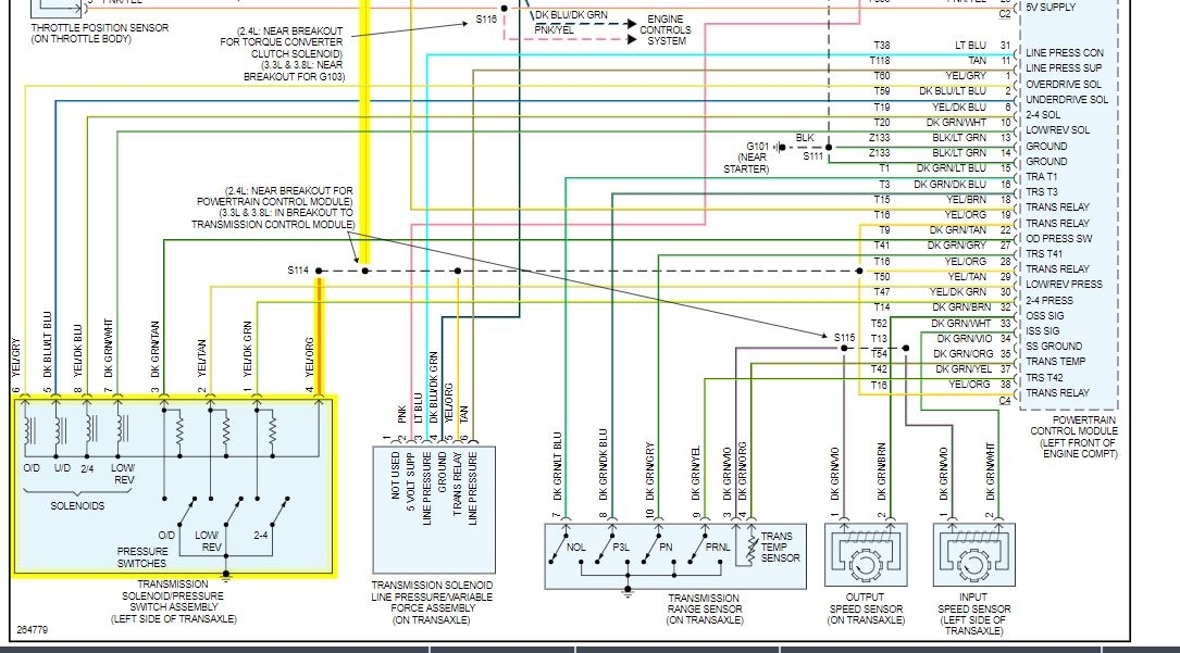

Looks like you have a wiring harness issue with the transmission. None of the codes are related to the fuel pump.

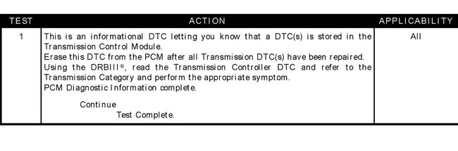

700
General transmission code. It means there is another code set.

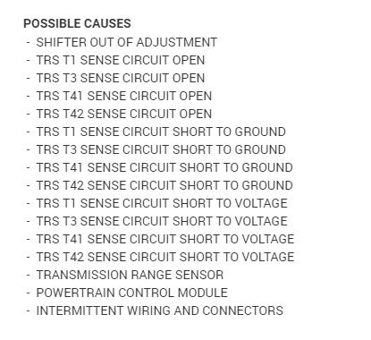

706 is below. This looks like a wiring issue.

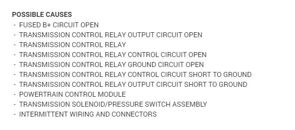

888 is below as well.
882 is the same as 88.

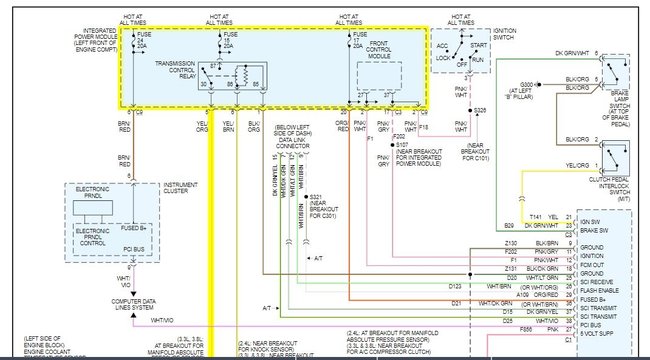

You will need a test light and a voltmeter to do some testing.
I attached a wiring diagram for you to view. Check the 3 fuses listed in the one diagram. This is not a visual test, it is a power test. Use a test light and check for power on both sides of the fuse.

They need a scan tool to clear the code. The 700 is a general transmission code. Usually, there are other codes but this is an information code.

Turns out multiple broken wires in harness main problem was etax ground wire. thanks for all the help.
