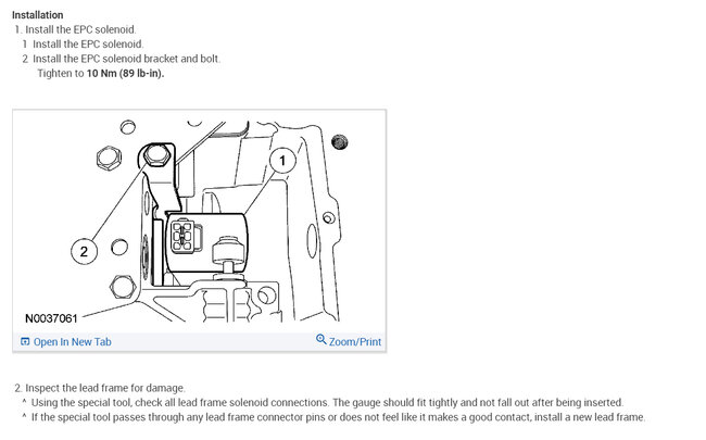

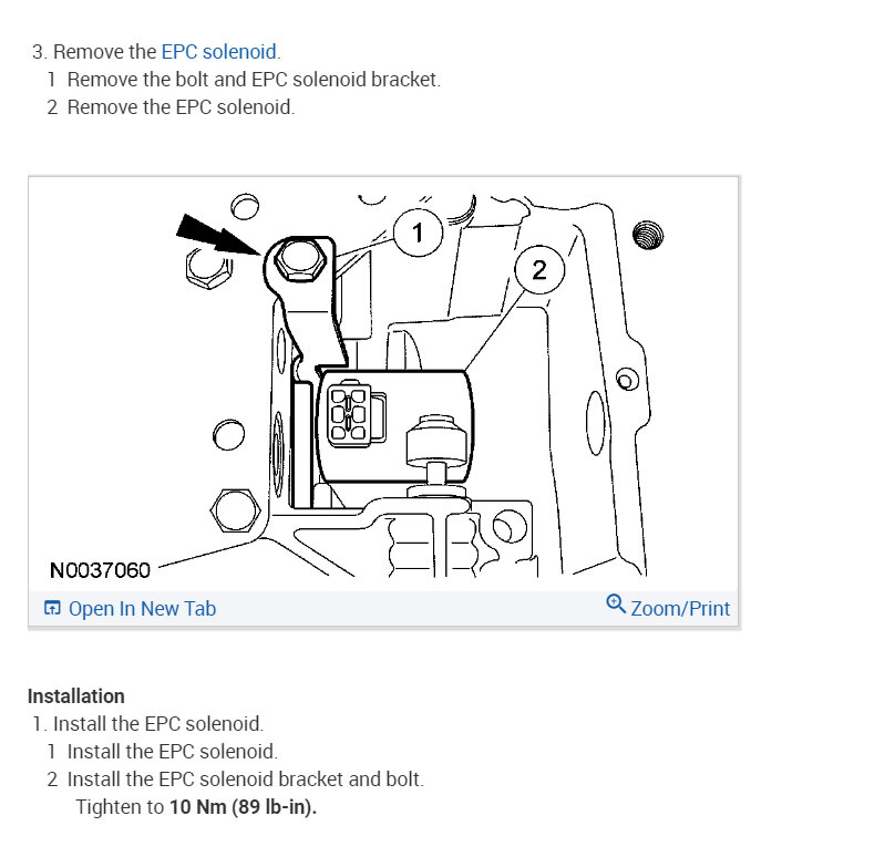

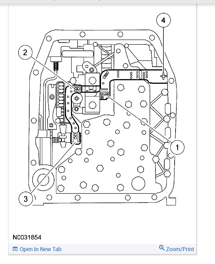

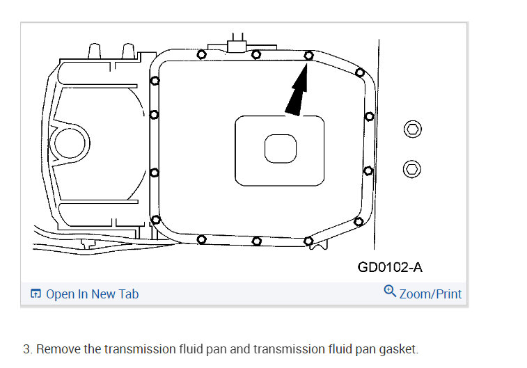

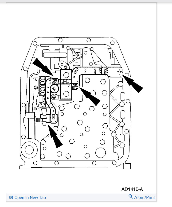

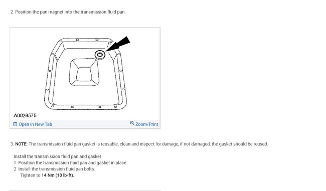

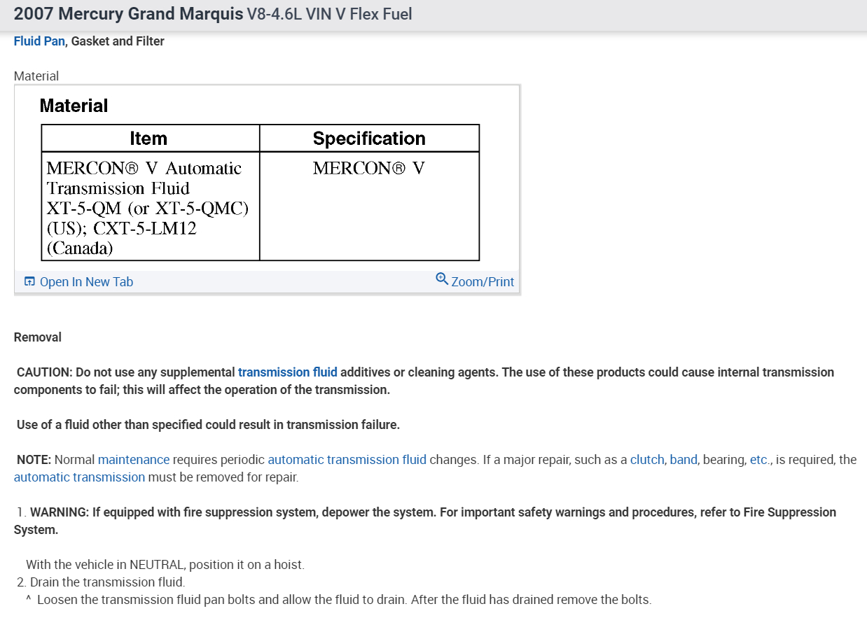

Anyways, I bought this car the other day. Seemed okay on test drive. Paid the man. Drove 30 minutes home. Went to do a 3-point turn it, and noticed it took about 4 seconds to decide to hit drive. Tried it again. Same thing. Time and again. Even if I gave it a tiny little bit of throttle while waiting. Otherwise, the car drove perfectly, full throttle, old lady throttle, through town, on I40, you get the picture. Transmission is full, fluid is clean and the right color. Car hasn't been used in a year or two though.
Dec 17, 2022 at 10:39 PM
  • 55,412 POSTS

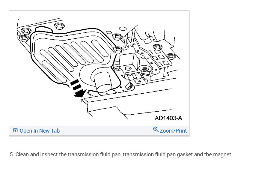

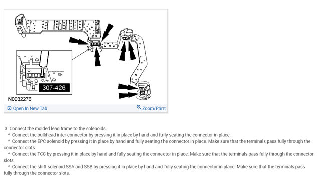

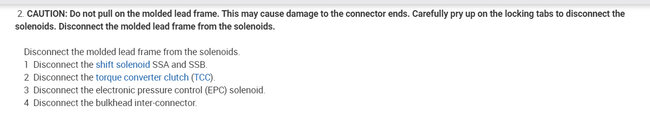

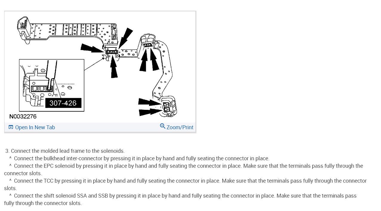

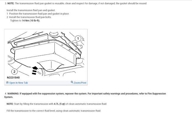

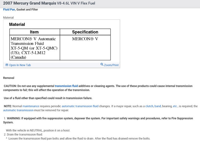

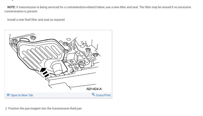

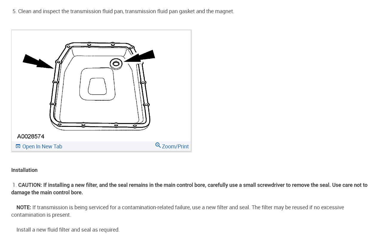

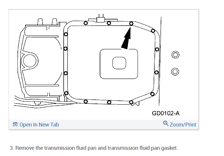

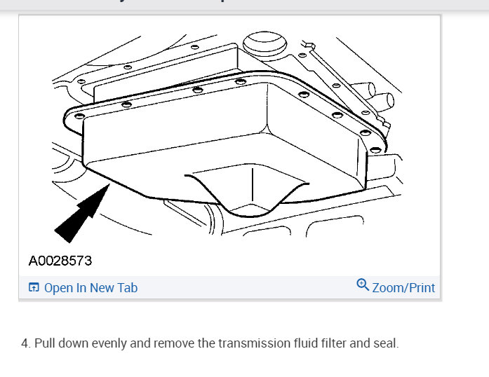

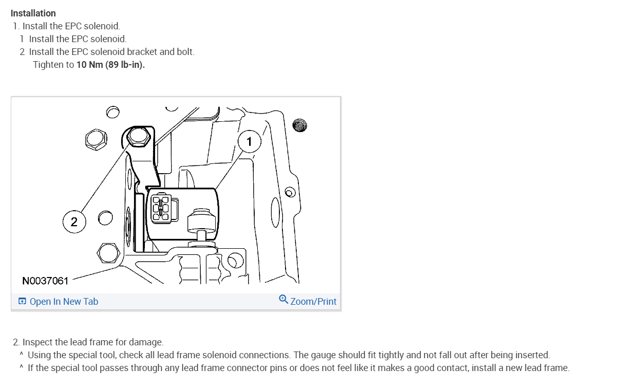

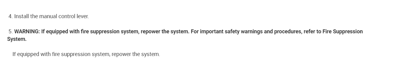

Thank you we added "Grand Marquis". It could be one of two things, first the transmission fluid filter could have fallen into the pan and is not sealed to the case. I would drop the pan to check it, next there is a pressure regulating solenoid that I would swap out I have included instructions in the images below and a guide that could help as well.
Check out the images (below). Let us know what happens and please upload pictures or videos of the problem.
