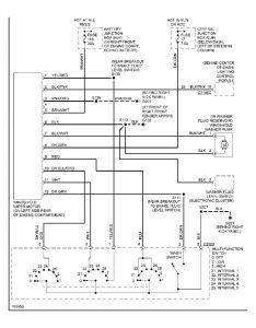

Please read the entire two part question. The Windshield Wipers, in the delay wipe and in low speed mode, didn't work, but the high speed setting dose. So, I checked all the fuses for a blown one. I didn't find any under the dash blown, so I checked the ones under the hood. I still didn't find any blower fuses. Then a bit later, when I tried to drive the car, the column gear shift would not allow me to shift out of park. I tried several times, making sure I had my foot on the brake peddle, but it stayed locked in the park position. Any thoughts on why the fuse checking would or could cause the gear shift problem?

Check to see if the brake lights are working.For some reason the Lighting Control Module is hooked into the wiper motor.The brake switch is what controls the solenoid for the shift-lock.I have included the wiring diagram for the wipers so that you can use a test light to see if the motor is getting power from the switch in the different positions

I think we are on the right track. But, the Wiring Diagram you sent was too small and blurred to read. Could you send me a larger copy of the Wiring Diagram that is readable? Also, where is the Light Control Module located? I have the Haynes Repair Manual, for this car, but it doesn't list this problem at all, or give any reference to a Light Control Module or its location.

I will send you the diagram and another for the shift-lock system, which isnt tied into the ligthing module, so you may have misinstalled a fuse or something for it to not come out of park.... Both are on their way as well as the diagram showing the location of the module

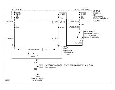

No, the Brake Lights don't work. I was afraid that you were going to say something like that. I use to be able to get into tight places, like under the dash. But now I am just getting to old to get under there any more. Is there any other way to get that Shift Lock Cylinder to release so we can at least move the car? It is in a bad place at the moment.

You arent going to like its location.... under the dash on top of the column.You can disconnect the shift cable under the dash to get it in neutral to move the car if need be.If on a hill, be sure to set e-brake and chock the wheel to prevent the car from rolling when you move the shift cable after unhooking it.Use you test light to see if the brake light switch is working, should have power at the light green/red wire. then when brake pedal depressed it should have power at the light green wire.Then power goes through fuse 19 (15 amp) to the solenoid.Also check fuse 16 it powers up the system as well
