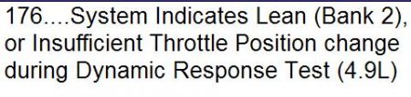

The codes are as follows:
172, 176, 332, 337 & 634

https://images.2carpros.com/forum/automotive_pictures/62217_172_2.jpg
https://images.2carpros.com/forum/automotive_pictures/62217_176_1.jpg
https://images.2carpros.com/forum/automotive_pictures/62217_332_2.jpg
https://images.2carpros.com/forum/automotive_pictures/62217_337_1.jpg
https://images.2carpros.com/forum/automotive_pictures/62217_634_1.jpg
Start with the lowest codes and work up, The egr insufficient flow is a blockage of carbon in the EGR grooves under the upper intake. go here and look at 94 town car, yours is the same, fix this, then clear KAM(keep alive memory) and retest. 176 probably means you didnt goose the gas pedal during this part of the test. http://www.lincolnsonline.com/tech/00015.html
