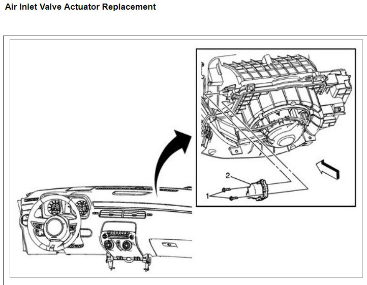

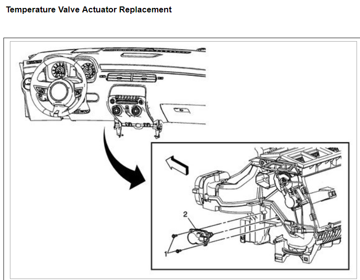

My defroster and heater are not working. The fan works but no hot air comes out.
Mar 5, 2018 at 2:58 AM
  • 55,399 POSTS
Yes, it sounds like you have a temperature blend door actuator that is not working right. Here is a guide to help you see what you are in for when replacing the actuator:

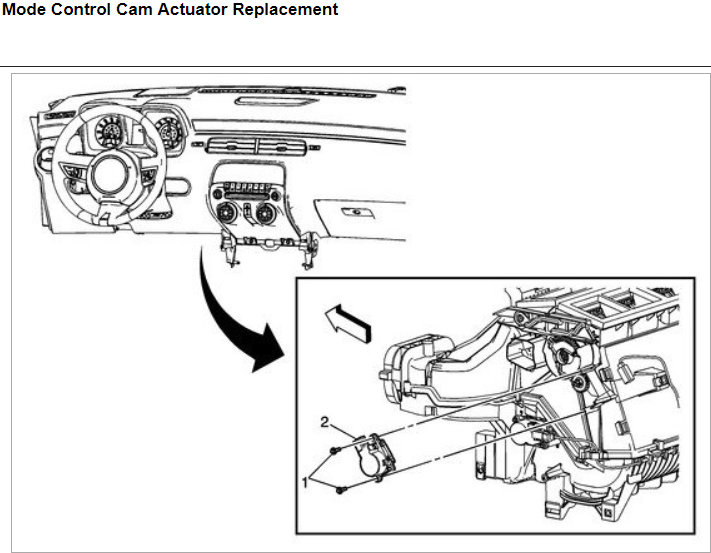

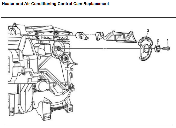

Here are the locations of all blend door actuators in case you need it later down the road. I would replace the temperature actuator.
