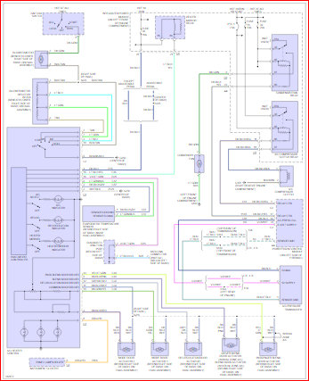

I had my dash pulled out working on eliminating the factory infinity amplifier and installing aftermarket Bluetooth media player. As I was working I noticed the glove box light was on and dome light at times. Anyway, I had to jump start the truck. Now defrost light is blinking constantly is this a code? Any information would be appreciated.

Yes, it is possible a code is now stored in your trucks computer. Are you sure when dash was put back in all the connectors/harnesses were plugged in and correct? If you don't have access to a code reader/scanner your local auto parts stores have a tool loaner program and will rent you one. Here is a tutorial showing what is involved checking codes: lets do a CAN scan which is the future of automotive repair you can get a CAN scanner from Amazon for about $50.00 here is a video to show you how.

Thank you for your help. I believe I've got it figured out. what I failed to mention I just remembered after the fact I change the heater control panel when I have the dash out because one speed on my fan control wasn't working. that control board must be bad because I put the old one back in and now it's fine. so thank you for your help. have a Merry Christmas.

However, the same speed that didn't work on the original board didn't work on the replacement board either. so there must be a problem somewhere else with that particular speed selection. I don't know if it's on the fan motor or the wiring. I might have to do some more investigating on that. I do know it's not on the on the control switch now though.

Be sure to check the blower motor resistor. Make sure it's not burnt/melted and has a good connection. Here is a link to testing wiring if it helps:
I've attached a picture of the HVAC wiring circuit below.Hope this helps and thanks again for using 2CarPros.
