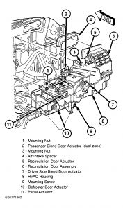

With air conditioning running there is acceptable cold air out of the drivers air vents, but the passenger air vents have warm air.

Do you have dual climate control?

Please send the dash board removal procedure I may be able to makeout the pictures.
More than likely one of the doors in the duct work has failed and I need to get to them to see.
Do you have any other ideas?

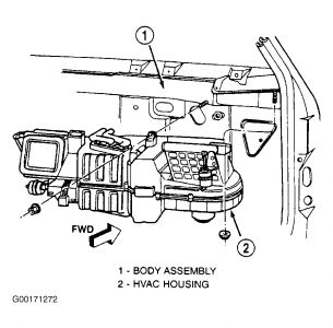

Here is what I was able to find. The directions explaine how to replace the heater core which requires the dash removal. I hope it helps and you can read it. And I agree, one of the vent doors is the problem. Infact, I feel the blend door is the problem. The last pictures are from Chrysler. #2 on the first picture is the blend door for the passanger side if you have dual climate control. The last picture on the page is removal of the HVAC housing.

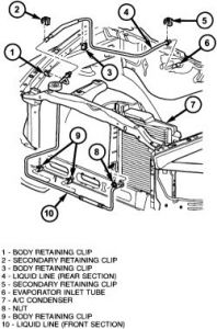

A.Discharge and recover the air conditioning system refrigerant.
B.Disconnect the refrigerant lines from the evaporator. Plug the openings to prevent contamination.
C.Disconnect the refrigerant lines from the accumulator. Plug the openings to prevent contamination.

8.In the engine compartment, remove the heater/air conditioning housing assembly-to-chassis nuts.
9.In the passenger-s compartment, remove the heater/air conditioning housing-to-dash panel nuts.
10.Pull the heater/air conditioning housing assembly rearward far enough to clear the studs and air conditioning drain tube holes.
11.Remove the heater/air conditioning housing assembly from the vehicle.
12.Remove the upper-to-lower heater/air conditioning housing screws and remove the upper housing.

Fig. Exploded view of refrigerant line
