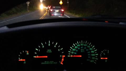

The back lights are still on. Slapping the dashboard with your right hand turns the dash back on. Also, intermittently when attempting to start, the dashboard appears okay, but the starter will not click or attempt to start the engine. Another slap on the dashboard fixes the issue.

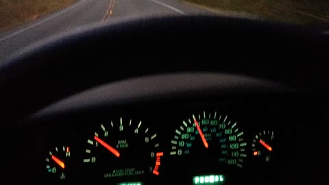

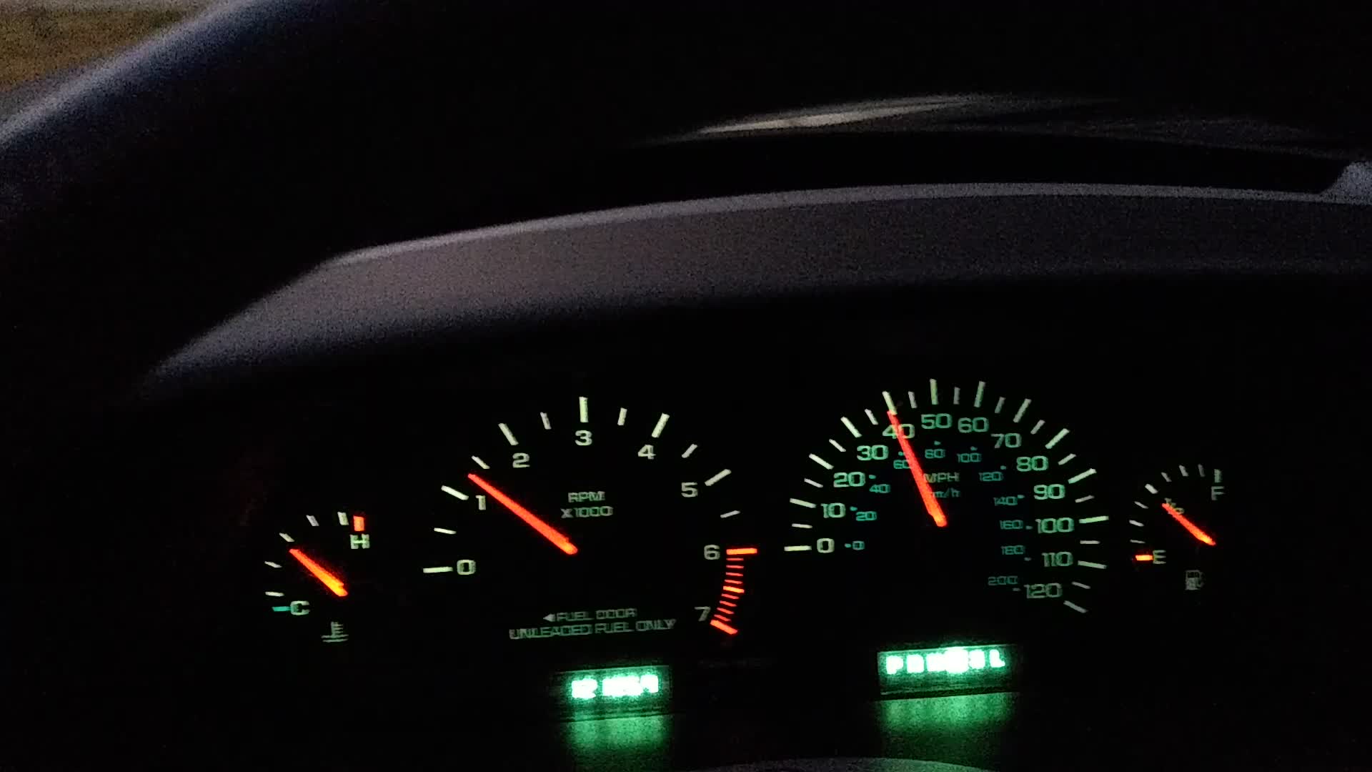

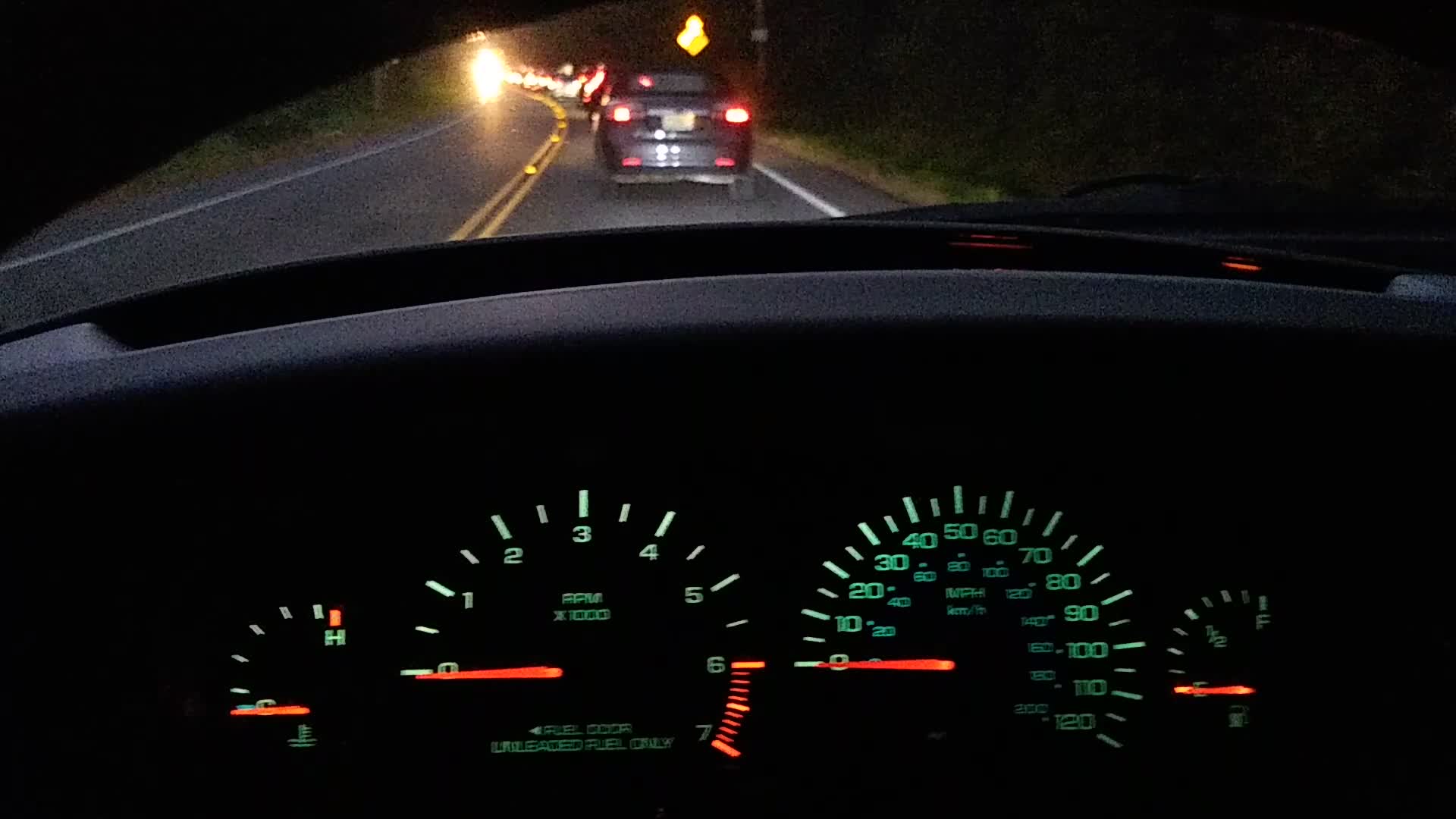

MGPETRYK
showing dashboard before and after a slap.

Don't waste your time with an over-involved diagnosis. There are broken solder connections on the instrument cluster's connector. Two rows of pins. Most commonly broken connections occur on those pins on the ends of a row.
