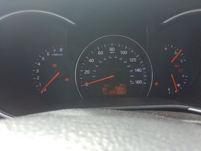

When idling for more than 10 minutes every single one of my dashboard lights will come on and the car will shut off?
2015 KIA SORENTO
130,000 MILES
DEVIN THOMAS
It will take a few tries to get it to turn over and start again, when it does all the lights turn off, but my RPMs will stay at 0. Even when I start driving the RPMs will stay at 0. After turning the car off for a while and leaving it, everything will go back to normal.

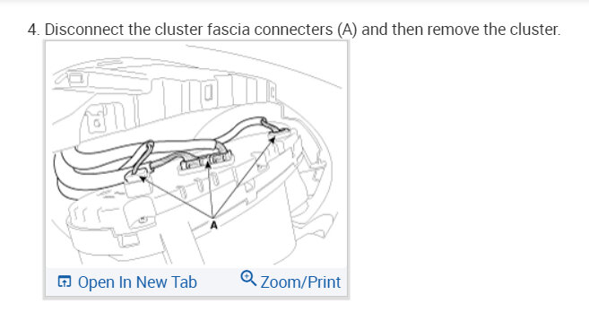

It sounds like the IPC is going out but to be sure let's run a CAN scan. You can get a CAN scanner (Controller Area Network) which will work on most cars from Amazon.
https://youtu.be/u-4syLc-ifQ

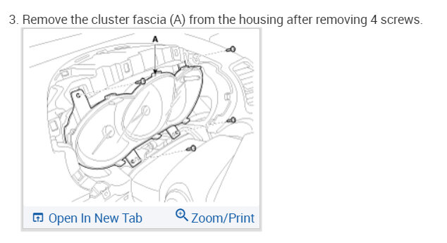

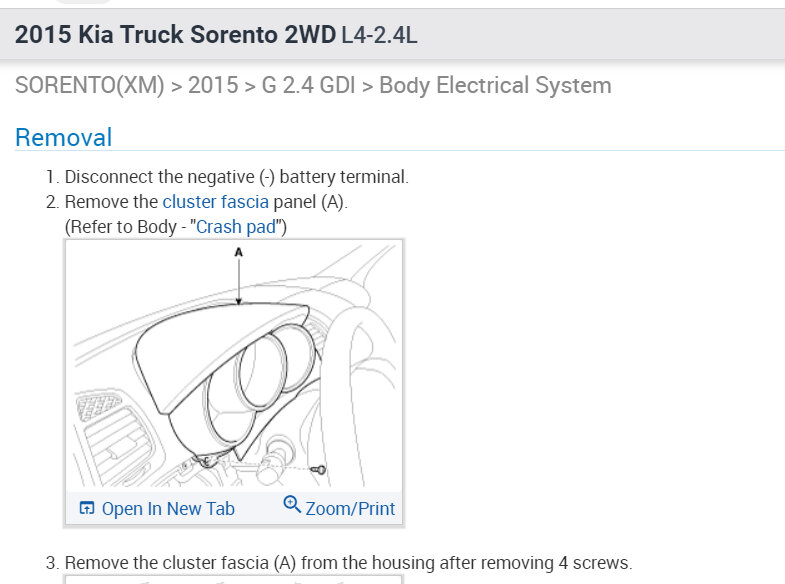

Here is how to change out the IPC, you can get a preprogrammed unit by searching Google or Ebay. Check out the images (below). Please let us know what happens.
