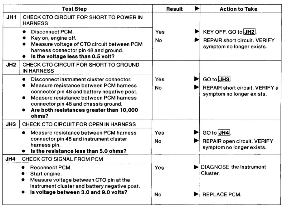

Why am I having problem that when my he is turned on my dashboard instrumental cluster panel goes haywire and when I hit the top of my dashboard it goes back to normal. however my RPM gauge always sits pointing down toward the bottom of my dashboard instrumental cluster panel. what could be the causes of this issue?

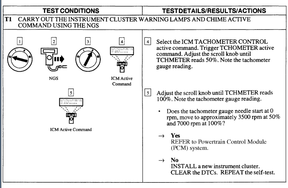

Let's talk the two that you mentioned in the heading. The cluster issue with the RPM gauge not operating is most likely a cluster issue. I attached the testing but unfortunately you are going to need a scan tool in order to confirm this. Basically you are going to hook up to the cluster and make sure that each gauge works properly. If it does then the PCM is not sending the signal to the tachometer for it to operate.

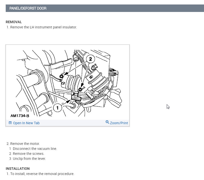

As for the panel vents not blowing properly, that is because of the actuator. I attached the process on how to replace this. Be careful with this because it is run off of vacuum so we need to check the vacuum line for leaks but I suspect the diagram inside is the issue which is why it responds by hitting the dash.
