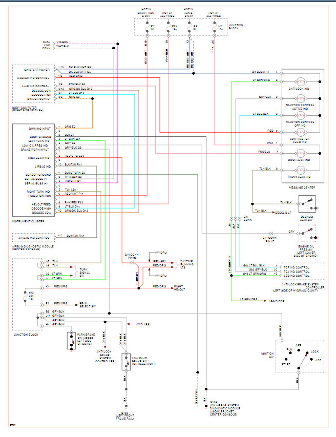

None of the dashboard gauges will work and the heater runs wide open and will not turn off. I also have a problem with my radiator fans, they want work at all. I checked the fuse box and there is power going to the relay but there's not any power going from the box to the wire that plugs into the fans.

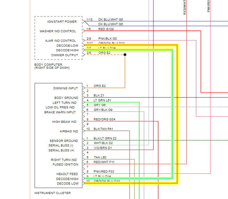

So let's start with the dash gauges not working. Can you get a picture of what is not working? Do any of the lights on the cluster work? We are going to need to check and make sure we are getting voltage to the cluster on the wires highlighted. If so, what is the voltage with the engine running.
Let's start with this and go from there. Thanks
