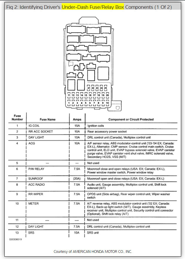

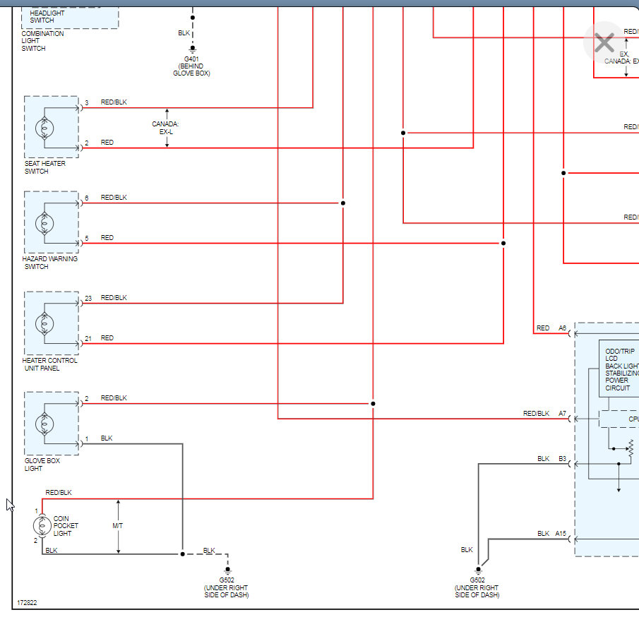

all fuses work with the key in "on".
Aug 3, 2020 at 8:15 AM (Merged)
So if all the fuses are working then I would go to the component with no back lighting and make sure the power is getting to it. If it is then the bulb is burned out. If you don't have power then you have a short between the fuse and component but this is unlikely based on what happened.
When you shorted the circuit the bulb is sometimes the weakest point which caused the open.

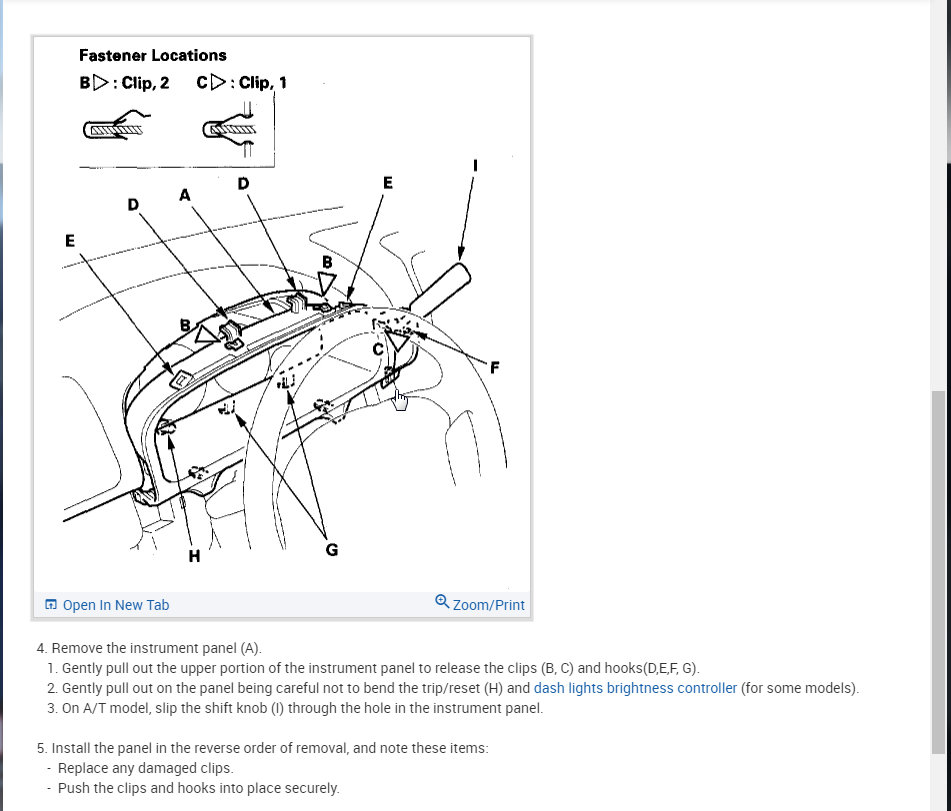

The only issue is it looks like the cluster is an LCD back light. I am not able to find if this is replaceable. If not then you will need to replace the cluster to fix it. However, I would pull the cluster out and see if you can access the bulb from behind it.
KYLE MENDES
  • 19 POSTS
So there are bulbs that illuminate all the dials and the odometer back-lighting. I shorted out the dash, then in the mix of things, swapped in the new bulbs.. only to find they were still out. So bulbs have been changed since this debacle. I guess the next step I could do is check the wiring harness for 12 V power. If that's fine.. then I assume the cluster is fried somewhere? Is that fixable at all? I don't really want to swap clusters because then my mileage wouldn't match. Also, the radio back-light and climate control still don't work, so it can't just be the cluster.

Yeah. I would check for 12 volts and if you have it then more than likely the component is failed at this point. The cluster has a circuit board that may have been damaged.
The way I would approach this is to look at each issue individually. It could all be related but if you just search for the common denominator you will pull your hair out. If you fix one and it fixes the rest then that is just a bonus. If not then you fix one and then move onto the next.

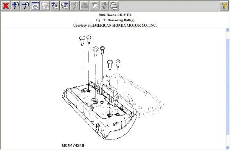

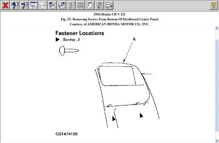

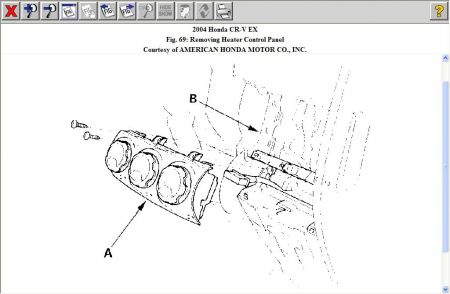

DDODGE

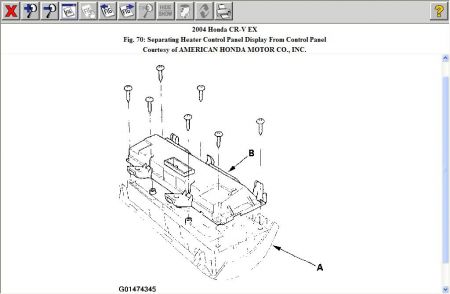

The temperature control knob light is apparently burned out. How do I remove or get to the bulb for replacement?
Aug 3, 2020 at 8:16 AM (Merged)
KHLOW2008
  • 41,814 POSTS

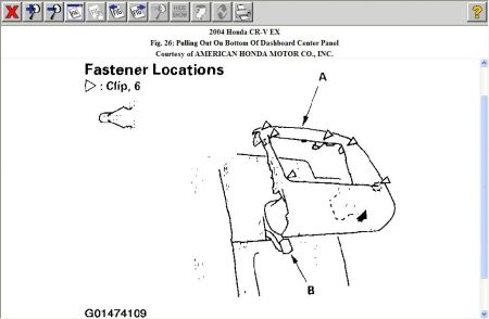

Hi ddodge, HEATER CONTROL PANEL REMOVAL AND INSTALLATION 1. Remove the center panel (see DASHBOARD CENTER PANEL REMOVAL/INSTALLATION ). 2. Remove the self-tapping screws and the heater control panel (A) from the dash board (B).
https://images.2carpros.com/forum/automotive_pictures/192750_Heater04CRV01a1_1.jpg
3. Install the control panel in the reverse order of removal. After installation, operate the control panel controls to see whether it works properly. 4. Run the self-diagnosis function to confirm that there are no problems in the system. DASHBOARD CENTER PANEL REMOVAL/INSTALLATION Special Tools Required KTC trim tool set SOJATP2014 NOTE: Take care not to scratch the dashboard and related parts. Use the appropriate tool from the KTC trim tool set to avoid damage when prying components. 1. Remove the screws from the bottom of the dashboard center panel (A).
https://images.2carpros.com/forum/automotive_pictures/192750_DashPanel04CRV01_1.jpg
2. Pull out on the bottom of the dashboard center panel (A) to create a gap between the and panel. Gently pull out along the panel to release the clips, then remove the panel. Disconnect the hazard warning switch connector (B).
https://images.2carpros.com/forum/automotive_pictures/192750_DashPanel04CRV02_1.jpg
3. Install the panel in the reverse order of removal, and note these items:  Make sure the hazard warning switch connector is plugged in properly.  Replace any damaged clips.  Push the clips into place securely. HEATER CONTROL PANEL BULB REPLACEMENT 1. Discharge the static electricity (which accumulated on you when you removed the climate control unit) by touching the door striker or other body parts. 2. Remove the self-tapping screws, then carefully separate the heater control panel display (A) from the control panel (B). Do not kink or pull on the wires between the display and the control panel. Do not touch the electronic components on the printed circuit board in the control panel.
https://images.2carpros.com/forum/automotive_pictures/192750_Heater04CRV01a_1.jpg
3. Remove the bulb(s) with a flat-tip screwdriver.
https://images.2carpros.com/forum/automotive_pictures/192750_Heater04CRV01b_1.jpg
4. Install the bulb(s) in the reverse order of removal.

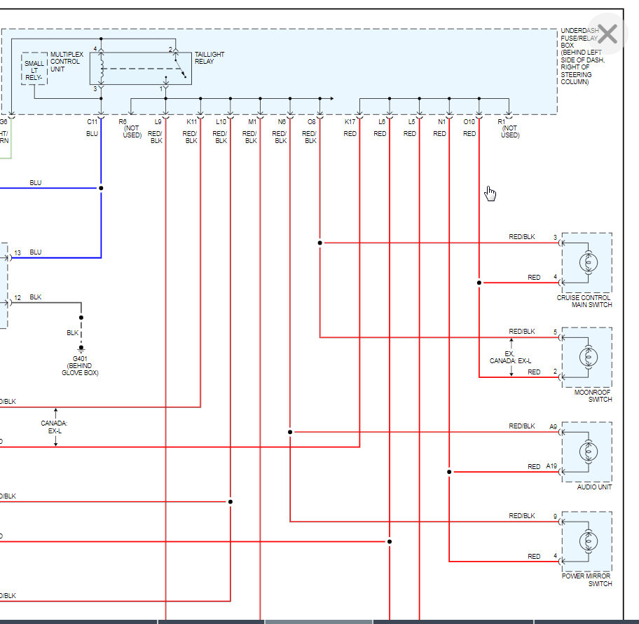

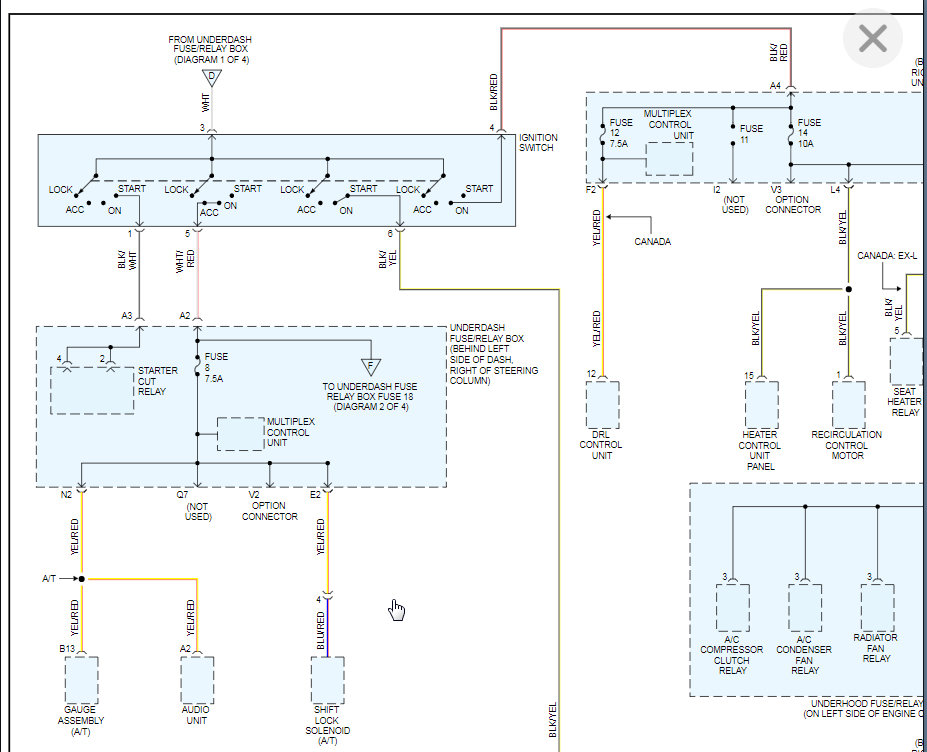

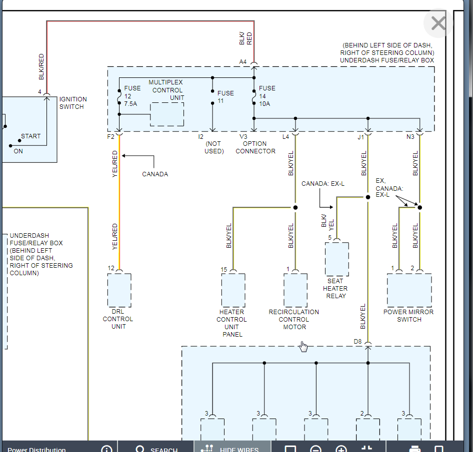

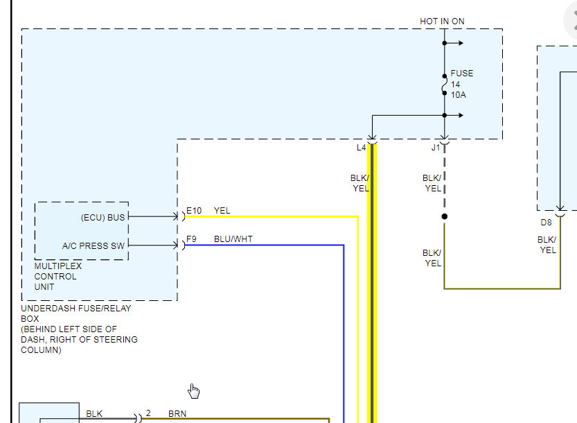

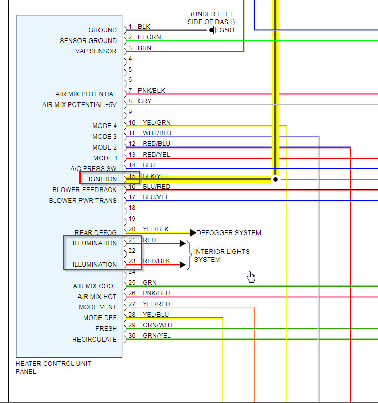

That's crazy how one low voltage LED short can screw up so many things. So testing these components individually, I should see if power's even getting there right? So for the climate control for example, I need to find a wiring diagram to see which terminal is power, then can I just hook up the car battery to the power terminal? I'm assuming no due to fuses and such.

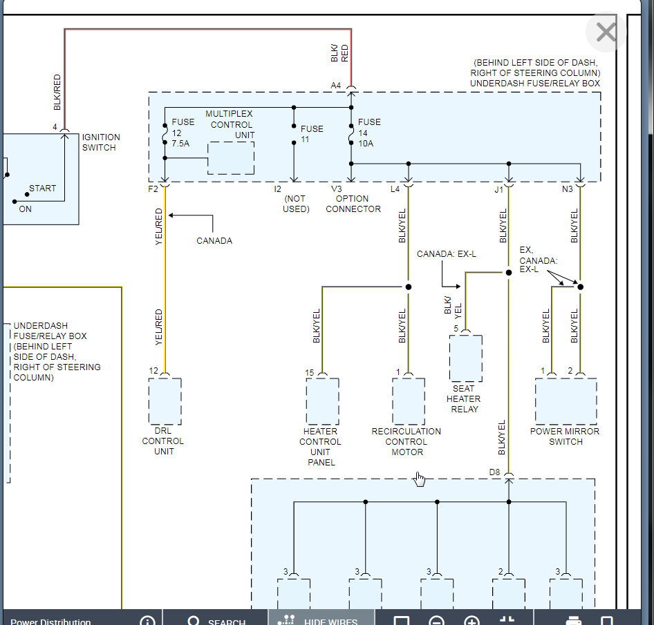

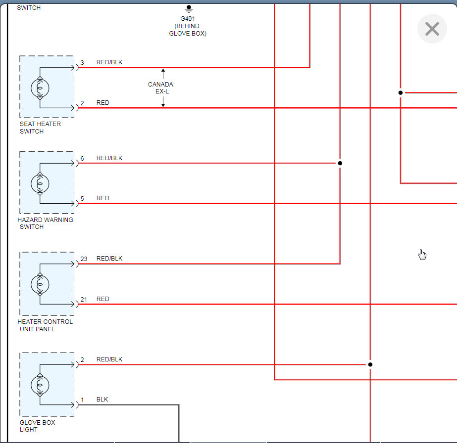

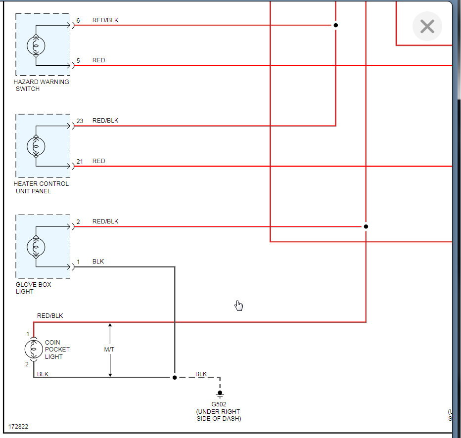

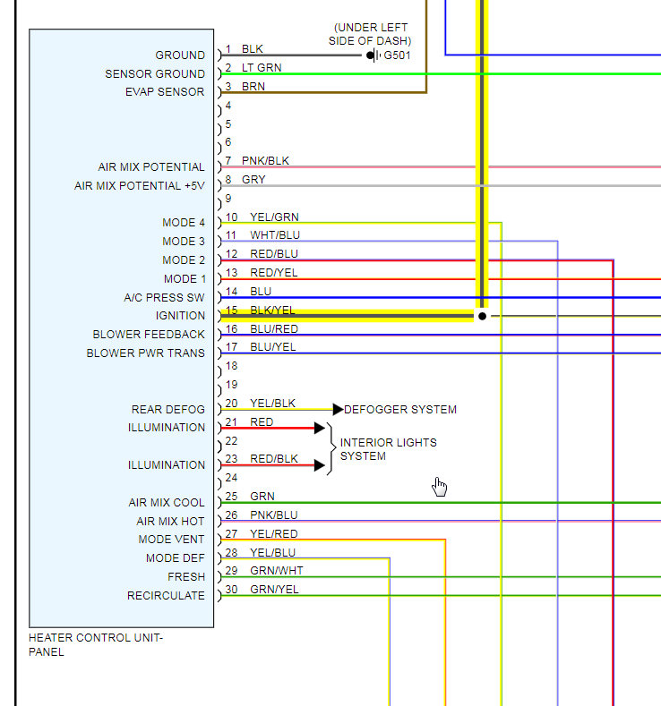

Yes. I included the diagram for the HVAC control panel. You want to see if you have 12 volts on the black/yellow wire. Do I understand correctly that the controls don't work or just the back lighting? If it is just the illumination doesn't work then check power on the Illumination circuits shown. If no power then we need to chase those. If you have power, then it is the unit.

Yes, the car's fully functional for headlights, with exception of radio back light, gauge lights, and climate with headlights switched on.

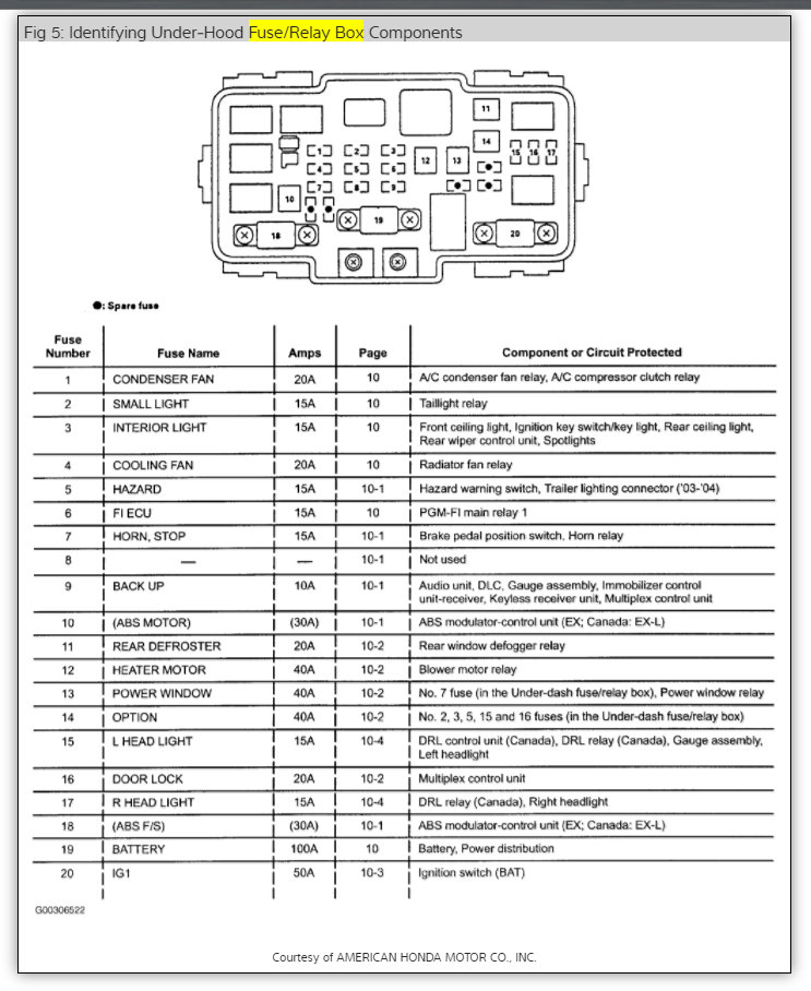

I discovered something new. My power windows are all out. So darn. I was sure I checked that relay but I'll have to check again. A mobile electronics place near me charges $70.00 an hour to fix. I really don't want to pay but I can't figure this out.

So wherever there is a wire harness check to see if 12 volts is at the black and yellow port?

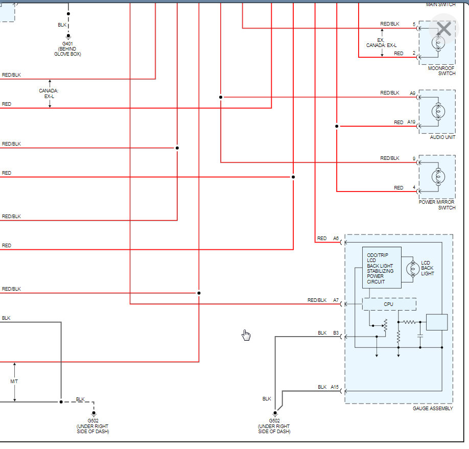

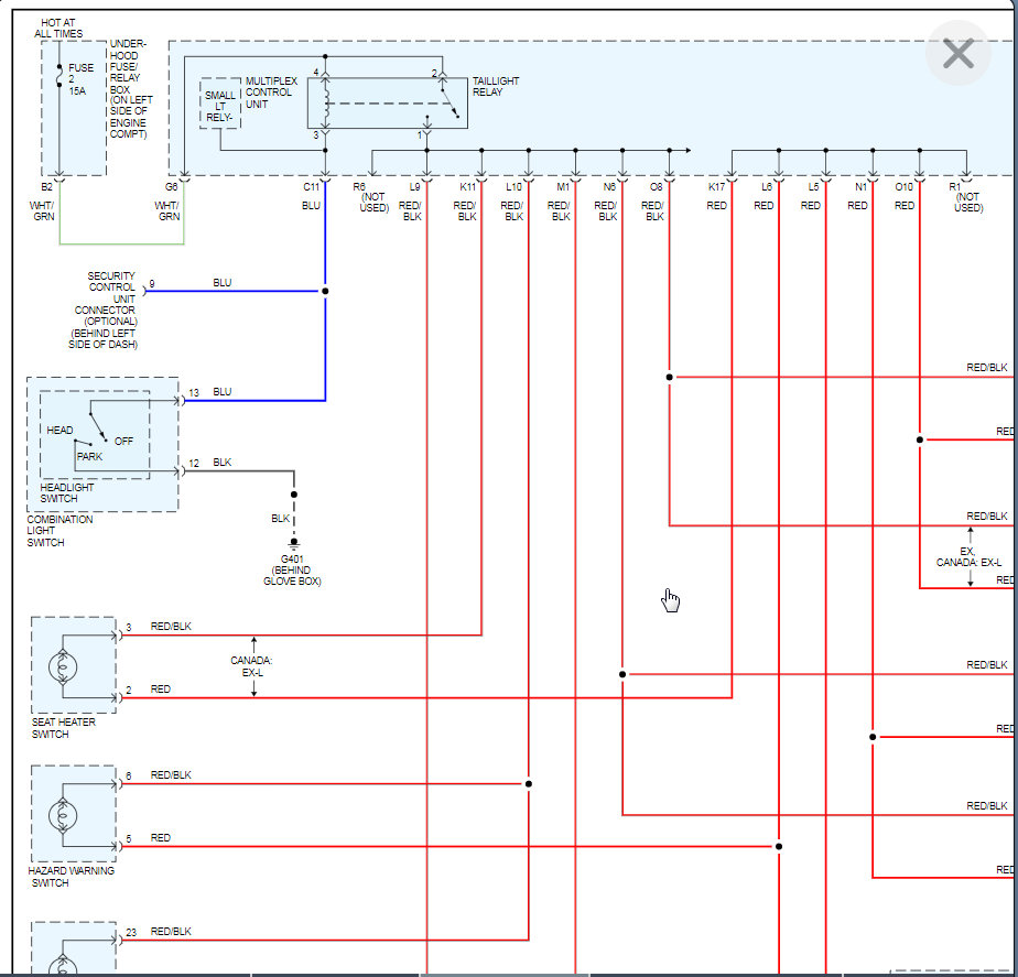

Well. The black and yellow wire is the ignition feed for the heater control which is what power the back lighting.
So if your issue is that the backlighting does not come on when the headlights are on then we need to check the ignition feed for power. If you have it then we need to test for power on the illumination circuits which for the HVAC control head are the Red and Red/Black wires.
Unfortunately these wire colors are probably going to be different for each module unless they share a splice.
Let's just turn the headlights on so that the backlighting should be on and test for voltage on these three wires. Let me know what it is and we can go from there. Thanks
KYLE MENDES
  • 19 POSTS

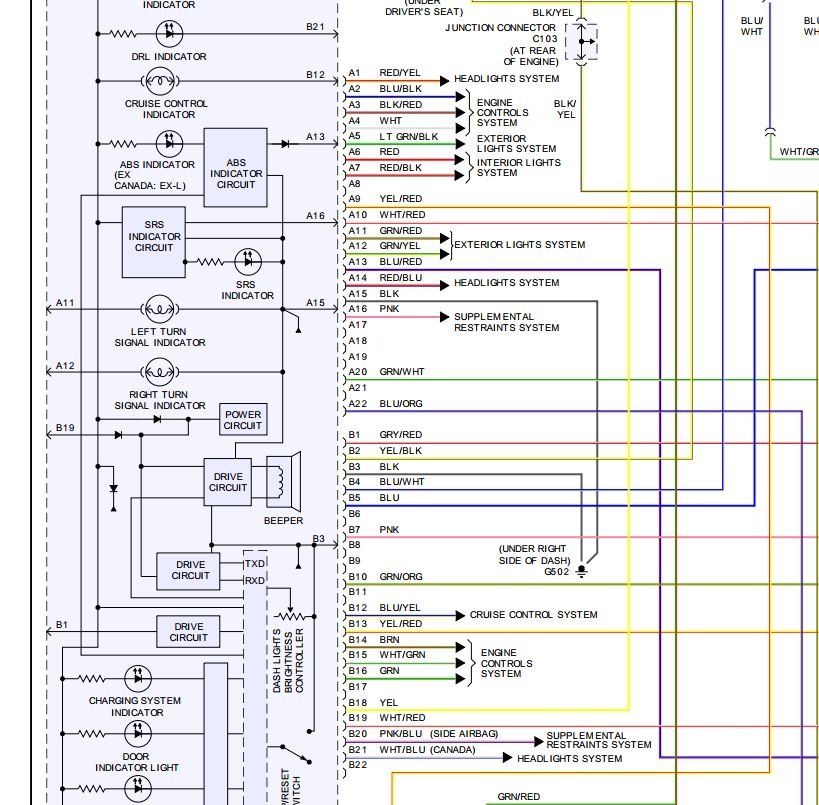

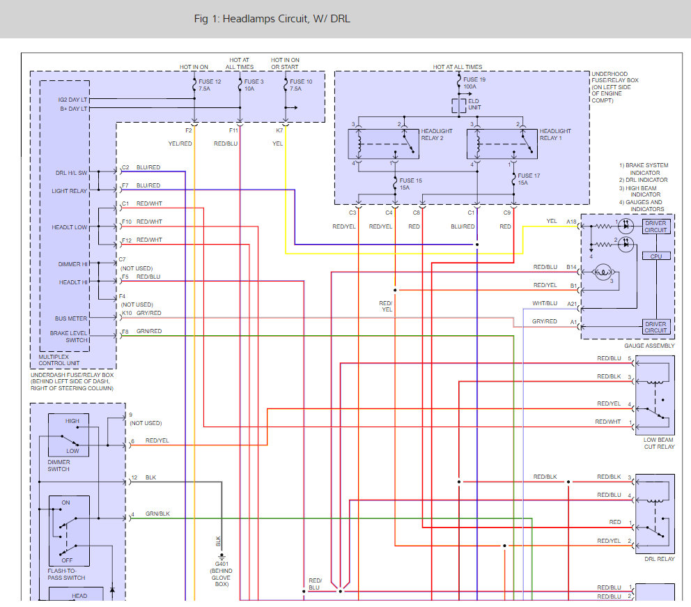

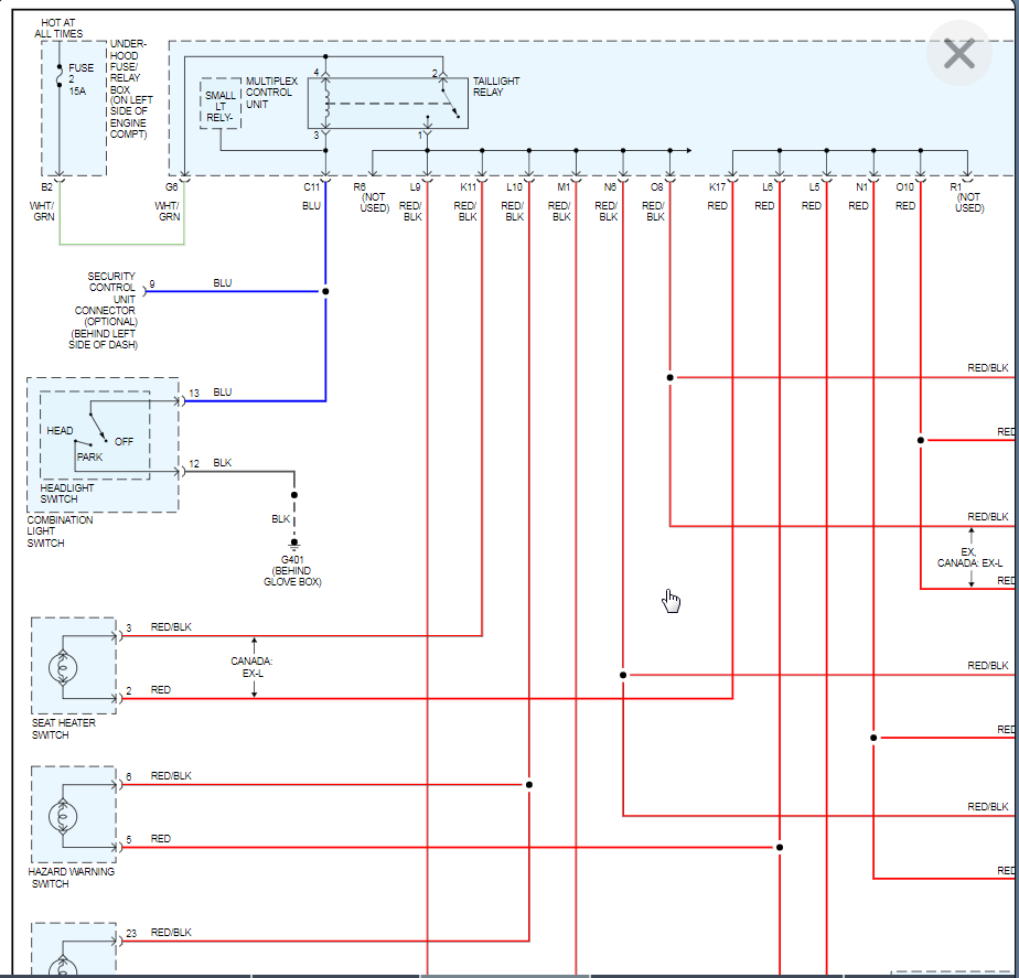

Finally got around to this. Been busy at work. So black/yellow, red, and red/black all have power. I had one terminal at the clip and the other on ground to measure.
KYLE MENDES
  • 19 POSTS

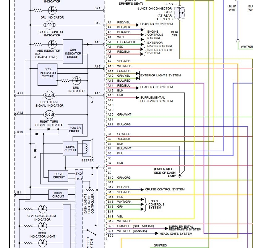

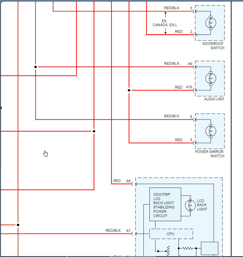

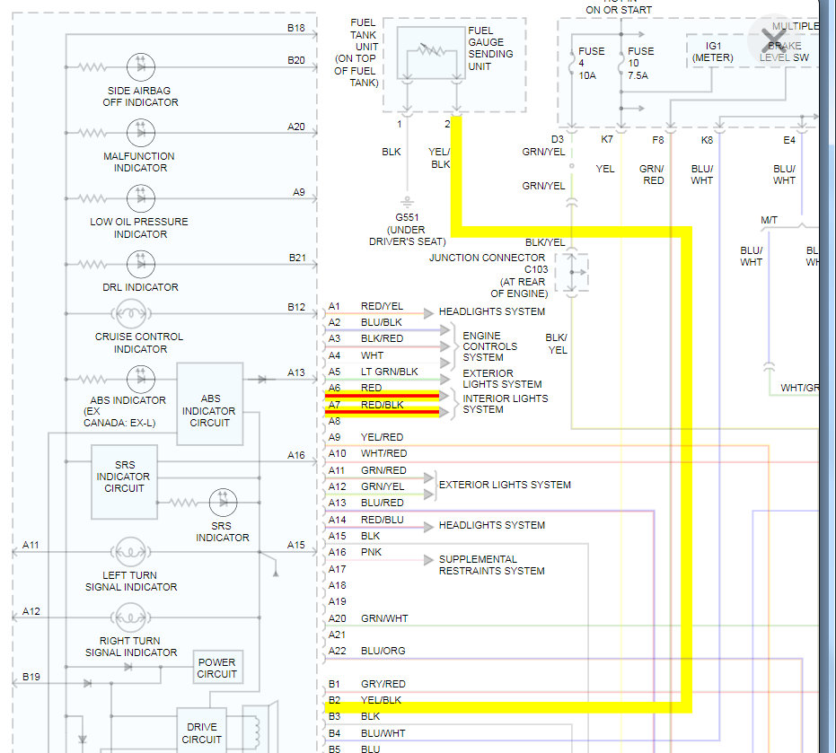

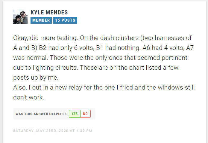

Okay, did more testing. On the dash clusters (two harnesses of A and B) B2 had only 6 volts, B1 had nothing. A6 had 4 volts, A7 was normal. Those were the only ones that seemed pertinent due to lighting circuits. These are on the chart listed a few posts up by me.
Also, I out in a new relay for the one I fried and the windows still don't work.

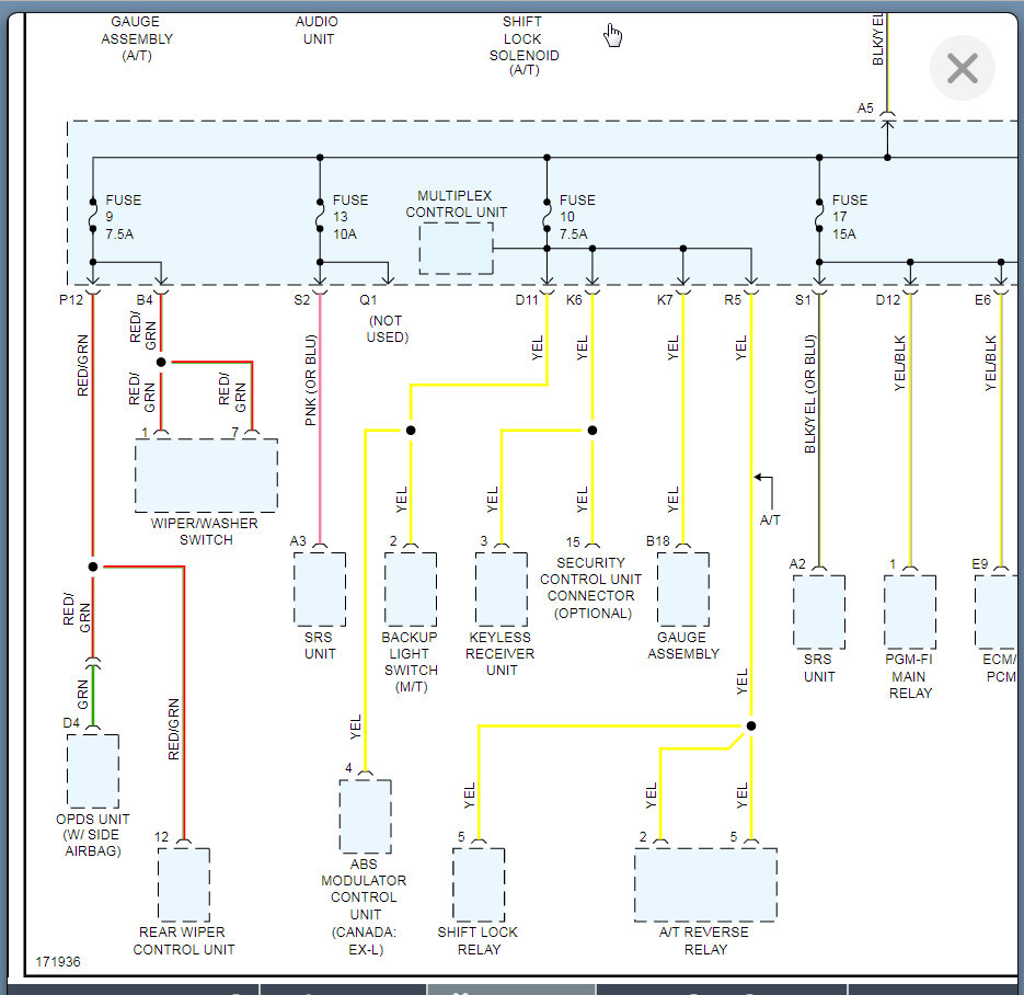

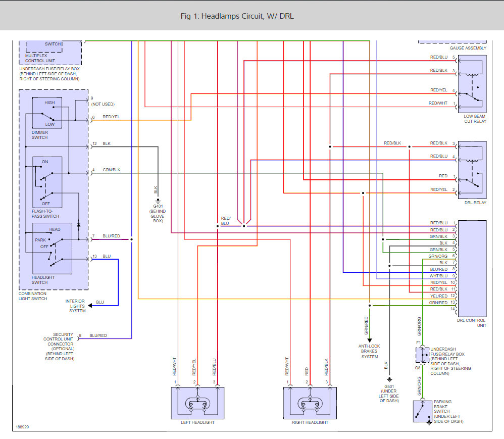

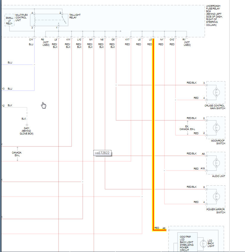

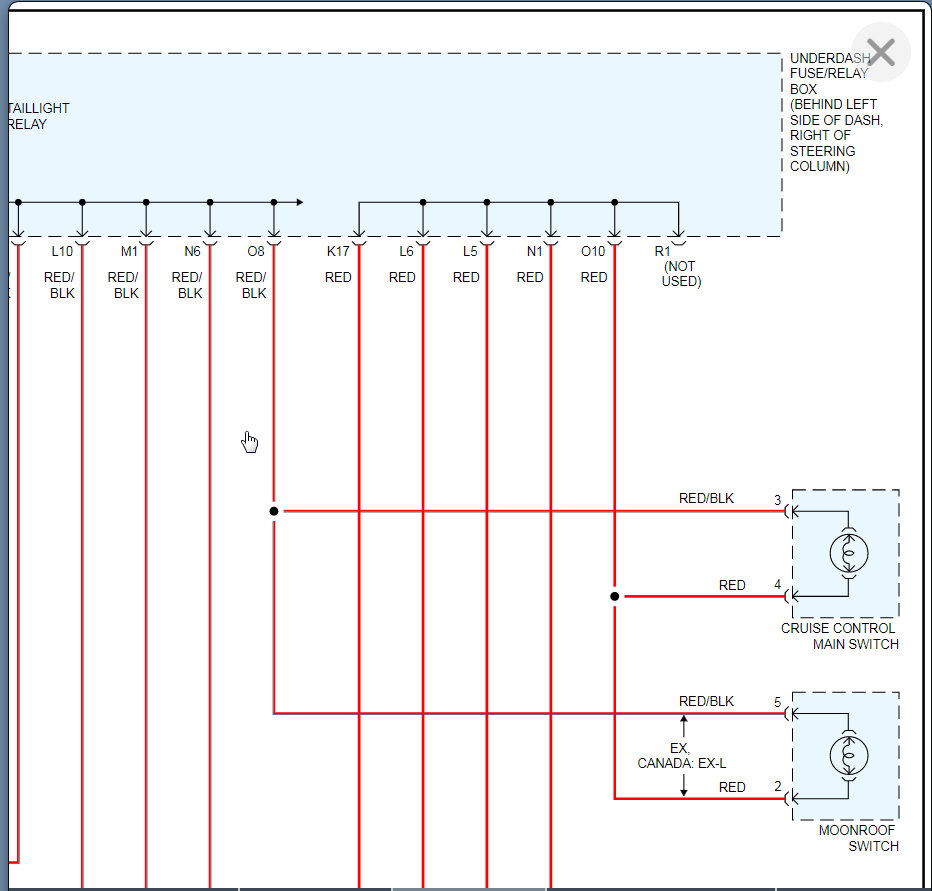

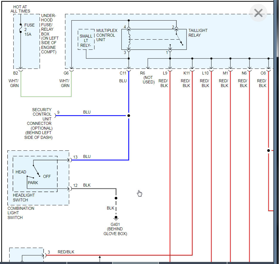

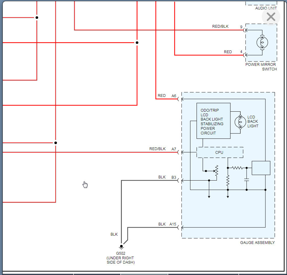

Clearly not the response I was hoping for. Let's go back to this post that you gave earlier. I attached it for your review.
B2 you said had 6 volts. This is for the fuel gauge sending unit so I imagine you had a half tank of fuel when you took that reading so I assume that is just fine.
The A7 was normal, I assume you had 12 volts. Is that correct?
The A6 with 4 volts is what we need to focus on. This wire is a direct feed from the underdash fuse box. Can you go to this L5 wire and check voltage there?

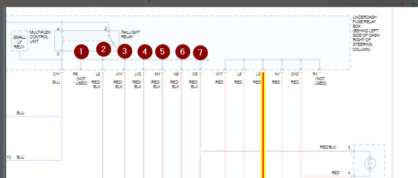

I'm looking at this box. Not knowing what L5 is. I don't see any plugs with all red or red and black wires.
Do you have two connectors? One with 7 terminals but only 6 wires? The other with 6 terminals but only 5 wires? Ignore the color as that may change. We just need to make sure this matches. If not then we need to find out why that is not the same as your vehicle.

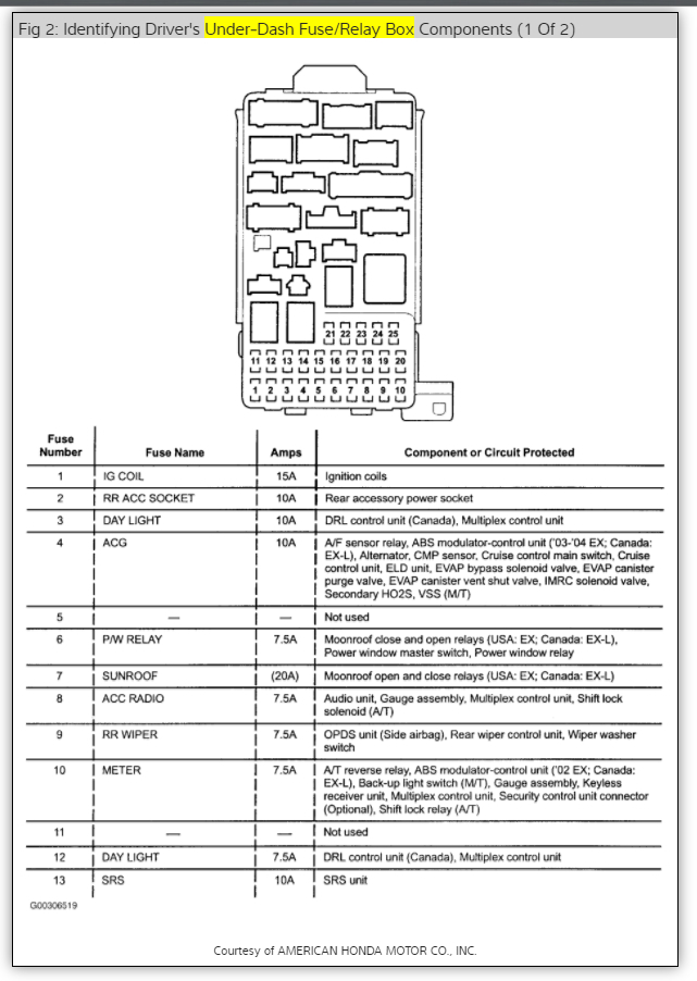

It's the usual K24A1 engine. What I meant was the under dash fuse/relay box (which is in my second post) is what I'm seeing. the top plugs, then the relays, then the fuses. I have no idea what L5 is, or even what you mean by a 7 or 6 terminal connector.
Sorry. The terminals are basically the female connectors on the back of the fuse panel. If you look on the back of the panel you should see two connectors. One with 6 wires and the other with 5 wires. The connector with 5 wires is what we need to look at.

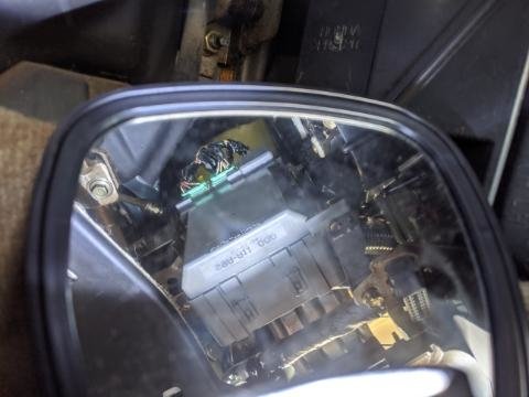

I can't get to them. They look like make connectors from the mirror I'm using and one looks like 4 wires but there could be one hidden. I have no idea how to reach it. My arms blindly reaching up under since I can't see and I can't reach the release levers.

here's a pic of what I'm seeing:

Unfortunately there is no trick to this. You may end up on your back in a very awkward position or you may have to try and unbolt the entire unit and pull it down a little to give you more access. Again, there is no trick as under dash work is the worst.
