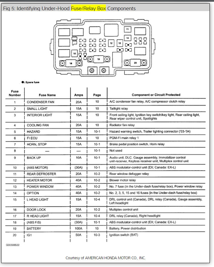

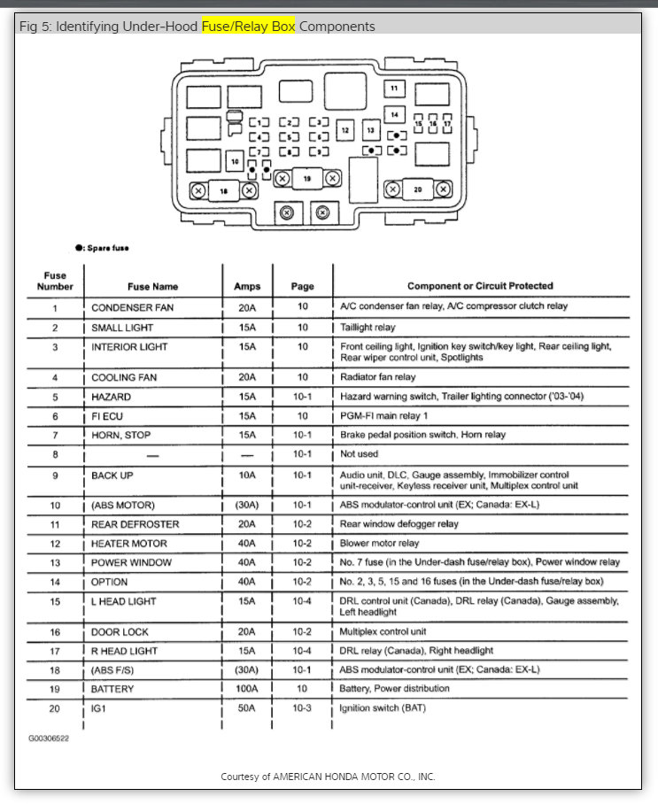

The dash lights (except for indicator lights) will not come on when headlights are turned on. I just checked the fuse, or at least the one I think is the fuse for the dash lights (radio/accessory) and it is not blown. Not sure what to do or check next. I am not very maintenance savvy, but if it is as easy as changing a fuse or light bulb I can handle it.

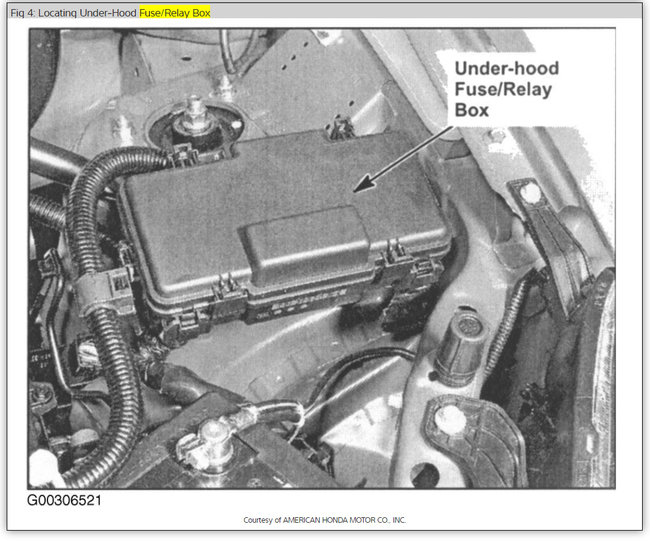

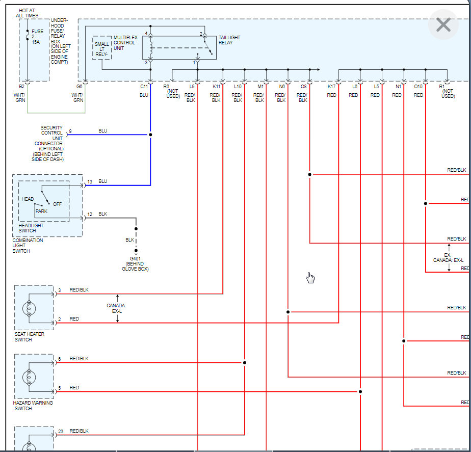

Check fuse number 2 (15 amp) in the fuse box under the hood. It powers the dash lights. It also powers the taillights and markers. If those are working the it is likely to be a bad dimmer control.
Aug 24, 2017 at 3:16 PM
WHITNEY ROYSTER
  • 16 POSTS
I've adjusted the dimmer switch and they're still out. Pretty sure the tail lights and signals work, but will double check when my husband gets home. If it's a bad dimmer switch I'm assuming I'll have to take it in? Not sure that is something I can tackle.
Aug 24, 2017 at 10:00 PM
  • 55,433 POSTS

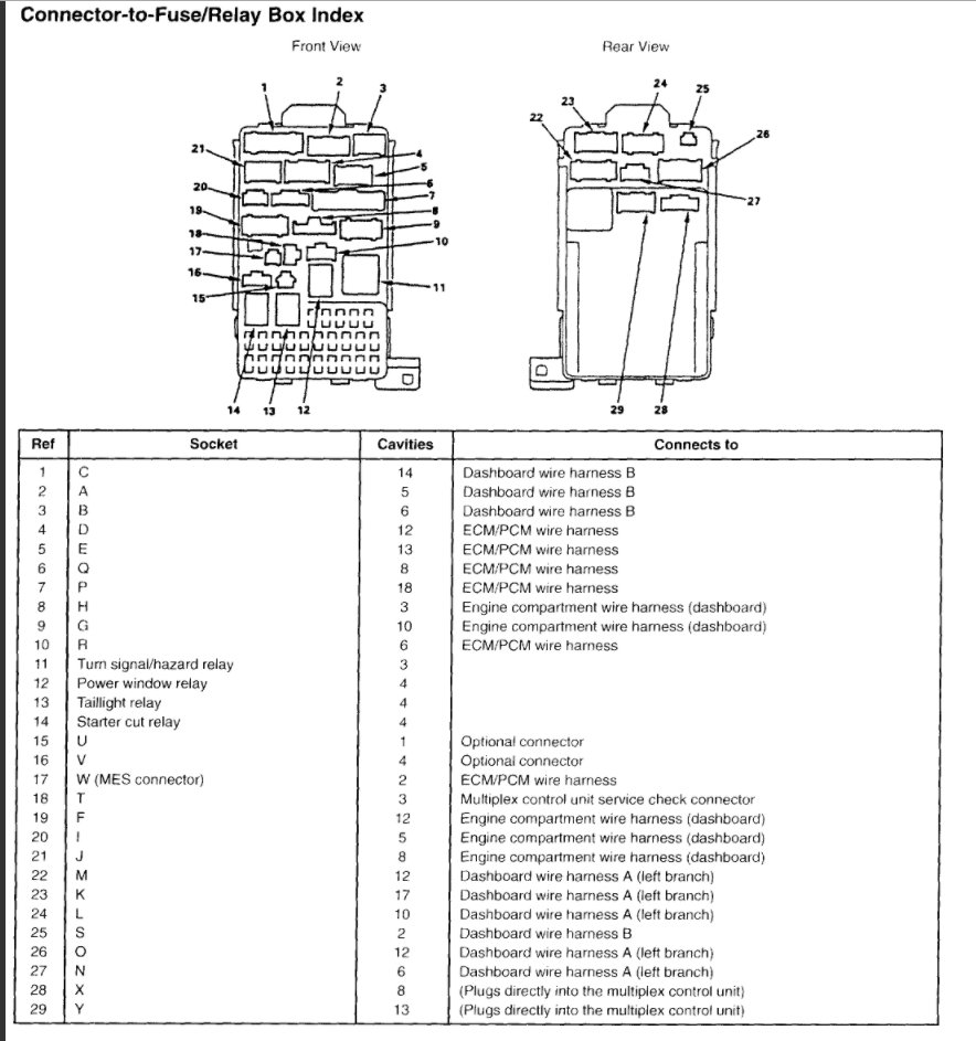

O good thanks for the extra information :) there is a taillight relay that sounds like it is out which controls the lighting system. Here is a wiring diagram and the location of the relay with a guide to help confirm the problem.
and

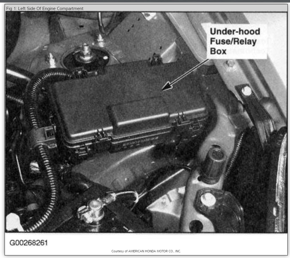

The relay is #13 in the under hood fuse panel
Here it is for $9.00 on Amazon
https://www.amazon.com/gp/product/B001UEHMCO/ref=as_li_qf_sp_asin_il_tl?ie=UTF8&tag=2carprcom-20&camp=1789&creative=9325&linkCode=as2&creativeASIN=B001UEHMCO&linkId=55d2082e0ad49a5b70e114a16bfa936a
Here are some diagrams so you can fix it. You can do it.
Aug 25, 2017 at 1:05 PM

Finally had long enough with the car... The tail lights do not come on when turning on the headlights so I'm fairly confident that the issue is the relay. The brake lights and signals do come on though. Do you still recommend replacing the relay? Or should I check that fuse as well? If replacing the relay I assume I'd just jump to step 14 of the how to you linked?
Thank you, Ken and Steve!
Aug 27, 2017 at 2:04 AM
WHITNEY ROYSTER
  • 16 POSTS
And just to confirm, that is relay #13 under the HOOD? Bc the diagram looks like it's under the dash.
Aug 27, 2017 at 2:05 AM
WHITNEY ROYSTER
  • 16 POSTS
Started with the fuse and this seems to have fixed the problem. Thanks guys!!

The fuse that keeps blowing powers more than just the dash lights. It powers the marker lights, tail lights and pretty much all the interior lamps used for the dash and control switches.
BUT the good news is that with a hard fail like you now have a signal tracer or short finder will now work to help you find the issue.
When does the fuse blow? With everything off you install the new fuse, it blows instantly or it blows as soon as you turn on the lights?

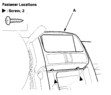

Got a saw??? OH you want to do it without damage...

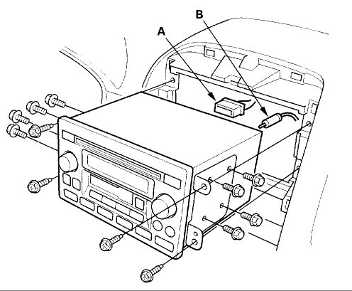

First make 100 percent sure you have the unlock code for the stereo. You will need it to make the stereo work when you put it back in. It will also wipe out the channel memory.
Once you have that you remove the center dash trim panel 2 screws and gently pull it away to free the connectors and remove the hazard switch connector. Then 4 screws let the stereo come out of the dash.

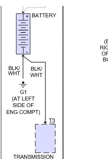

check battery to body ground it may be corroded and not connecting. also, check taillight grounds. ground for taillight is behind right quarter panel. See picture for battery ground.
Aug 3, 2020 at 8:15 AM (Merged)
WHITNEY ROYSTER
  • 16 POSTS
I'm having a similar problem. If there is corrosion, how do you fix it?

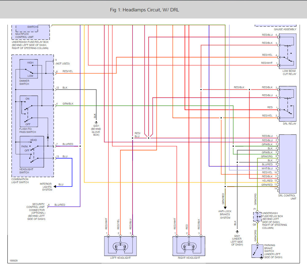

  • 55,433 POSTS
This sounds like a bad headlight switch. Here is a guide and some diagrams (Below) to help confirm and then repair the problem.
There are two relays that can cause the problem as well.
test through the switch
and

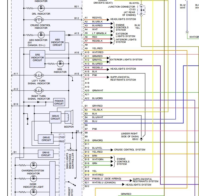

KYLE MENDES
  • 19 POSTS
I was changing climate control bulbs with LED's and while turning in one of the bulbs using a square drive (dumb idea) I shorted the circuit somewhere. Since then the climate lights, dash cluster lights, and radio lights all don't work when the headlights are switched on. The back lighting's there if the lights are off. I checked all internal fuses under the dash, nothing looks fried on the back of the cluster itself, and the one interior light fuse under the hood in that fuse box was fine also. My front blinkers work. I'm about to check my rear ones now since reading this post.
https://www.2carpros.com/questions/dash-lights-not-coming-on
Taillights are fine, so that rules out relay 13 right?

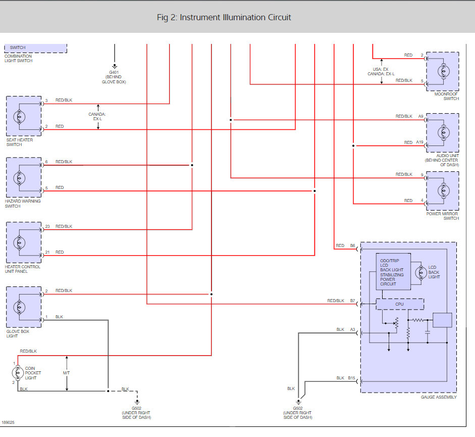

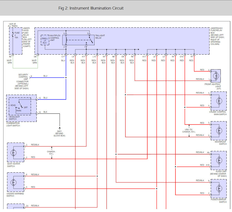

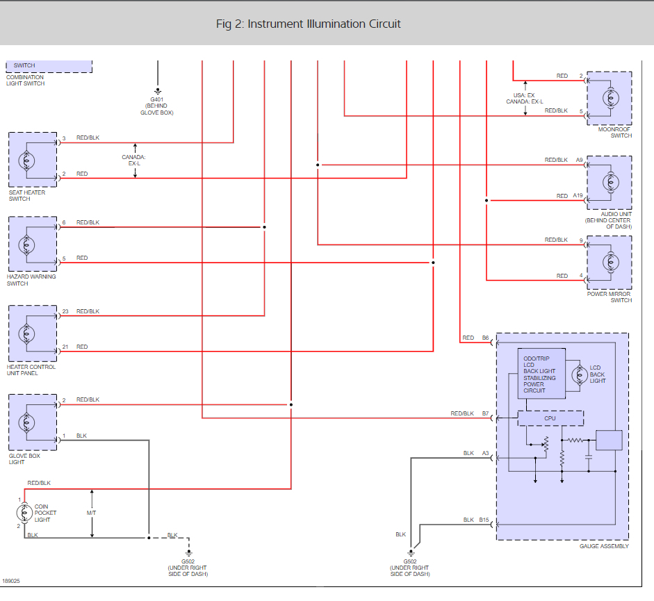

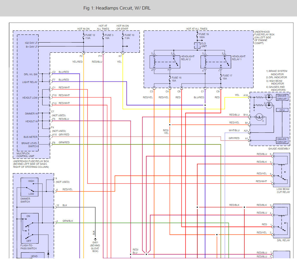

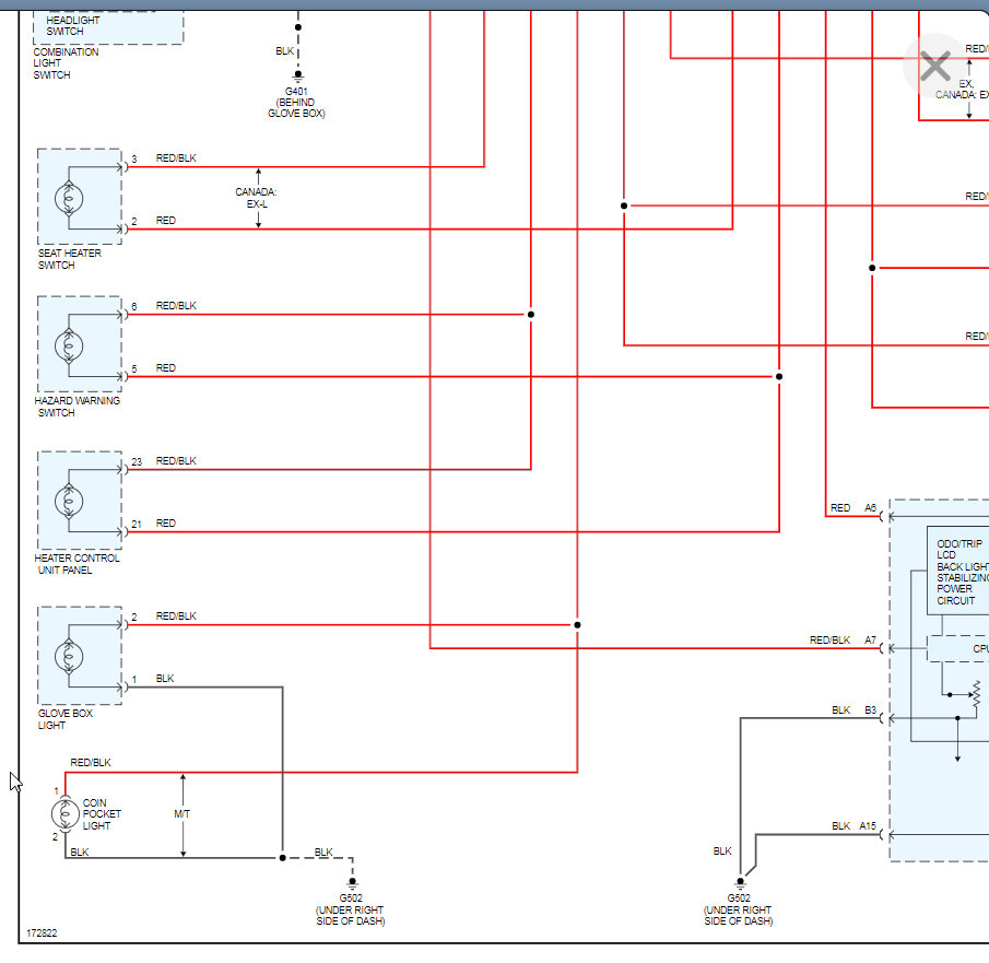

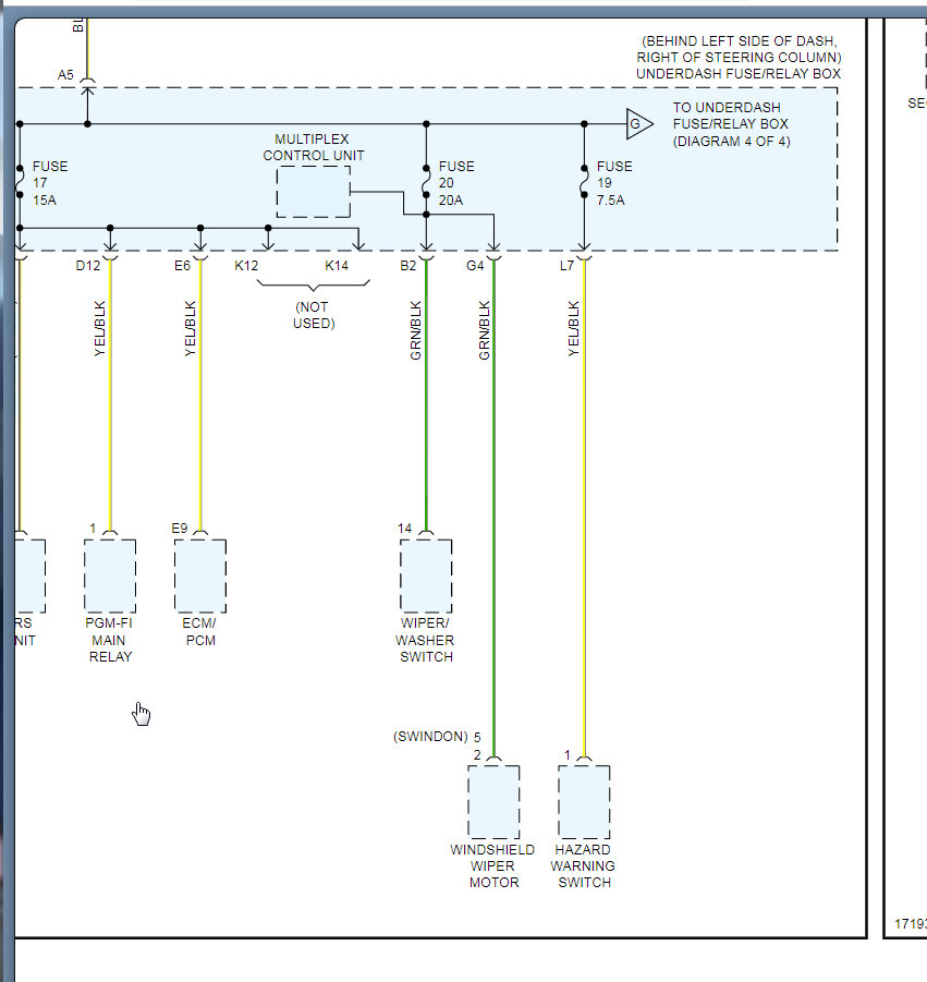

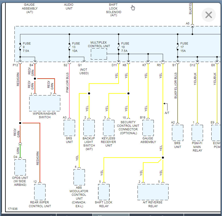

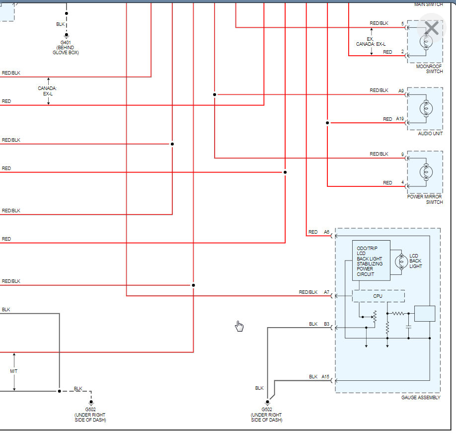

Your issue is most likely with the underdash relay box. If you follow the power wire back for each of the components you listed they are all feed by the underdash box.
Here are the wiring diagrams. Let me know if you have questions but I think you are on the right path because I think you shorted them out.
KYLE MENDES
  • 19 POSTS

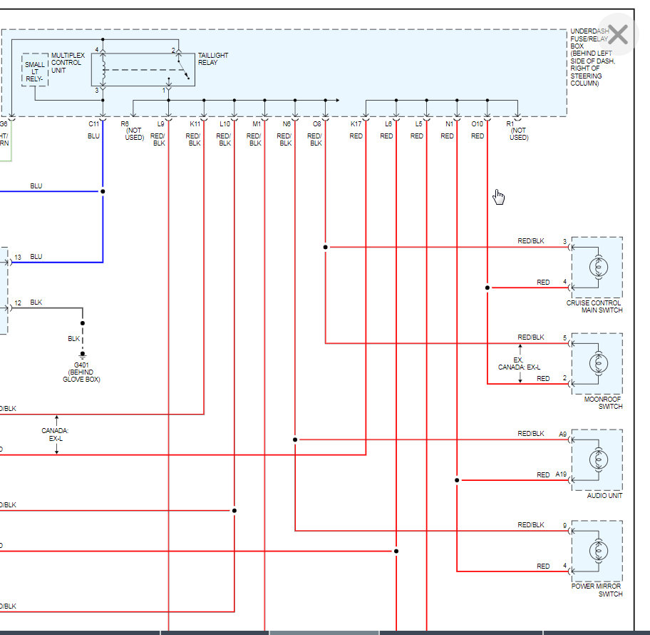

So by reading that diagram, as well as the fuse charts I've seen, I'm assuming the Headlight switch relay (since everything stops working once the switch is clicked on). I'm not clearly seeing which one that is. Also I'll note than when switching from parking lights to full headlights the "D" and "OD Off" lights flicker quickly.
As you can see in the chart, numerous things contribute to "gauge assembly". Is there a better way to rule this out? I know how to check fuses but relays are different. You have to connect them and feel for the switching right? Or is there a way to "jump" the terminals to then see if the panel works without the relay?
Here is a guide on how to test a relay:
When you are dealing with something like this, it is like a lightening strike and the only way to get through it is to test each component individually.

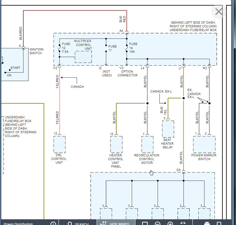

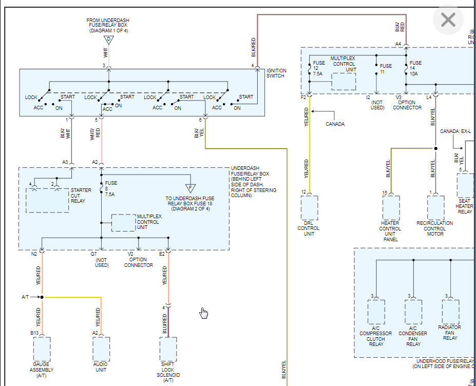

KYLE MENDES
  • 19 POSTS

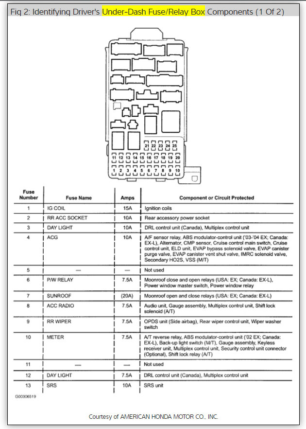

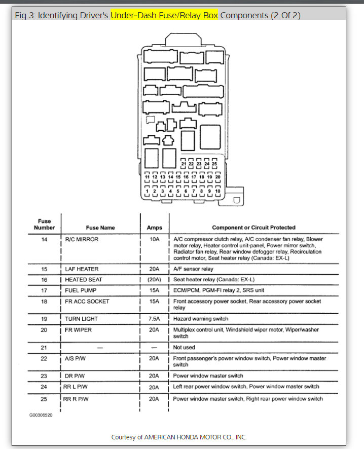

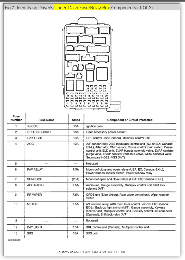

Okay, so I tested the relays with a simpler method I found (two terminals to the power source and the other two via resistance meter). The relays 13 and 14 (taillight relay and starter cut) were fine. 11 and 12 are turn signal and power windows, none of which were affected so I didn't bother with that.
Under hood fuses all check out.
Under dash fuses were all over the place. Unless I'm not understanding this, I used the circuit tester and 1,4,6,8,9,10,12,13,14,17,18,19,20,23,24 were all unlit. Only a handful lit up the light. This makes no sense to me since a lot of those fuses power things like the ignition coil, radio power, key-less receiver unit, power windows, etc. And those all work! what the heck am I missing? The wiring diagram you listed has the headlight switch connecting to the main circuit which feeds down into things like the heater controls and such. But there's no relay on the board for that. where is this relay? Or is that actually the headlight switch knob? and If so, how the heck do i test that?
looking at this wiring diagram I got elsewhere, also for 03 CRV, shows a link between B3 and A15 (which I think it s typo and should be A3 and B 15, because both show G502 which looking at both wiring harnesses, is ground. But if the ground is simply a screw somewhere, how can it be a bad ground from a light bulb shorting?
What position was the of the key when you were testing these fuses? It appears all of them are downstream of the ignition switch. Which normally means the key has to be on for these to have power.

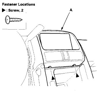

APMAN
2004 Honda CRV
how do you change dash lights on a 2004 honda crv
HONDA TECH 1818
  • 536 POSTS
1.Remove the driver's dashboard lower cover, then remove the instrument panel.
2.Place a clean shop towel under the gauge assembly to prevent scratching the steering column or dashboard.
3.Remove the three mounting screws from the gauge assembly.
4.Disconnect the connectors, and remove the gauge assembly and found the bulbs that needs to be replace.
5.Install the gauge assembly in the reverse order of removal.
