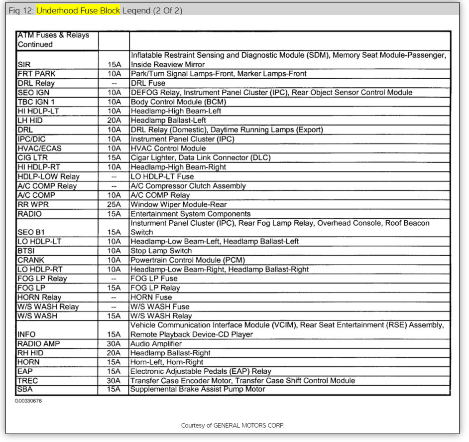

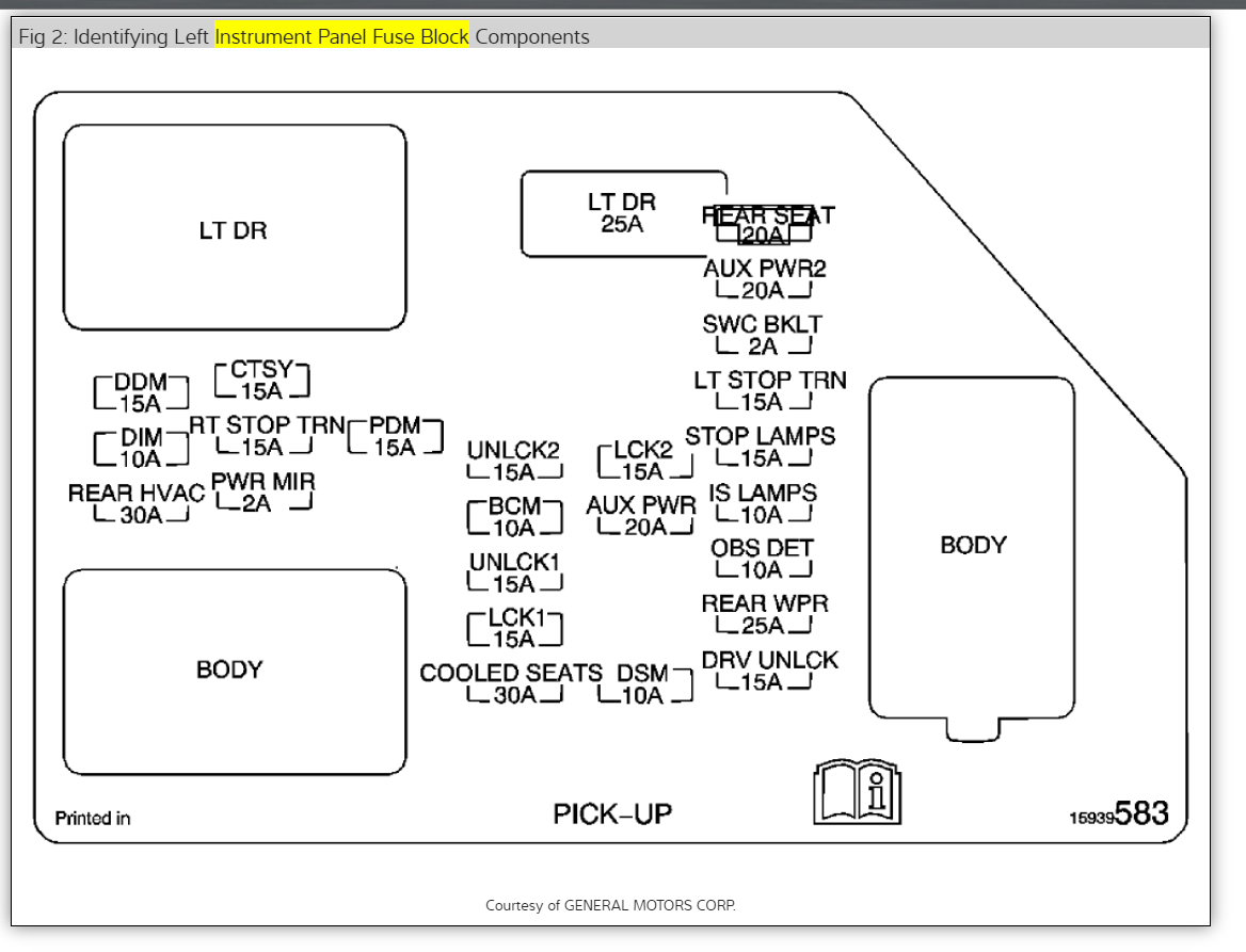

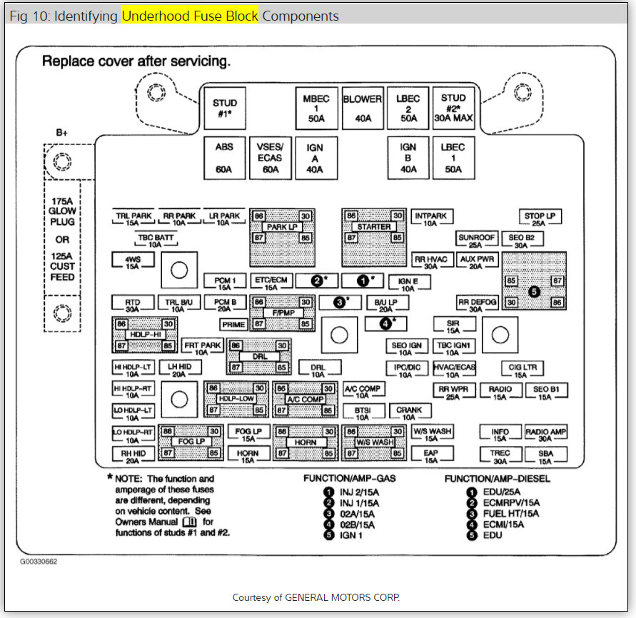

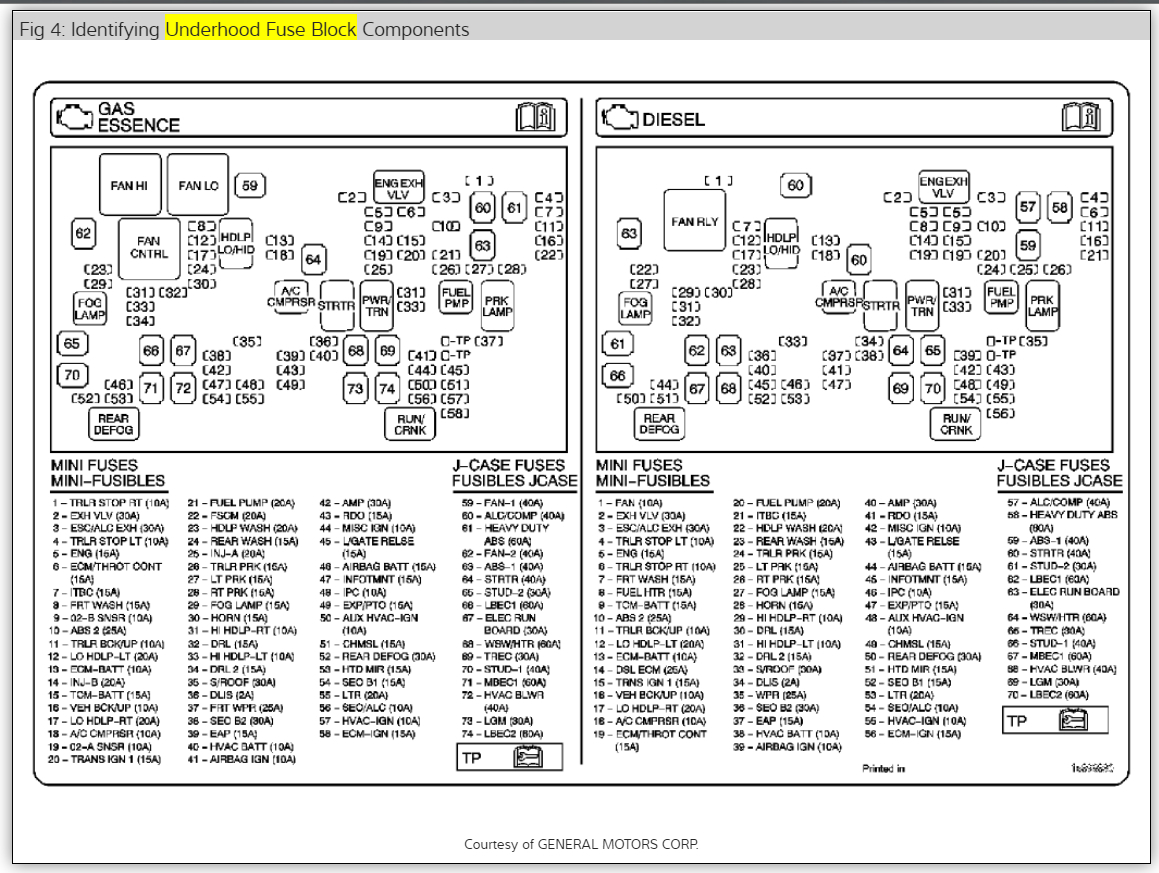

Fuse 48 in the under hood fuse box feeds the instrument cluster.
The data link connector receives power from the cigarette lighter fuse.
What you're experiencing was a common issue on these trucks where the data bus communication signal is lost between the IPC (instrument cluster) and other modules. Most often the cluster requires replacement. There are some rebuilding services on eBay for this.
Dec 20, 2020 at 7:57 AM
  • 55,224 POSTS
Here is how you can check the fuse and the fuse location. If the fuse is good chances are the cluster has gone out here is a video showing you how to change it out:

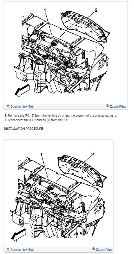

This is common when the instrument cluster goes out which is common by first lets check the fuses by using this guide.
If the fuses are okay I would replace the cluster which is easy. Here is a video to show you how.
https://youtu.be/_HEC44xENxw

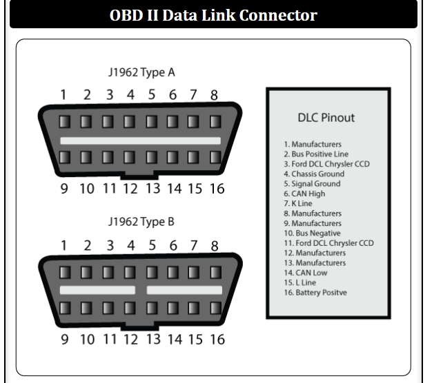

Good afternoon.
With the little information you have given me, it is hard to say. The fact that you cannot communicate with the ECM tells me you either have an issue with the serial data line or the ECM itself.
I would address this issue first as it may be the source of your issue. You need to unplug one module at a time and watch to see if you can communicate with any module. Time-consuming procedure but must be done before you can point a finger anywhere as to the failure. Is the check engine light on?
I do not like to guess and I know you have had a lot of recommendations but you need to start with basics to find the issue.
Check pin 16 in your connector under the dash for power.

Yes sir, I have checked for voltage out of the OBD connector under the dash and it shows 12 volts. I came to the conclusion of the BCM when I was looking for what I thought was a short. I took the positive side of the battery loose and held a multi meter to the negative side of the battery and it started showing voltage so I started removing fuses one at the time until I got to the BCM fuse. When I removed it the voltage at the negative post went to zero so I thought maybe that was part of my problem. So from there I removed the BCM and soldered it and it worked for a couple of weeks . The check engine light does work because it threw a code about three days into that two week period but I hooked up the scanner again and it showed no codes stored in the computer. The computer was actually the first diagnosis I had so I bought one and took it to an ASE certified shop in town to have it programmed. When I went to pick it up the guy at the shop told me he did not think it was the computer. When I asked him what he thought it was he said it could be a loose wire. So I asked him if he would mind looking at it. He said sure no problem. So I took it back to him the next day and for nine straight days I left it all day for him and he never looked at it again. So that is how I wound up trying to fix it myself because I could not get anyone else to help me. So I have been going solo on this thing for a couple of months. I have learned a lot but I do not quite have it figured out yet. And I want to thank you for acknowledging this I know I am not much help but I thought I would give it a shot and see. There is not much I have not tried with the limited knowledge I have. But that is how I came about this site.
Jun 2, 2021 at 5:40 AM (Merged)
Okay, got it.
You need to start where I told you by disconnecting the modules one at a time until your scan tool will communicate.
lets see which module is not allowing communication.
Never remove the positive cable first. The rule is negative off first and back on last to prevent voltage surge to the modules.

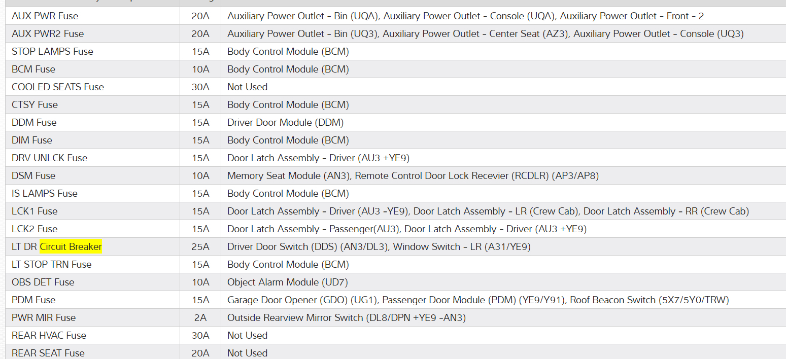

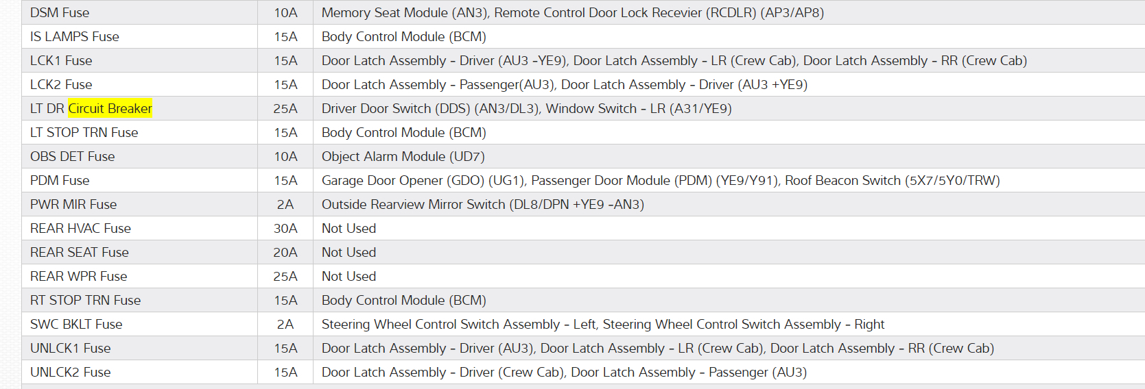

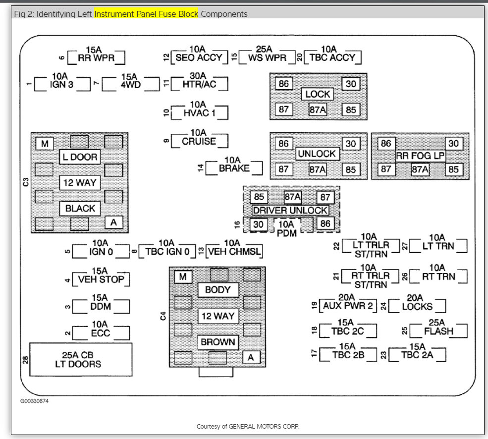

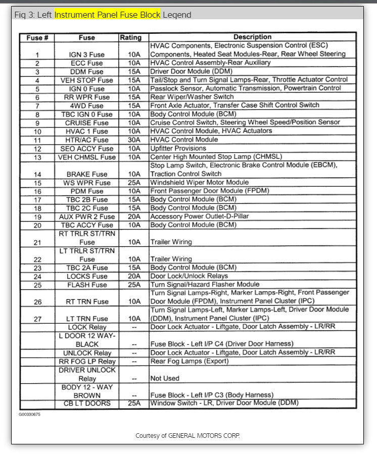

DOCFIXIT
  • 18,828 POSTS

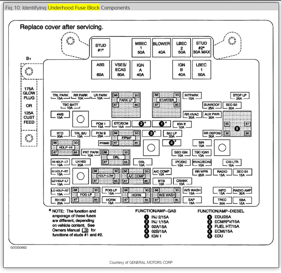

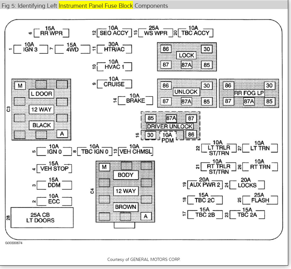

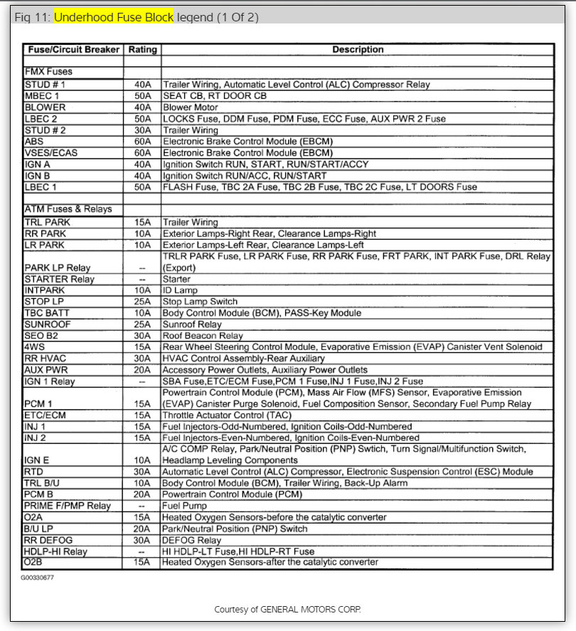

Underhood fuse box check fuse IGN E and IPC/DIC here is a guide with the fuse location in the diagrams below.
Check out the diagrams (Below). Please let us know what you find. We are interested to see what it is.

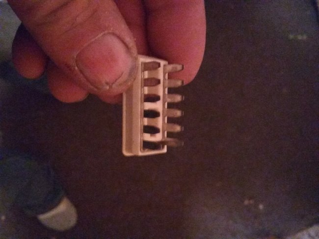

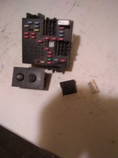

327W2ND
Thank you for letting me post on your site to 2CarPros. This morning I decided to go to a salvage yard that had 2004 Chevrolet Silverado. I told him what I was in search of and asked him if I could go dissect one of the trucks and I was correct somebody had taken the splice pack out of the connector in my truck. so it harvested the one at the salvage yard and I scored a couple extra parts to for $42.00 I'm relieved. thank you guys I'm just in hopes when I put it in all is good.
  • 55,224 POSTS
That is a good one, it looks like it might be heated on one side of the connector? Please let us know if that fixes it.

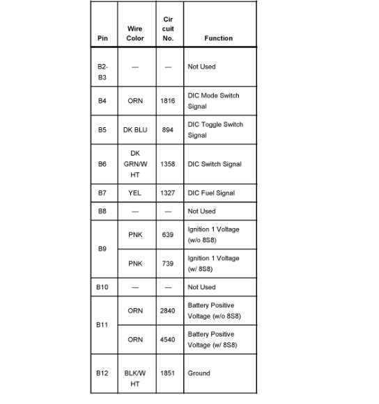

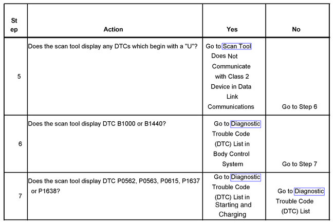

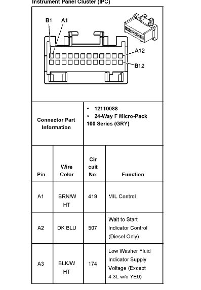

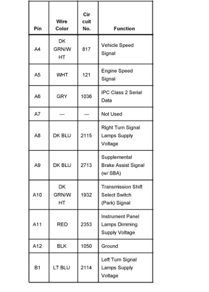

  • 110,240 POSTS

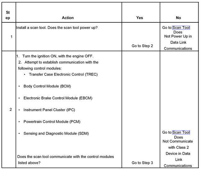

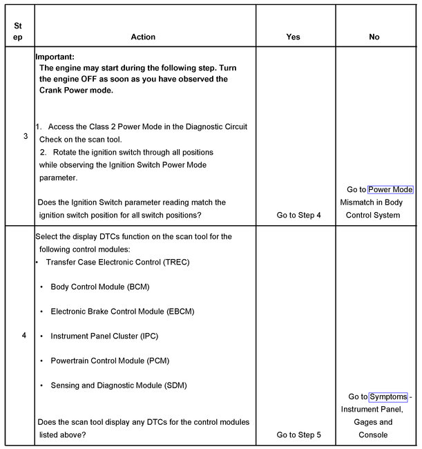

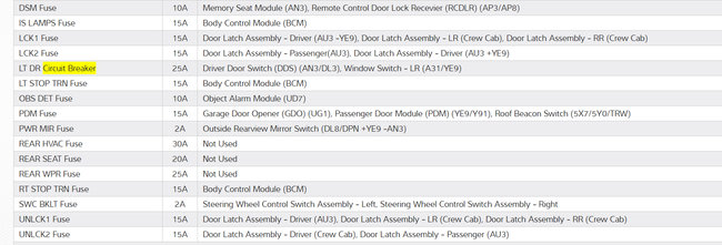

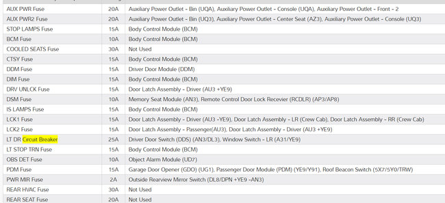

A lot of the instrument clusters failed and needed to be replaced. With that being said, you need to run a diagnostic check on the one in the vehicle to determine if it is bad. Based on your description, I believe the internal circuitry has shorted causing the high beam light to get power all the time but not nothing else is getting power.
To test the cluster requires a scanner. I don't know if you have one, but if you look through the three pictures I attached, you will find they are the instrument cluster diagnostic flow chart. I am attaching them for you in case you have a scanner or have access to one. Also, the following correlates with the test.
The numbers below refer to the step numbers on the diagnostic table.
2. Lack of communication may be due to a partial malfunction of the class 2 serial data circuit or due to a total malfunction of the class 2 serial data circuit.
The specified procedure will determine the particular condition.
4. The symptom list in Symptoms will determine the correct diagnostic procedure to use.
5. The presence of DTCs which begin with "U" indicate some other module is not communicating. The specified procedure will compile all the available information before tests are performed.
If you are able to perform the test, let me know the results so I can further advise you.
Let me know if you have other questions,.

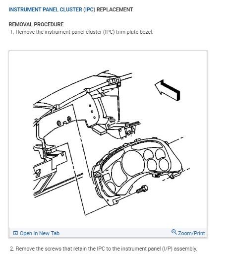

  • 110,240 POSTS

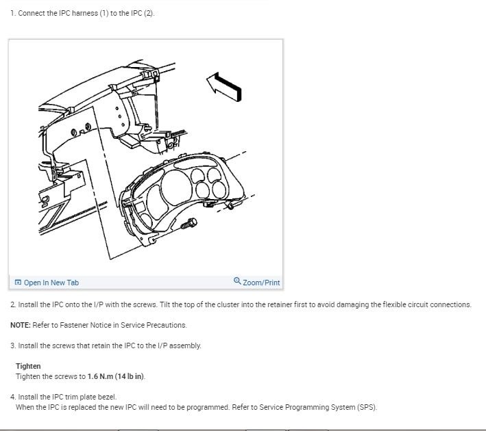

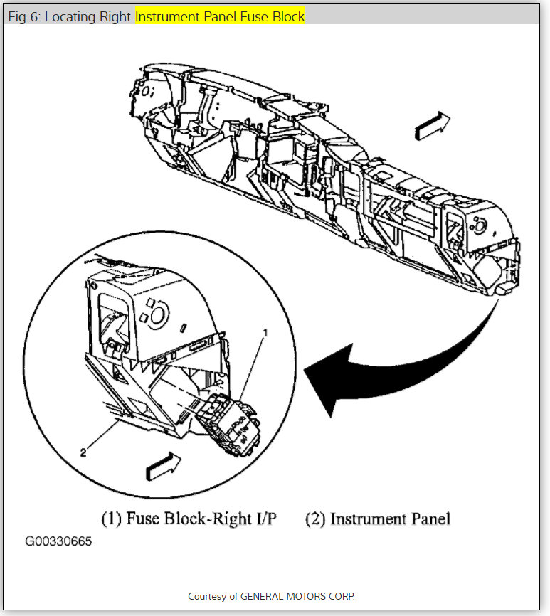

The instrument clusters in these trucks had alot of issues, you may need to replace it. You should be able to do it at home if you have a small amount of mechanical ability
See the attachments below for instructions on how to change the gauge cluster.

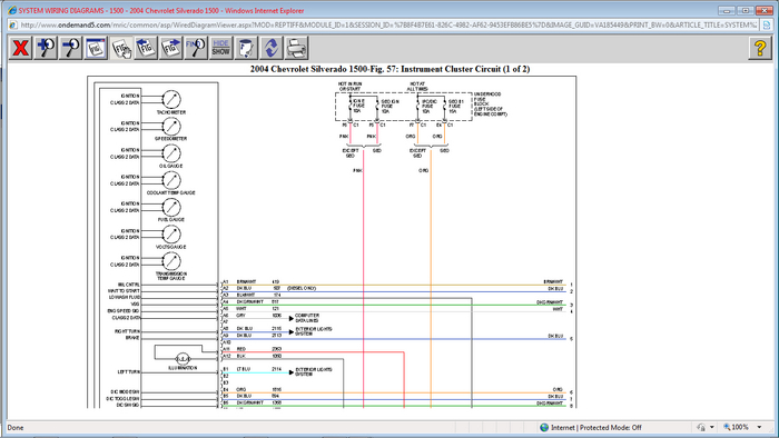

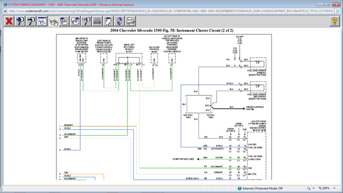

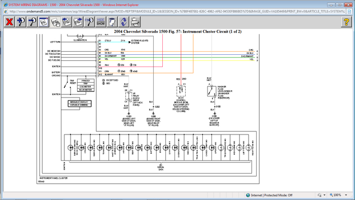

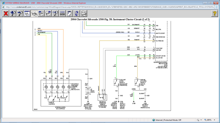

RIVERMIKERAT
  • 6,110 POSTS
Check the wiring and fuses. Pay special attention to instrument panel grounds. I have attached the schematic for the instrument panel. Each page is in 2 parts for clarity.

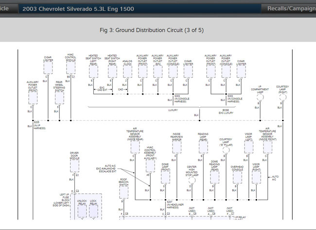

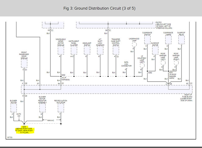

SCGRANTURISMO
  • 4,897 POSTS

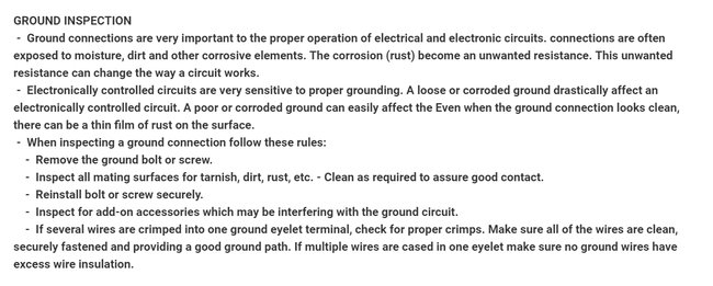

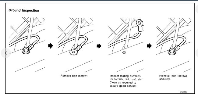

This could be a problem with ground #200 which is located behind the right side of the dash near the "A" pillar. Today's modern vehicles have a lot of electronics and electrical systems on them. People tend to focus on the power side of circuits but forget that it is only 1/2 of the circuit. The ground side of the circuit is the other half. In fact 75% of all vehicle electrical problems are poor or bad grounds. Because of the many electrical circuits in today's vehicles, they will share a common ground, so if the ground goes bad, it will effect many systems. In the diagrams down below I have included a ground distribution wiring diagram for your vehicle as well as ground location and how to inspect a ground for your vehicle. Please go through these guides and get back to us with what you are able to find out.

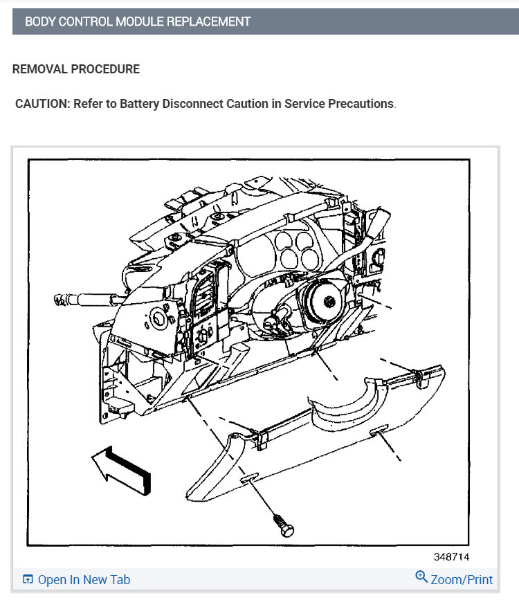

  • 55,224 POSTS

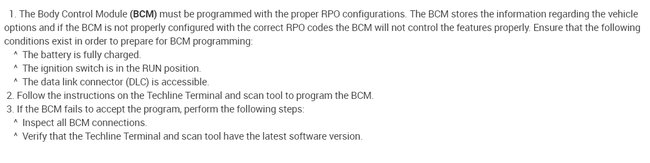

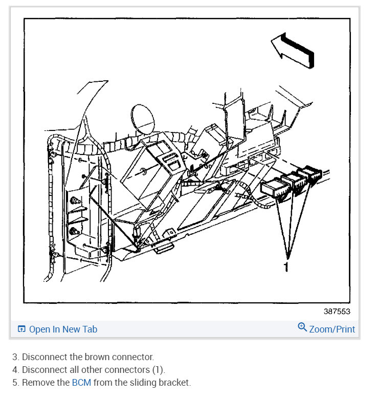

It sounds like the BCM is out. To be sure here is a video doing a CAN scan which is the future of car repair you can get one for about $50.00 on Amazon:
https://youtu.be/InIlnsjOVFA
Here is how to replace the BCM in the diagrams below in case you need it. Check out the diagrams (below). Please let us know what you find. We are interested to see what it is.
