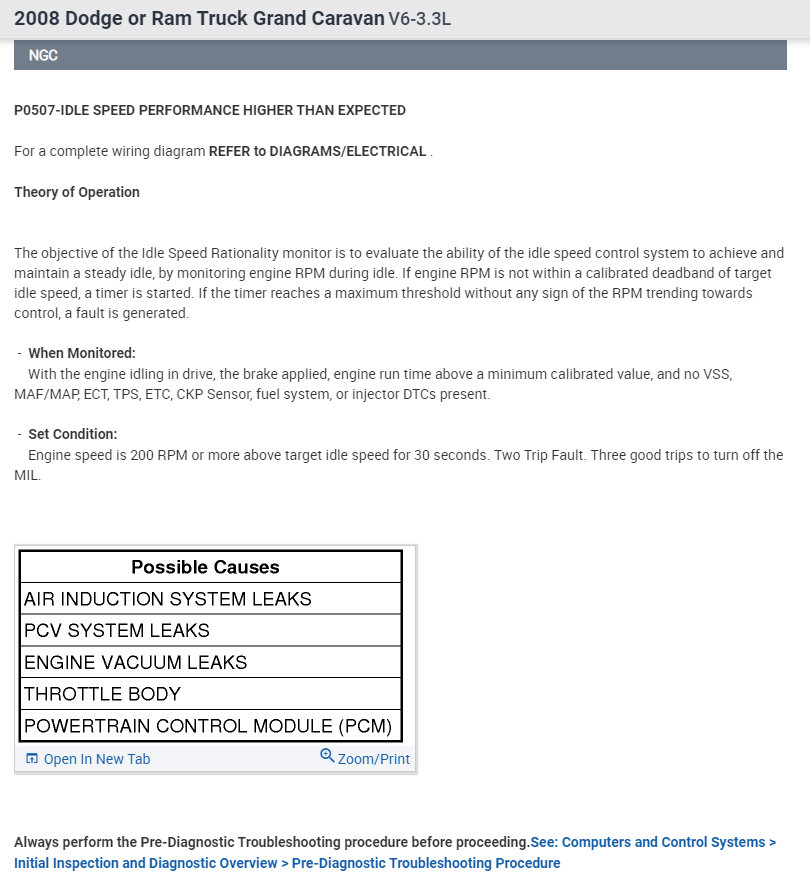

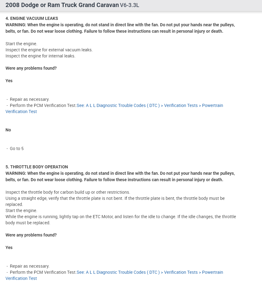

Will driving the "ETC" lightning bolt symbol will come on followed by "ESP" car wavy lines symbol. Car engine will "rev" a little high and surge in power on/off.
It will reset if the ignition is turned off, wait a minute or two and restart engine, lights clear off dash and van drives fine.
Also have a reoccurring "check engine" light. Ran a scanner on it, p0507 is the trouble code it reads.
What do i need to do to fix these?
Thanks

The traction and stability control lights can get triggered when the system detects any faults within any of the components. It could be a wheel speed sensor, wiring issue or even a module. These are primarily related to the ABS system of the vehicle.

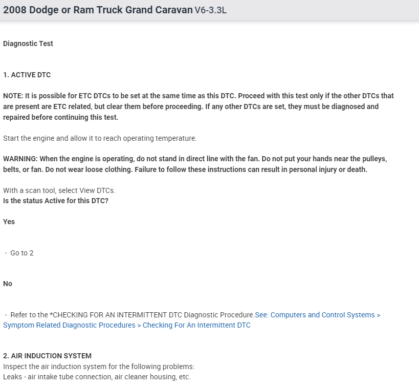

A good first step would be to scan the vehicle and retrieve the codes for the system.
https://youtu.be/rTtAnsOlZU4

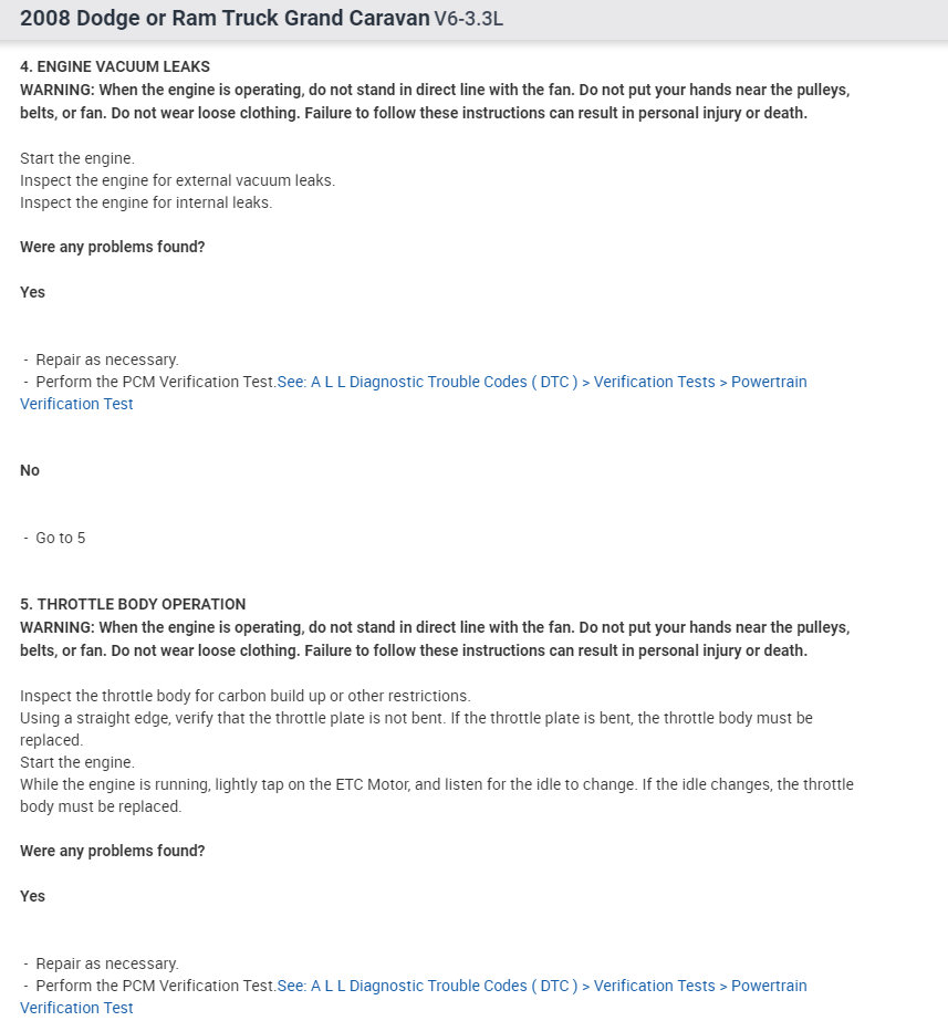

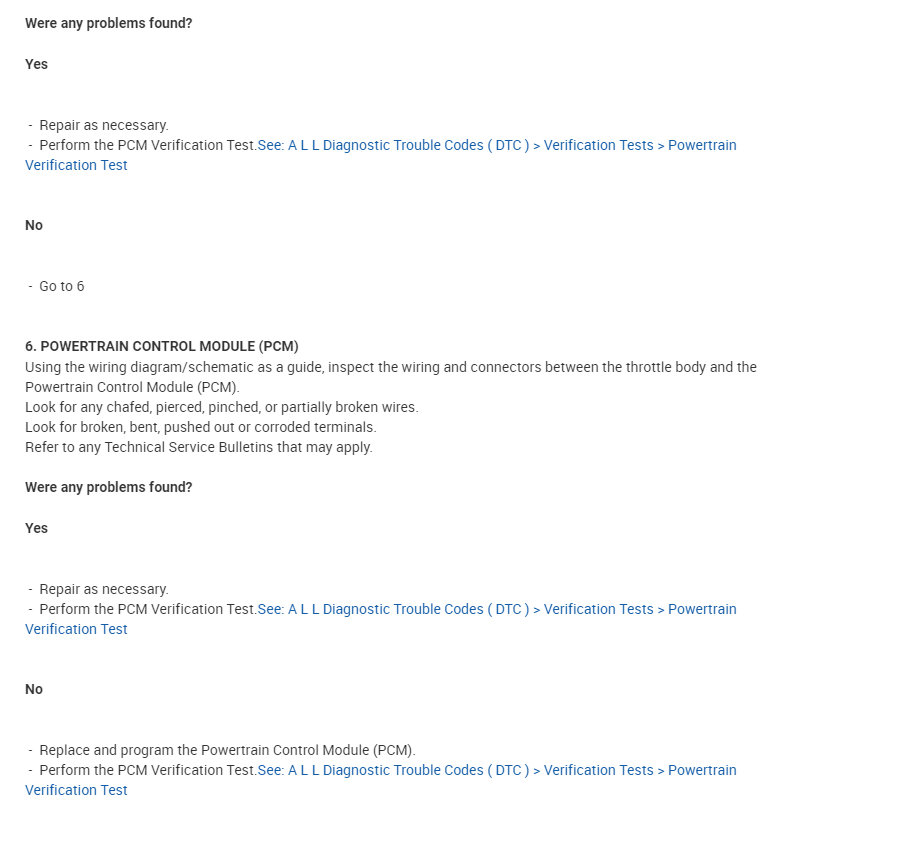

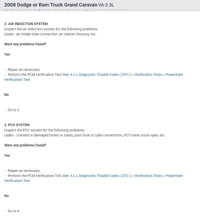

As for the P0507 code, it is typically due to issues with the throttle body, leak in the air intake system, vacuum leak, or even the PCM.
I have attached the trouble shooting steps for the code P0507 below. Follow those steps as it can help you determine the issue.
Let me know of any questions.
