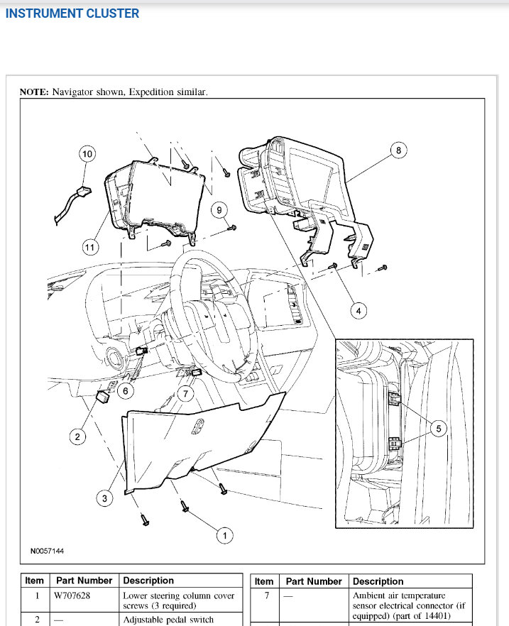

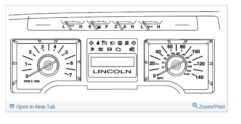

Dash light cluster went out above oil and battery gauge. Now the speedometer lights that illuminate the mph range from 70 MPH to 100 MPH went out.
What is the fix?
Dec 23, 2022 at 5:50 AM
  • 54,832 POSTS

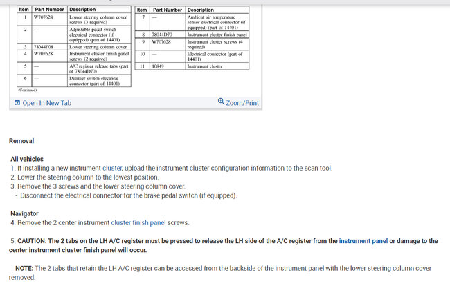

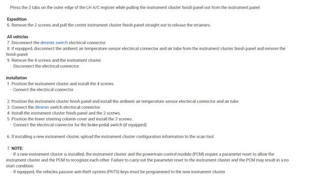

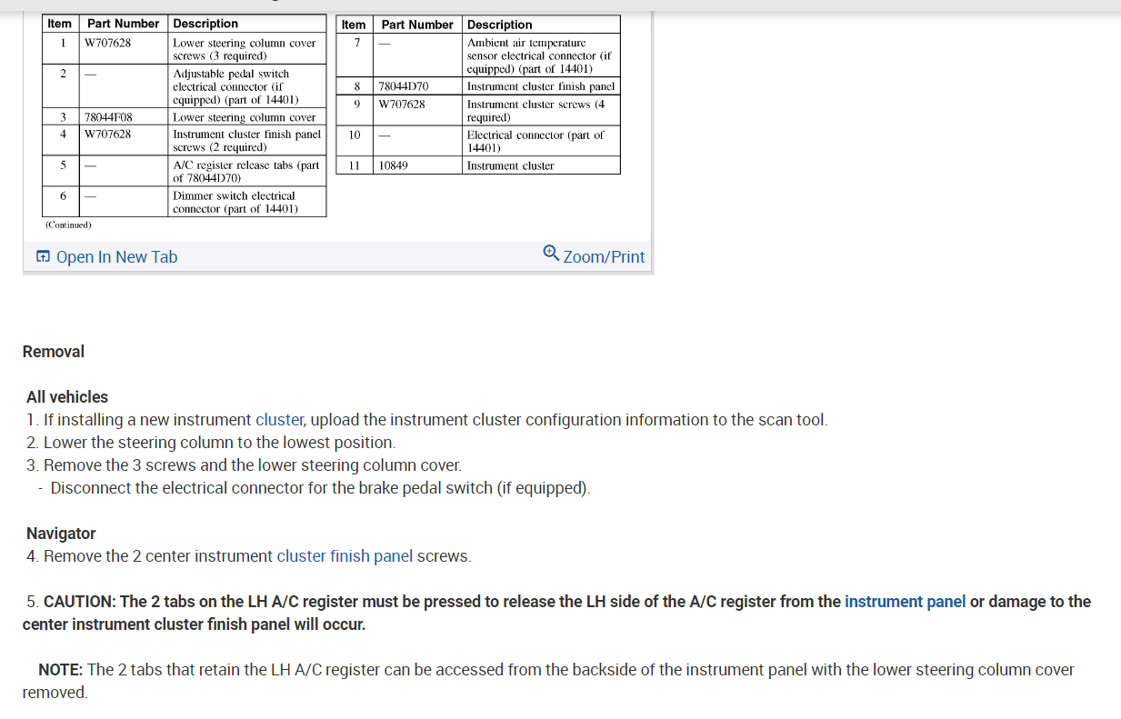

You will need to remove the clusters and replace the lights, which is not that hard to do. I have included instructions on how to do the job in the images below. The bulbs are at the rear of the cluster gently turn them counterclockwise to remove. Check out the images (below). Let us know what happens and please upload pictures or videos of the problem.
