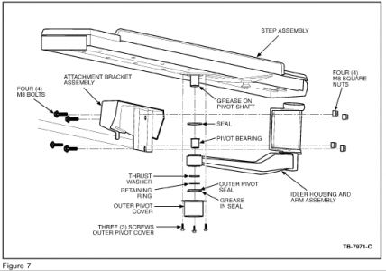

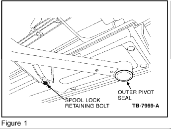

Remove the two spool locks from the guide tracks by removing the spool lock retaining bolts (Figure 1) and test the system again. If the system moves freely with the spool locks removed check spool lock or arm track for damage and replace damaged part. (2) If torque greater than 4.0 Nm (35 lb-in) must still be applied to move the running board, the issue is most likely in the drive arm or idler arm. Remove the running board assembly from the vehicle, refer to Workshop Manual Section 501-08. Remove the four bolts that secure the drive unit to the running board. With bolts removed, manually compare the drag of both the drive arm and idler arm. If drag is excessive in either arm, replace the appropriate arm. Refer to REMOVAL AND INSTALLATION. REMOVAL AND INSTALLATION NOTE THE RETRACTABLE RUNNING BOARD MUST BE REMOVED FROM THE VEHICLE IN ORDER TO REPLACE THE IDLER OR DRIVE UNIT. FOR ADDITIONAL INFORMATION, REFER TO WORKSHOP MANUAL SECTION 501-08

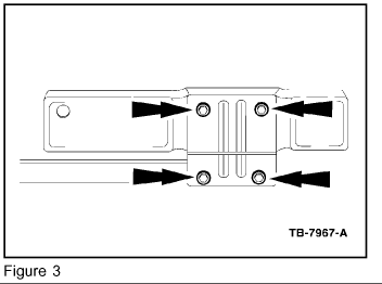

2. Remove the four (4) bolts that secure the drive and idler assemblies to the board (Figure 3).

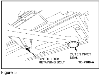

4. Remove the outer pivot seal (Figure 5).

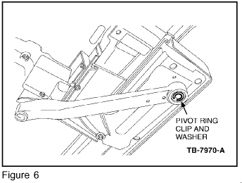

5. Remove the outer pivot ring clip and washer (Figure 6).
https://images.2carpros.com/forum/automotive_pictures/248015_Running_Board_7_1.jpg
. Before installing the new drive and idler unit, be sure that the seal is present and in the proper orientation, that the bushing is present in the pivot bearing, and that the outer pivot shaft is greased. (See Figure 7 for reference) 7. Install the drive and idler assemblies. NOTE BE SURE TO INSTALL THE THRUST WASHER BEFORE INSTALLING THE PIVOT RING CLIP, AND BE SURE THERE IS GREASE IN THE PIVOT BEFORE INSTALLING THE OUTER PIVOT SEAL. 8. If installing the idler assembly, be sure to set the height of the idler to the same gap that was measured in Step 2 above.

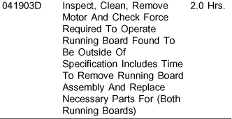

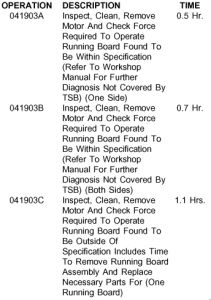

OPERATION/DESCRIPTION/TIME WARRANTY STATUS: Eligible Under Provisions Of New Vehicle Limited Warranty Coverage DEALER CODING CONDITION BASIC PART NO. CODE 16B472 41
