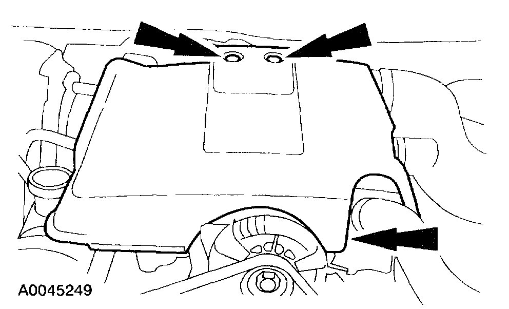

1. Disconnect the battery.
pic 1
2. Remove the screws and the engine cover.
pic 2

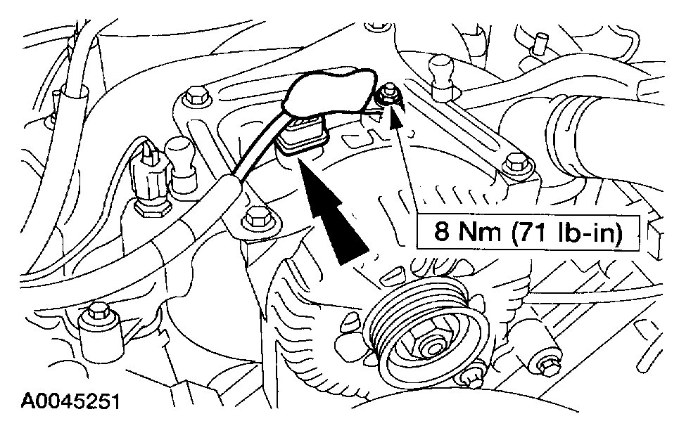

3. Loosen the clamp and remove the intake induction resonator.
4. Release the tension and remove the accessory drive belt from the generator pulley.
pic 3

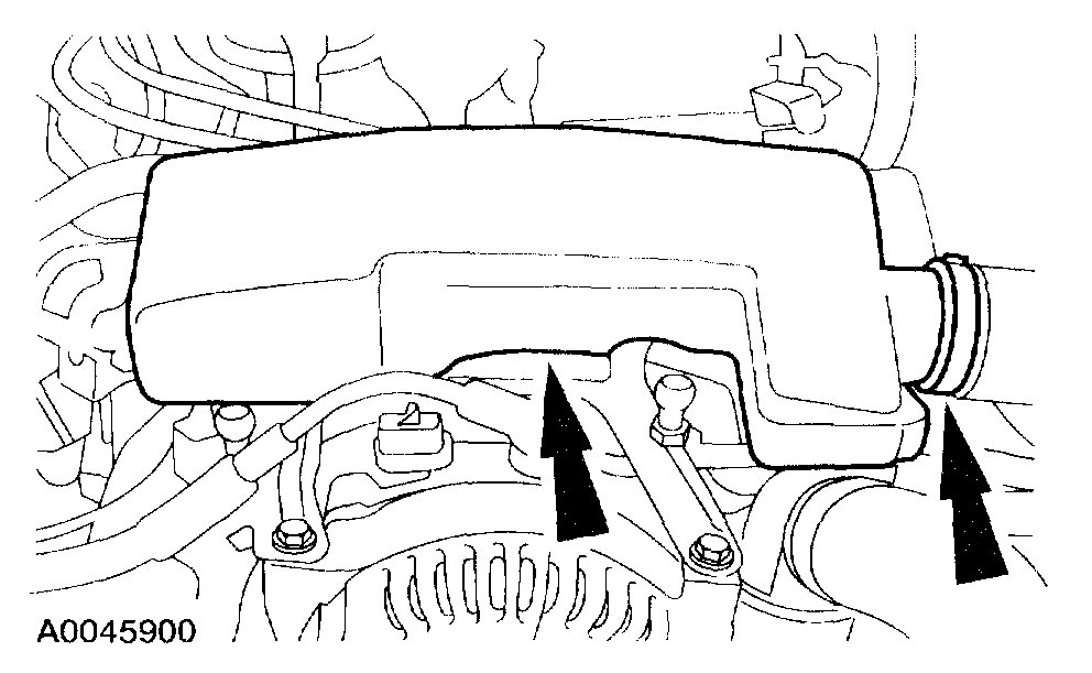

5. Remove the nut and disconnect the generator electrical connectors.
^ Position the cover aside.
pic 4

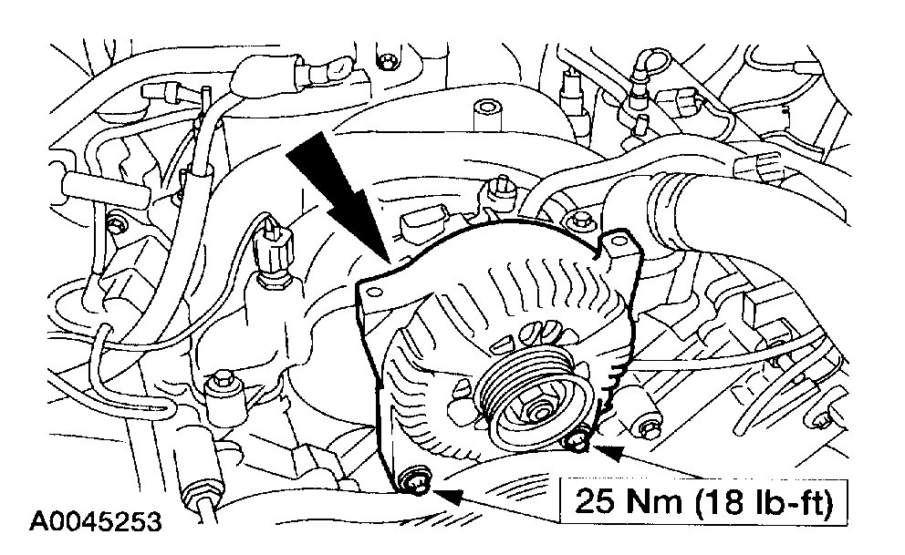

6. Remove the bolts and the generator bracket.
pic 5

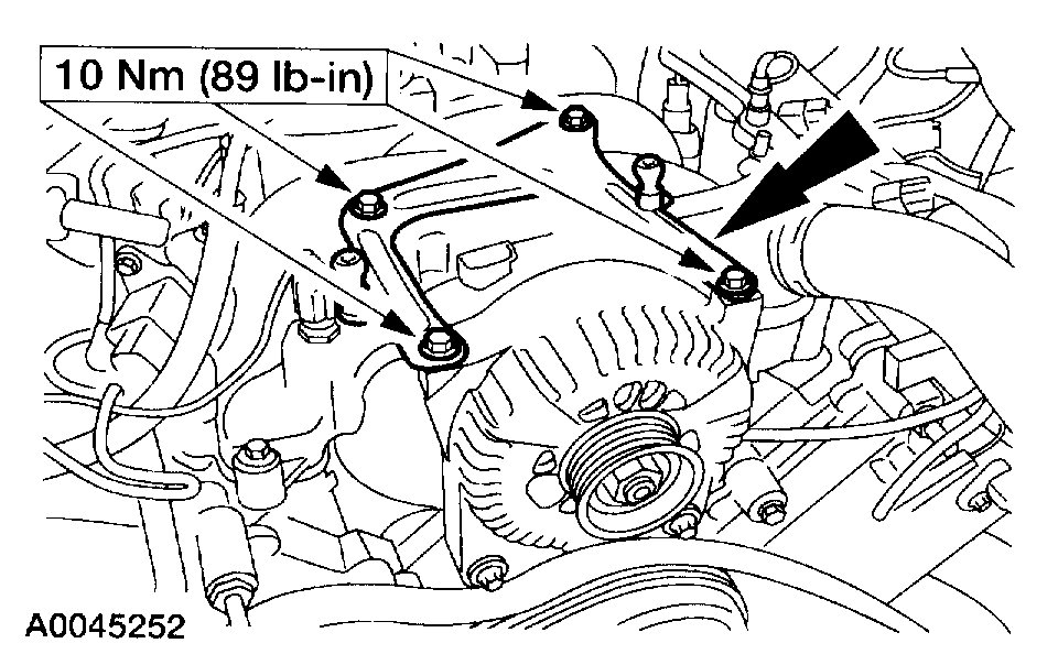

7. Loosen the bolts and remove the generator.
INSTALLATION
1. To install, reverse the removal procedure.
