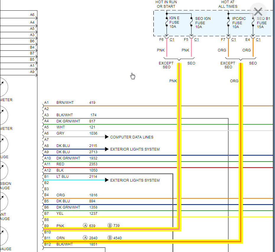

So to figure out why the good parts won't work in your vehicle we need to start with actually checking for voltage on the two wires highlighted on the wiring diagram. The pink wire will only have voltage in run so just make sure you check it in that position.
You need to check it at the cluster connector so we can see if the power is actually getting to the cluster.

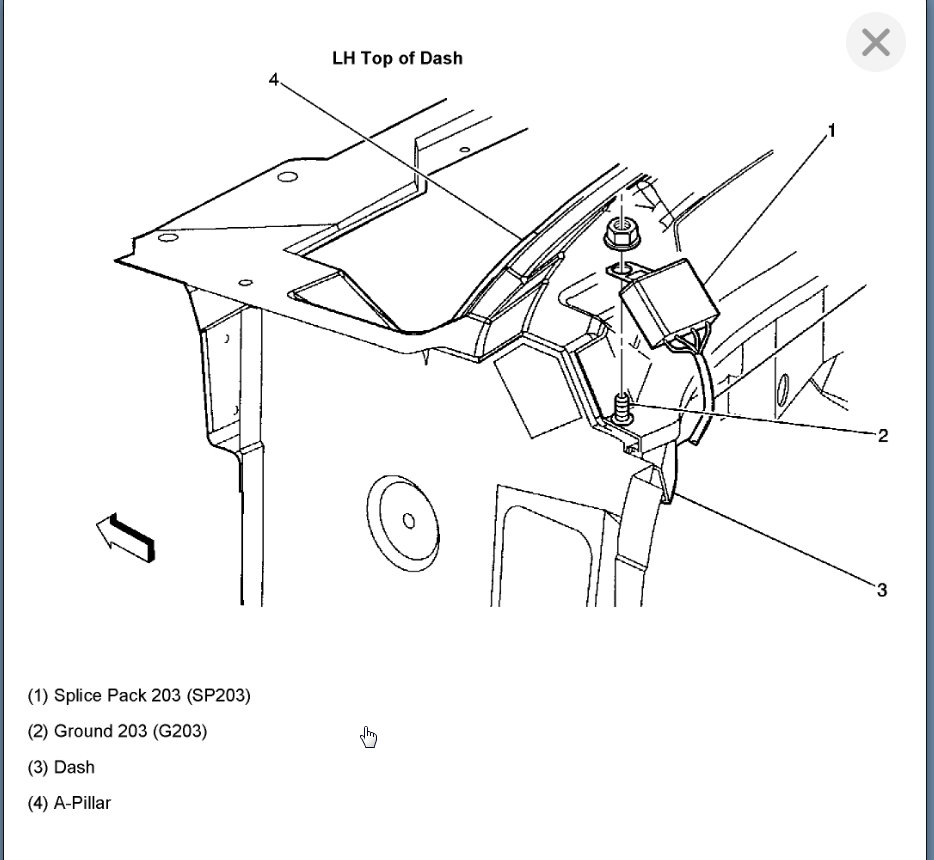

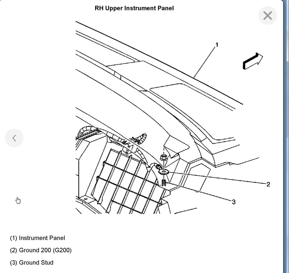

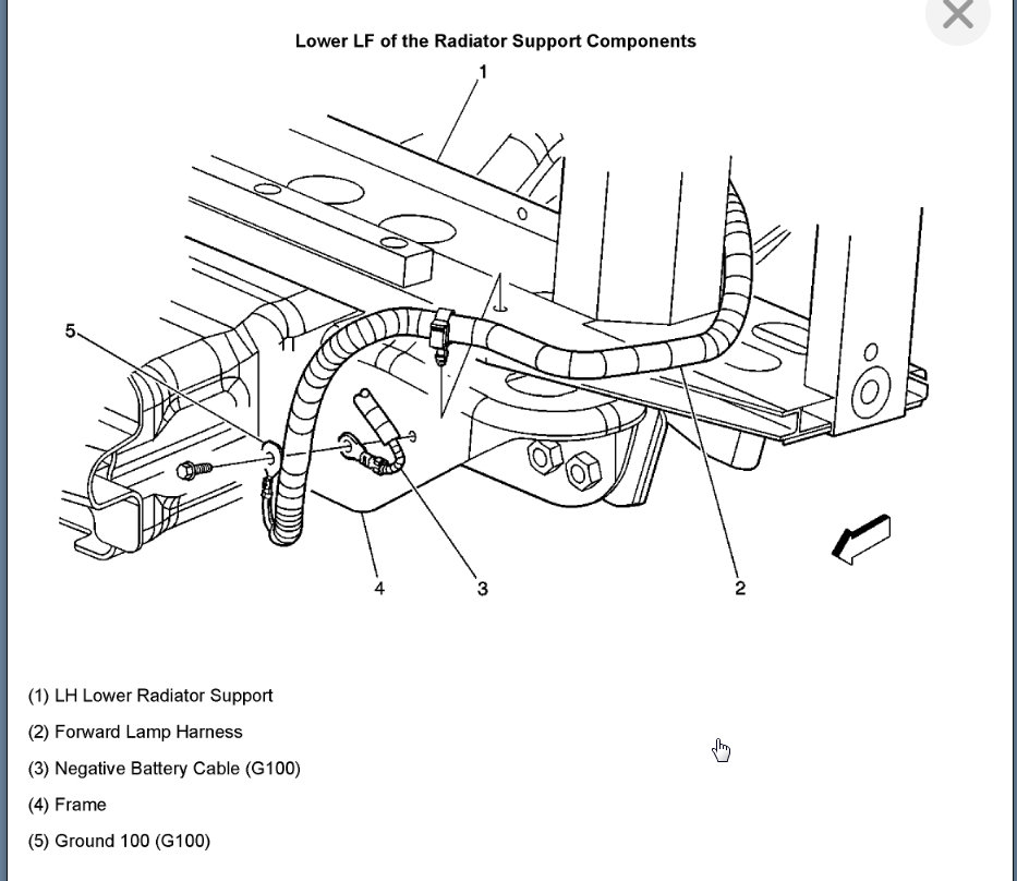

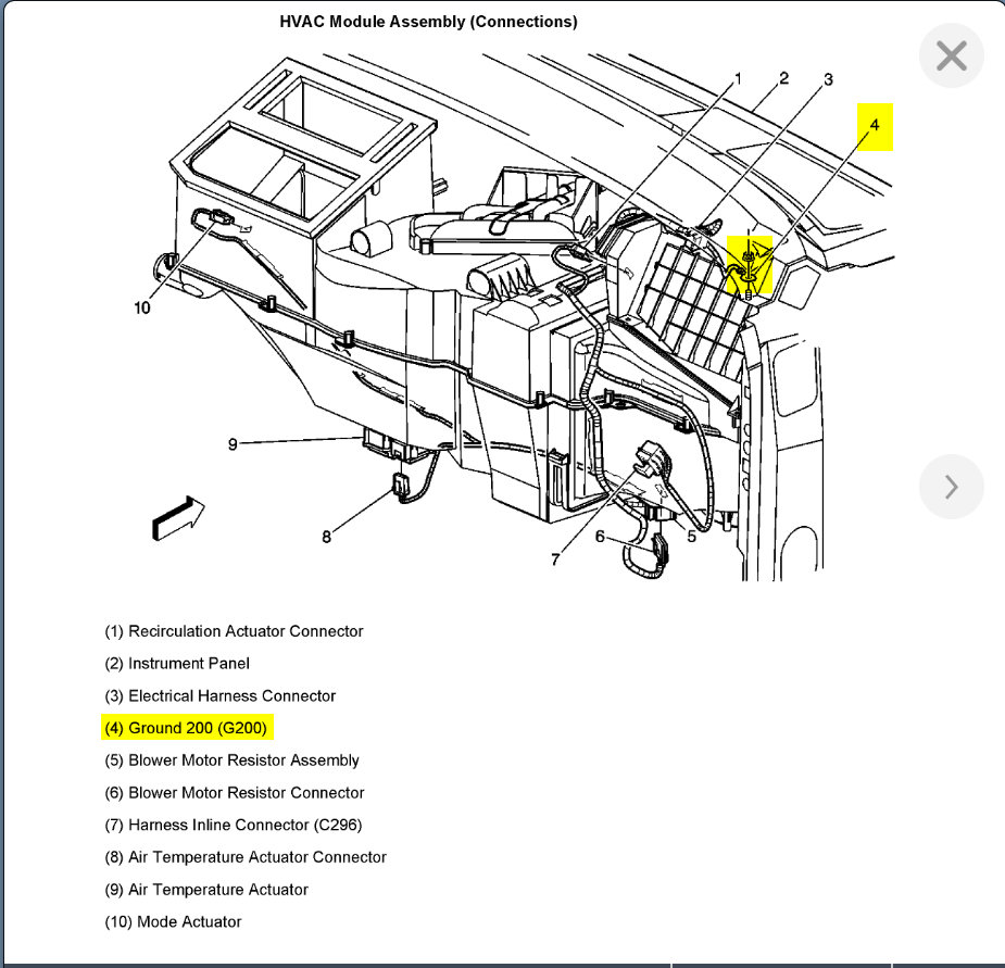

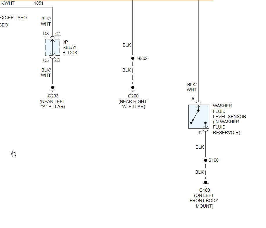

Which ground wires have you cleaned? I know you said you cleaned them all but which ones specifically because the cluster has a couple grounds.
Oct 11, 2019 at 12:37 PM
KENHALL
  • 5 POSTS
I did the 2 under the drivers floor the one to the fire wall and the one on the radiator support. don't know of anymore.
Oct 11, 2019 at 1:53 PM
Okay. Here are a few more that we need to check that are for the cluster. If these check out then we need to make sure you have power coming into the cluster on that wiring diagram I provided last time.

I have power to the plug that goes to the cluster and all grounds under dash are good, but still have the same problem. also cluster is receiving data at the dataline on the ipc and dic.
Oct 16, 2019 at 6:53 AM
Okay. We are missing something because if that is the case it should be operating or the cluster is the issue. What were you voltages on the data-lines and which wires were they (color or pin location)?
