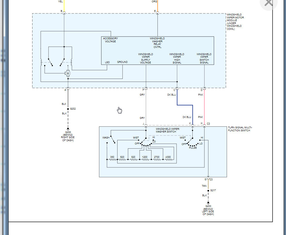

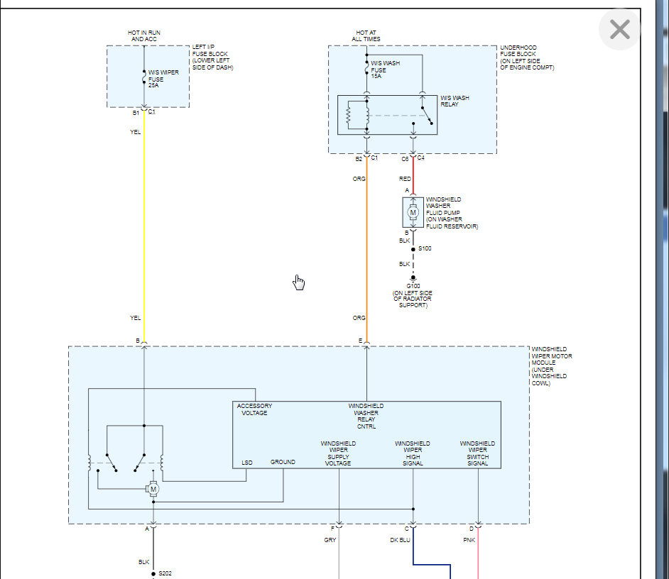

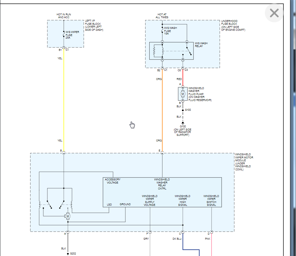

I have a 2003 Tahoe, left the window down and it rained. Now, my gauges work sometimes, sometimes not. Left turn signal, window controller (it's brand new) front blower motor (replaced the blower and resistor kit recently), and windshield wipers don't work. All fuses are good. Any ideas or help would be much appreciated. I also replaced the ignition key lock cylinder recently. Not sure if that info helps or not.
Sunday, October 25th, 2020 AT 9:16 AM
Assuming all these are related, we need to start with one of them and fix it and hope it fixes the rest. If it does not then we can just move onto the next one. Let's start with the wipers. I included a wiring diagram. We need to check the fuse and then follow the power through the system with the wipers turned on to find where we do not have the power. This will tell us what the potential issue is.
So let's check voltage at each component on the circuits shown and go from there.
+1
Wednesday, October 28th, 2020 AT 2:11 PM
MIKE DORSEY
That's awesome. Sadly, I'm an electrician of 21 years, just not familiar with vehicles at all. It's raining here because, well, Louisiana. But hopefully this weekend I'll have the chance to trace this out. I really think I'm losing the negative or ground somewhere, but haven't been sure where to even start. I'll post an update, or probably more questions, after I see what I can or can't find. Thank you very much for the info.
Thursday, October 29th, 2020 AT 5:58 PM
Okay. Great. So with your experience we can figure this out. To check the ground just use a test light and hook it to the battery positive and then go to the wiper motor and use the probe to back probe the black wire at the connector. The light should come on. If it does then you have a good ground connection from the connector to the ground bolt. It could still be the connection point but that is unlikely but not impossible.
The wiper motor is under the cowl which is the cover that is below the windshield. The piece that is between the hood and the windshield.
