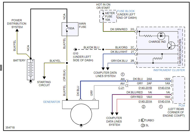

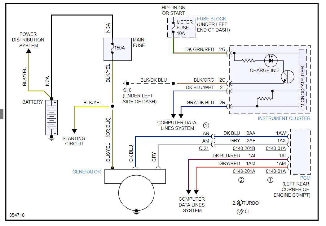

I will watch for your reply. Here are the alternator wiring diagrams so you can see how the system works. Check out the diagrams (Below). Please let us know what you find. Take care, Joe

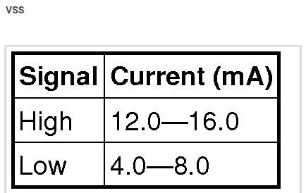

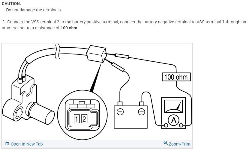

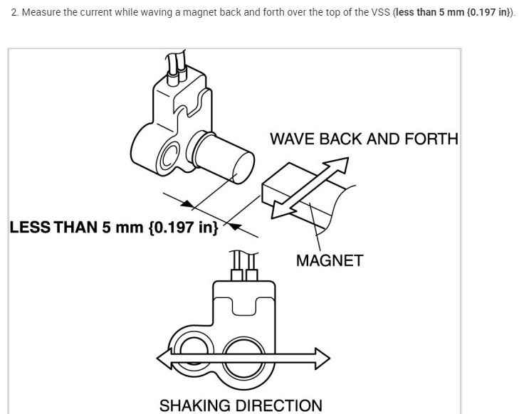

Here is a video that you should review on the speed sensors while I get the rest off the circuit:
https://youtu.be/InIlnsjOVFA
Tom. Here is the info to bench test your speed sensor:
Jul 17, 2020 at 8:03 AM
4DRTOM
  • 467 POSTS
This should also Helping getting the correct part on the motor.
Let me know how you do.

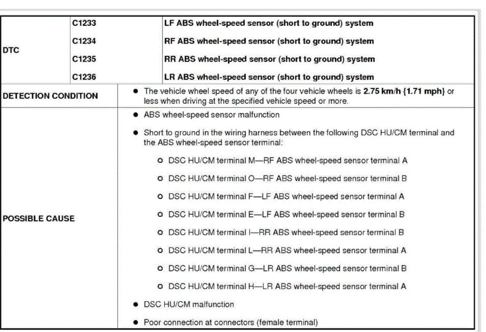

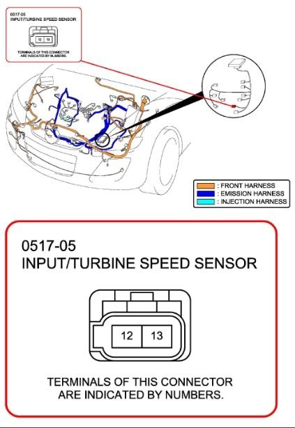

I had another car scan on my car by a mechanic he gave me these codes: c1222, u2023, c1236, c1234, p0500 and p061B. what I need to purchased to fix my car?
Jul 23, 2020 at 9:39 AM
  • 110,248 POSTS
These codes indicate different things. There isn't one part you can purchase to repair it. Further testing needs done. For example, the "C" codes you have are all related to a short in the ABS sensors. See pic 1. The first thing I would suggest is to simply check the connector at each of the wheel speed sensors to make sure they are not damaged. However, it is hard to believe they all went at once.
Next is the U2023 which is specific to the powertrain control module (PCM). This code specifically indicates that the correct information from the PCM can not be received.
Interestingly, the code is also tied into the brake (abs) system. So, if we lost the sensors all at once, it seem logical that the problem would be related to the PCM.

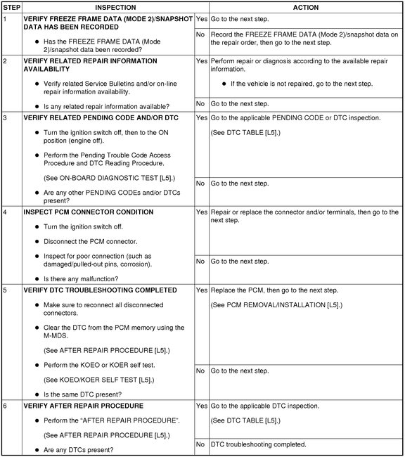

The P061B is also related to the PCM. It indicates an internal module in the PCM has miscalculated performance. If you look at pic 2, I attached the diagnostics related to this code.
The P0500 is again related to wheel speed miscalculations by the PCM. Again one of the possible concerns is the PCM.
