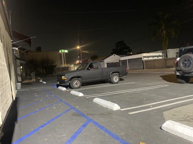

So I just purchased a 1993 Dakota with close to 300k miles on her she seems solid. I know it need major maintenance Any recommendations as to where to start.I already replaced the front shock and did an oil change

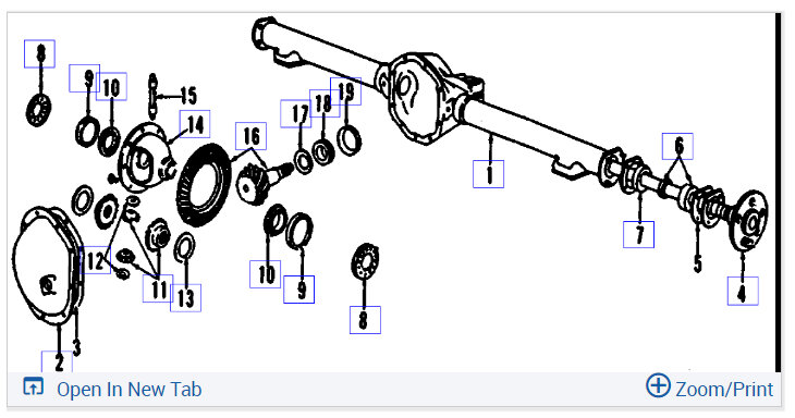

Nice truck! That is a good start. I would do an engine tune up and flush out the brake fluid for fresh. Also, a differential service would be a good idea as well. Here are three guides will the instructions below to help as well. Also, check the transmission fluid condition and if burnt I would change it out as well.
https://www.2carpros.com/articles/how-to-bleed-or-flush-a-car-brake-system
and
https://www.2carpros.com/articles/how-to-tune-up-a-car-engine
Here is a guide to help you service the throttle bore and IAC motor as well:
Here is how to service the differential:
https://www.2carpros.com/articles/differential-service
