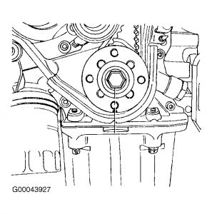

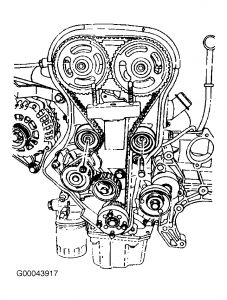

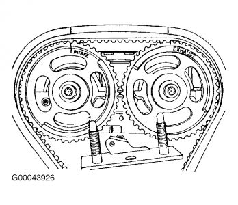

The cam gears were lined up before we took belt off and once we took it off they moved slightly. i am havign a hard time getting them back into perfect alignment. please help!!! Im a single mom who couldnt afford the money for a shop to do this.
Sep 4, 2010 at 11:28 AM
DOCFIXIT
  • 18,828 POSTS
Be carefull not to turn crank or cam gears to far cause valve damage will hapen. if cam gears rotate a little then kinda freeze up you have mad contact with piston. see diagrams
