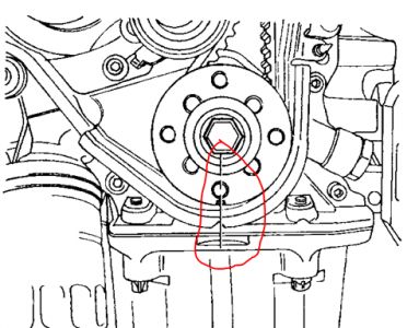

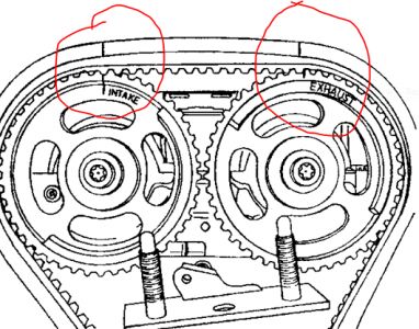

how to set timing gears one has to marks
Feb 18, 2010 at 3:41 PM
MHPAUTOS
  • 31,937 POSTS
Hi there, See pics for information, i have marked the timing marks. mark (mhpautos)
