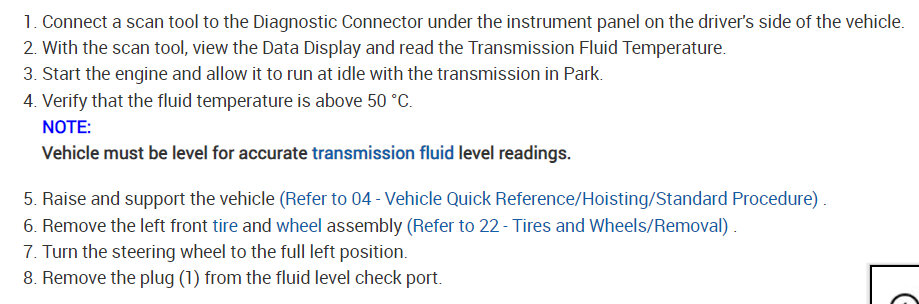

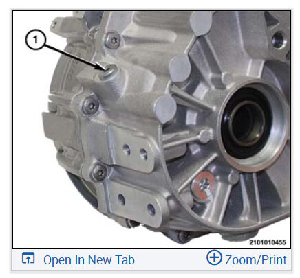

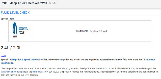

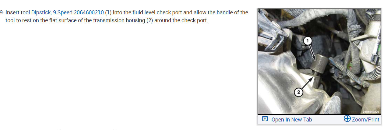

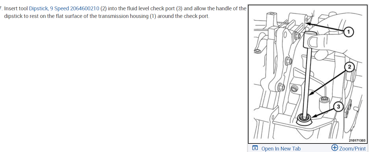

It sounds like the transmission could be low on fluid, here is how you can check it to see if this is the problem. When you warm the engine up it expands the transmission fluid and fixed the problem.
Use only MOPAR ZF 8&9 Speed ATF Automatic Transmission Fluid, or equivalent. Failure to use the correct fluid may affect the function or performance of your transmission.
Or you can just add a little fluid to see if the problem goes away. Also, let's run the codes to see if any are stored.
Check out the images (below). Please upload pictures or videos in your response of any problems so we can see what to help you with.
