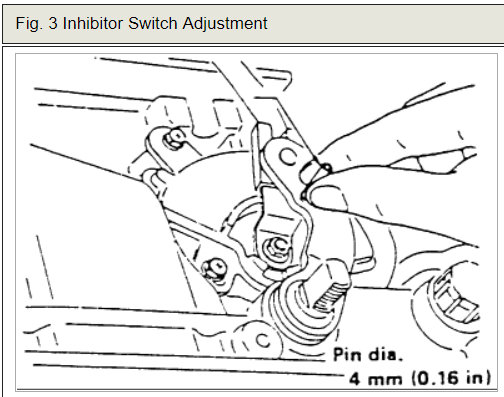

My truck reverse will not work at all. All other gears including overdrive work. Any ideas what could be wrong?
May 20, 2018 at 12:08 AM
  • 55,224 POSTS

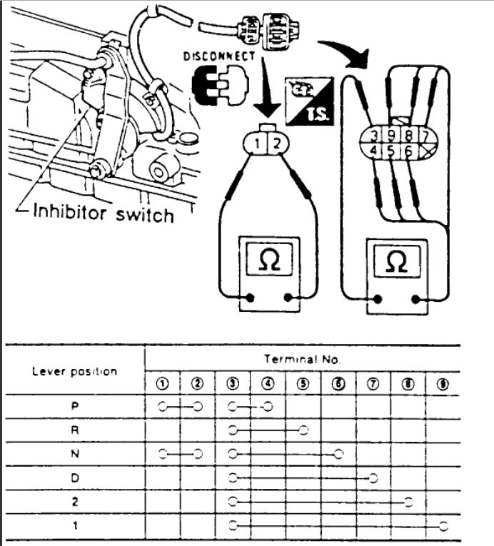

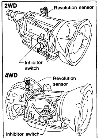

Yes, it sounds like your transmission range sensor has gone out. Here is a guide and the sensor location so you can confirm the issue:
https://www.2carpros.com/articles/how-a-neutral-safety-switch-works
May 21, 2018 at 3:41 AM
SILASLOPEZ18
I am not sure what that is but I will try. It went from one night to next morning not working did not even feel it go out or anything. The "P" "D" "1" and "2" all work except "R" (reverse).
May 21, 2018 at 1:47 PM
  • 55,224 POSTS
Yes, it is going to be the transmission range sensor or a reverse shift solenoid. Lets check the easier part first. ;)
May 22, 2018 at 3:23 AM
SILASLOPEZ18
I just noticed that when I press the button that is next to the shift it only goes half way on reverse and on all others it locks in to shift.
May 24, 2018 at 11:04 AM
SILASLOPEZ18
The reverse lights work. Could it be a latch in the shift stick (automatic P R D 12)?

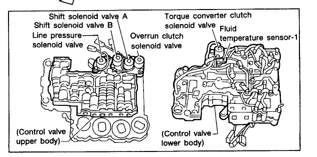

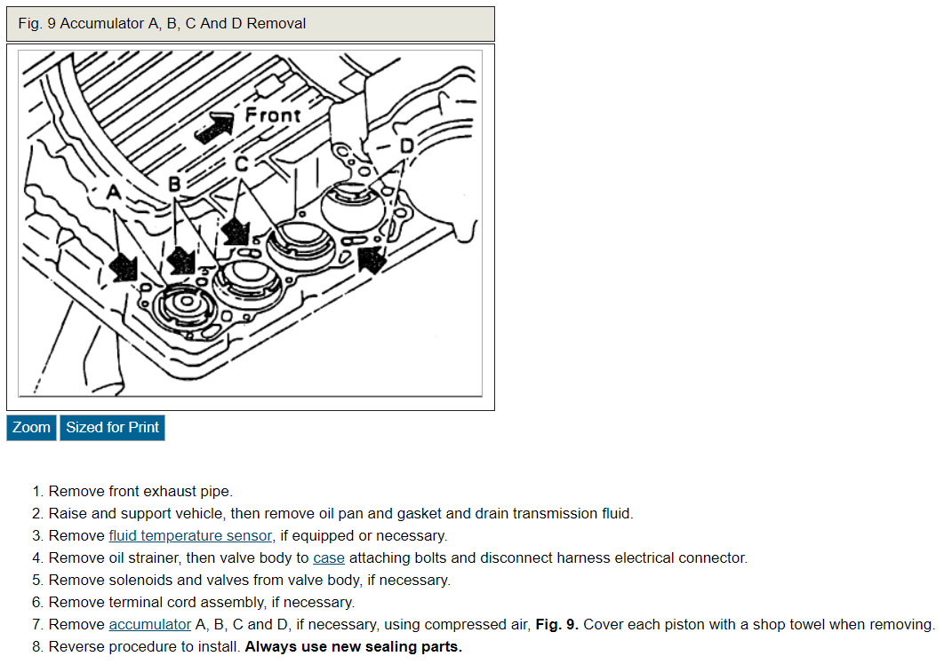

Yes, that is where I was headed next. Here is a diagrams to show you what the shift solenoid are and the turbine speed sensor.

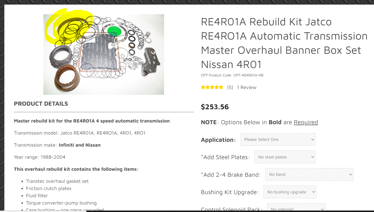

There was nothing to indicate that R was on it's way out. I was pulling out of a slightly inclined parking stall when I realized it was rolling out of the stall backwards instead of reversing as per yewsh. So I got it home where me and my uncle investigated further. Fluid was slightly dirty but full. I had the ATF flushed about 8000 km before, and it didn't smell burnt when we checked it. I was running premium 0% ethanol gas for 2 weeks before this issue started because that's all the gas station had, but I usually run regular or 10% ethanol.
Since then I've taken it to the only transmission shop in a 200km radius from where I just recently moved to. The guy said that its an internal clutch belt that's either slipped or worn so bad it won't catch anymore. And he really does not want to work on it, as parts are near impossible to find in this area and we'd quickly run up an "outrageous" bill.
When I put it in R, the front axle will register a little bit (the wheels will turn about a 1/2" backwards) but the rear end does nothing. When I press the accelerator, it only revs my engine. No spinning of the wheels of any sort.

I wish I could call, but we are required to keep everything online. I hope you understand. Where are you located? The transmission model is a RE4R01A. That may help you locate one. However, whatever you find, confirm with the seller it will fit your vehicle.
My biggest concern with a used unit is it fails. Then you are stuck paying labor two times.
As far as the issue, there could be several things causing this. It could be related to a line pressure issue. If a band was slipping, you would have noticed it starting to get worse over time. Since it just happened all at once, I question if that is the issue.
Are there any other shops near you that would check transmission line pressure? Also, have you ever had the fluid changed? A partially plugged trans cooler can be causing issues as well. Also, the line pressure can be good in drive but not reverse. It's just a thought/theory at this time.
Next, if you decide to replace the transmission, you can get remanufactured transmissions from a parts store. I just checked AutoZone and they have three or four to pick from. They aren't cheap, but if you get one that is bad, they normally will pay the additional labor cost.

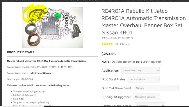

As far as parts, I found complete rebuild kits online. If you look at the pic below, it shows a kit and I highlighted the band in question. Here is the link:
https://www.oregonperformancetransmission.com/product/OPT-RE4R01A-RB.html
Again, confirm this will work for your vehicle, but I suspect it will.
I would want the line pressure tested. This could be the issue and could be internal or not.
For example, a direct clutch leak will show a pressure drop when the transmission shifts to third and low pressure in reverse because in most cases, the direct clutch is on in third and reverse. Also, reverse requires the peak pressure from the system.
Also, there is a line pressure control solenoid in the transmission which can be bad.
I don't like replacing parts until I know what is wrong. Regardless, please let me know what I can do to help you. Also, let me know if you have other questions.
