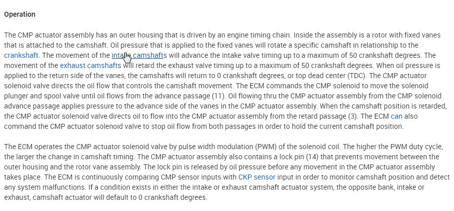

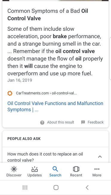

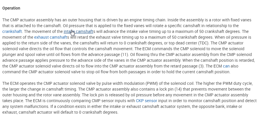

I found this information on the oil control valve. I hope this is the only thing wrong with my car.
