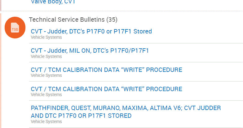

Vehicle is starting to do what Nissan's TSB states is a "judder". There are no stored DTCs in the vehicle's TCM. General repair shop states the transmission needs to be replaced but everything I find online says Nissan's fix in most cases is to replace the valve body. Obviously, one is cheaper than the other and I am looking for recommendations.

I need more information. The TSB related to the judder should set a code. Can you explain exactly what you are experiencing?
If you look below, I listed all TSB's related to the valve body. Note they are based on codes. Also, there is a TSB related to recalibration between the TCM and the CVT transmission. If you have something different, let me know.
I will watch for your reply.
See pic below. Note: The pic below is a short portion of the TSB's related to the valve body, so let me know exactly what is happening and if the shop scanned the can-bus to check for transmission codes.
