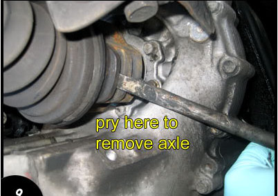

Trying to replace passenger axle. I have everything taking off but it wont come out. Tried cutting the old axle in half to get out but no go on it. If I could just get a walk through on how to take it off for a 1988 it would be great. Just cannot figure how to get it off from the transmission.

Okay, they are sometime hard to get out if you do not have the proper tool for the job. What you need to do is, with crow bar or pry bar find a good pick point between the axle and the transmission, you will need some extra room to do this. After getting a good point were the bar wont slip out of position easily you need to pull the bar toward the wheel, it may take several attempts to get it out. It has a spring clip to help hold it in the transmission and that is what keeps it from coming out easily, you can see what I am talking about on the new axle.
Hope this Helps.

OBXAUTOMEDIC
  • 3,711 POSTS
Here is a picture I found. It is on a 1996, but may help I believe axle is similar to the 1988.
