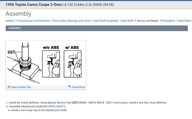

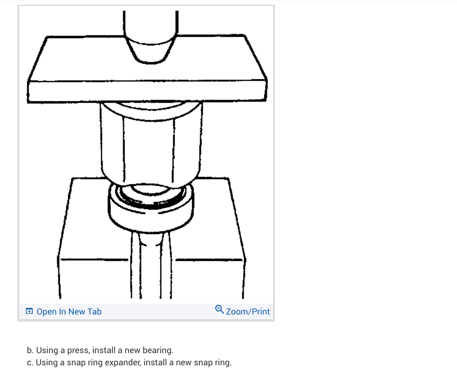

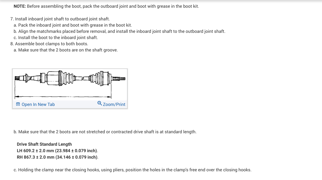

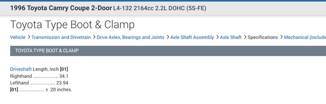

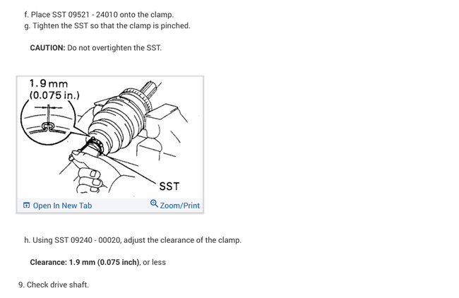

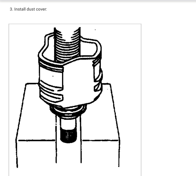

Recently replaced driver's CV joint popped out while driving
1996 TOYOTA CAMRY
16,000 MILES • 4 CYL • 2WD • AUTOMATIC
INSANE

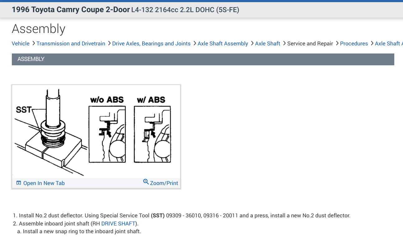

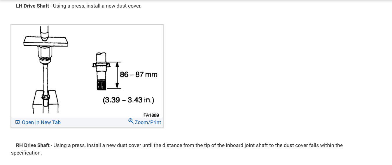

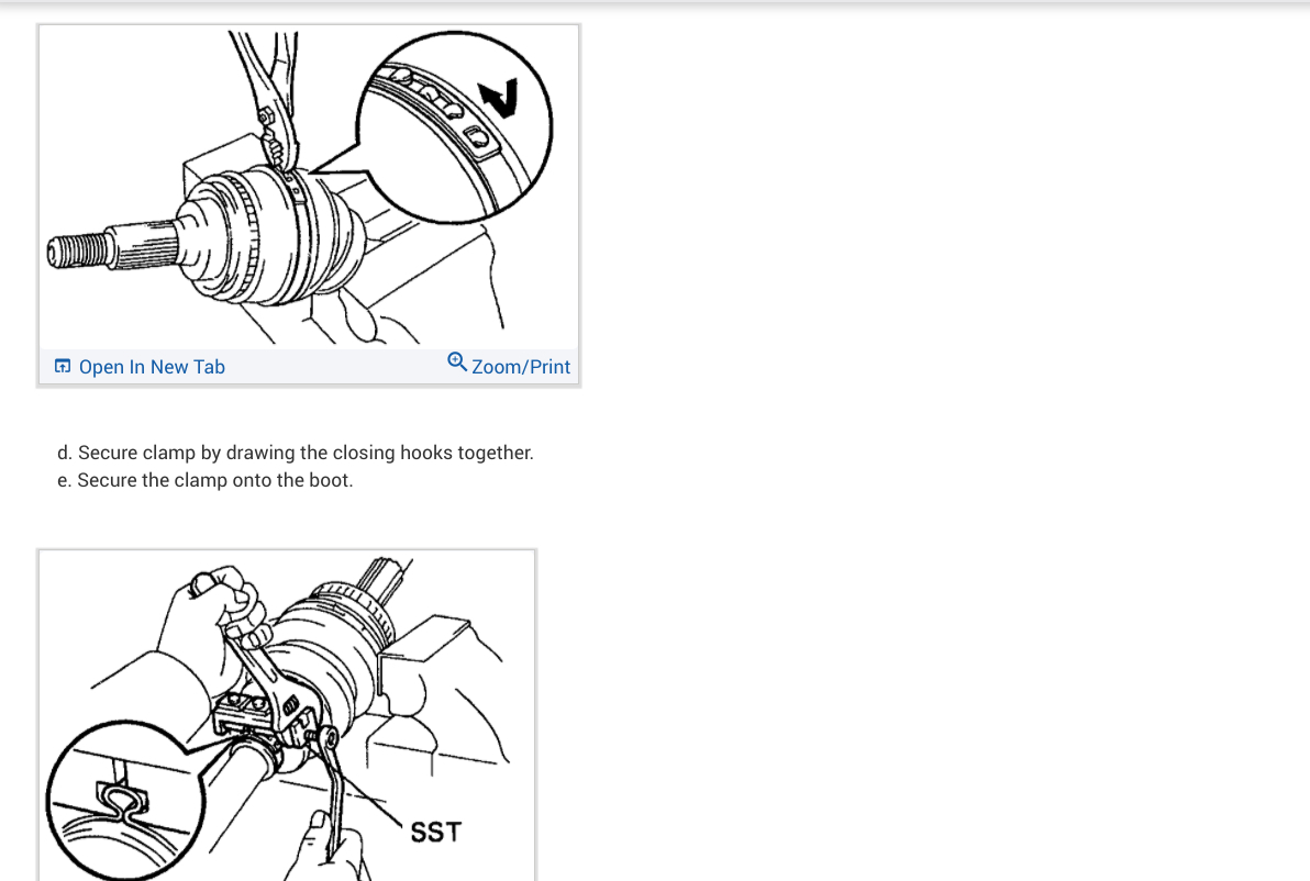

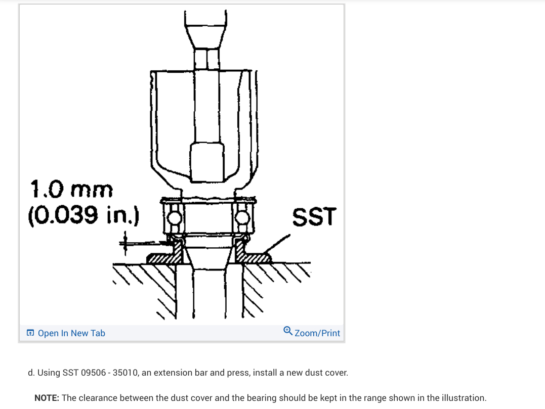

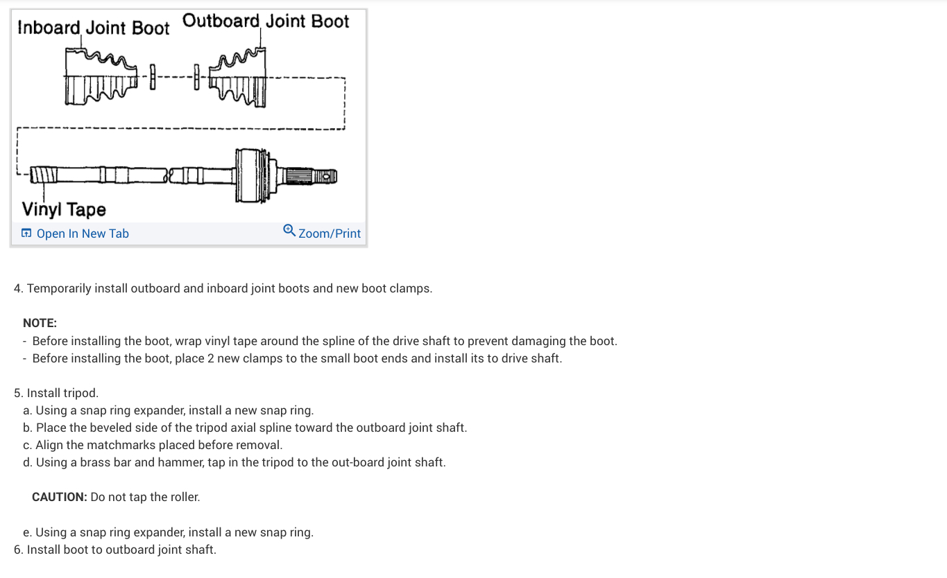

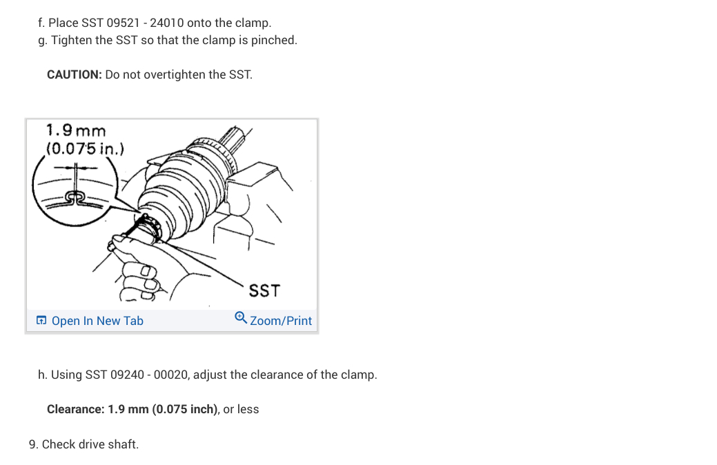

I replaced both CV joints on my car I drove 700,miles and after that my driver side CV joint popped out but it back in and within a half mile it pops out again. so towed home and put it back in and I didn't even make it out of my driveway. help!
Jan 25, 2020 at 11:21 AM
SCGRANTURISMO
  • 4,897 POSTS
I am not sure what went wrong with your vehicle here. In the diagrams down below I have included the installation guide from the vehicle manufacturer for the drive axles on your vehicle along with specs for two different types of CV boots and clamps as well. I hope that this helps and get back to us with how everything turns out.

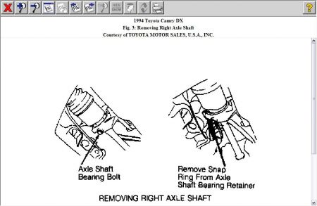

My name is Dempsey, I am having a problem taking my passenger side axle off. I have taken everything off but the axle won't pull off. Is there something else holding it on that I don't know about?
Feb 15, 2021 at 5:06 AM (Merged)
  • 75,992 POSTS
You need to remove the bearing bolt and snap ring. See below

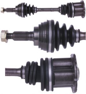

Your mechanic is right but the problem in this case is due to wear in the inner cv joint housing. I prefer to disassemble the inner joints and look for the wear rather than replace both half shafts. It is not unheard of to get a rebuilt assembly with a worn housing that got overlooked. Then you'll have the same problem and incorrectly assume the mechanic diagnosed the problem incorrectly.
Once you have the housing apart and cleaned of all the grease, there are six highly polished rolling surfaces the rollers ride on that must be checked. If you can feel the slightest waviness on any of those surfaces you really have junk. Normally you must shine a light in there and look for the slightest irregularity in the reflections. If you see a tiny wave in the reflection and you're not sure that's the cause of the problem, . . . it is.
Those rollers have to run back and forth in the housing as it rotates. That allows the shaft to change length and angle. When accelerating, the torque makes it harder for the rollers to move over the raised areas so they tend to bind. When the shaft can't change length freely it pushes and pulls on the spindle as it rotates. That tugs on the lower control arm which is mounted on rubber bushings. The steering linkage is also connected to the spindle so as it gets pushed back and forth, it tugs on the steering linkage causing the shimmy you feel.
Replacing engine mounts can cause this problem to occur. The wear is already there in the housing but at least one engine mount sets the location, side-to-side, of the engine and transmission. Repositioning the engine just a little one way or the other will change the area the rollers run in and that is when the problem may occur. The engine mounts didn't CAUSE the problem. They merely caused it to become evident. You may reduce the shimmy by repositioning the engine mount but that's not really addressing the main cause.
Most of the time a new inner housing from the dealer is real expensive, often two or three times as much as the cost of a rebuilt half shaft. That's why to save time and therefore your money, many mechanics don't waste it inspecting parts. It's less expensive in the long run to just replace both shafts than it is to identify the bad one and replace just that one.

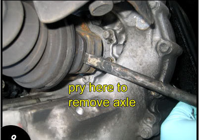

Trying to replace passenger axle. I have everything taking off but it wont come out. Tried cutting the old axle in half to get out but no go on it. If I could just get a walk through on how to take it off for a 1988 it would be great. Just cannot figure how to get it off from the transmission.
Feb 15, 2021 at 5:08 AM (Merged)
OBXAUTOMEDIC
  • 3,711 POSTS
Okay, they are sometime hard to get out if you do not have the proper tool for the job. What you need to do is, with crow bar or pry bar find a good pick point between the axle and the transmission, you will need some extra room to do this. after getting a good point were the bar wont slip out of position easily you need to pull the bar toward the wheel, it may take several attempts to get it out. It has a spring clip to help hold it in the transmission and that is what keeps it from coming out easily, you can see what I am talking about on the new axle.

Here is a picture I found. it is on a 1996, but may help I believe axle is similar to the 1988.
