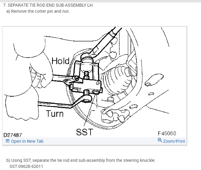

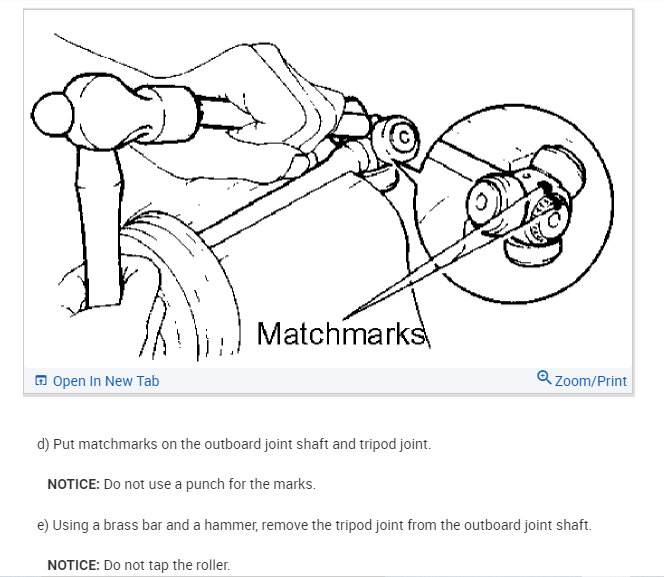

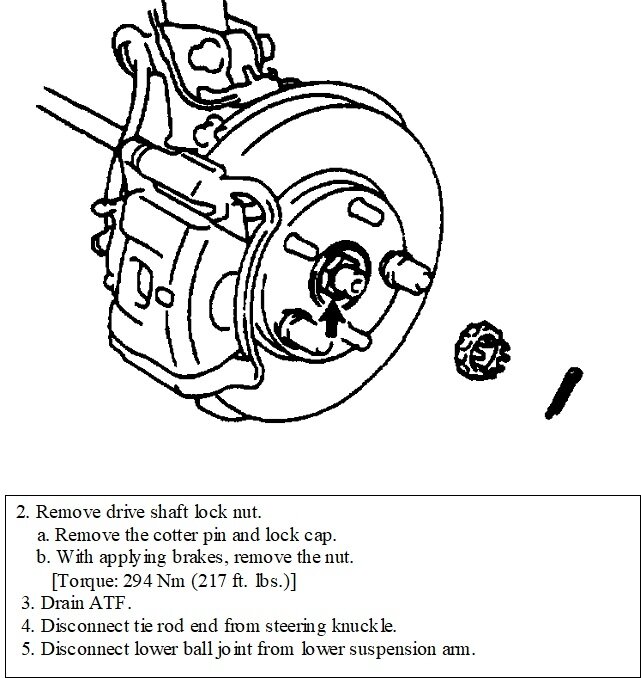

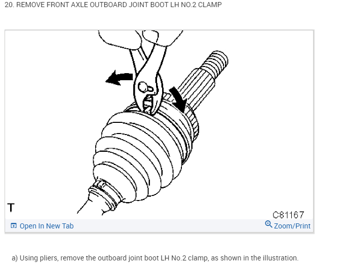

Hi 2CarPros. I just started a mobile mechanic side business, so I haven't done every repair on a car although quite a bit. This will be my first-time doing CV boots. I'll be doing this tomorrow. Can you please give me fully detailed, step-by-step instructions with pictures as well as anything to be aware of and to look out for? I heard a jack is good in removing. I believe the control arm (suspension part) that you have to pry out. Should I have extra cotter pins in case I have to cut them off? I'm a little nervous but I have to learn and start somewhere. I really appreciate it, thanks.
Dec 7, 2022 at 8:21 AM
CARADIODOC
  • 34,388 POSTS

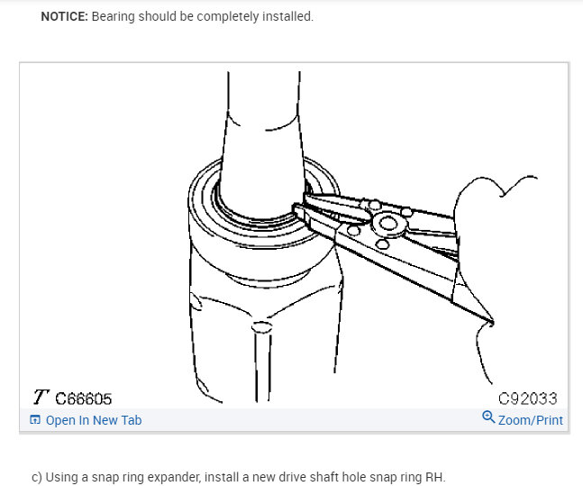

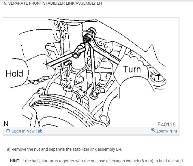

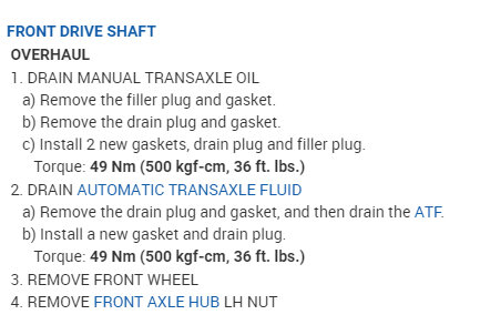

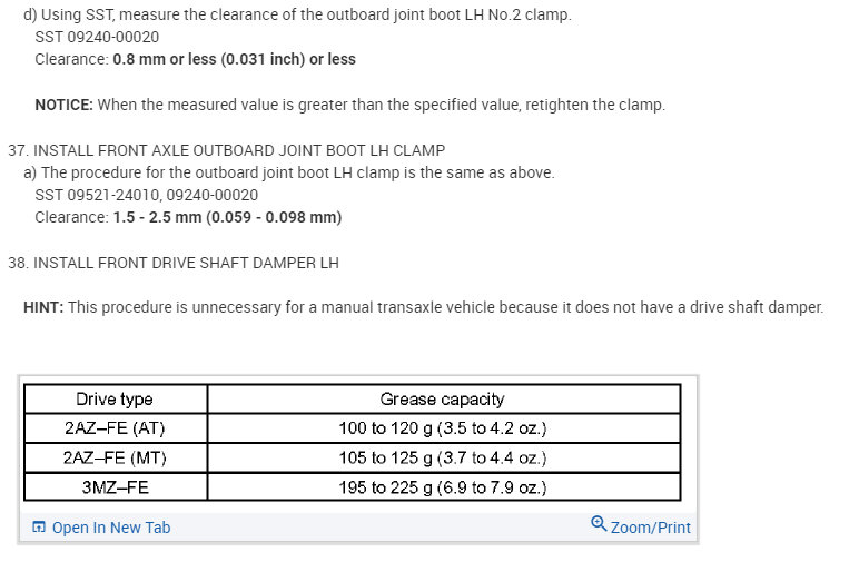

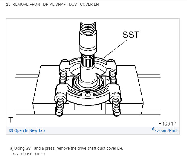

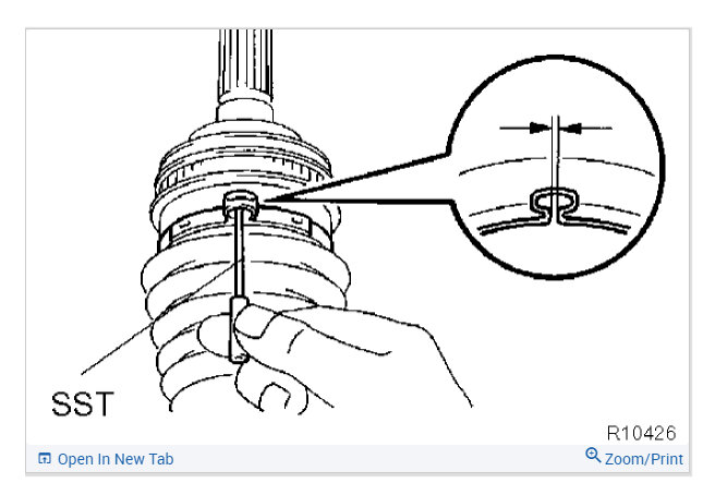

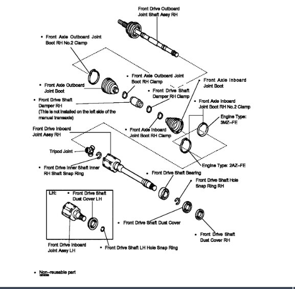

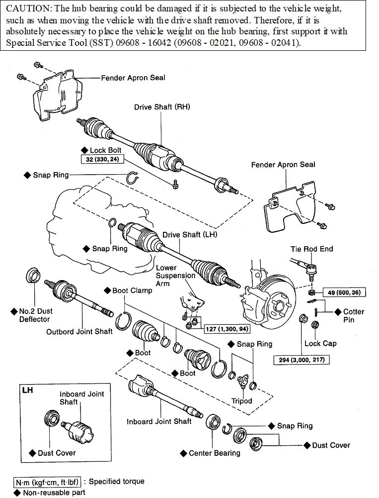

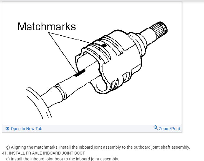

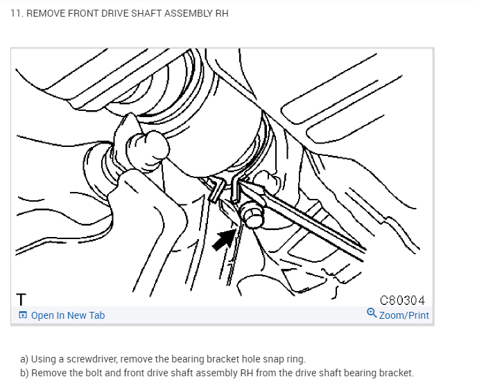

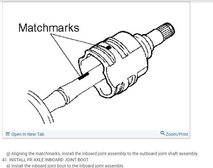

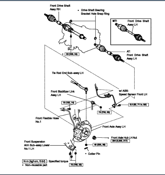

The procedure isn't listed on our online service manuals, but that's okay. There's a much better way to go, both for you and for your customer. One boot alone is listed as costing over $66.00 from the dealer. Expect the kit with grease to cost roughly half of that from an auto parts store. Compare that to the cost of a new half shaft, complete assembly. The most expensive one from Rock Auto is only $71.00. Doesn't show if that's new or rebuilt, but I did buy a brand new one for my '88 Grand Caravan a few years ago for $65.00. Why pay just as much for only the boot, then have to go through the work of replacing it?

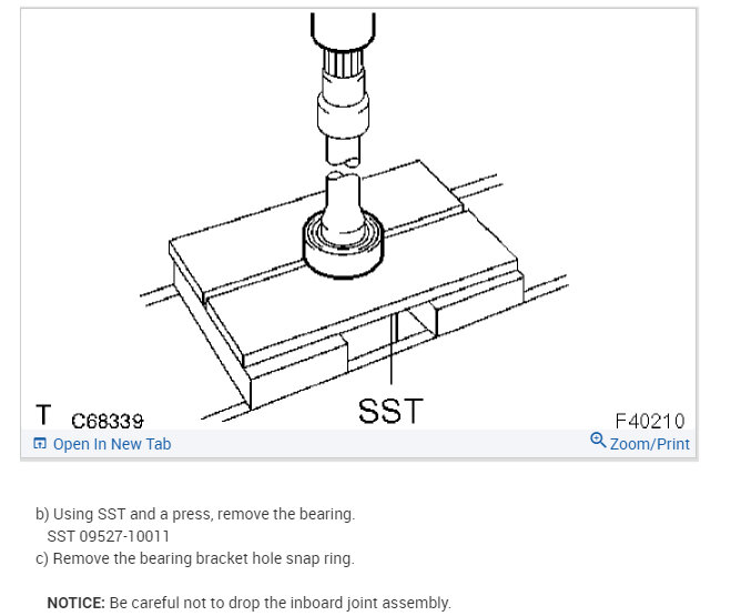

On a lot of imports, the inner cv joint can't be separated from the shaft. To replace an inner boot, you have to remove the outer joint and boot, then slide the new inner boot on from that end, then reassemble everything. It's a very messy job that's listed to take over 2 1/2 hours.

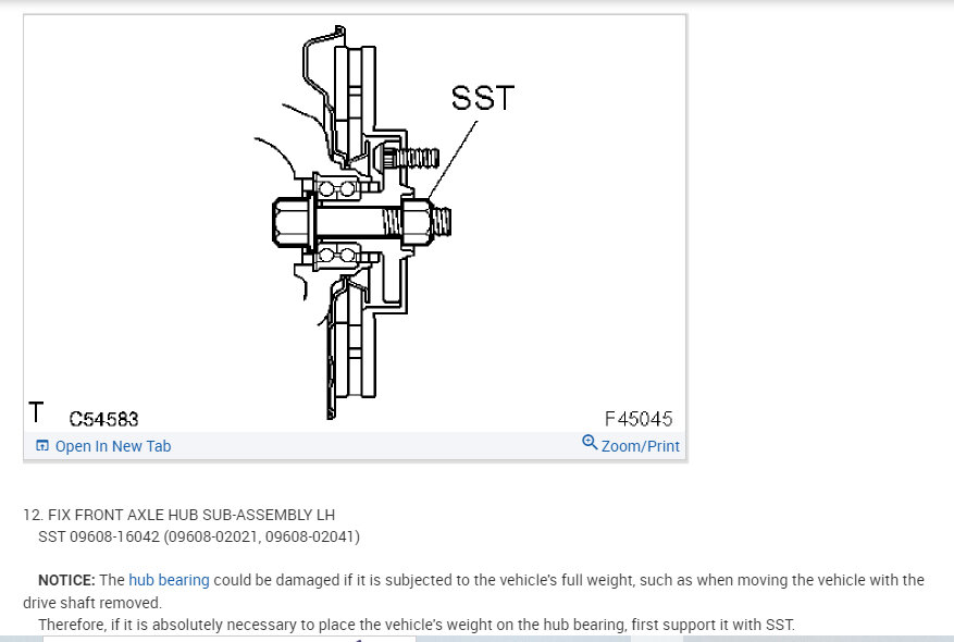

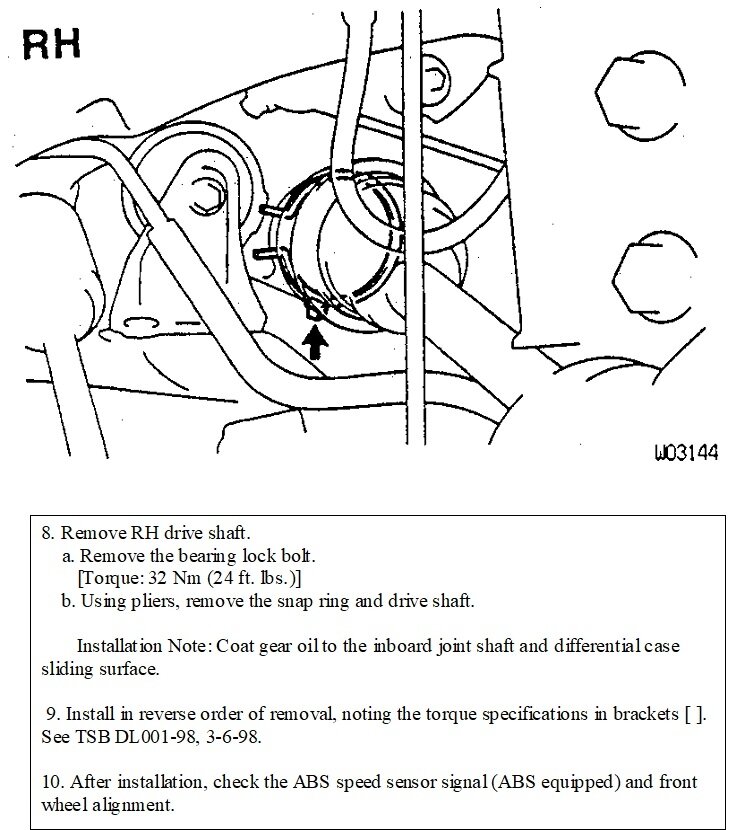

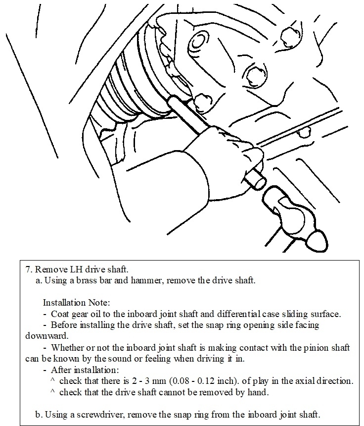

The steps to replace the half shafts are shown in the drawings below. Explain to your customer this will cost them less by requiring a real lot less labor time and give them a much higher quality repair. It will cost you about the same but make you a lot more profit with less mess and no special tools needed.

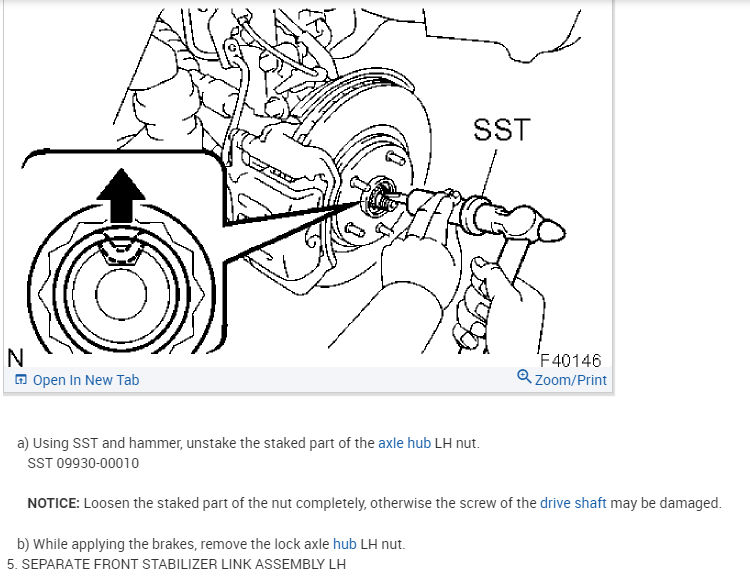

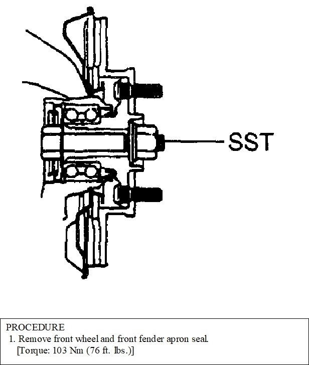

Note the warning at the top of the first page about placing no vehicle weight on the wheel bearing when the axle nut is loosened or removed. I've been preaching that to my students for years, but this is the first time I saw it in print.
If you're just starting out, learning on customers' vehicles is a real bad idea. Word of mouth advertising from an unhappy car owner can make for a bad reputation. Better to work in a shop first to get some experience. It isn't too hard to get hired at a new-car dealership, but it's the independent shops where you'll reach the pinnacle of success. The people there have to know all brands and models, not just the brands they sell.

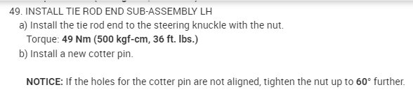

As for your cotter pin question, don't try to do this on a daily basis out of a car. They just don't come big enough to haul everything you might need. Use a full-size van or a small truck with a box high enough to stand up in. Put a workbench with a vise in there along with a small parts cabinet. If you don't need a new cotter pin on today's job, you surely will in the near future.

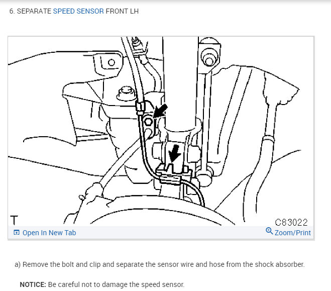

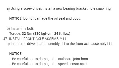

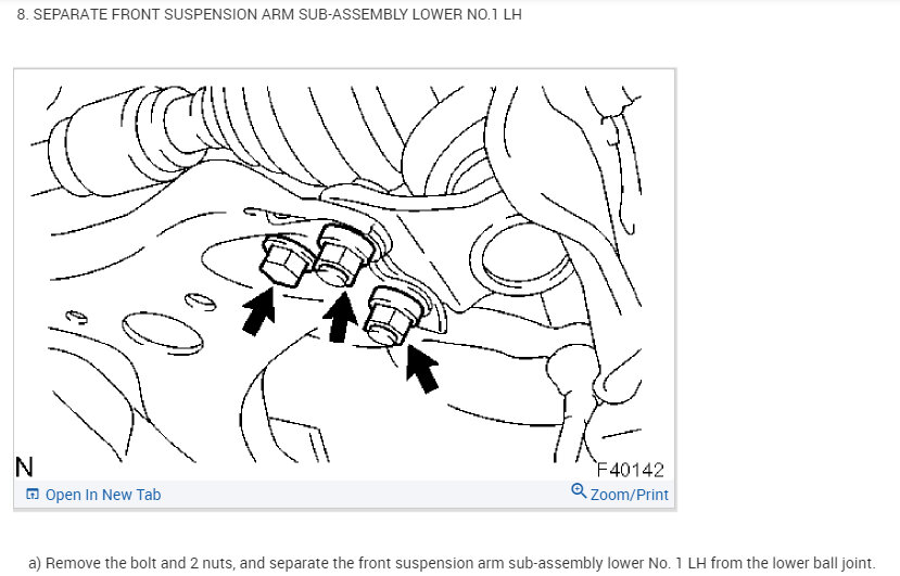

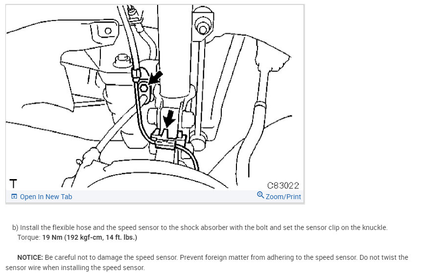

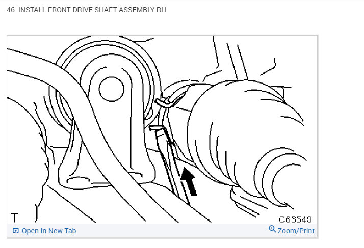

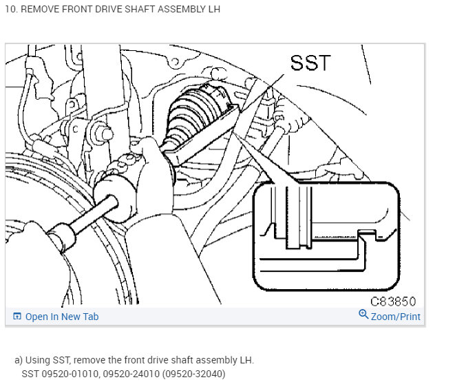

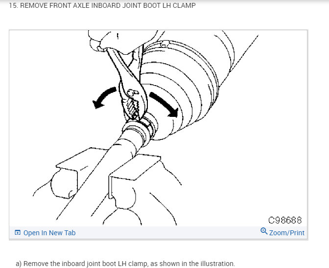

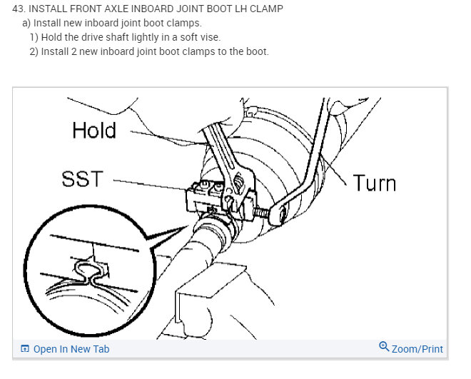

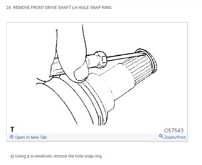

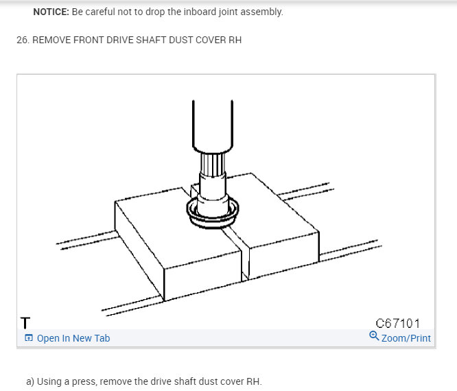

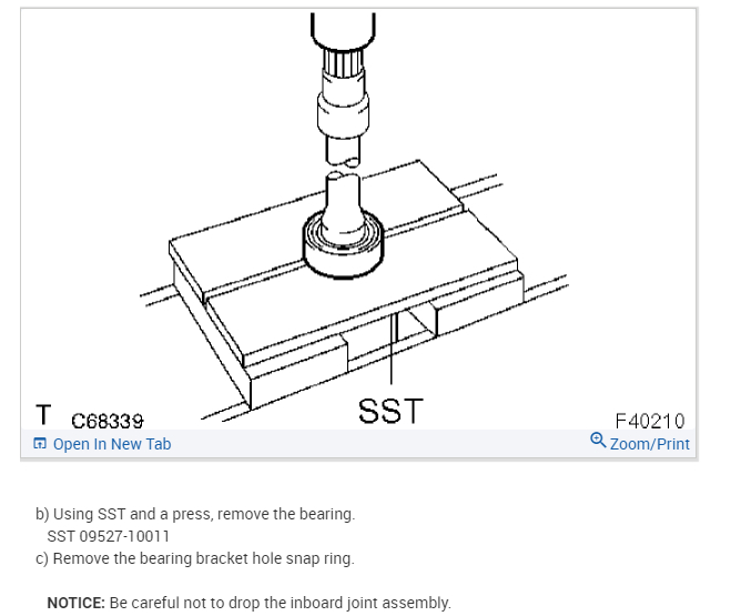

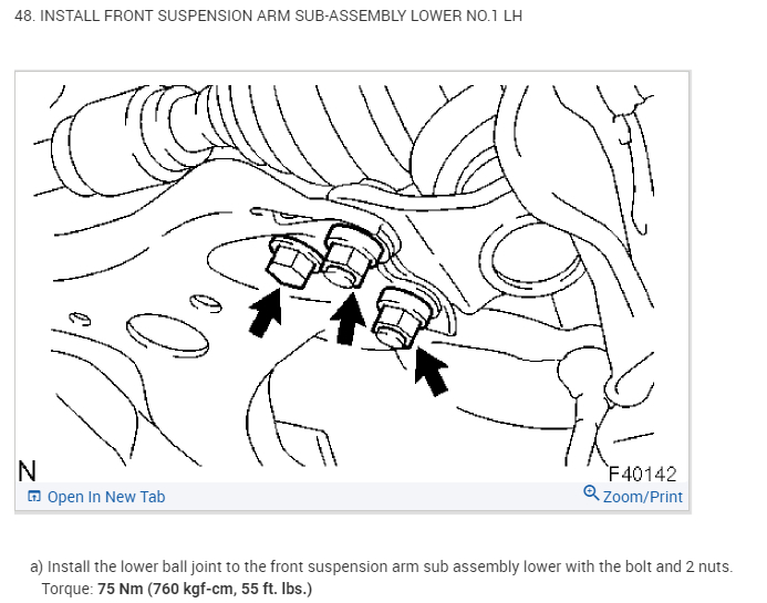

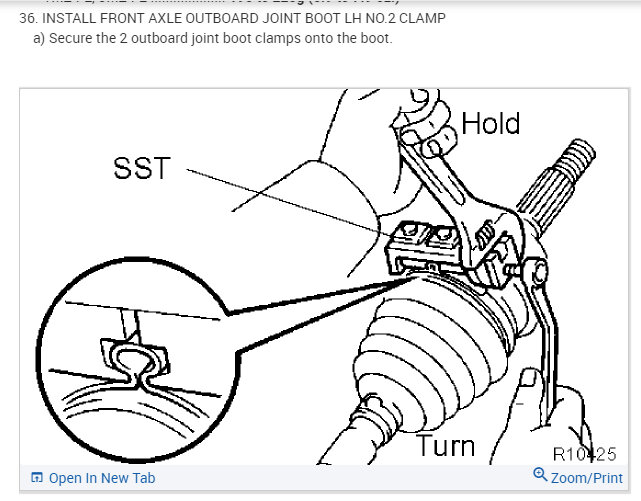

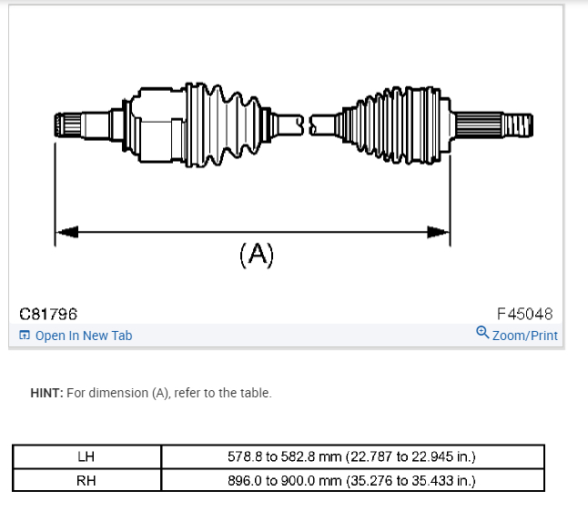

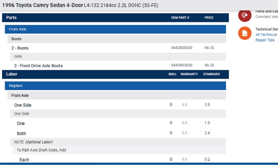

Are you replacing the boots or the half shafts? To replace only the boots isn't worth the cost. You will have more in labor than the cost of a new replacement half shaft that includes new CV joints and boots.

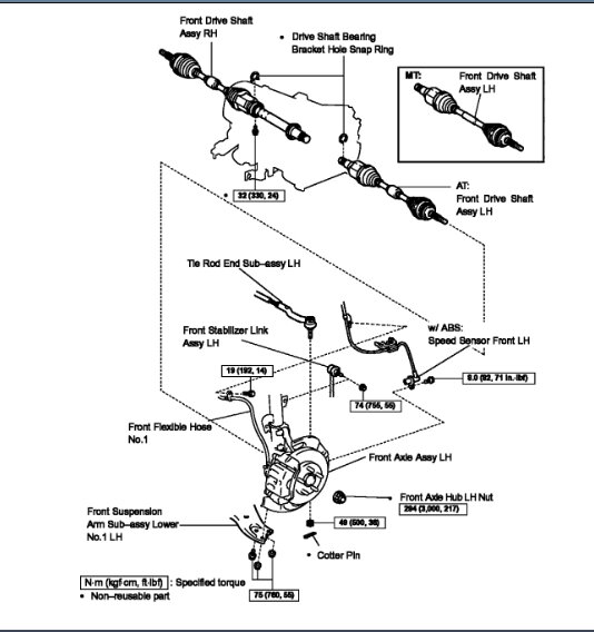

As far as replacement, I have no idea how you could use a jack, and I don't feel it is needed. You will need to remove a tie rod and lower ball joint on each side. There are special tools for the tie rod, but you shouldn't have any trouble separating it with a heavy hammer. I use a dead blow hammer.
As far as the lower ball joint, I don't believe it will need to be removed. You should be able to turn the steering knuckle far enough to remove the axle shaft from the bearing.

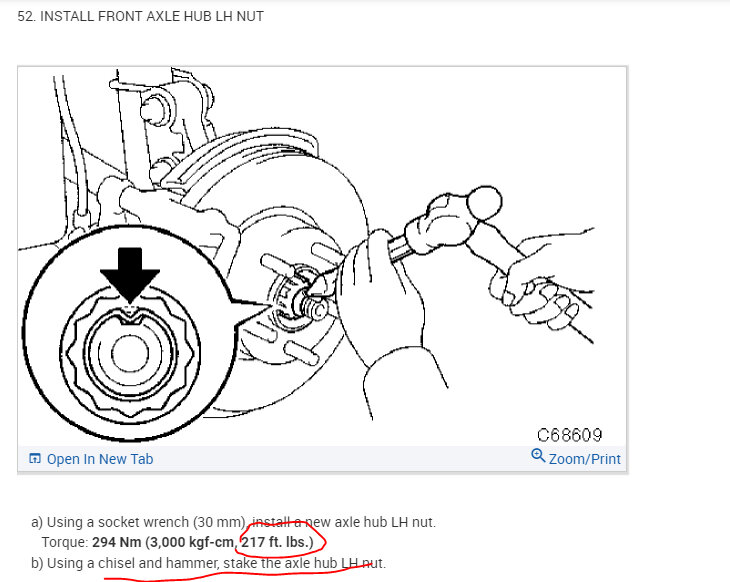

Now, as far as special tools, you do need a torque wrench that can reach 217 Ft/lbs for the axle nut. Also, I can't remember exactly, but the nut is 30mm. The nut should be replaced once it is used.

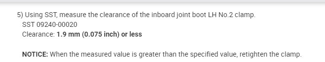

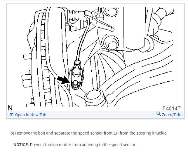

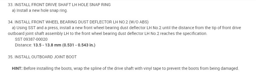

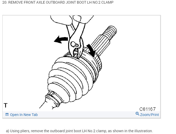

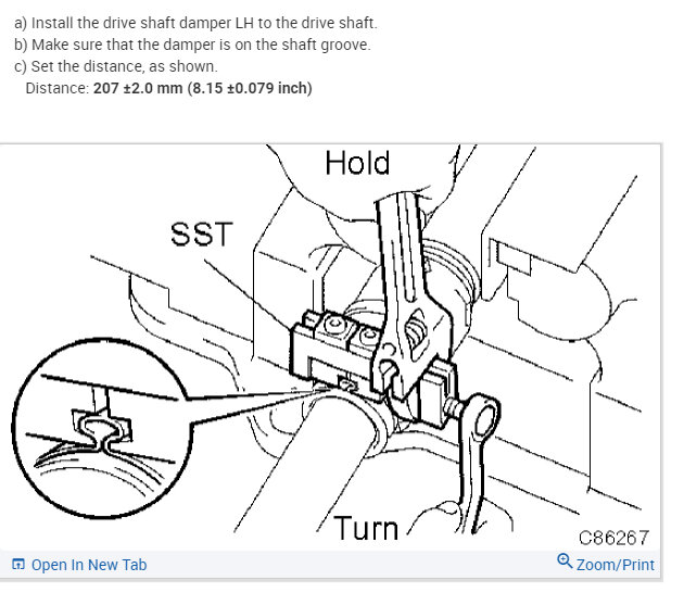

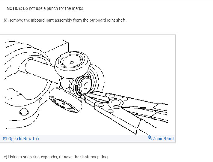

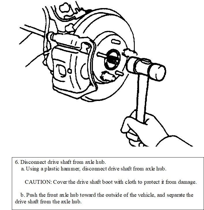

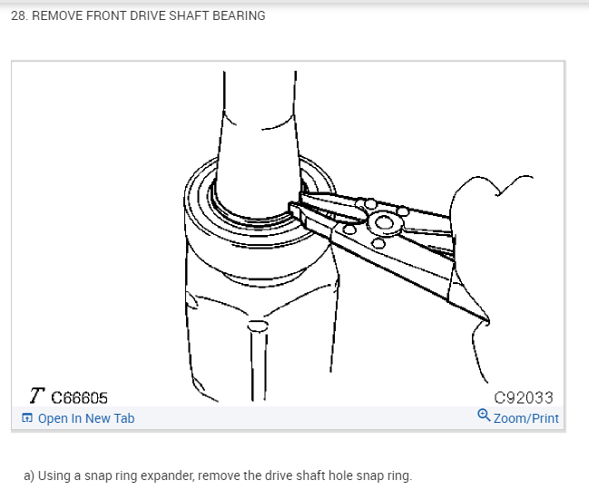

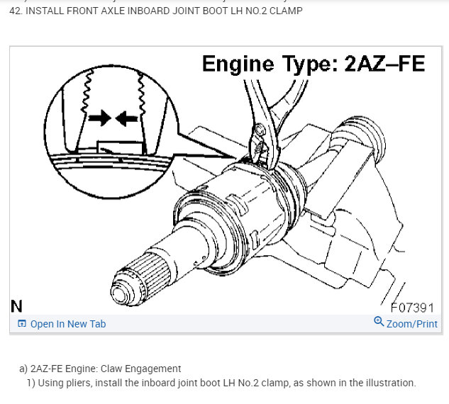

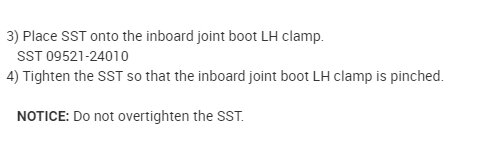

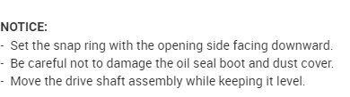

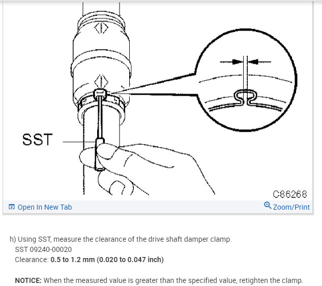

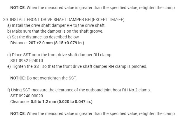

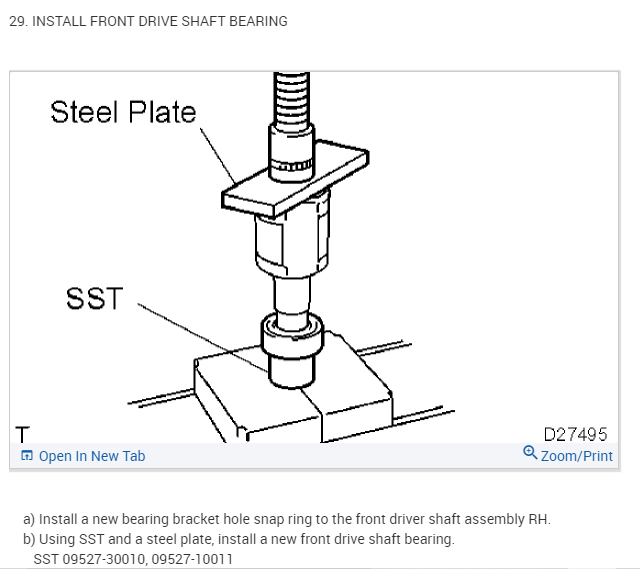

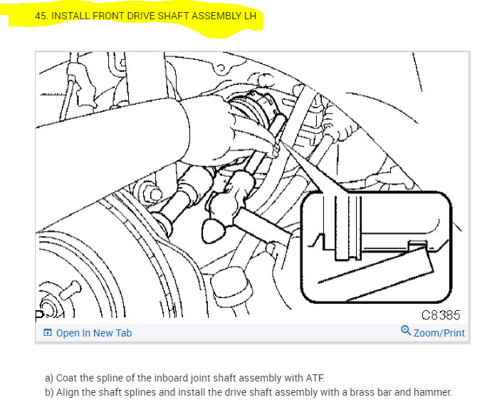

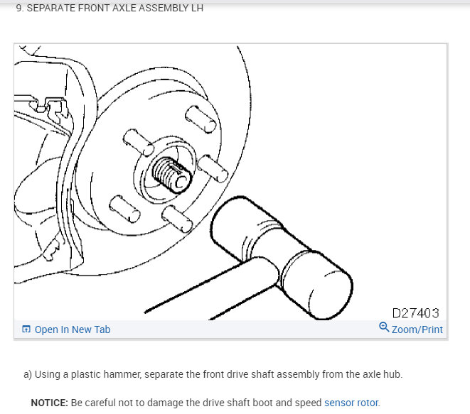

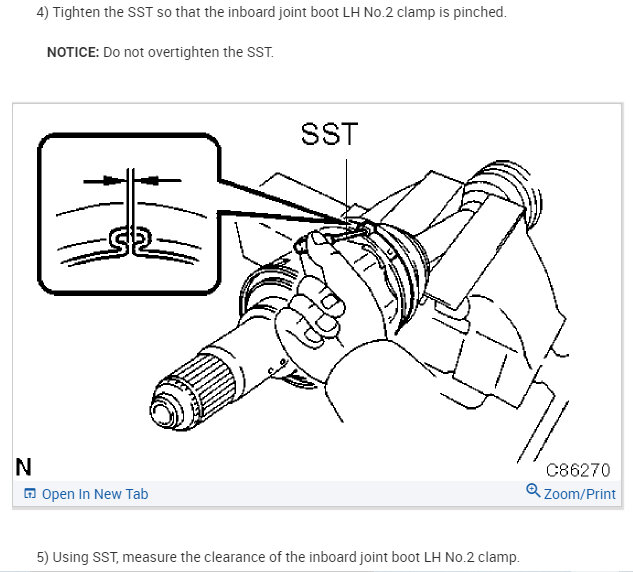

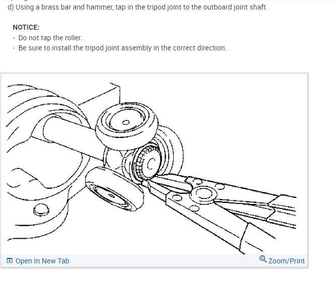

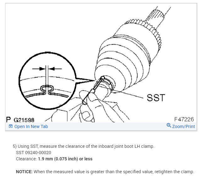

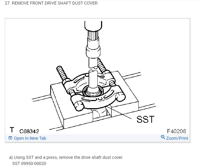

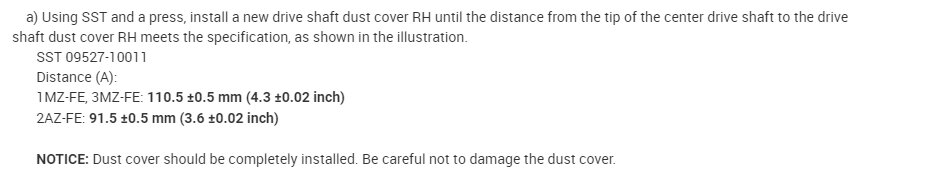

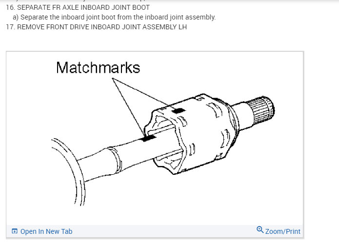

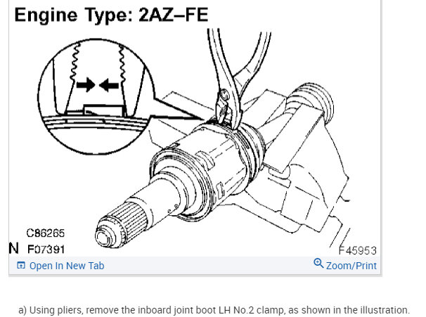

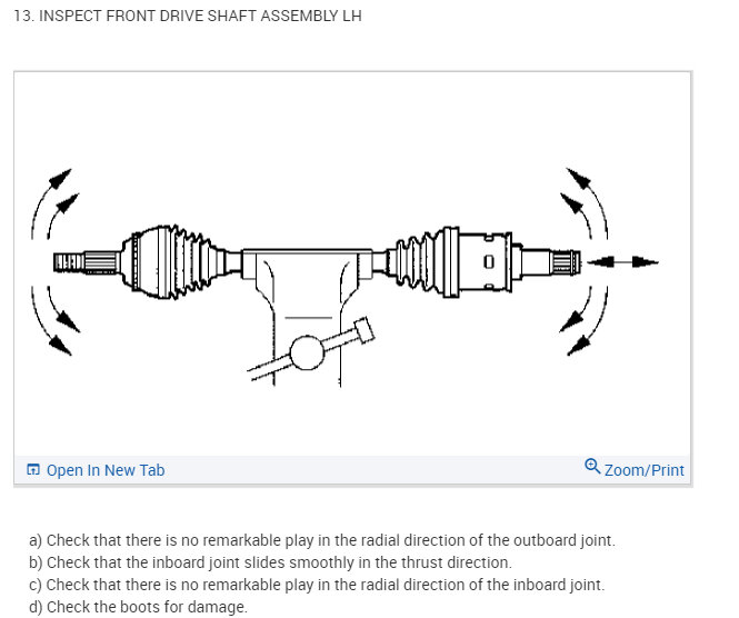

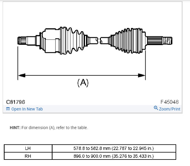

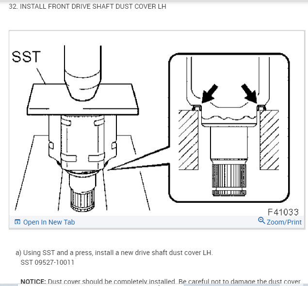

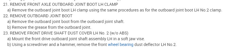

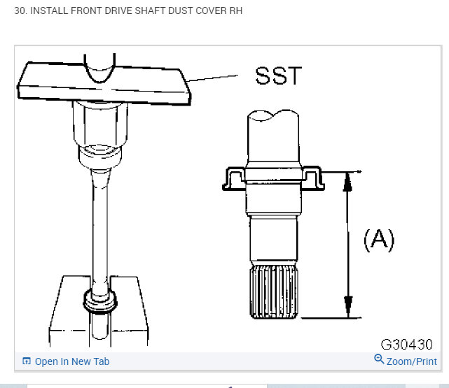

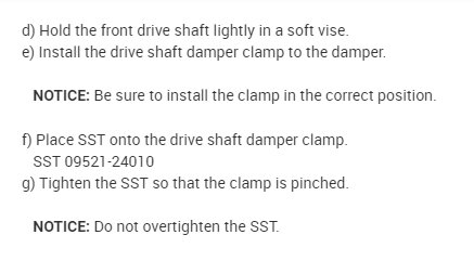

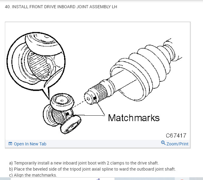

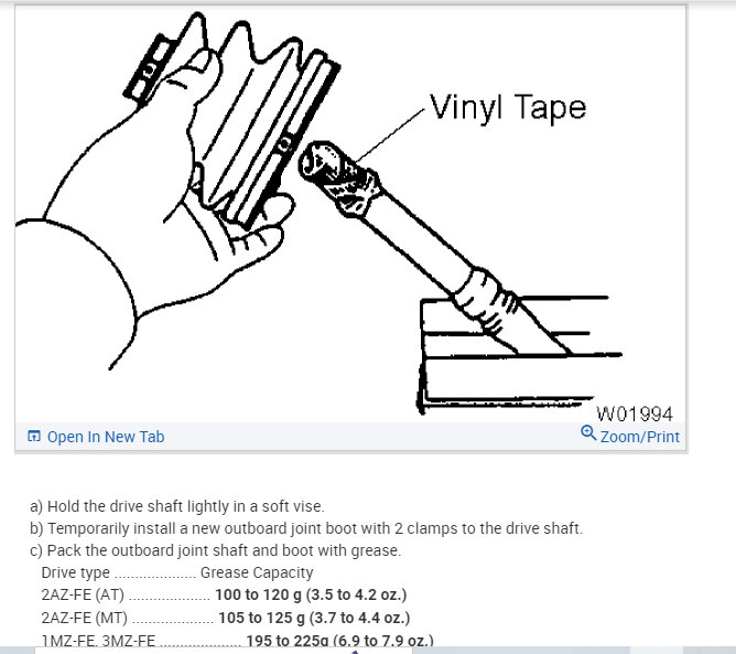

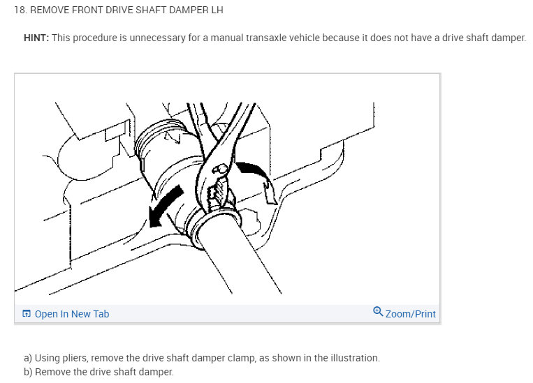

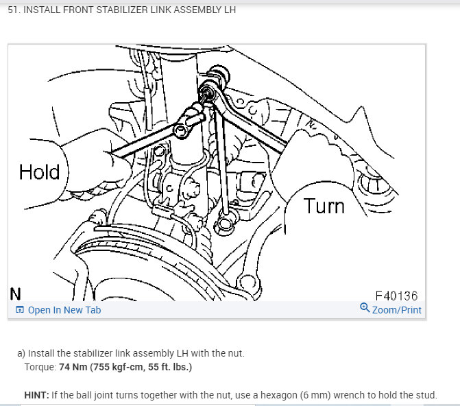

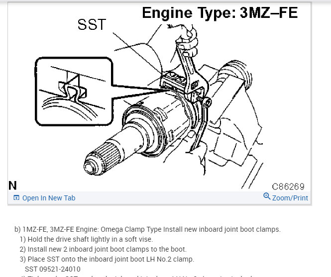

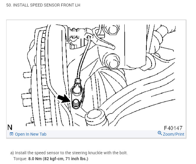

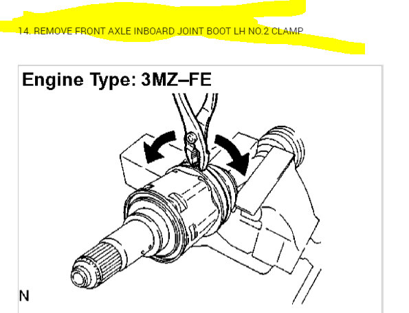

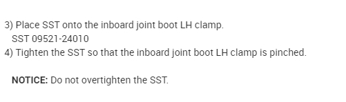

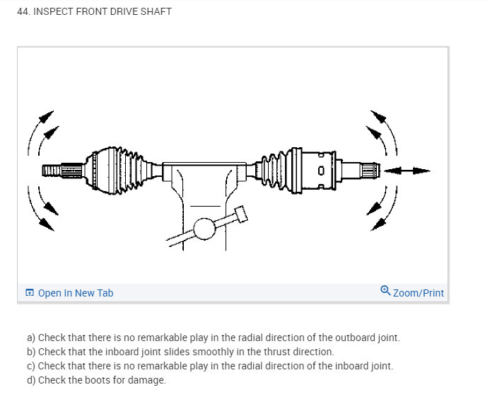

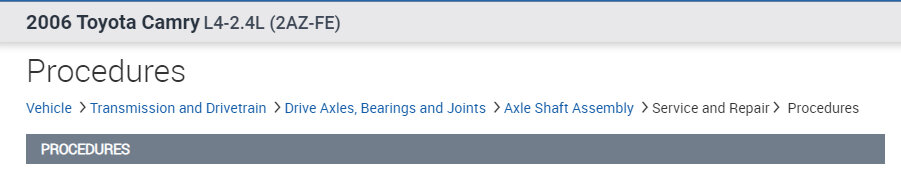

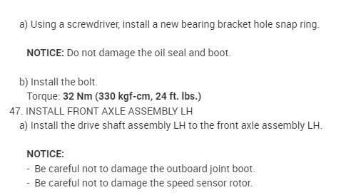

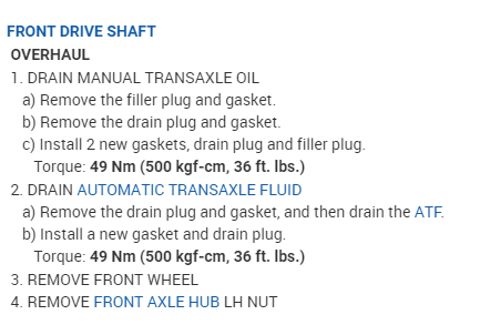

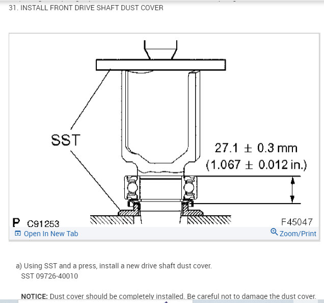

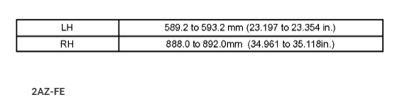

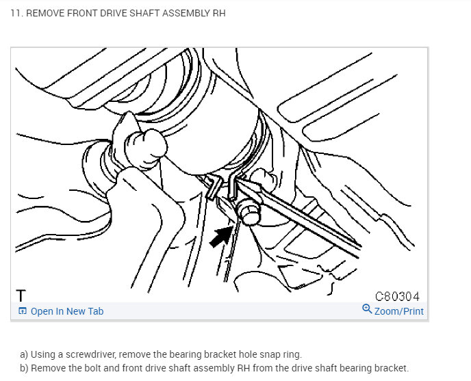

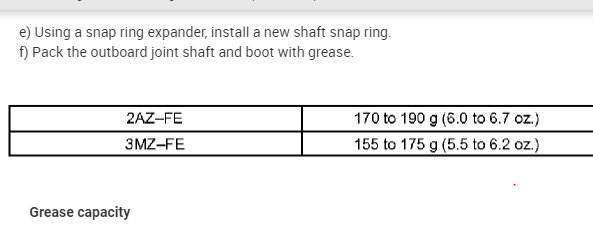

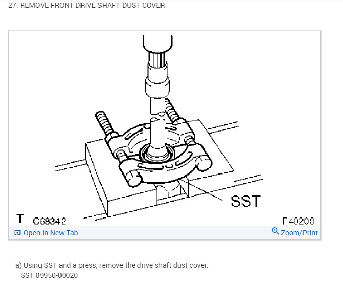

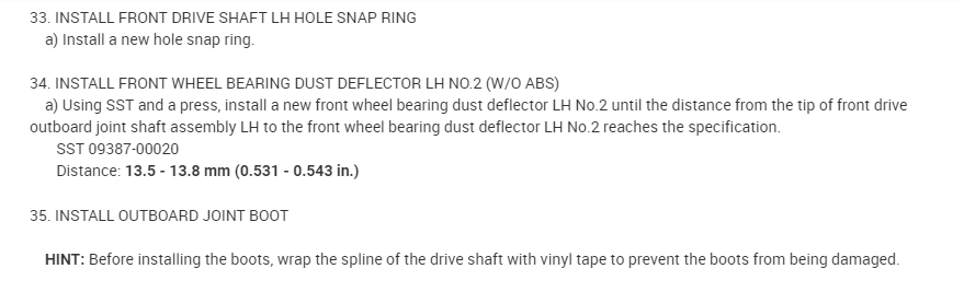

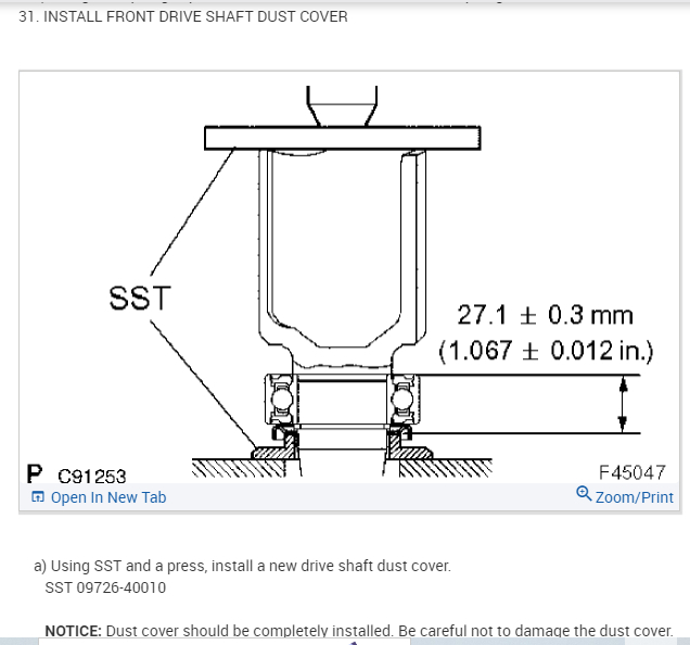

Do me a favor. I'm adding the directions below. The directions include the removal and installation procedures, how to inspect the CV joints, how to replace the boots and repair the CV joints, and the torque specs.
If you are just starting out, you can make the same by simply replacing the axle and still charge the customer less money due to the difference in labor. That will likely get you more business. Additionally, the new parts usually carry a lifetime warranty, so that covers you if the new boots fail.

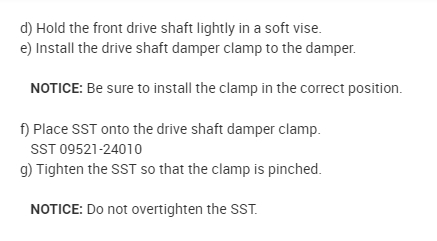

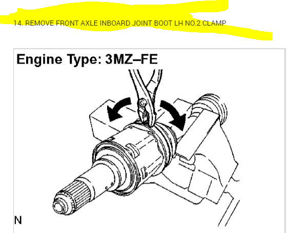

Take a look through the things below and let me know if you have questions. Note: The directions are extensive because they include all the things I mentioned. Before going to the site, you may want to stop at a parts store and rent an axle nut socket set and a torque wrench that can reach the torque needed. Before you reinstall the tire, double-check all torque specs and make sure to stake the new axle nut.
I hope this helps. Let me know if you have questions or if there is anything other I can do to help you. Good Luck and I wish you a lot of success in this endeavor. And yes, take a few cotter pins for the ball joint and tie rod.
joe

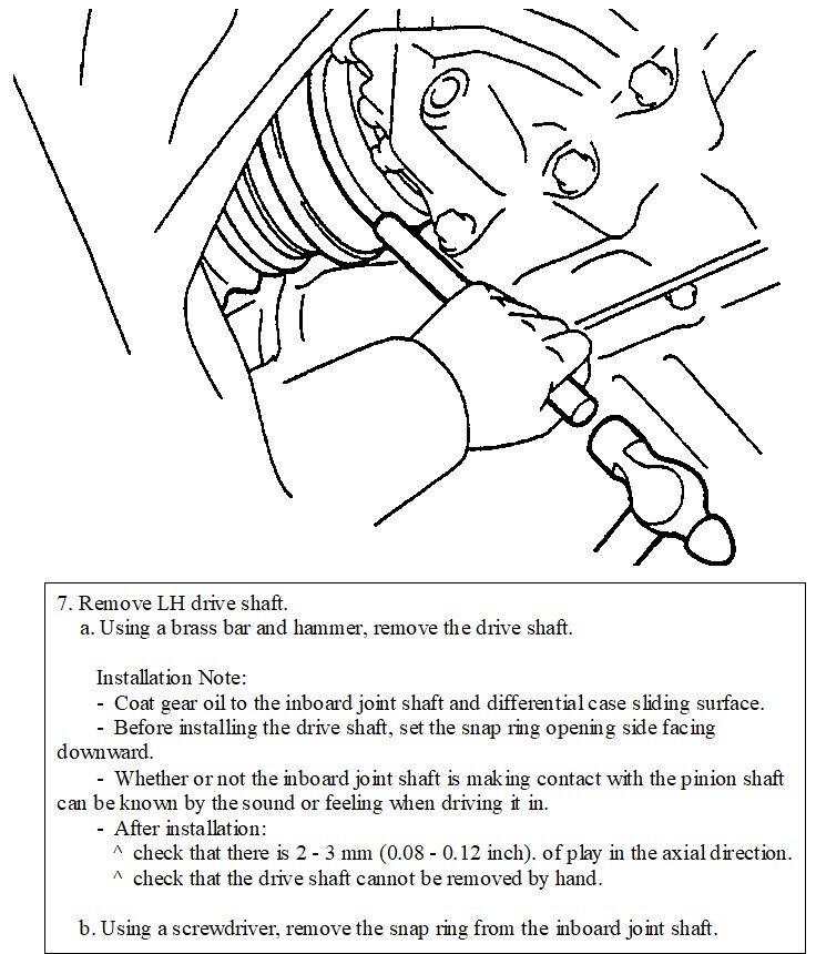

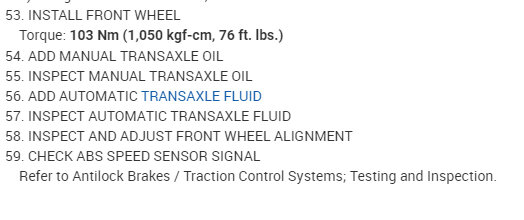

See pics below. Note: in pic 5 it says to hold the brake to remove the axle nut. If you don't have a helper, use a strong chisel or screwdriver and slide it into the rotor cooling fins and allow it to press against the caliper mount (not the caliper) to remove and retorque the nut. Also, note there are two highlighted areas in the pics. Between the two highlighted areas are the directions for removing, OH, and replacing the CV joints and boots.
Dec 7, 2022 at 11:33 AM
CARADIODOC
  • 34,388 POSTS
Hi Joe. I couldn't find the instructions for replacing just the boots on AllData. Also, I forgot to stress the importance of proper torque on the axle nut. One kick in the pants for me. If not tightened sufficiently before the car's weight is set on the tire, it can lead to a noisy, buzzing wheel bearing.
