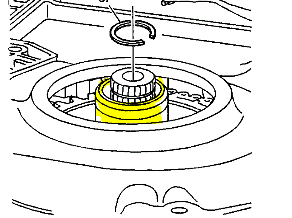

The seal can be nicked or damaged by the shaft. Just inspect it for any imperfections. Also, make sure to lubricate it with transmission fluid before installing the axle.
Now, I attached a pic below. I highlighted the output shaft sleeve. Is that what came out?
See pic below.

Thank you, Joe. Yes, that's the part that came out it does not want to reseat. What can I do?

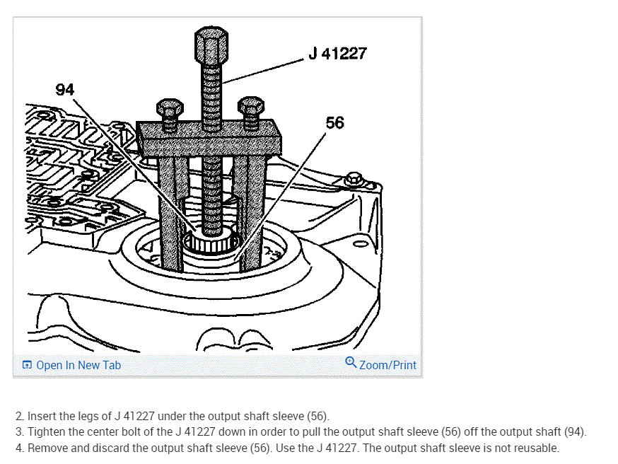

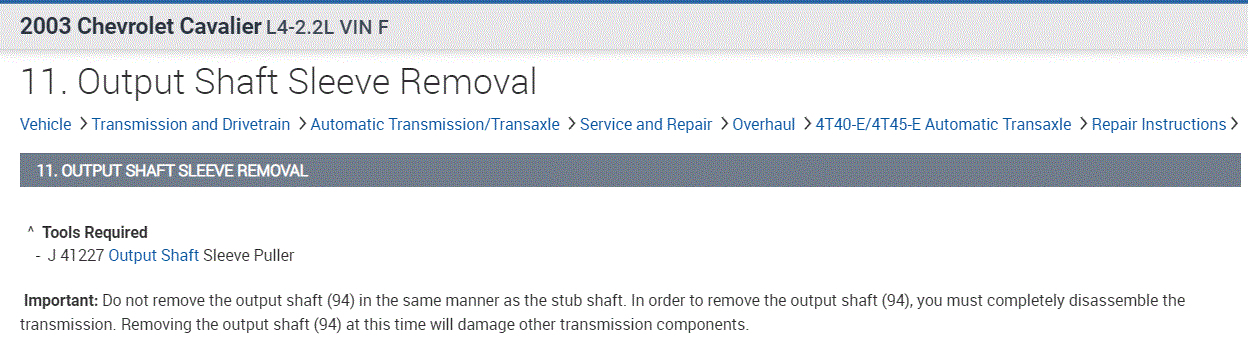

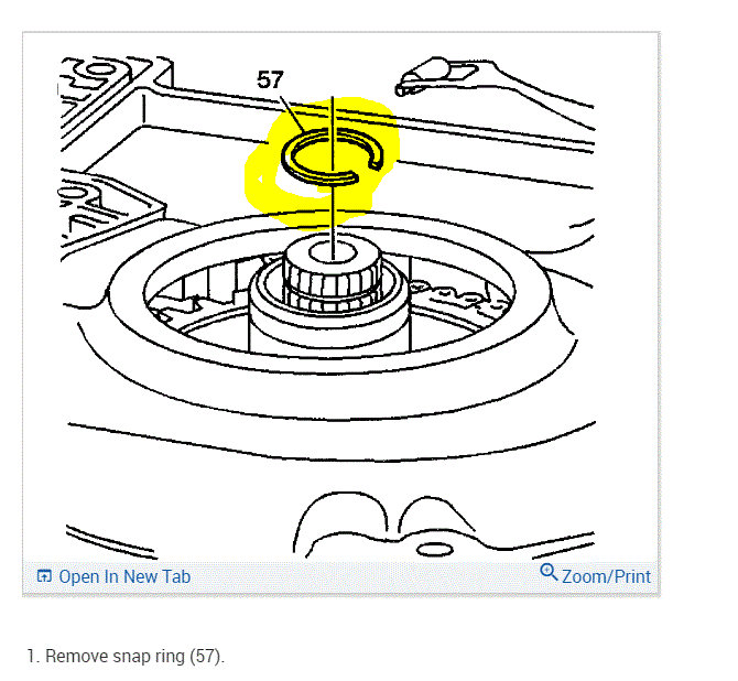

If the sleeve is what came out, first, it can't be reused. It must be replaced. Second, there should be a snap ring on the stub shaft (part in the transmission that the axle splines into) that has come off.
Do me a favor. I attached the directions for the removal of the sleeve. Take a look through them. The directions mention the snap ring. Either it fell off or you are trying to install the sleeve over it which is preventing it from fully seating.
Let me know. Note: These are the removal directions. Installation is the opposite. There is a special tool that is used to fully install it. It is GM tool number J-41228. You may find a parts store that can lend one to you, but they really aren't too common. The directions mention a specific puller. Since it is already loose, that shouldn't be needed.

If you are only removing the sleeve, the transmission doesn't need to be taken apart. If it is already loose, you should be able (once the cv axle is removed) to remove the snap ring and remove it. However, you will need to replace it. The directions indicate not to reuse it.
If I had to guess, I suspect that is because it would get damaged by the puller, but you won't need to do that since it's already loose. Also, I have a feeling the snap ring was lost at some point which led to the sleeve coming loose.
