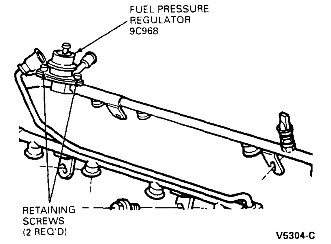

Now I'm thinking it's the fuel pump. But before I get there...I test the fuel pressure. 0. So, I changed the Fuel Pressure regulator. I gave the tool back, so I actually never tested the pressure after that. But still the same problem.
