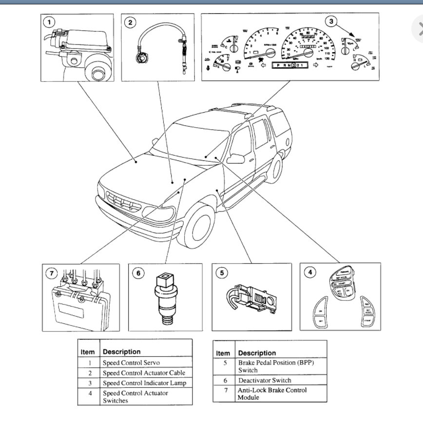

If this is the case, then this is most likely one of two issues. First and foremost, it is the brake switch or deactivation switch.
The brake pedal switch is on the brake pedal arm, and it tells the vehicle if you are pressing the brakes. Sometimes these stick on slightly and if it thinks you are pressing the brakes then it will not turn the cruise on.
You can test this by checking the voltage coming out of the switch. It should be an open circuit unless the brakes are pressed.
The same thing with the deactivation switch. When this fails, it thinks the system needs to be turned off and so it won't allow you to activate it. This can be tested by just unplugging the sensor and jumping the switch terminals in the connector to see if the cruise comes on.
The other common failure when the light comes on in the dash is the servo. Basically, it just doesn't engage the cruise.

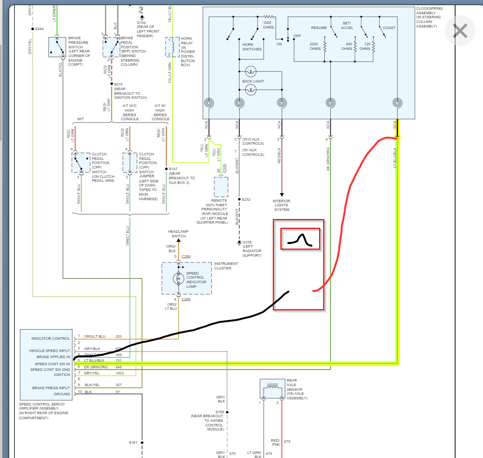

Please see the info attached for this including the wiring diagram so we can start testing if needed.
Please see the attached below and let us know what you find with this.

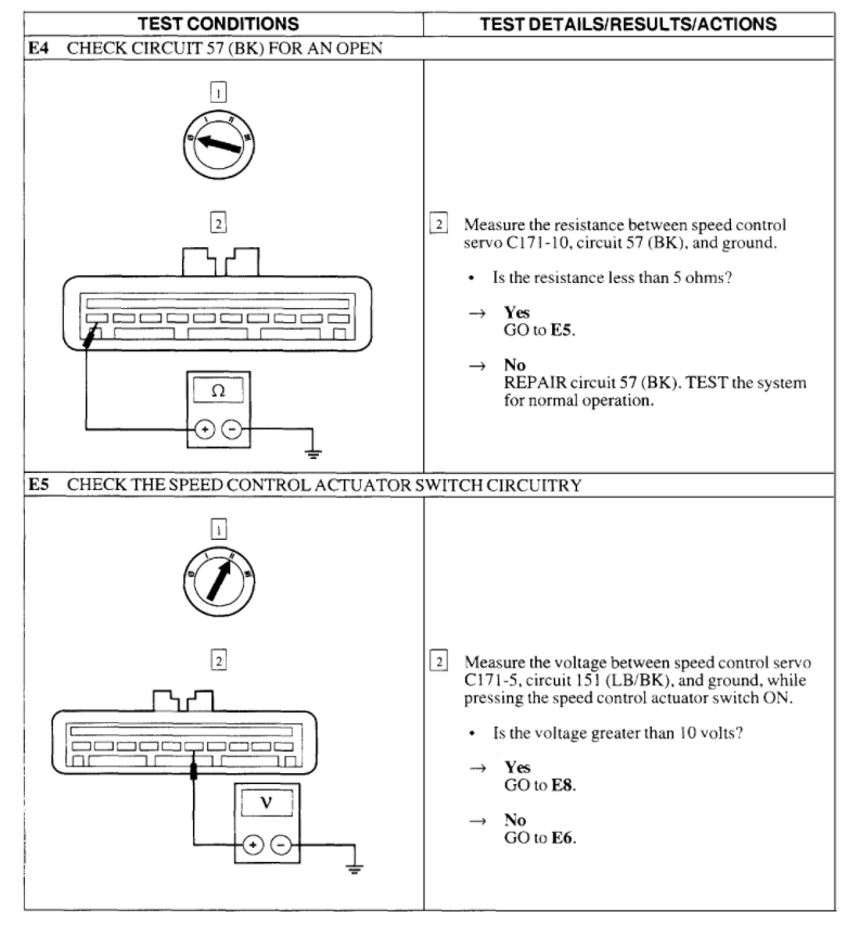

the light on the dash does not come on when you push the on switch on the steering wheel. but if you hold the off switch and turn the key on off then on then push on then resume then cost then set the light comes on and blinks three times. i changed the brake light switch today but no light. I checked the switch on the brake master cylinder and i got continuity and pushed brake and then no continuity brake lights work fine. so, this tells me I have power, correct? where do i go from here?

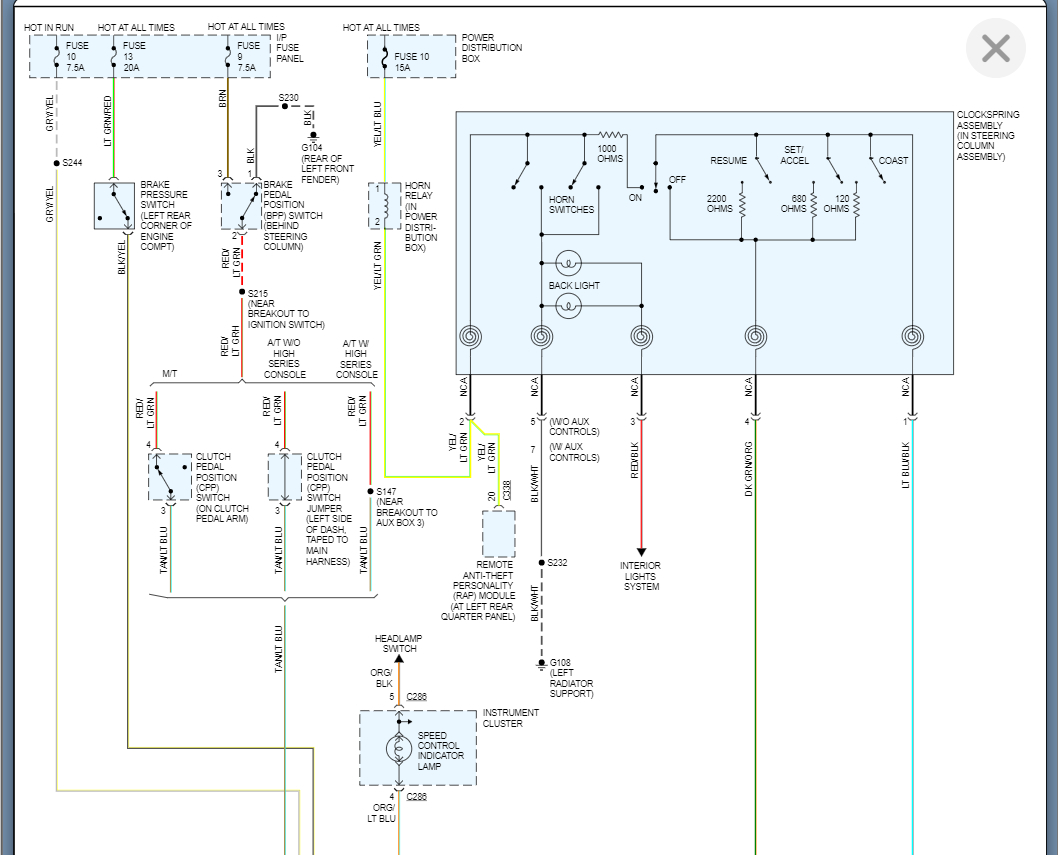

Okay. That is great info. Normally this is a switch issue but if you replaced them and you can press these buttons and get the light to come on then that shows the buttons are working and at least getting power to the servo.

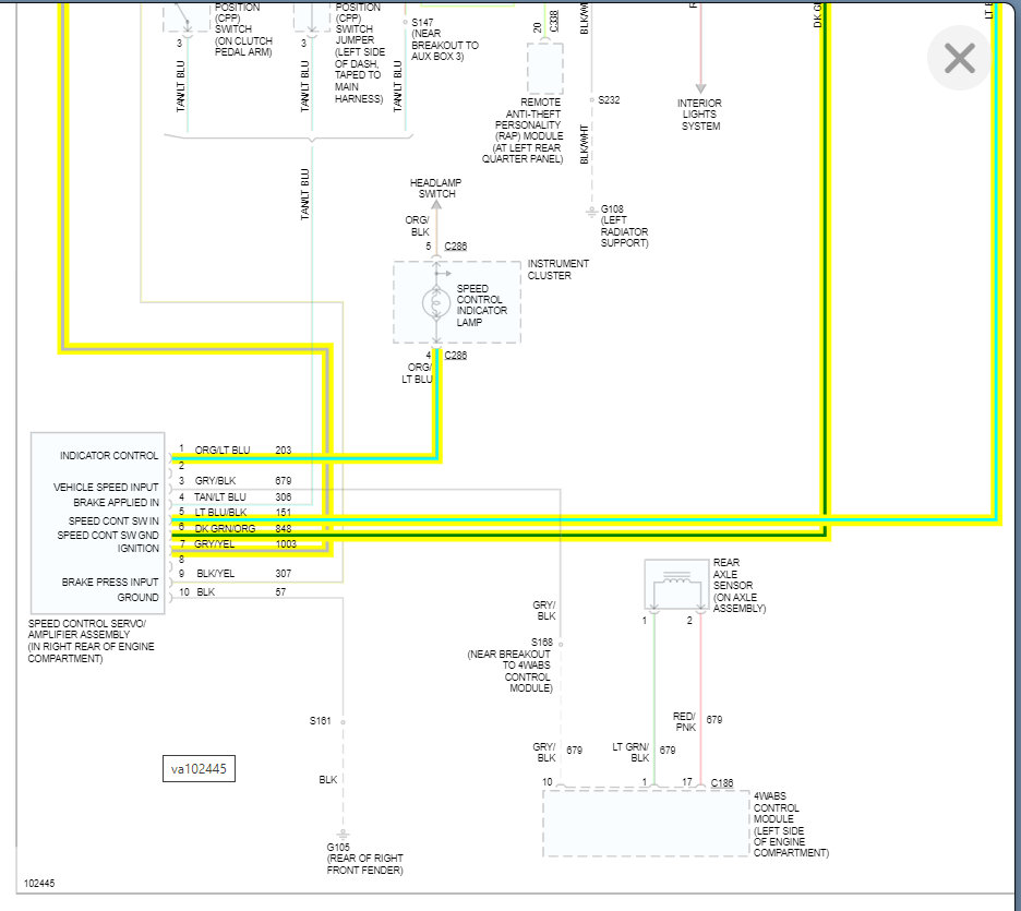

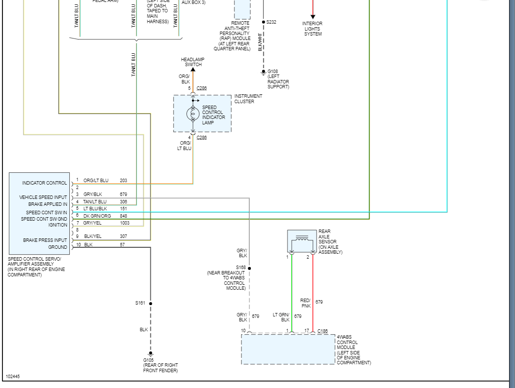

However, we need to just jump to the servo and check the power on the highlighted wires below. The complete wiring diagram is above but we need to check the voltage and make sure we are getting proper voltage on each one.
Test the switch circuits when you are pressing those buttons on the steering wheel. Then tell me what the voltage is on the other circuits, and we can go from there.

wire #1 indicator control 10v , wire # 5 speed control switch 5'7 volts, wire #6 4 ohms resume 6 ohms on set and 7 ohms on coast, wire # 7 11.2volts the light still not on and I know lamp is goon when I did the test the speed control actuator cable is supposed to move and it does not .cable not broken i checked that what do I do next. is the servo bad?

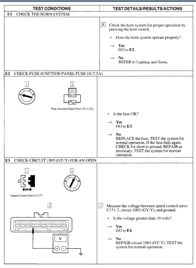

I assume when you said ohms when pressing the resume, on/set, coast buttons, you meant you have 4, 6, and 7 volts? Basically, the way this works is when you press these buttons the voltage signal runs through different resistors that changes the voltage that actually makes it to the servo and based on this voltage it knows what button you are pressing.
If this is the case, then yes you have a servo issue. Just to be sure, I would check the last three wires.
Number 7 should have battery voltage which appears you do. I would just check this using pin 10 as your ground for your meter just to make sure the module has a good ground. Basically, checking the voltage on pin 7 to pin 10 you should have the same 12 volts.
Lastly check voltage at pin 9. If you are not pressing the brake, then you should have an open circuit. However, this is not going to prevent the light from coming on.
If the cruise is engaged and you hit the brakes, then the light should stay on, but it just disengages. So, I assume the brake input is fine, but it is nice to make sure.

Correct. I think the servo is the issue.
What happens is, you press the buttons, and the servo sees those button presses. Then the servo engages the throttle and holds it in place, and it turns the light on by grounding that circuit.
The fact that you have 10 volts on pin 1 shows it is not grounding the circuit. If the lamp was on, then you would have very little voltage at the servo because the bulb is using it to illuminate.
So basically, we know the servo is getting the commands from the buttons to turn on the cruise, but it is not doing anything. So everything going into the servo appears to be correct, but the servo is not doing anything.
This is one of the most common failures that causes this issue so if it were me, based on this info, I have seen enough to replace it.

Okay. I didn't notice this before because you said that the buttons all made the light come on when you did this test of turning the vehicle off while holding the off button.

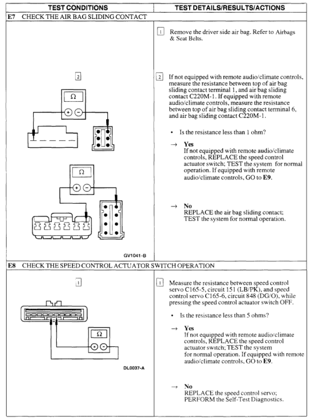

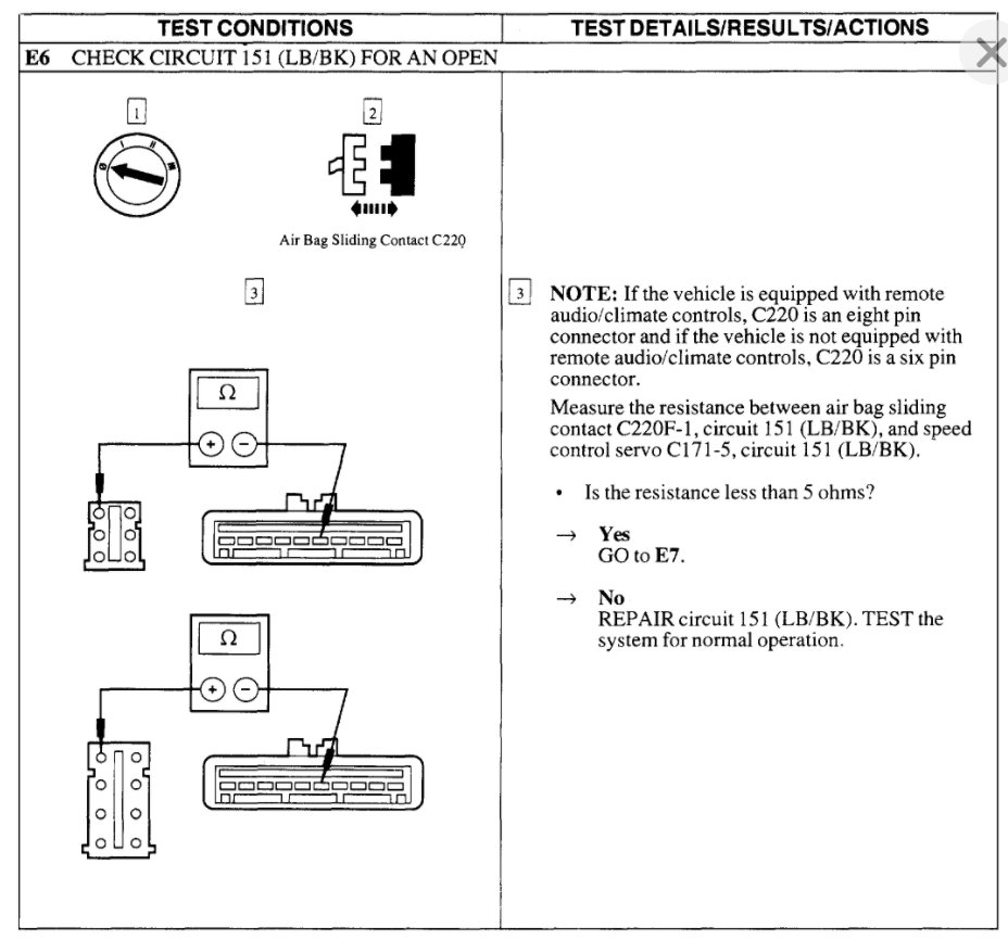

However, you said that at the servo on pin 5 when you pressed the on button you had 5.7 volts. Is that correct?
If so, follow this testing through because what I see is you get to step E5 and the answer is no. Then you go to E6 where you are checking the circuit through the clock spring.
This would make sense because you have voltage so the test where the lights all respond "passes" because you are getting voltage. However, the servo is not going to turn this on because it needs to be over 10 volts. This appears to be what mislead us.
Run through this and make sure you are getting the same thing. Thanks

you lost me at e6 i do net know about remote autio 6 pin and 8 pin and were do i find them also the air bag sliding connecter messing with airbag not sure about.

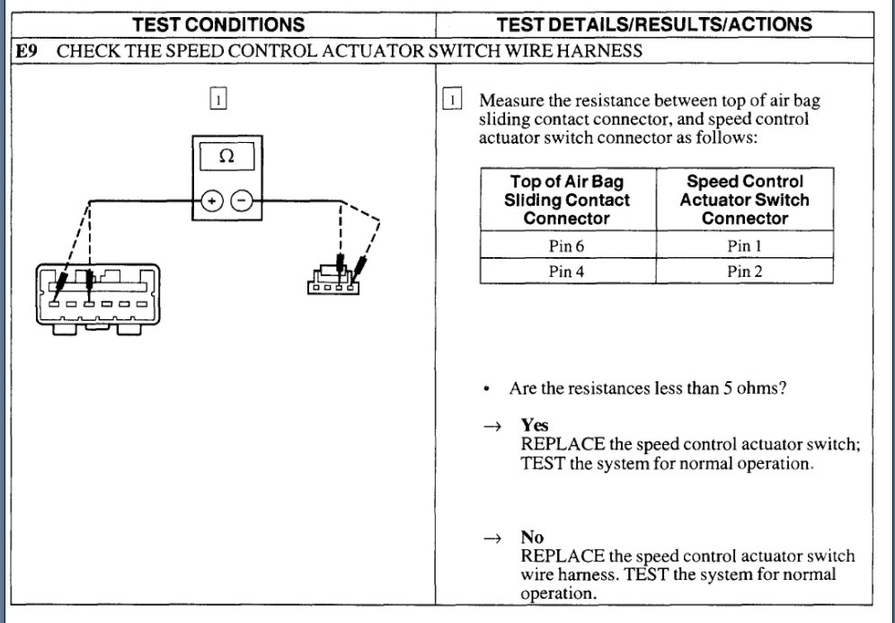

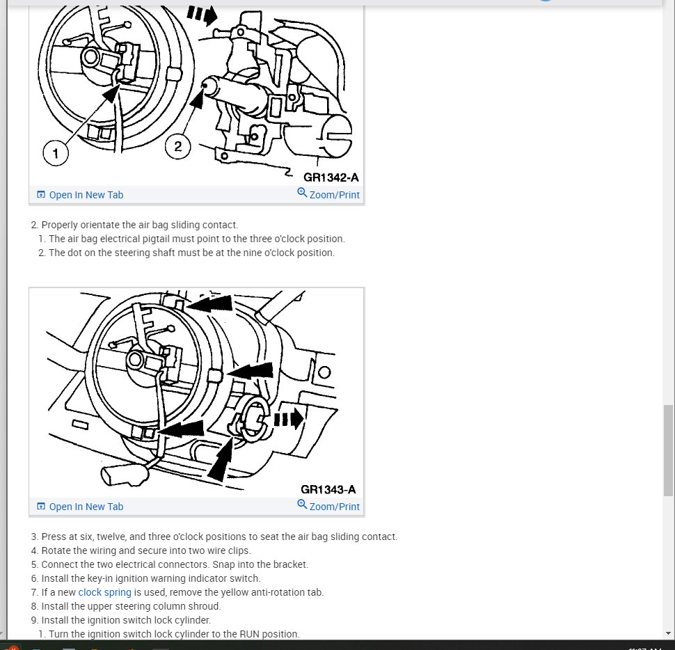

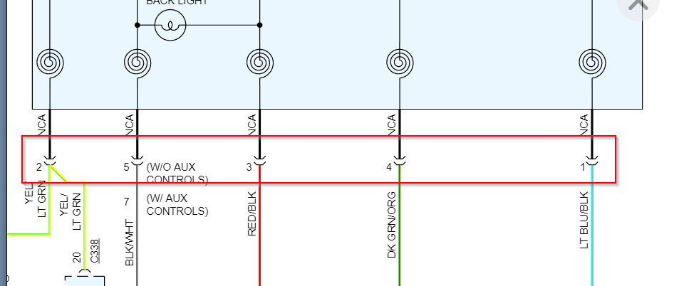

Sorry. This is the connector that goes into the clock spring from the servo. Basically, what you are doing is checking the circuit from the clock spring to the servo to make sure the wire is okay. If this is okay, then you have an issue with the switch or the clock spring and most likely the clock spring.
The fact that you are getting 5.7 volts on this circuit when you are pressing the button means you have high resistance in the circuit. I would double check this on pin 5 at the servo just to confirm we are not going off incorrect info.
You should have over 10 volts in order for the servo to turn the system on. You have some voltage, so we know the circuit is intact, but you have high resistance somewhere that is causing the voltage to drop in half.

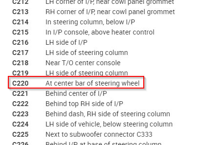

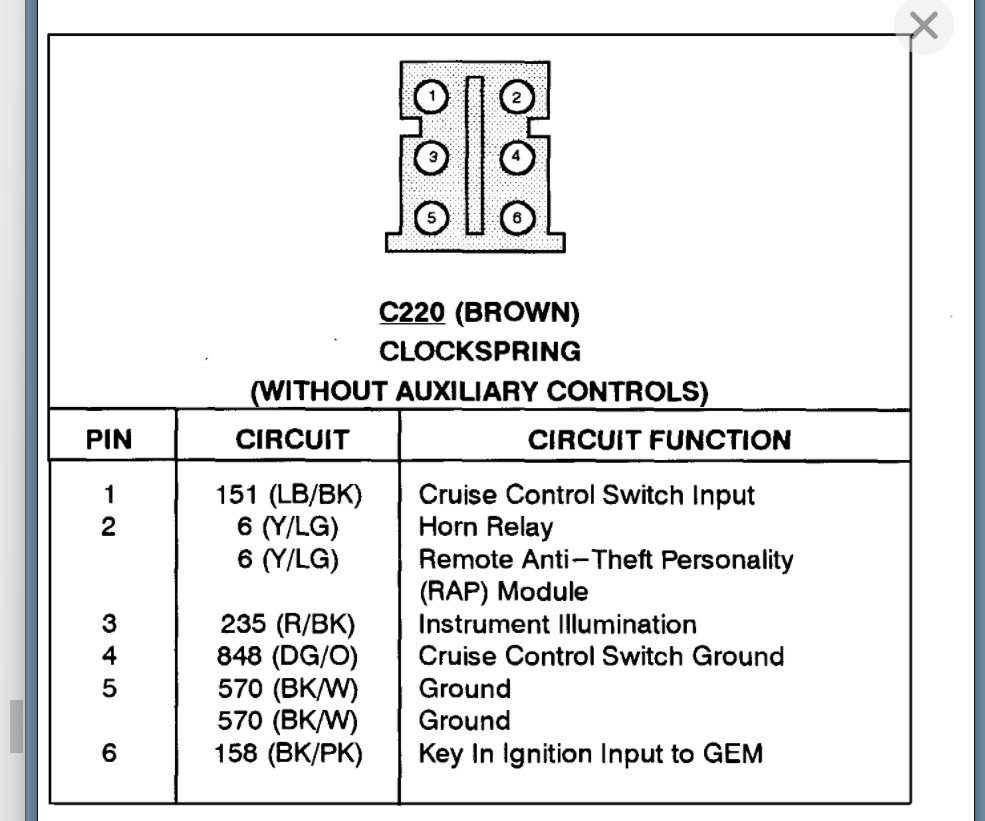

To try and illustrate this, using words the circuit starts at the switch on the steering wheel. When you press the button, it sends voltage down through the clock spring to the c220 connector where the LB/BK wire takes that voltage to the servo. What you are testing is the wire that leads to the servo to find out if that is the source of the high resistance. If it is not, then the clock spring would be the issue.
However, this is just putting the pieces together and requires testing to confirm this.

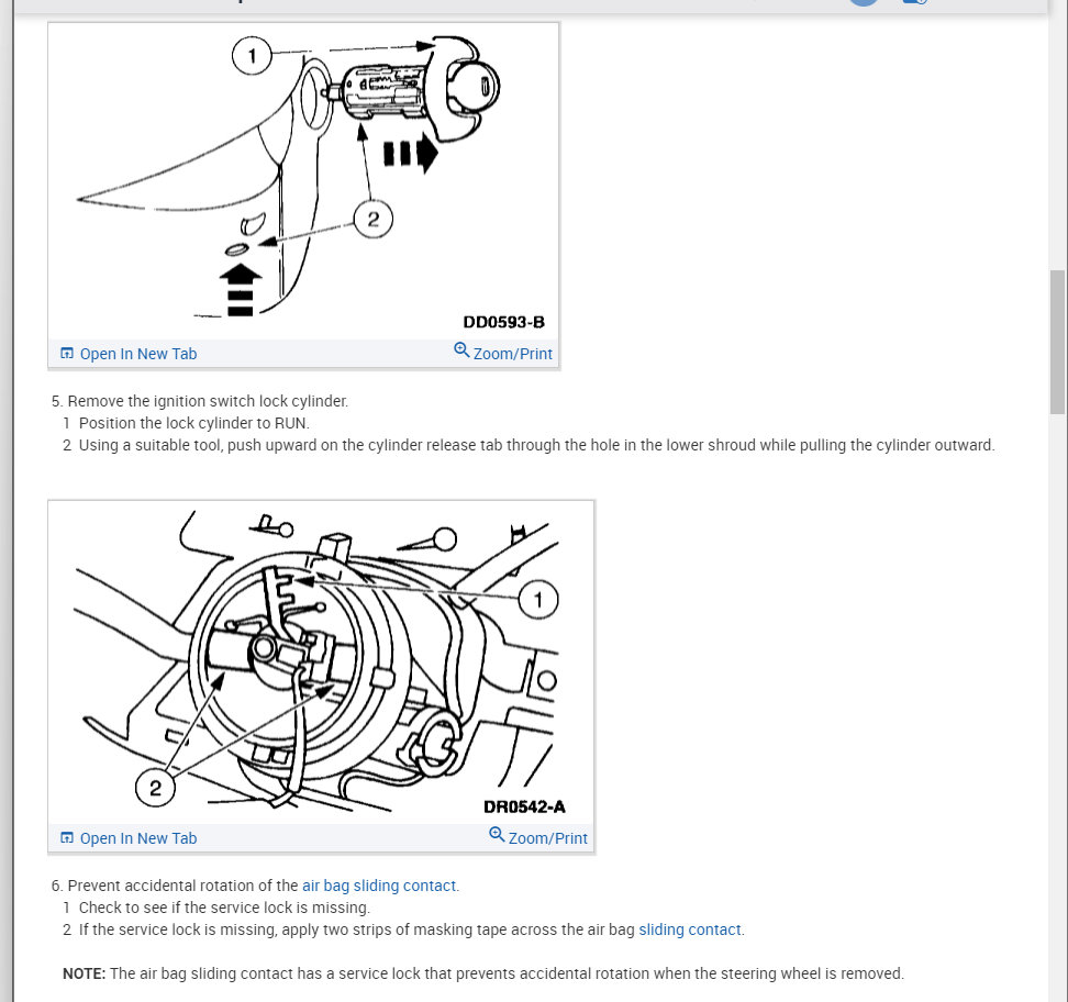

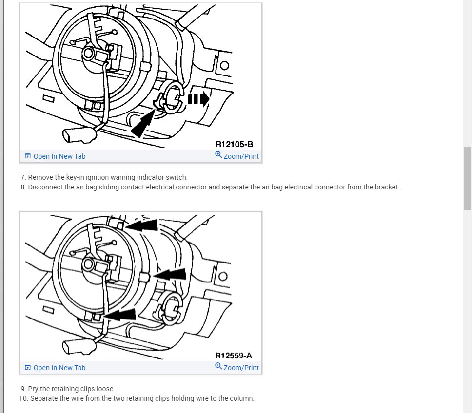

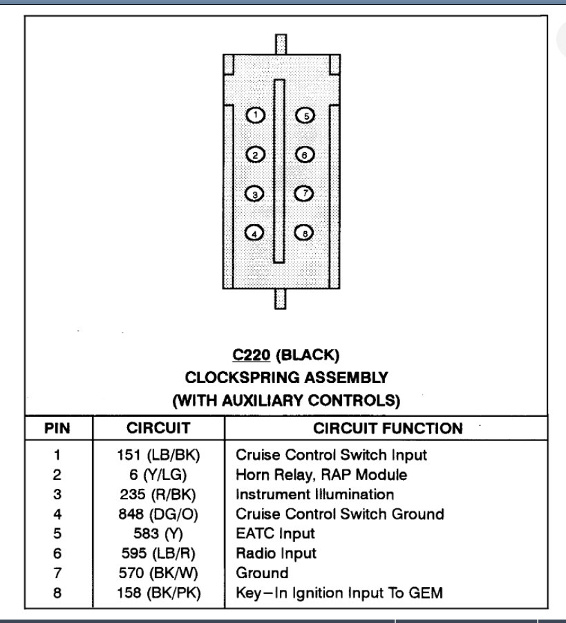

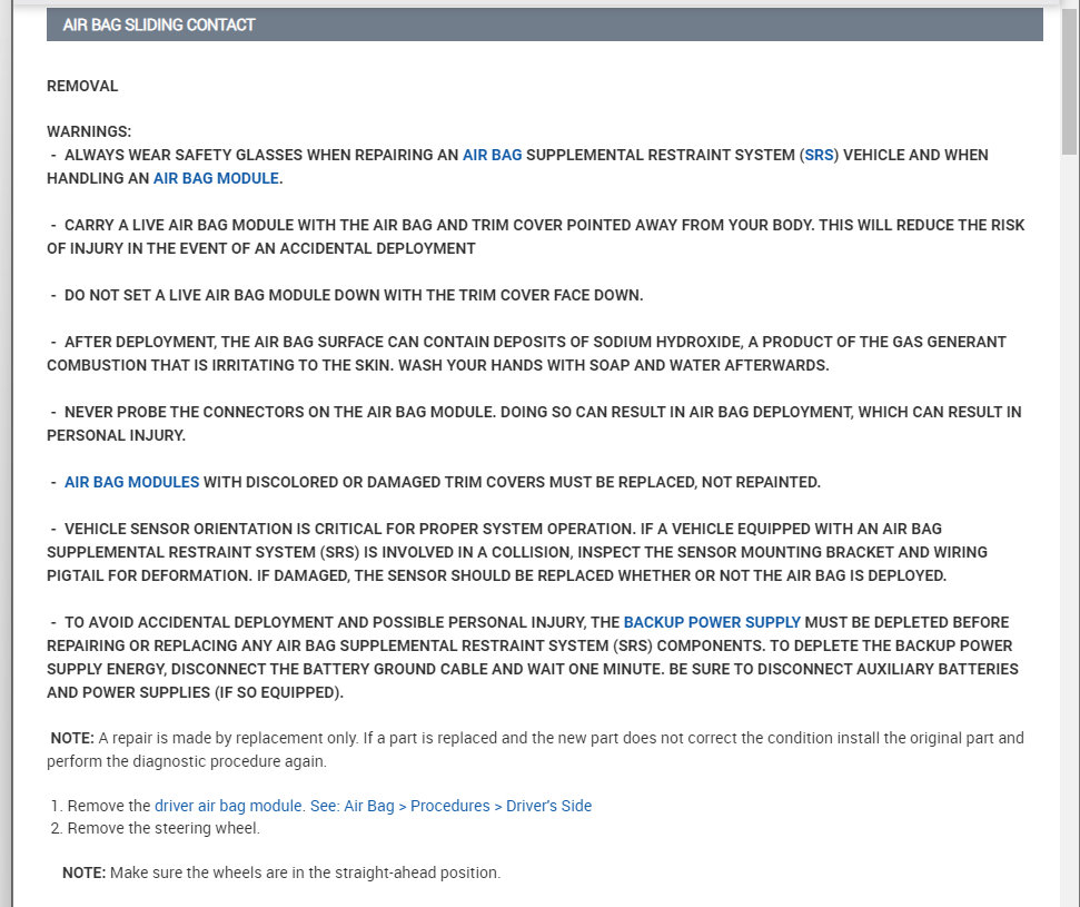

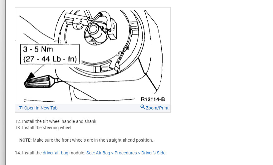

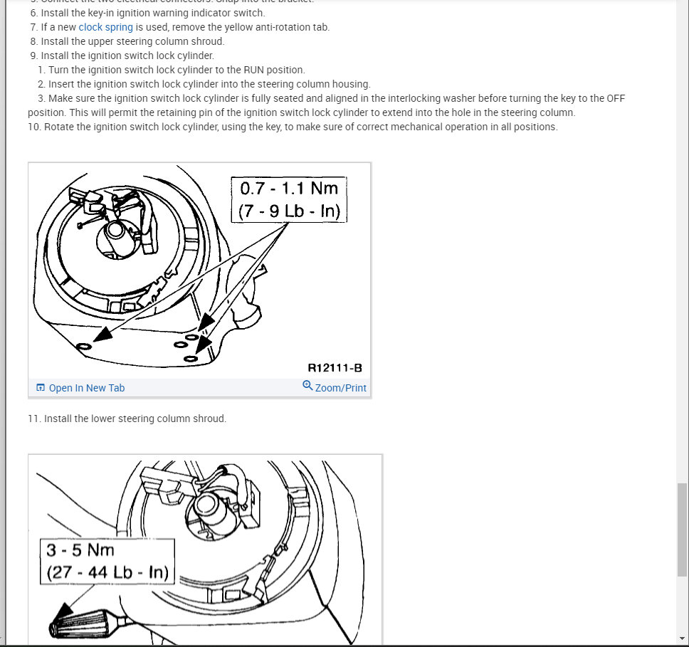

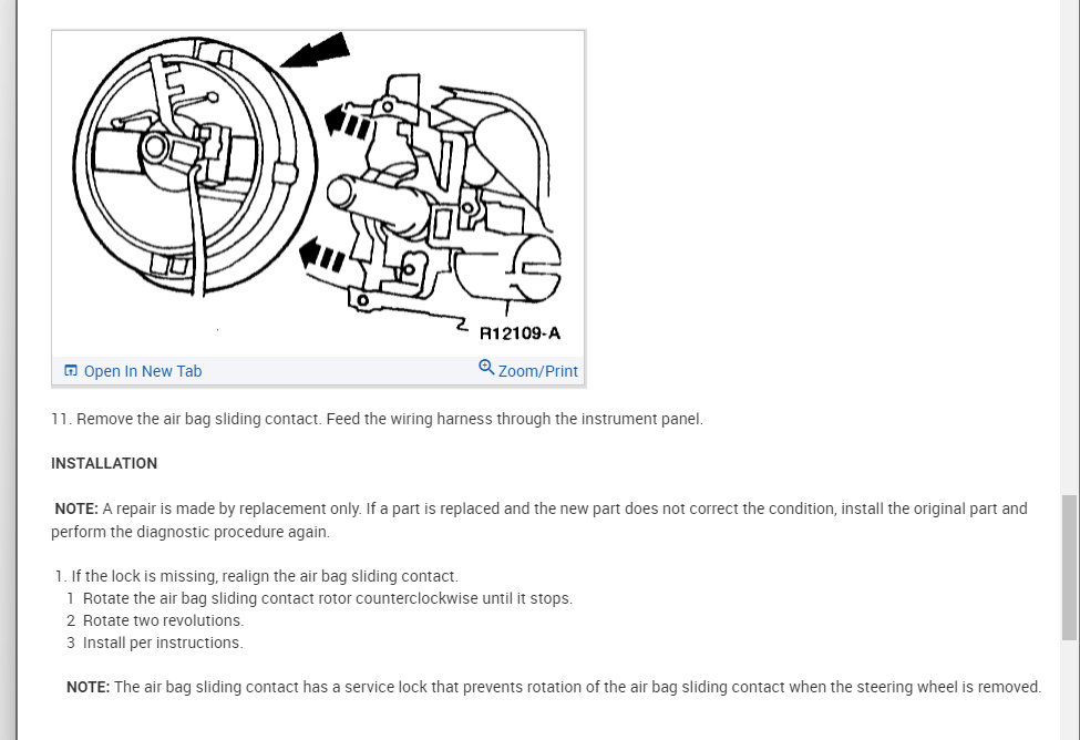

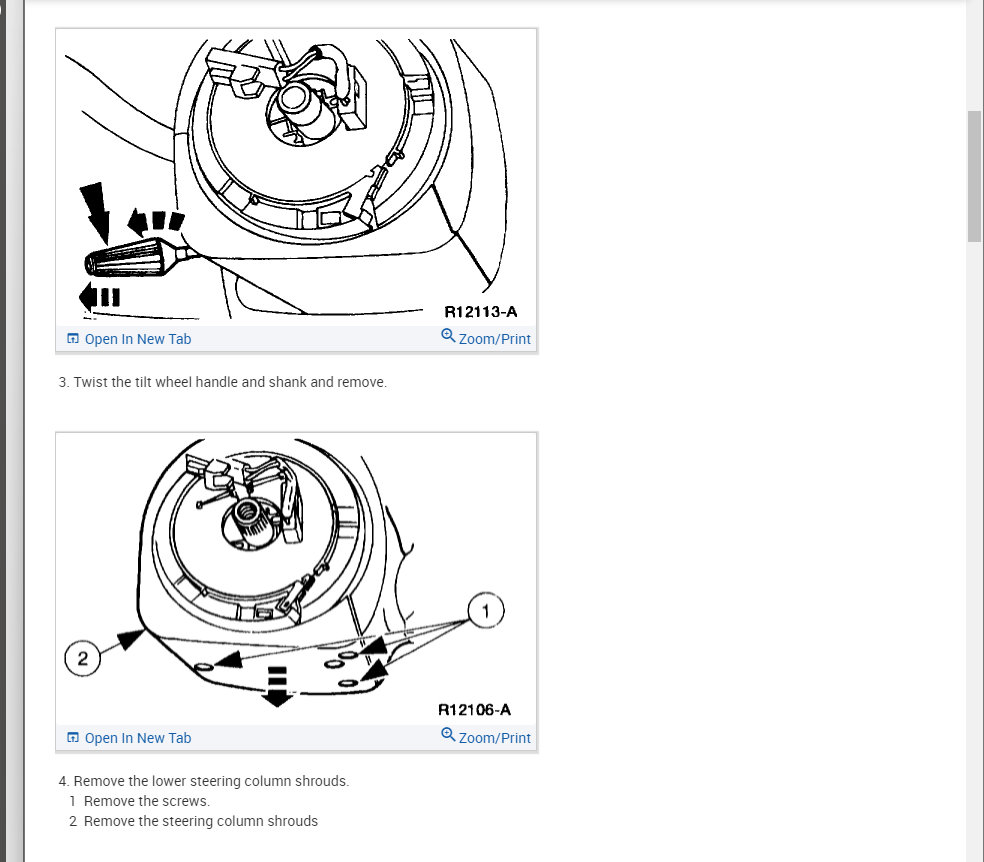

I am attaching the process on how to replace the clock spring. You will see the connector in this process. Also, the connector view depending on if you have aux controls or not. However, both connectors have this circuit in pin 1.
So, you are checking the resistance by putting one meter lead on pin 1 in the C220 and the other lead in pin 5 of the servo connector and checking the ohms. Both connectors need to be unplugged and you are literally checking just the wire and you should have less than a half ohm on a wire like this.
