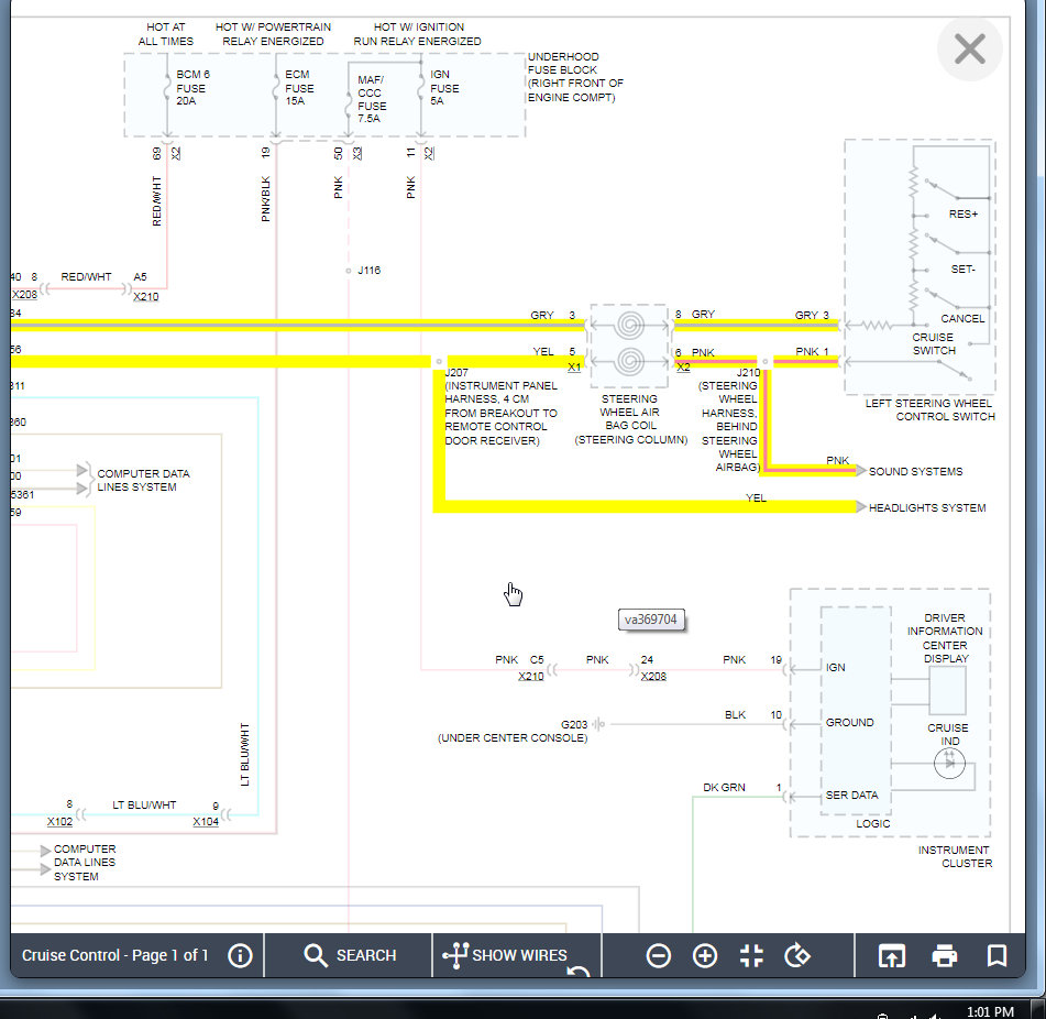

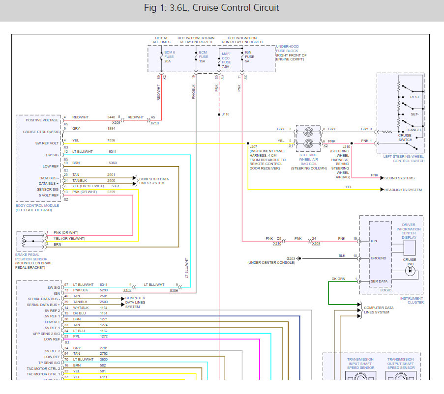

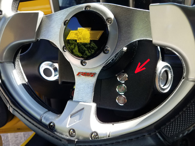

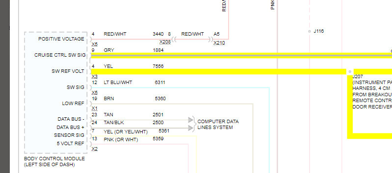

Being i changed my steering wheel to a custom wheel, i lost my cruise control. I need to wire up new switches on the dashboard. I need to know which wire is the ignition, cruise on/off, set, resume and accelerate, whether in the column or under the dash. I bought 3 LED switches. One on/off and two momentary switches. I believe the ignition wire needs to be connected to all switches other the correct wire to control that action. Thank you.
Jun 9, 2020 at 2:10 AM

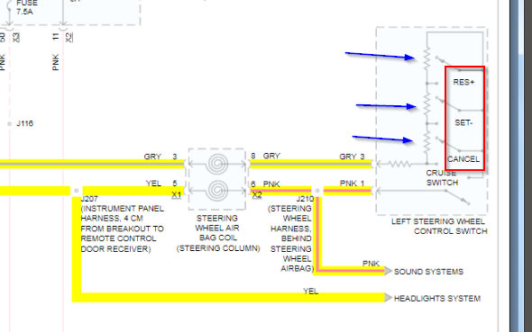

You may have a bit of an issue with your planned set up. The reason I say that is the cruise is operated by varying the voltage on the Cruise Control Switch Signal in the BCM.
Basically the cruise is set by the "On" button on the wheel and it sends a 5 volt reference to the BCM to tell it to turn on. So this will work by using a simple toggle switch.
The "Set" "+" "-" buttons are all operated off of resistance. This means the BCM sees a varying voltage and depending on the voltage it knows what -speed to set the cruise control at. As you press the "+" or "-" it increases and decreases the resistance which changes the voltage that the BCM sees which tells it to increase or decrease the speed.
Does that make sense? Check out the diagrams (Below). Please let us know what happens. Let me know what questions you have. Thanks

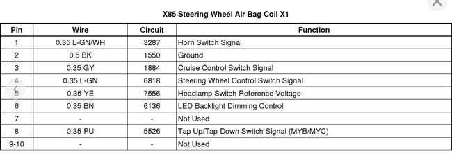

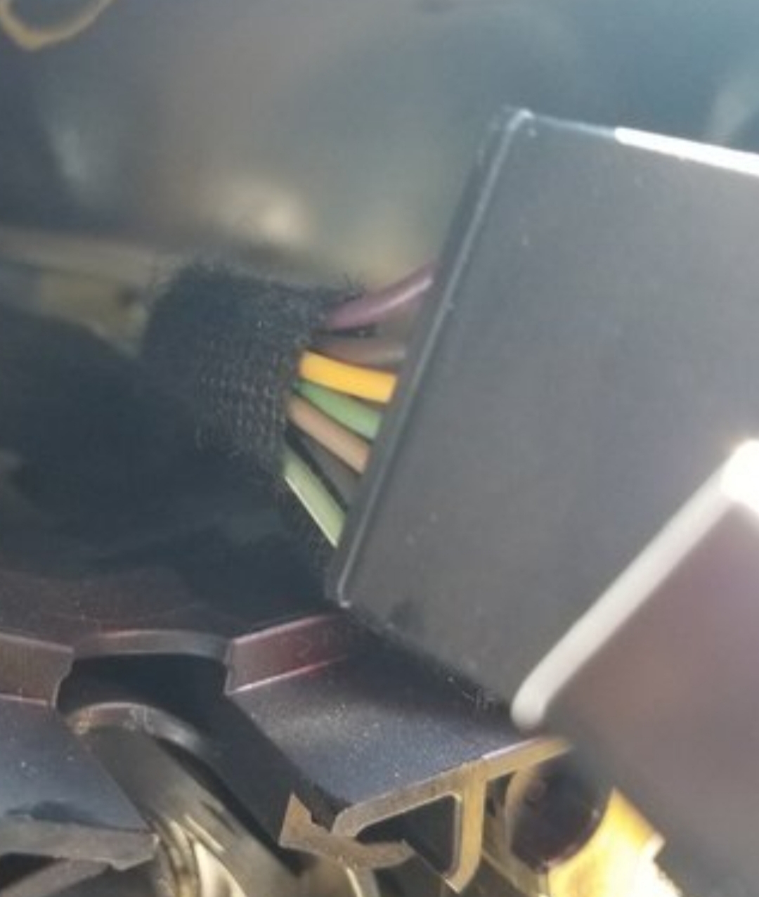

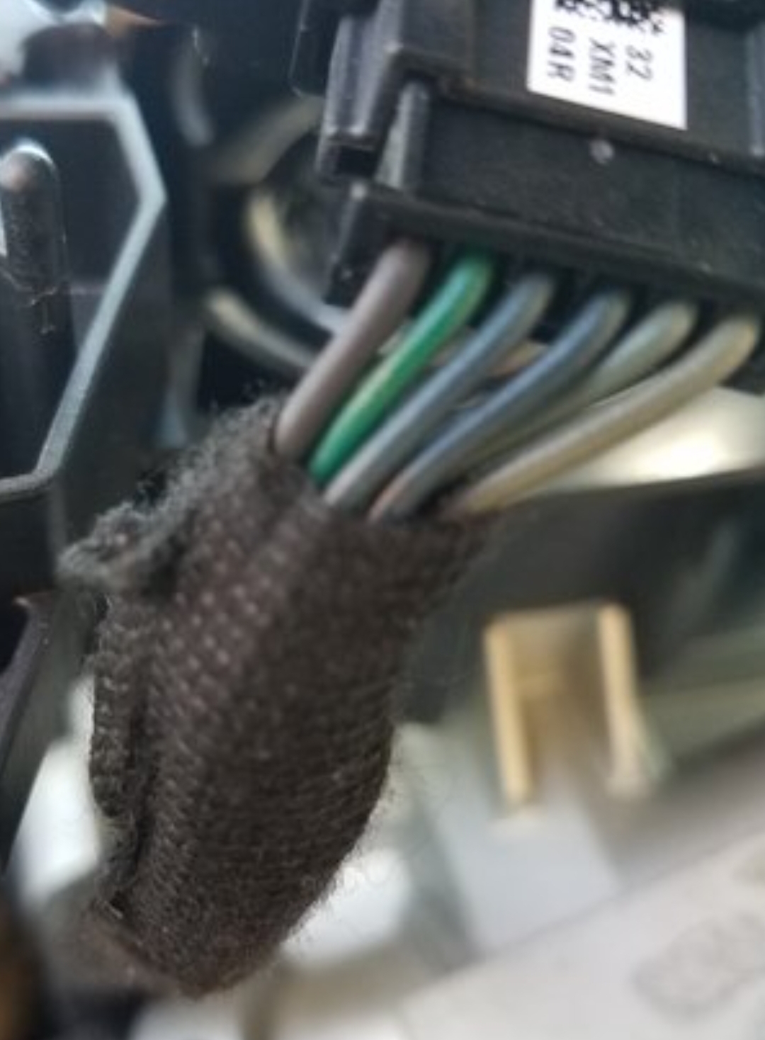

I was wondering if you could tell me which wire colors go to each function of the cruise control. I believe the plug that contains these wires lie underneath the clock spring. From what I was able to get off the internet, a gray, a dark blue and a gray with a black stripe are the correct colors, though I'm not to sure about that. I attached a pic of the wire cluster. If I knew which went to what, I can hook this up easily. I also need to know the 12v ignition wire color because it gets hooked up to each of the 3 buttons. Thank you so much for your help on this.
Jun 11, 2020 at 5:01 AM
I think we can figure that out. However, can you get a little further away so I can see what it actually plugs into? From what I can tell the gray wire is the cancel/set/res buttons but I would like to try and get the connector view of this connector but I just need to know what it hooks to.
Jun 11, 2020 at 12:04 PM
ROBERT MASELLI JR.
  • 52 POSTS
The connector is connected to the bottom center of the clock spring, but does not rotate with it.

If you do find the correct 3 wires, plus the ignition wire, here's my other mind boggling thing. The guy that did this on his Honda had an orange wire that provided the 12v constant power. He wired this to one terminal of the switches. The corresponding Cruise control wires were connected to the other terminals. All of these wires were on the column right near the ignition. He used 2 terminal switches. I will be using 5 pin Halo switches which need a positive and negative to light up the switch. I know what all the terminals on the switch are for, but need to know how to wire this. Take your time trying to figure all of this out. I want to get it right on my first attempt and really appreciate all of the help you are giving me.

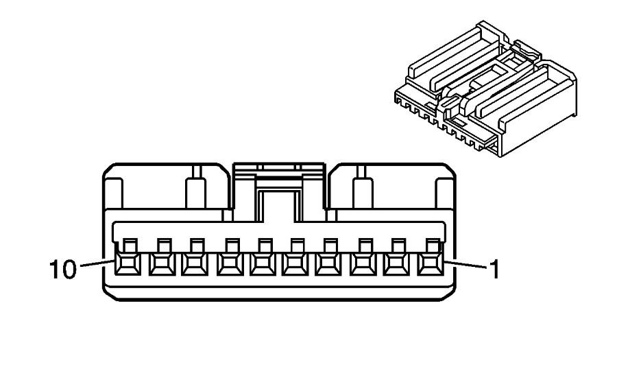

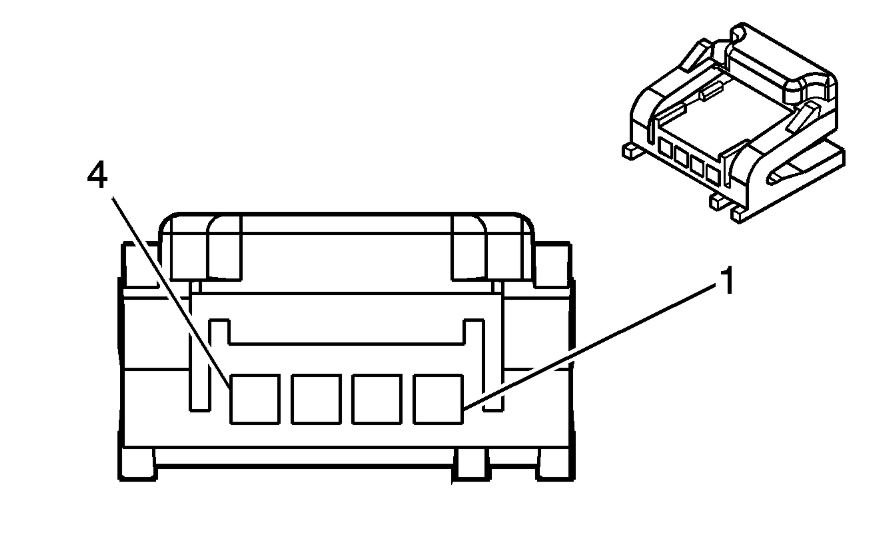

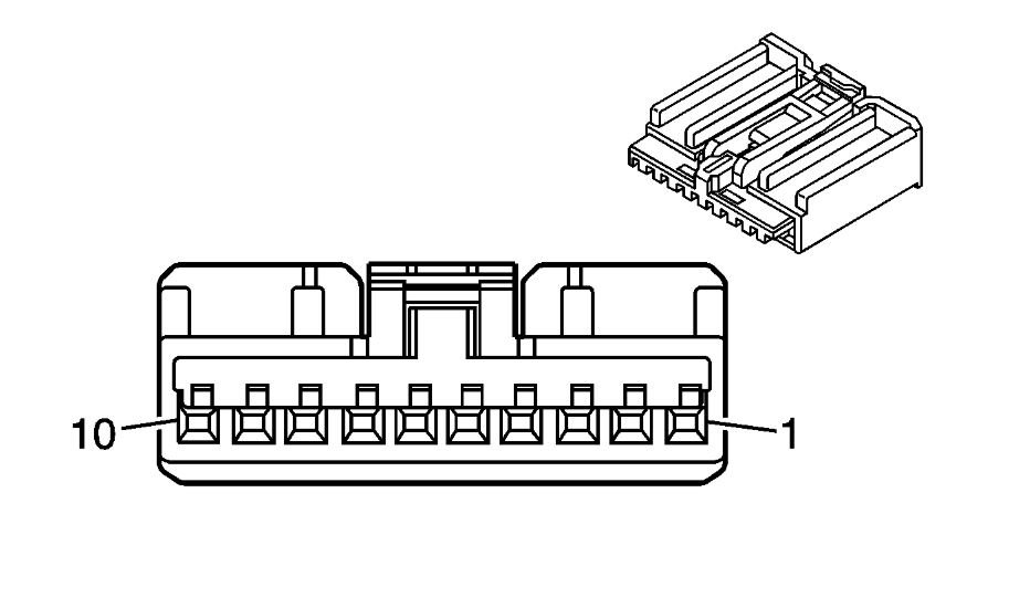

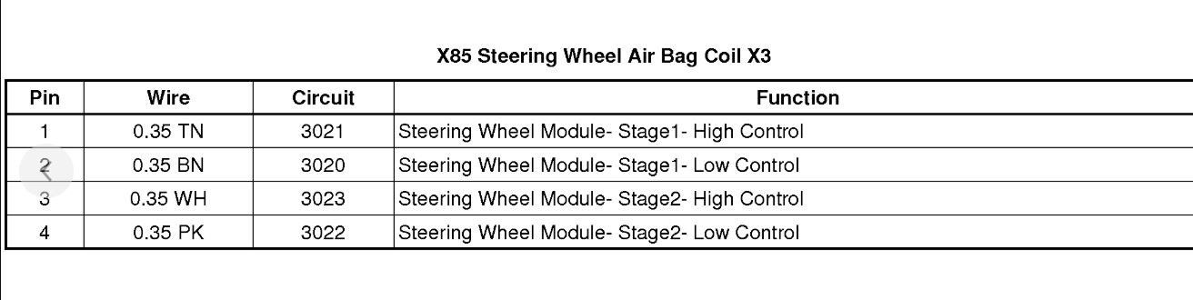

How many total wires are on that connector? Is it just 6? I show three connectors on the clock spring. 2 of them have 10 connection terminals (not all filled) and the third has 4.

Sorry for not getting back sooner because I've been a bit busy. The pic I sent you was the terminal on the bottom of the clock spring that doesn't rotate with it. Then there are the 2 airbag connectors and the other is the female side of where I unplugged the steering wheel from. This connector does rotate with the wheel and is where I found the pins to connect my horn. I believe there is another connector behind the clock spring, but I didn't need to remove it because the new NRG Hub accommodates the clock spring when installed.
Jun 15, 2020 at 8:13 AM
ROBERT MASELLI JR.
  • 52 POSTS
My mistake. The lower plug does have 6. The top plug that rotates has 7.

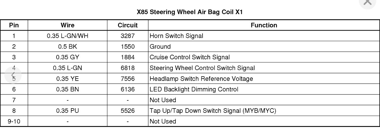

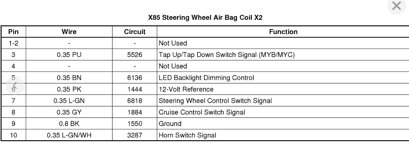

If I can throw in my 2 cents, I attached the connector diagrams for the clock spring.
Can you verify the connectors on the car side?
Jun 16, 2020 at 5:09 AM
ROBERT MASELLI JR.
  • 52 POSTS
Your second diagram corresponds with the plug on the clock spring that rotates with it. This is where I found the positive and negative lead for the horn which is in pic number 1 from me. The other plug is bottom dead center of the clock spring which doesn't rotate with it. Pic number 2 from me. I am at work right now and can't provide you with other photos other than past ones from the last project you helped me with.

The other 4 pin connector in your pic might be behind the clock spring. There are other plugs behind it that need to be disconnected if I were to remove the clock spring, but my new hub accomadates the clock spring inside of it and I have it all wired nice and tucked away from the horn project.

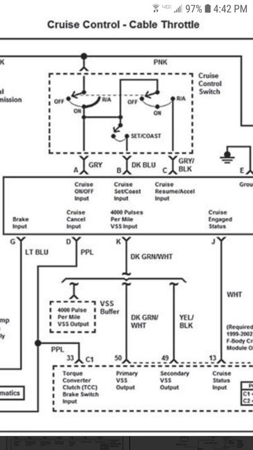

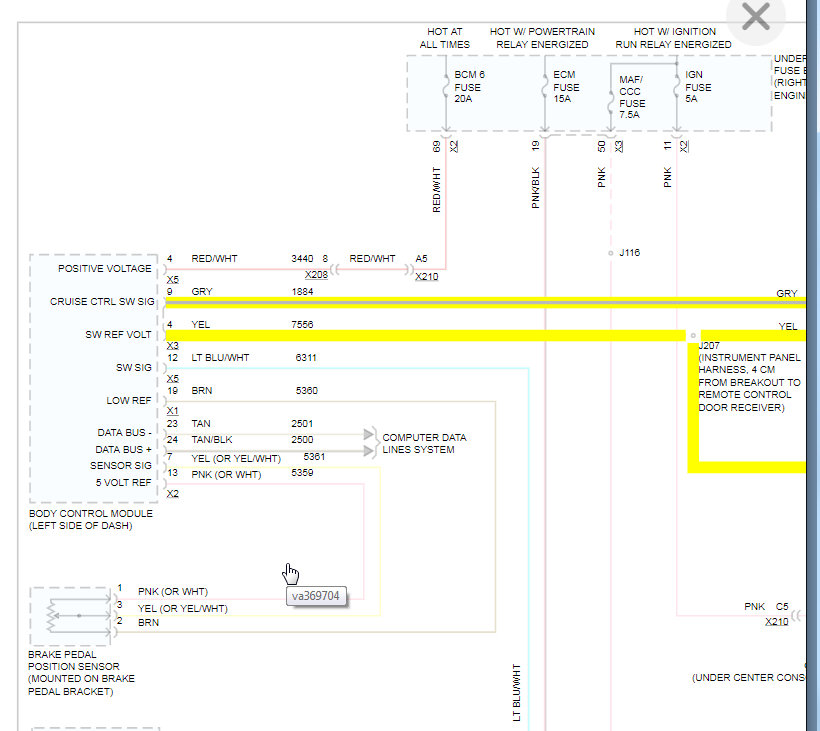

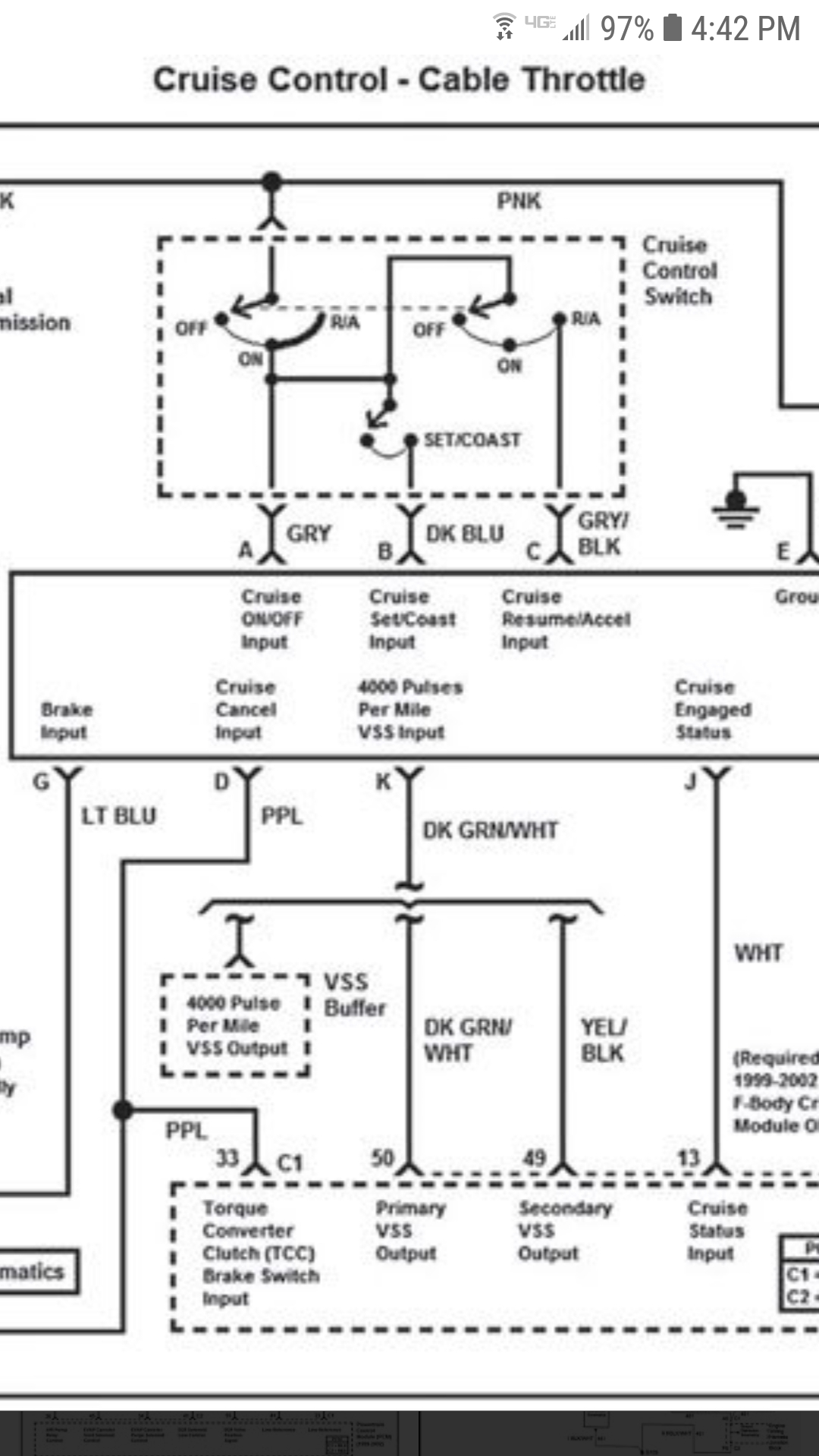

Hello Roy, hope I'm not being a pain. I thought you were going to get back to me with more info. Here's a diagram that I found online for the present GM Cruise Control. On top you'll see the Cruise Control Switch and the color wires that go to it. Also is the pic again of the lower connector to the clock spring that doesn't rotate with it. Are those the correct colors wires you are seeing in the diagram and can they be found in this connector. What's throwing me off, is can't tell the if one of them is blue because they seem faded. If I knew what each of those wires go to, I can figure this out. The other diagram you sent me, which is the connector that my horn is attached to, shows 1 gray wire for the cruise control, but I need 3. If you can be some help it'd be awesome.
Jun 23, 2020 at 4:59 AM
The very first response form the other tech had the cruise diagram.
Do you have more than one connector at the clock spring from the body?

The diagram you sent me shows only one gray wire for cruise control. The other one you sent is for the 4 pin connector, which I don't know what any of those are for. I'm just looking for the 3 correct wires. 1)On/Off, 2)Set, 3)Resume/Accel. They have to be together somewhere. The other guys diagram shows only 2 wires. A gray and a pink.

Yes, I received these. You sent 6 diagrams where 2 of them were doubles. So I got 4. After looking at that, which is why I contacted you again, is because other than the pin that says Cruise Signal (gray), I haven't the slightest clue which the other two wires I need are. No other pins in the diagrams say anything about cruise control.

Roy, I don't mean to be disrespectful at all. This is easy as heck to do if I just know where the 3 wires are. I've seen plenty of videos on this, but unfortunately none 9n the Camaro. All one has to do is tap into these 3 wires, connect each one to one one side of a switch and the other to 12v power. Your diagrams tell me nothing. I can find all of these connectors. I sent pics of them, but if you don't tell me which 3 wires I need to tap into, I'm in the dark. There's one wire for ON/OFF, one for SET and one for RESUME/ACCEL. Your diagrams show none of this except for a gray wire for Cruise Control signal, which means what? Is that for ON/ OFF? I too just don't know what else to say or any other way to put it.
Jun 23, 2020 at 8:57 AM
ROBERT MASELLI JR.
  • 52 POSTS
I have the 3 switches in already. One latching, two momentary. Just need the 3 correct wires.

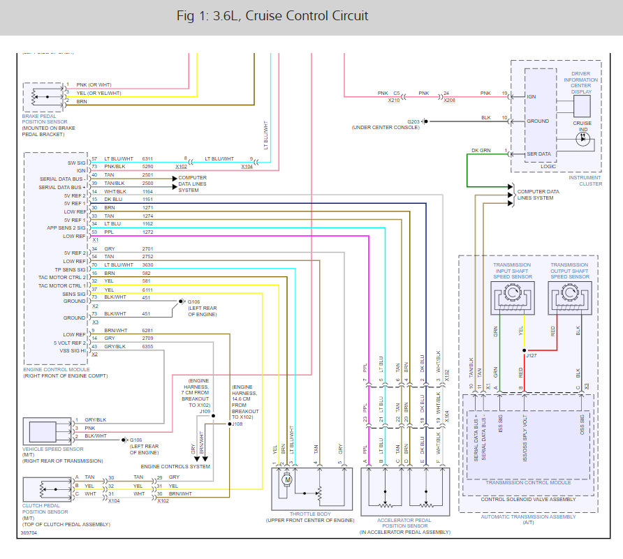

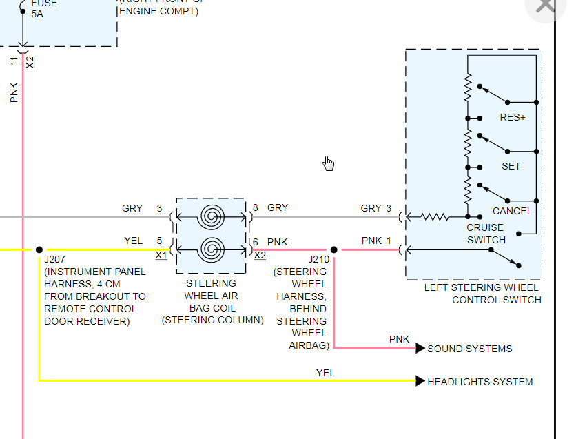

I think the issue is you saw a video on a different vehicle. Is that correct? If so, I suspect the confusion is coming in that the system in that vehicle was wired differently then your vehicle. If you take a look at these wiring diagrams, you are not able to find any wire for RES/SET/Cancel except the cruise signal wire because that is the only wire that is used. You don't have 3 separate wires that when the button is pressed it sends a signal to the BCM. You have a signal wire that the BCM will read the voltage on this single wire and depending on what it is, it knows what button is being pressed.
If you look at what the blue arrows I added are pointing too, those are resistors in the switch. This tells us that when the cancel button is pressed it grounds the signal wire and then BCM sees a voltage signal. When one of the other buttons are pressed, it grounds the signal wire but the voltage passes through other resistors and it changes the voltage the BCM sees so it knows that a different button has been pressed.
I imagine we can trick the BCM into thinking that your buttons are the stock buttons, we just need to know what the voltage is on the signal wire at the BCM when each button is pressed. Then you tap all three of your new buttons into this signal wire but you will need to add your own resistors to each wire so that when you press your new button it gives the same voltage to the BCM so it knows what button that is supposed to be.
Hopefully that makes sense. It is not the easiest thing because I don't know what the starting voltage is (I suspect it is 5 volts) to know what size resistors you need for each button in order to cut the voltage down to match the stock buttons.
First thing to do is monitor the voltage on that wire at the BCM and press each button to find out starting voltage and then how each button effects it.

Okay, that absolutely makes sense to me. I don't know how to read wiring schematics, so I didn't know that resistors were needed for this. Thank you for helping me to understand this a little bit better. I obviously have more work to do on this.
