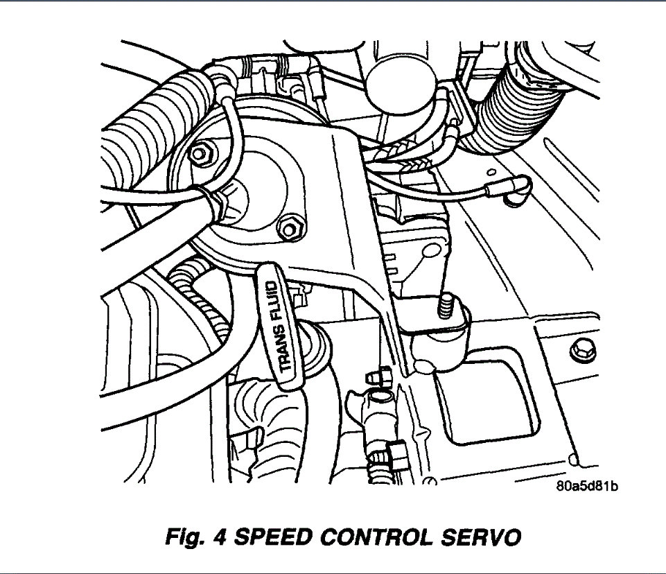

cruise light comes on but periodically will not engage.This time when it came on the engine sounded rough.Vehicle seemed to drive okay, until i let off the gas then it was rough again.
Jun 26, 2020 at 11:00 AM
  • 110,240 POSTS

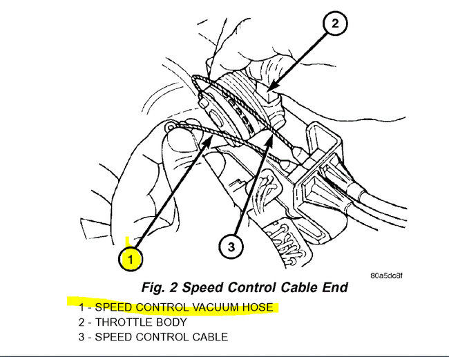

It sounds like the electrical portion is working. However, there is a servo that operates from engine vacuum. Based on your description, it sounds like there is a vacuum leak not allowing the system to work and causing a rough idle.

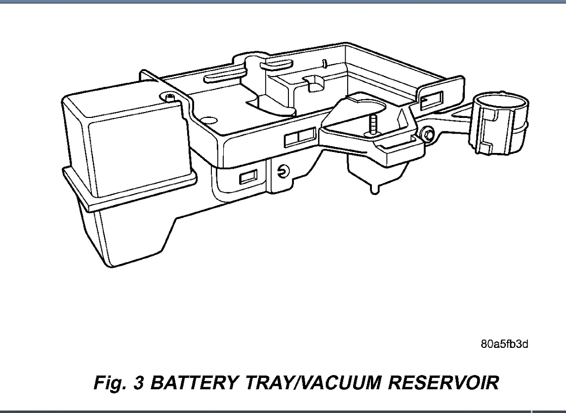

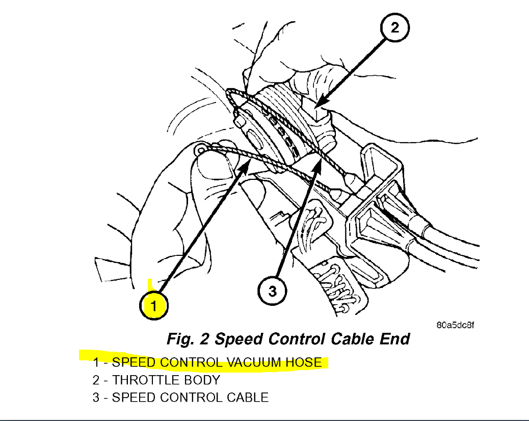

I attached pics below of the two places to check. There will be engine vacuum hoses going to and from them. Check to make sure nothing is disconnected, cracked, or leaking. Also, there is a vacuum reservoir that is part of the battery tray. Make sure to check for cracks and leaks there. The 3rd pic shows vacuum hose orientation at the throttle body.
If you start the engine and open the hood, you may hear a hissing sound which would indicate a leak, so try that. Also, here is a link that explains how to check for a vacuum leak:
