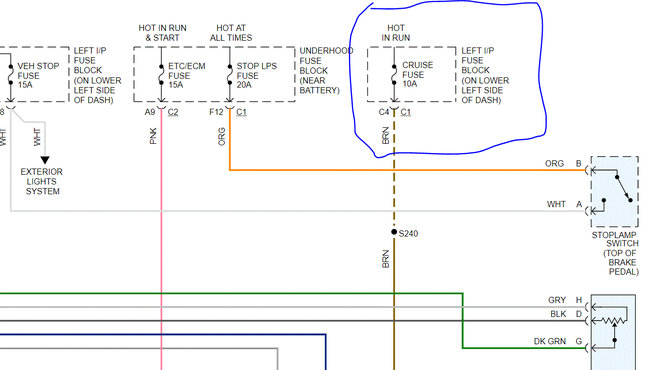

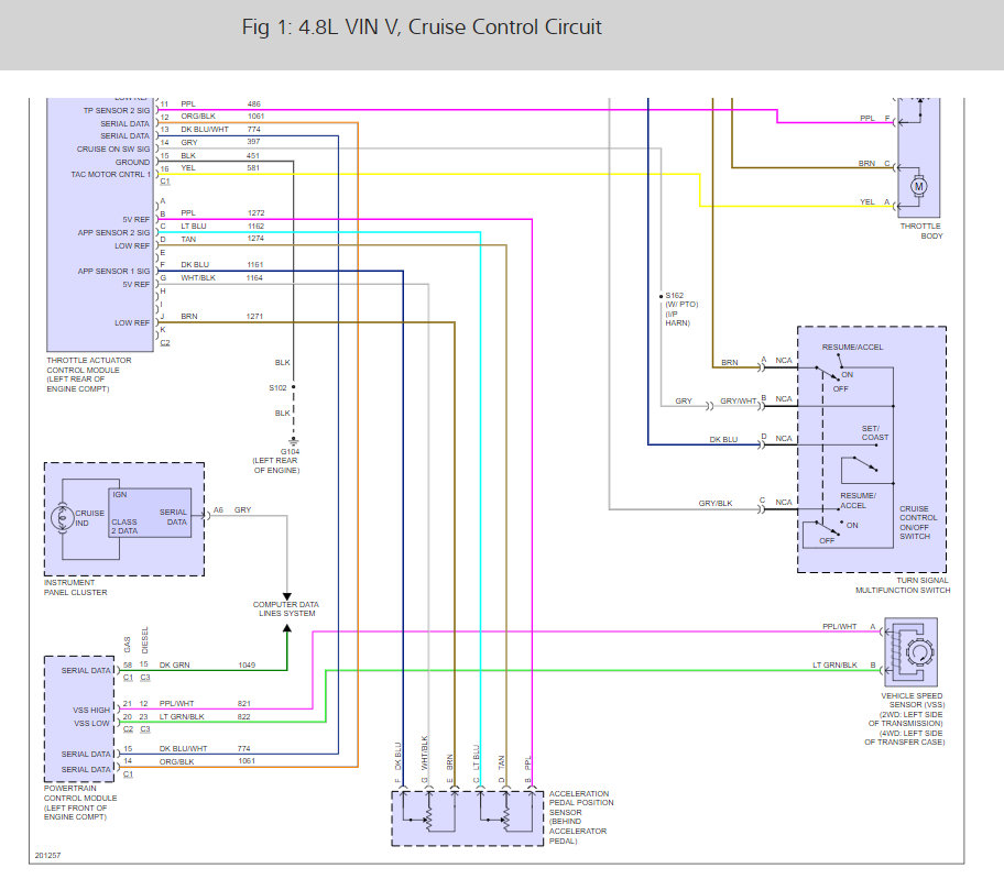

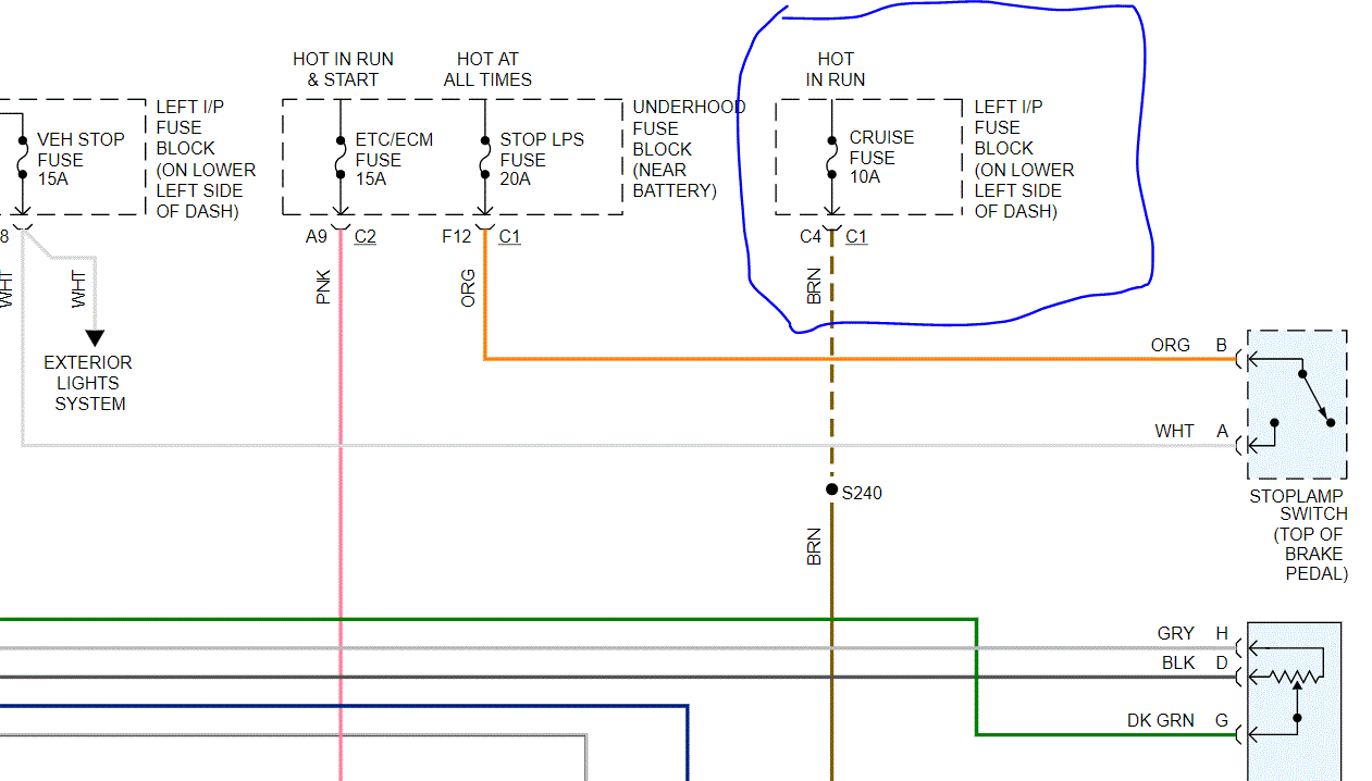

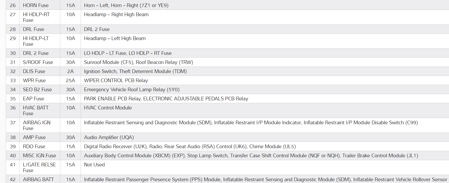

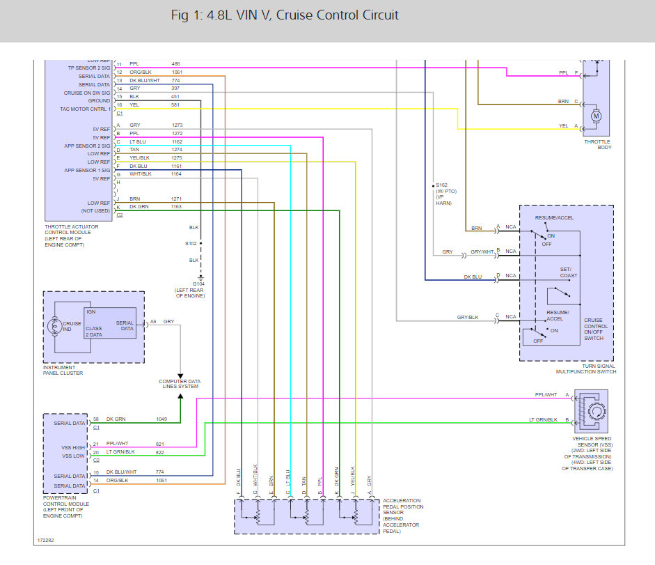

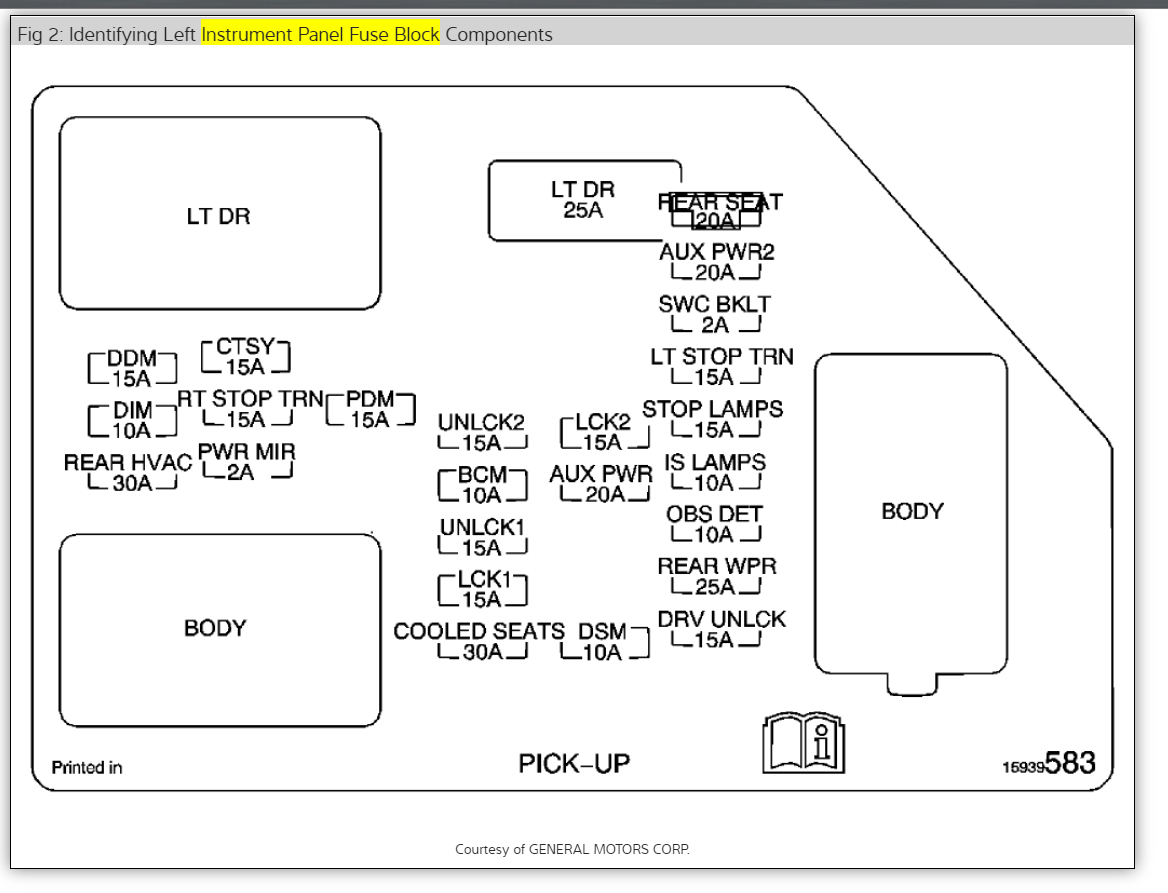

i want my truck to have a cruise control but it doesn't work should I check the fuse first? Thank you in advance!
Mar 12, 2019 at 10:55 AM
CARADIODOC
  • 34,381 POSTS

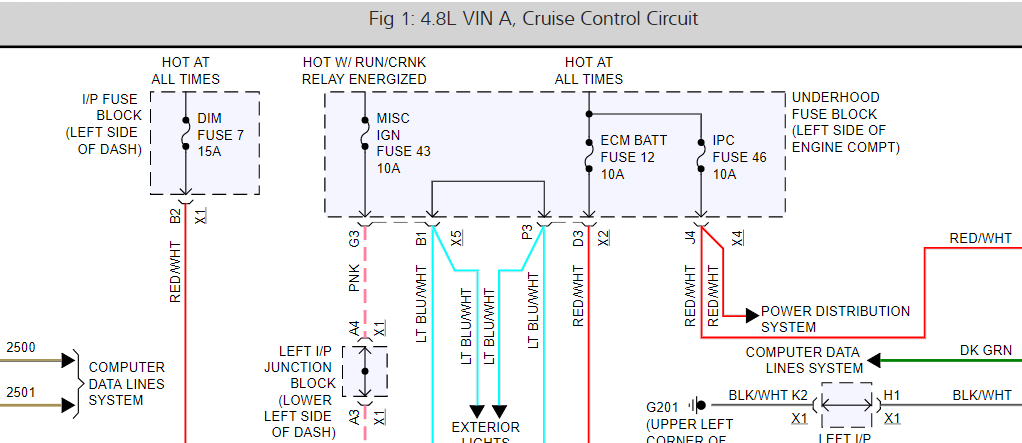

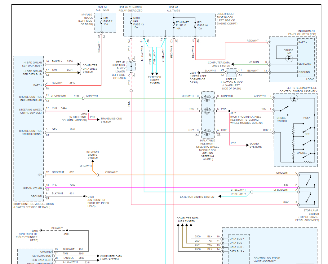

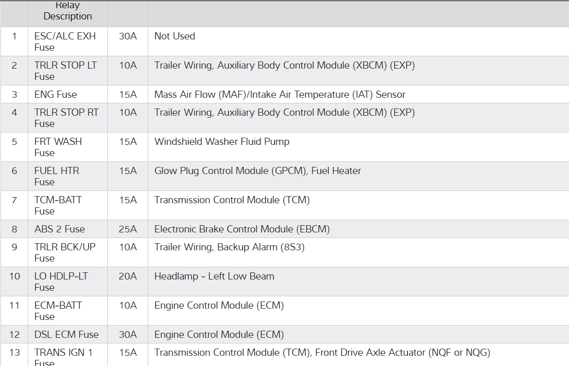

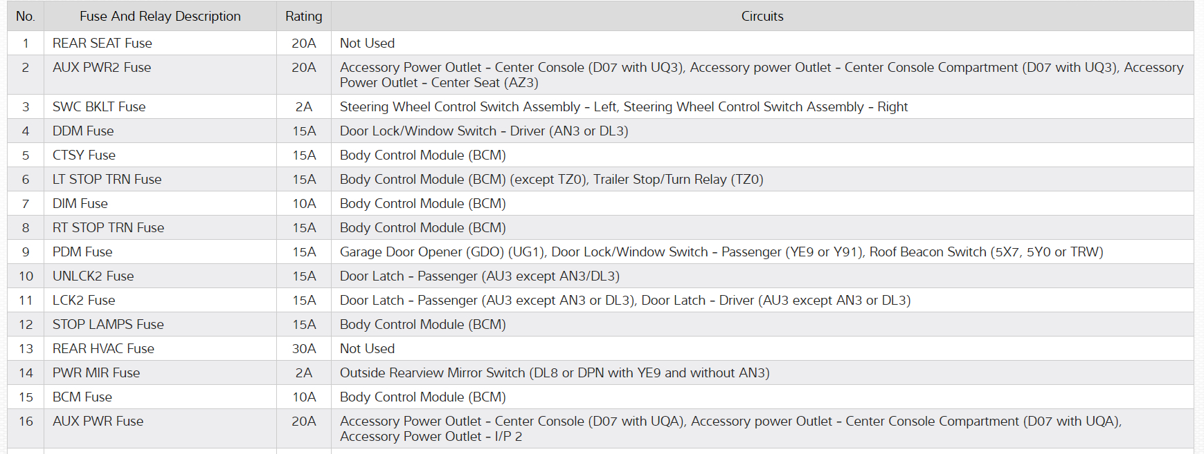

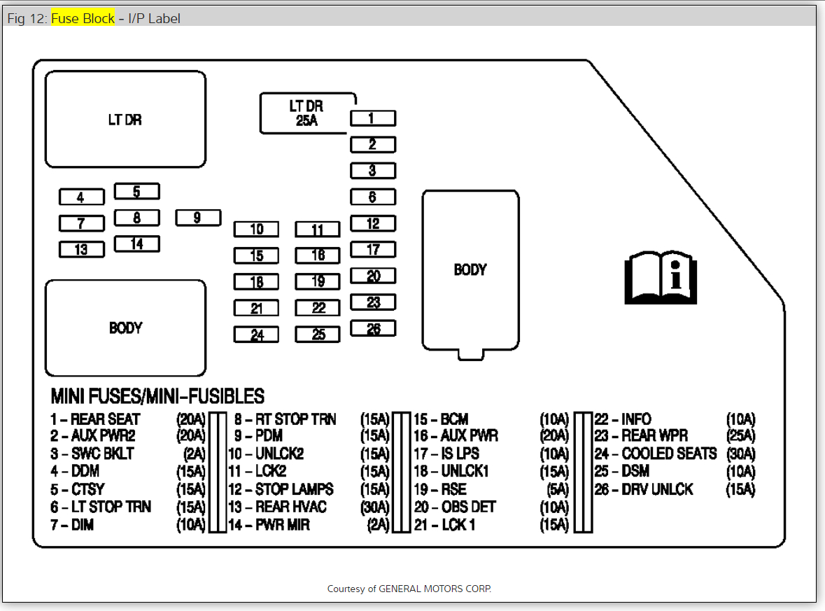

I would start by making sure the brake light work and then check the fuse this guide can help with the fuse locations in the diagrams below. ( DIM, MISC ENG, ECM BATT and IPC)
Check out the diagrams (Below). Please let us know what you find. We are interested to see what it is.

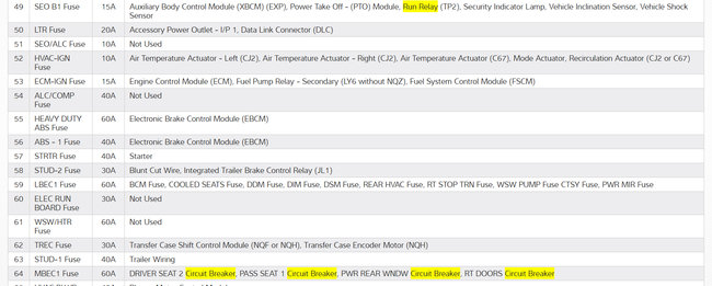

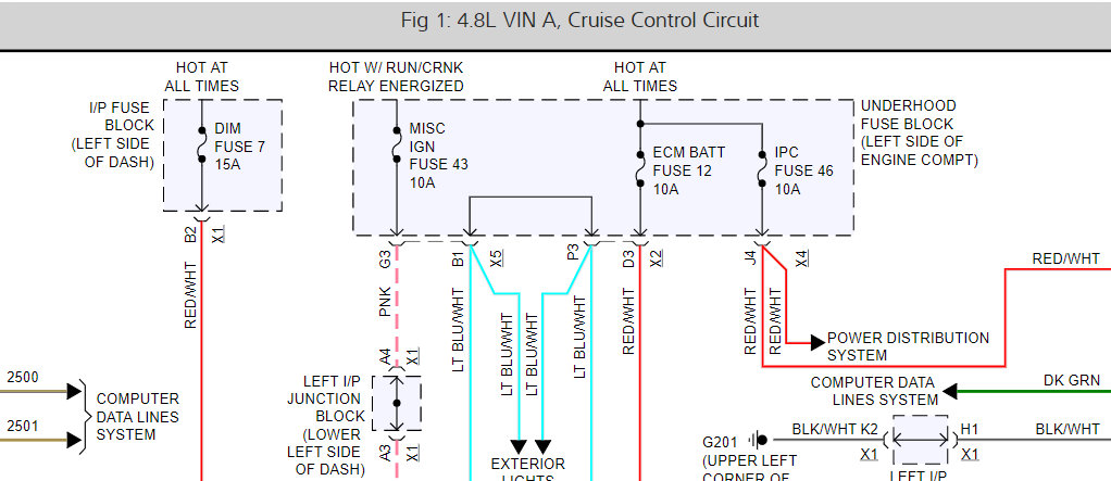

JDL
  • 16,098 POSTS

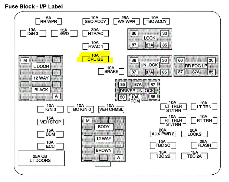

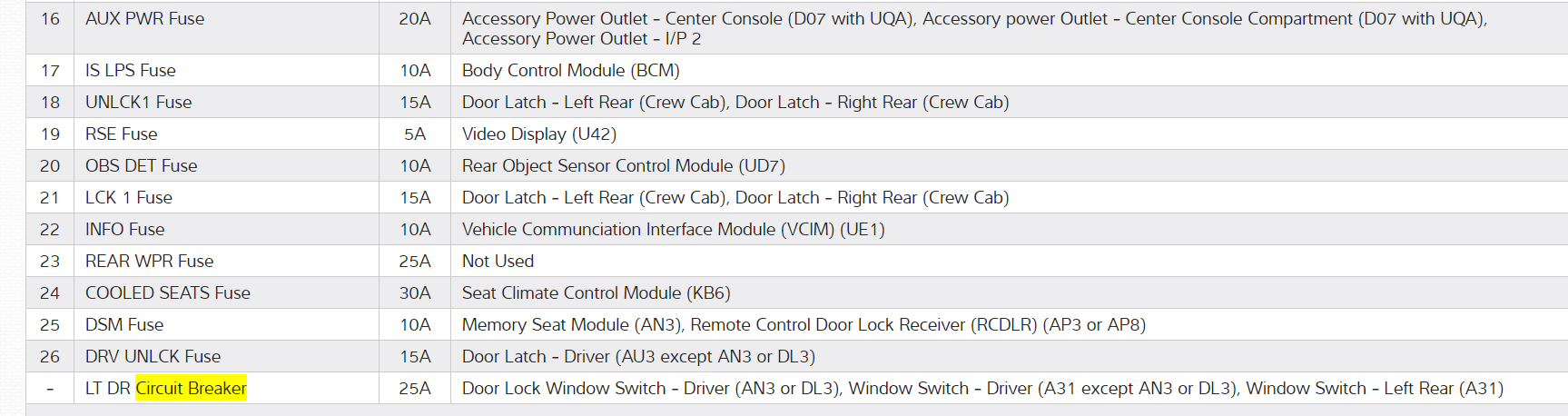

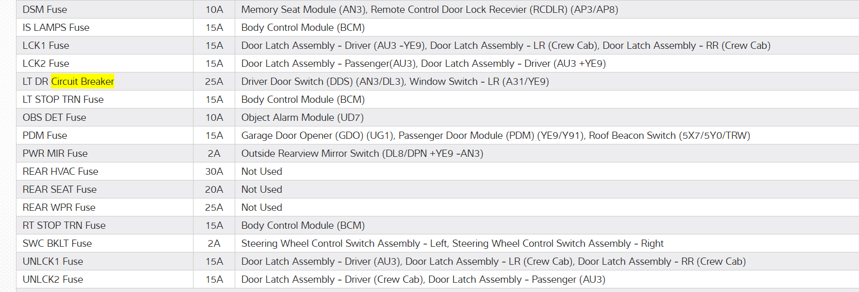

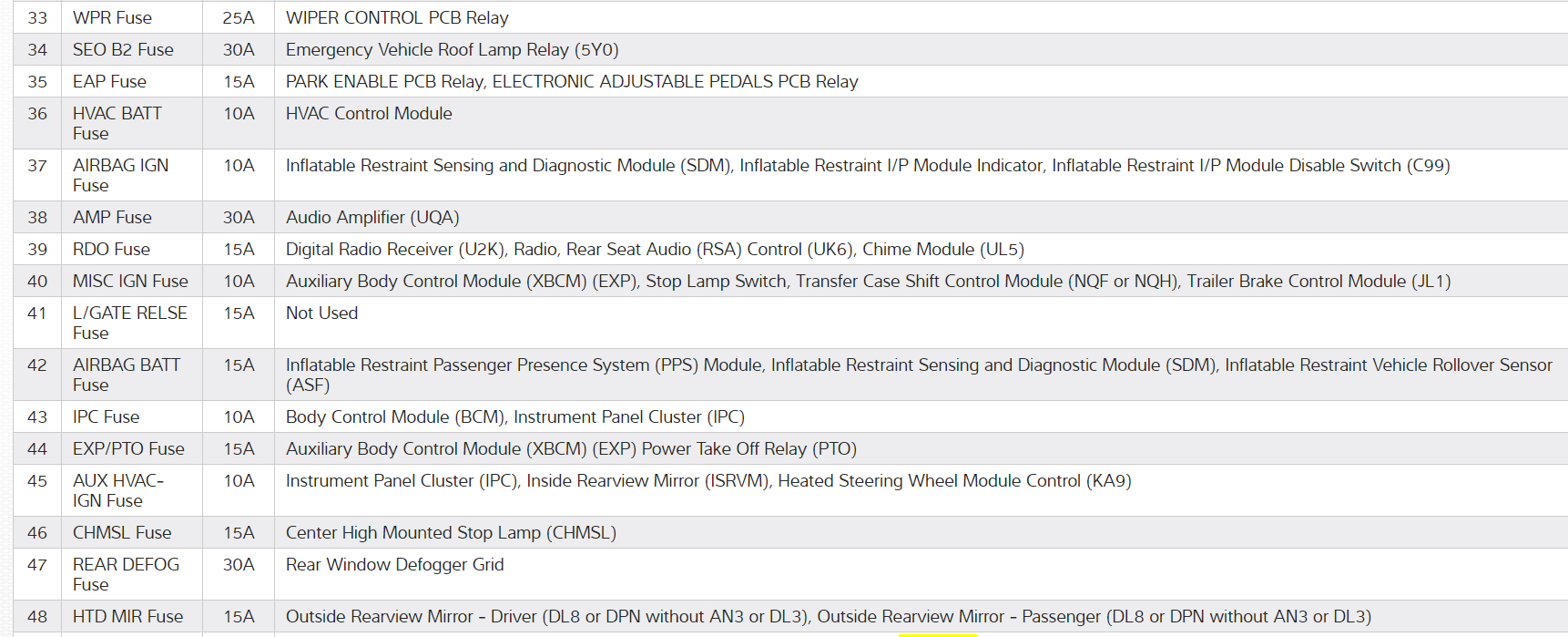

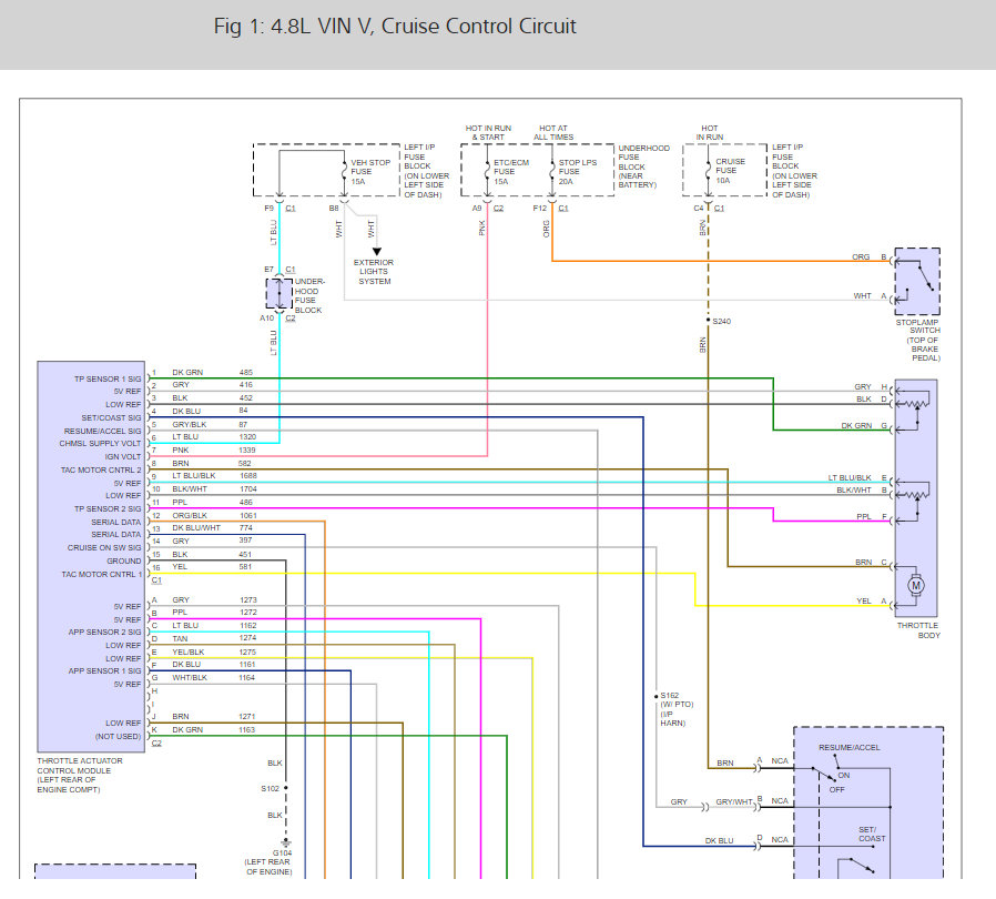

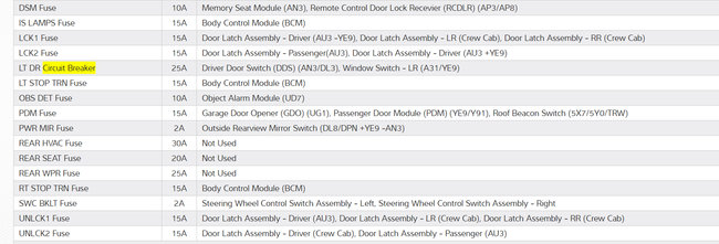

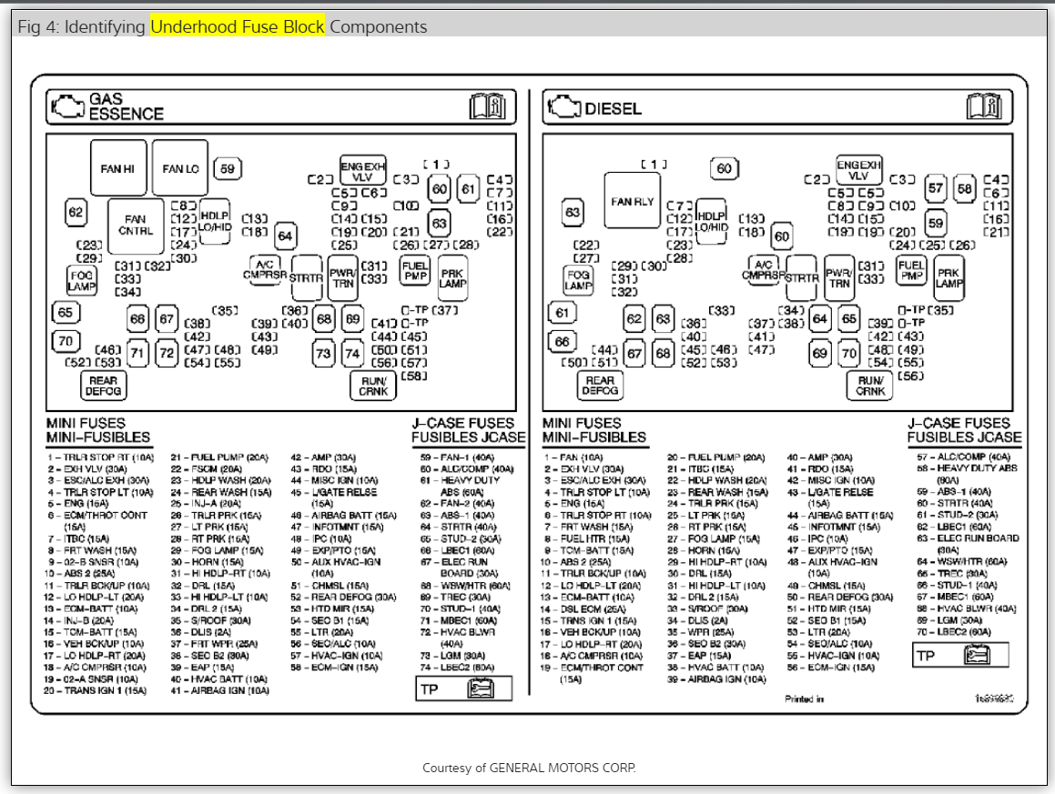

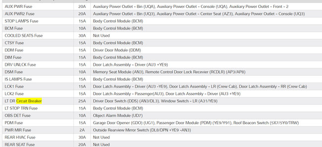

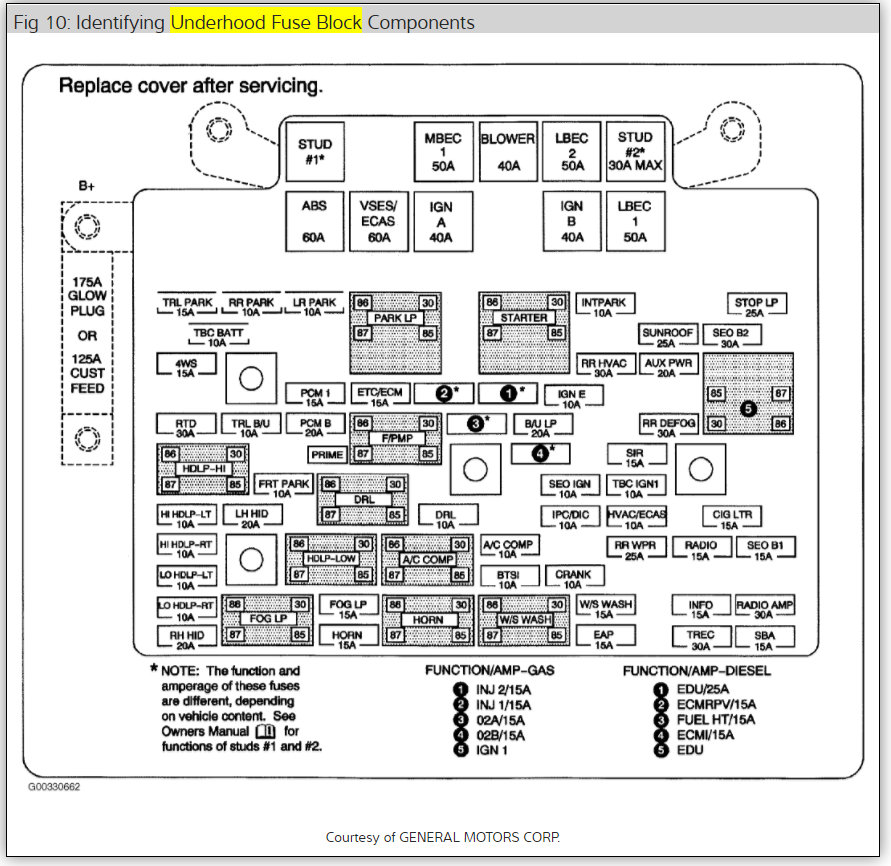

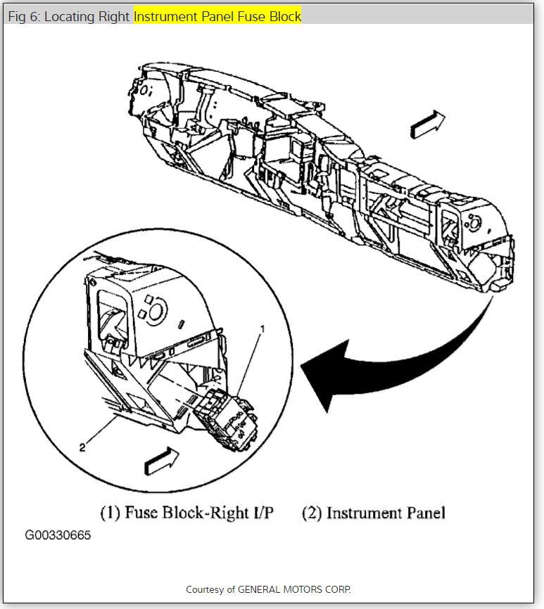

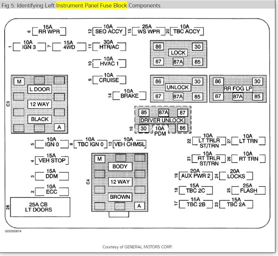

there are 5 fuses ( IPC, ECM BATT, MISC ENG and DIM) that run the system here is a guide to help check them and the cruise control wiring diagrams so you can see how the system works.
Check out the diagrams (Below). Let us know what happens and please upload pictures or videos of the problem.

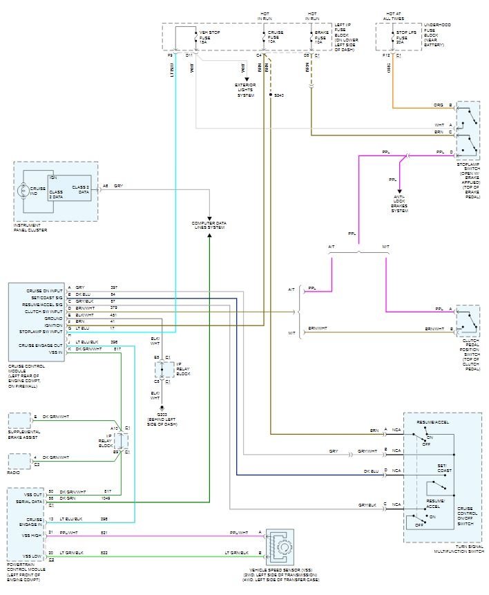

COLTON THOMAS
I have the truck listed above 1500 4.3l lu3 v6 and the cruise control has not worked ever since I got it. the guy before me had a trailer brake booster and took it out. I have looked at all the wires to make sure that they are still in one piece. I've changed the fuses and relays and cruise control is still not working. I've gone to Google but it's not helping me at all.
May 5, 2021 at 6:36 AM (Merged)

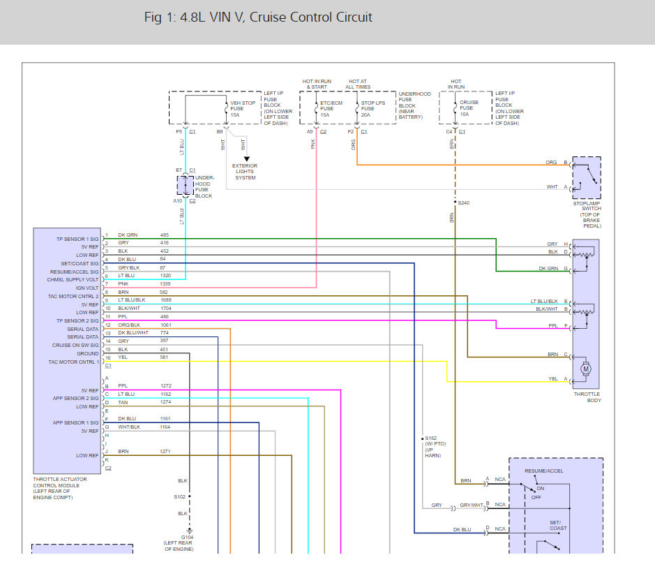

STEVE W.
  • 15,350 POSTS
The previous owner may have tapped into the brake switch wiring on the wrong wire and it broke when removed, happens if they used the scotch loc type connectors. I would first test the fuses in the cruise to be sure they have power. For those connect a test light to a good ground and with the key on, check for battery voltage on the top points of the cruise fuse and the brake fuse in the fuse panel in the dash. Next go to the brake switch and find the Brown wire, with the key on there should be voltage on it. Then check the Purple wire for power, be sure the pedal is fully up.
If you have power at both of those the next thing would be to find the cruise module on the drivers side firewall under the hood. Unplug it and check the connector for corrosion or damaged pins, somewhat common for that and then for battery voltage on the Light Blue wire (G) while the brake pedal is pressed and the brake lights are on.
Then with the key on but pedal not pressed check for battery voltage on the Brown wire (F) and the Brown wire with white stripe (D)
If they all test OK then the next step would be to check that the ground is good, it is the Black wire with a White stripe (E), put the test light onto a battery feed and see if the ground makes it light.
If those all check out the cruise module is getting power and ground.
The next testing will test the cruise switch functions. Now connect the test light to a ground. Go to the plug on the module again and have someone move the switch as you test. Do each test and while doing them move the turn signal stalk into both left and right positions, just in case there is a broken wire.
Testing - First turn the cruise switch to on, Test for battery power on the Gray (may have a white stripe) wire (A). Now with that switch on have them select and hold the set button. Check for voltage on the Dark Blue wire (B) and lastly, do the same with the resume button, this time looking for voltage on the Gray wire with Black stripe. If they all test good the switch isn't the problem.
Next you need to know if the VSS is okay, if the speedometer is working that signal is good.
The last test requires a scan tool that can access the cruise control module. That is because you need to see if it is responding to the various signals. I'm betting that you have already found a bad power, ground or switch by this point so you may not need the scan tool. That would be a good thing.
If you haven't used a test light to test fuses or even to test voltages this may help. Any of the cheap incandescent units will work for this testing.

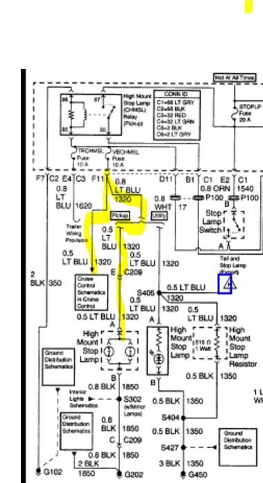

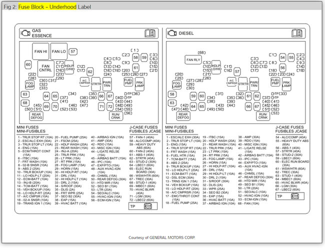

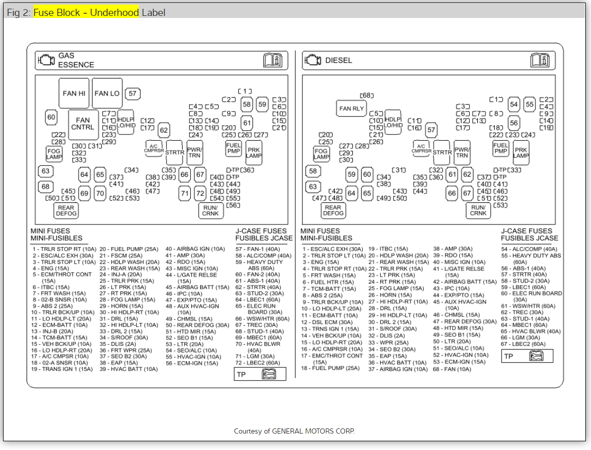

If you ran a separate battery, I don't see how that would affect this. Do me a favor. The cruise control fuse is located in the vehicle (under the dash). I need you to recheck it. In addition to just checking the fuse, confirm there is power to and from it.
I attached a couple of pics below showing the fuse I'm referring to. Check that and let me know what you find.
May 5, 2021 at 6:37 AM (Merged)
DARRELL DAVIS2
Yes, I have power on both sides even popped in a new fuse while after checking. Then checked again.
  • 110,244 POSTS

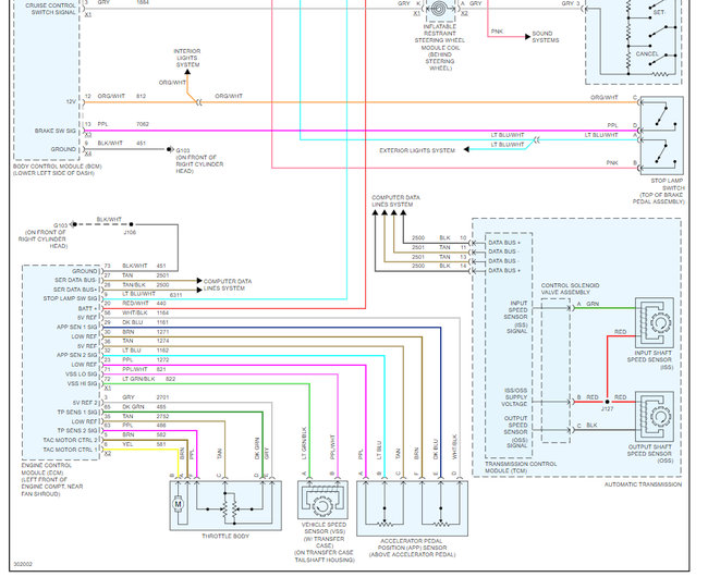

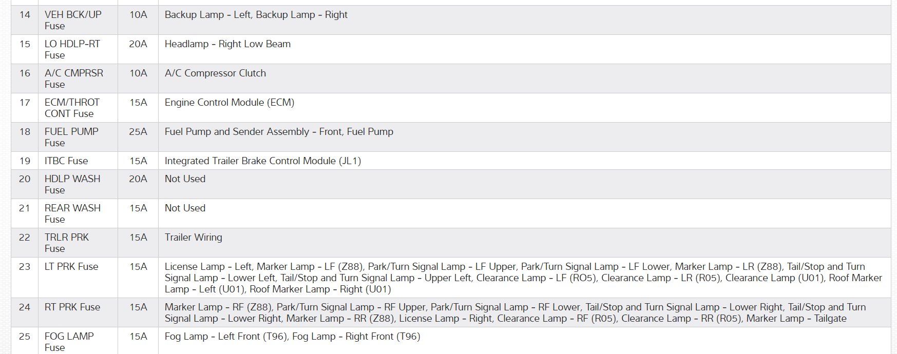

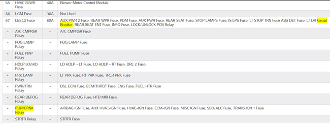

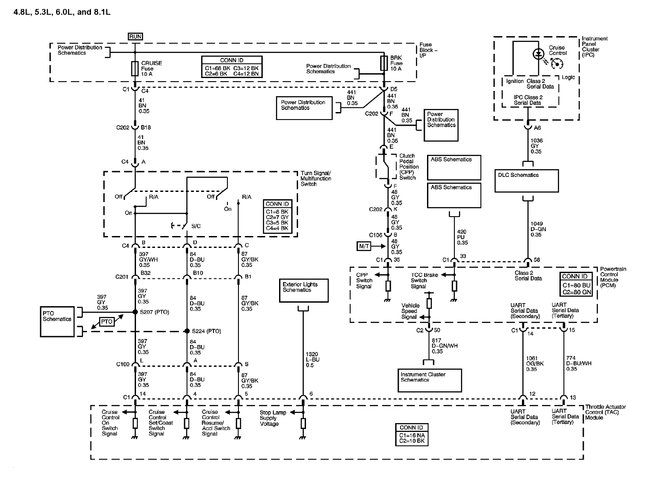

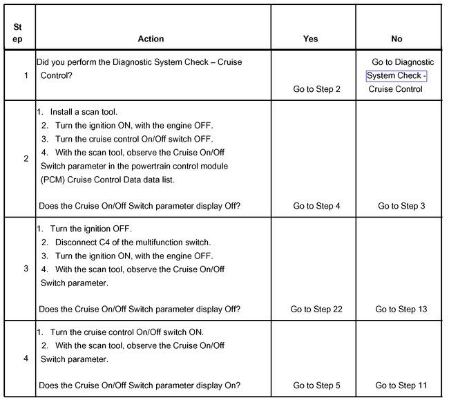

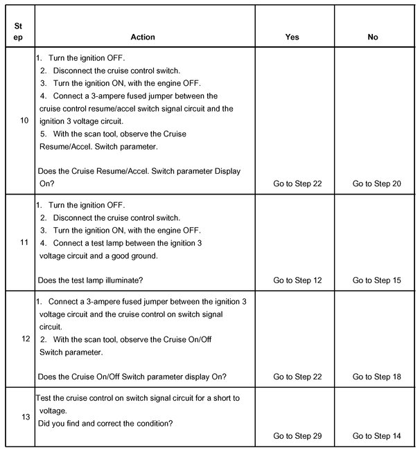

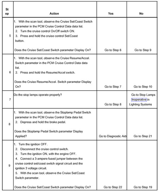

Okay, if power is getting to it, then it's time to start diagnosing. Here is the diagnostics related to an inoperative CC. The attached pics are the actual diagnostics. Take a look through them and let me know if you are comfortable following them.
_________________________
2004 Chevy Truck Silverado 1500 4WD V8-5.3L VIN T
Cruise Control - Inoperative/Malfunctioning
Vehicle Cruise Control Testing and Inspection Symptom Related Diagnostic Procedures Cruise Control - Inoperative/Malfunctioning
CRUISE CONTROL - INOPERATIVE/MALFUNCTIONING
CRUISE CONTROL INOPERATIVE/MALFUNCTIONING
DIAGNOSTIC AIDS
Perform the following in order to avoid a misdiagnosis:
- Inspect for proper operation of the brake lamps. Refer to Exterior Lighting Systems Description and Operation in Lighting Systems.
- Electromagnetic interference (EMI) on the vehicle speed sensor signal circuit may cause erratic cruise control operation.
CONDITIONS FOR ENABLING CRUISE CONTROL
- The vehicle speed is greater than 40 km/h (25 mph).
- The vehicle is not in PARK, REVERSE, NEUTRAL, or 1st gear.
- The system voltage is within 12-16 volts.
TEST DESCRIPTION

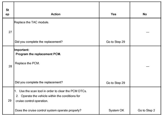

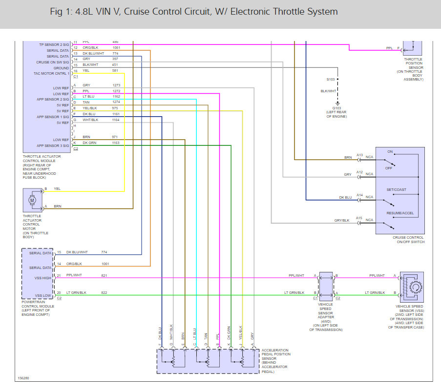

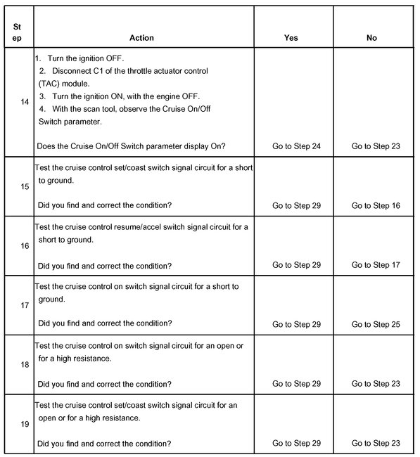

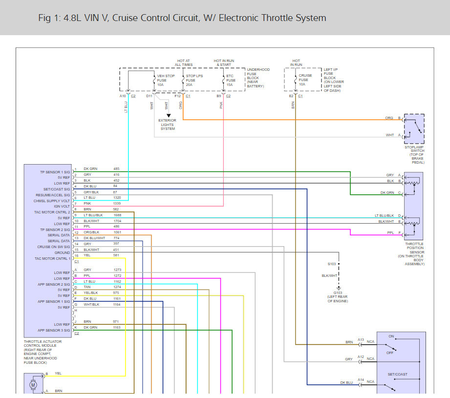

Steps 1-4
see pic 1
Steps 5-9
see pic 2

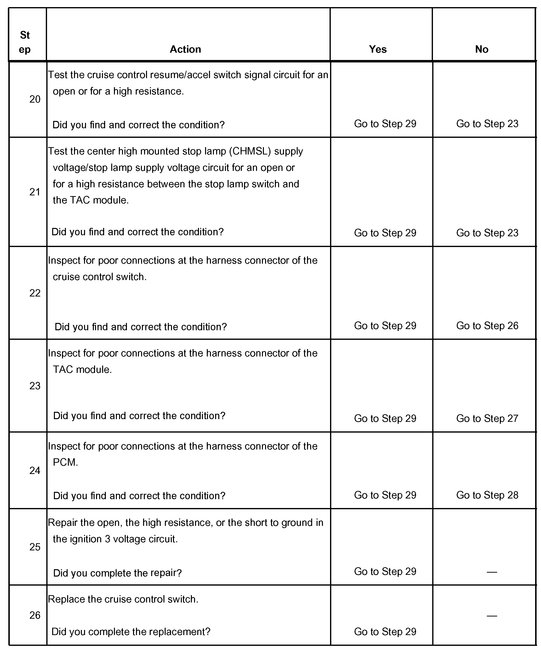

Steps 10-13
see pic 3
Steps 14-19
see pic 4
Steps 20-26
see pic 5
Steps 27-29
see pic 6
The numbers below refer to the step numbers on the diagnostic table.
8. This step tests the center high mounted stop lamp (CHMSL) supply voltage/stop lamp supply voltage circuit for an open or for a high resistance between the stop lamp switch and the throttle actuator control (TAC) module.
9. This step tests the cruise control set/coast switch signal circuit for an open or for a high resistance.
10. This step tests the cruise control resume/accel switch signal circuit for an open or for a high resistance.
11. This step tests the ignition 3 voltage circuit for an open, for a short to ground, or for a high resistance.
29. DTCs will set in the powertrain control module (PCM) when you perform this table.
_________________
Let me know if this helps.

Part of the cruise control circuitry is grounded through the brake light bulbs. When 12 volts appears on that circuit from pressing the brake pedal is when it kicks out. You removed that ground when you removed the bulbs. You can prove that by putting the bulbs back in. You'll have to figure out a way to wire in the old bulbs and hide them if you want the cruise to work.

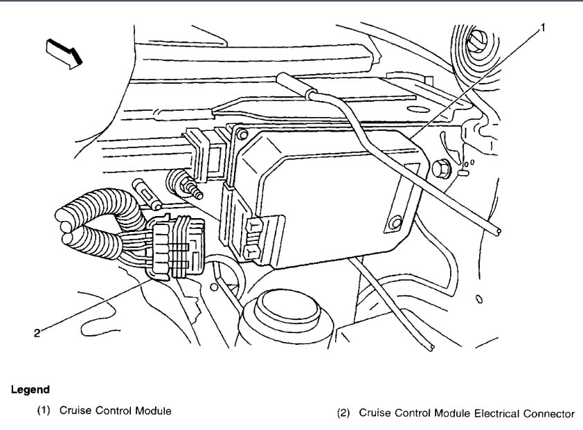

Hello, I'm Danny.
The first thing I would check is the cruise control module. It's located on the left side of the firewall under hood. I've attached a picture below of its location and description.Hope this helps and thanks for using 2CarPros.

IBHOMELESS
  • 5 POSTS
Update:
I removed the hi mount light and tested the voltage to the brake light. The blue wire (which is the one that supplies twelve volts when the brake is pressed) has a constant four volts DC on it when the key is on. I broke the connection to the light assembly to eliminate it and with no load, it still has four volts on it. When the brake is applied, it goes to twelve volts. I need to find out where this stray four volts is coming from.
I am attaching a diagram to illustrate. Since I severed the wire at the light, the only other connection is from/to the cruise control. I have that diagram but they are from different sites and I am not sure where the blue wire comes in yet.
By the way, the cruise worked this afternoon.
more as I find it :)

Update #2:
I started looking for the four volt bleed and started with the VECHMSL fuse and the TRCHMSL fuse. Here is what I found with my testing.
With the key off, there is no voltage across either fuse, normal.
With the key on there is the four volts I also found at the high mount light.
I then activated the brake pedal with a bar and then re checked the fuses mentioned above. They now have twelve volts on them and the brake lights are on full bright.
I unplugged the new brake light switch but it did not change anything.
Looking at the diagram, it appears my next step would be the hi mount relay (CHMSL). It was getting dark and I was not able to locate it yet.
Got to be there or possibly the multi-function switch?
Anyway, I think I am getting close, hopefully.
May 5, 2021 at 6:39 AM (Merged)
CARADIODOC
  • 34,381 POSTS
Without contacting a GM trainer, I think I know what's going on, and I have a solution. If you had the original assembly in there, with its incandescent bulbs, you would not see a problem. I am pretty sure the four volts is normal, thanks to the addition of all kinds of computer circuitry. (This goes back to when I used to install aftermarket cruise control systems in the 1980s). Four volts is being applied to the circuit, then the current flow is monitored to test the bulbs. Actually, the computer is using the bulb circuit as a ground circuit. Applying 12 volts to it removes the ground and is the first backup strategy in cancelling the cruise control operation.
At the same time, the cruise control system gets at least part of its power source from the same circuit that feeds the brake light switch. That is done because it needs to cut the cruise control operation when the brake pedal is tapped. If the brake light fuse is blown, there would never be 12 volts on that line, and no "cancel" signal for the cruise control. You'd keep flying down the highway. When that fuse is blown, the cruise control won't work, so there's no danger from not getting the cancel signal.
If I'm right, the four volts will be gone when the ignition switch is off. The way I would solve this is to take that light blue wire with the four volts, cut it, and connect the two ends to the contacts of a relay. Also attach the end with the four volts to one of the relay's coil terminals. Ground the other coil terminal. Four volts is not enough to turn the relay on, so the brake light will be fully-off. The relay will turn on when it gets the full 12 volts, and that will switch on the light. I can draw a diagram if necessary.
Be aware that if you use a common relay with five terminals, (one isn't used), there is a damping diode across the coil to kill the voltage spikes it creates when it turns off. You must connect the 12 volt and ground terminals in the right order. If you use a square four-terminal GM relay, most of those use a damping resistor. Resistors don't have a polarity, so you can connect either coil terminal to ground and 12 volts.
IBHOMELESS
  • 5 POSTS
Thanks
You are correct that the 4 volts is gone when the key is off.
What puzzles me is that these lights just started coming on dim as described. It has been a couple years that they have not with this LED light. Something has changed
I understand that 4 volts is not enough to see using the regular bulbs and I also understand what you are saying regarding the relay.
Everything you describe above make a lot of sense and it is new info for me...thank you!
I guess my OCD will not let me give up *grin* If it started doing this right away when it was first installed, I wouldn't worry about it but since it is a new problem, it is hard to let it go.
Do you know where the hi mount relay is located? I saw somewhere that it was under the hood on the passenger side but that makes no sense
Thanks again, I really do appreciate all your input
