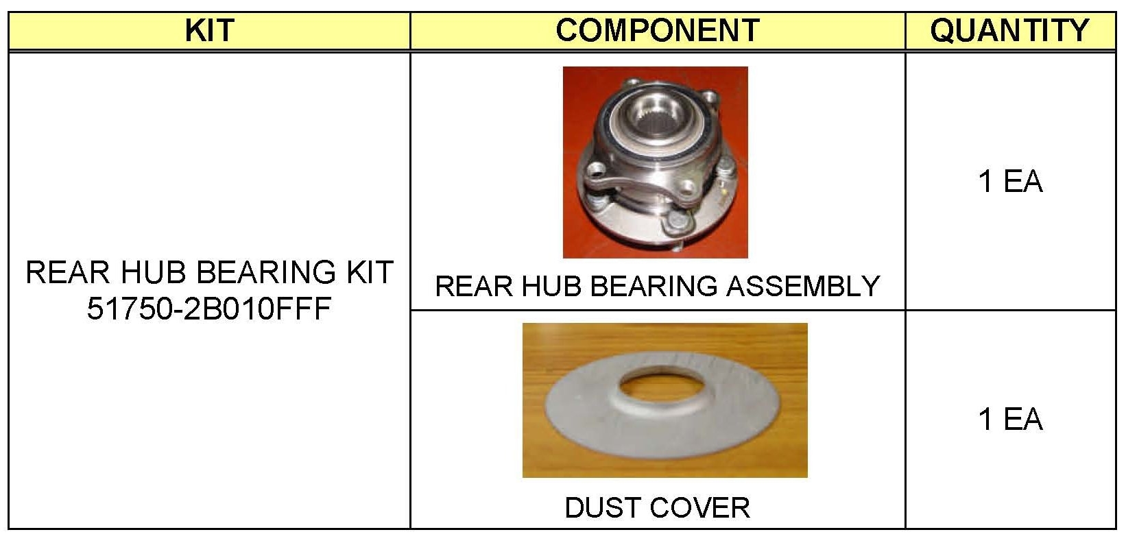

Hi there,
There is creaking sound (like an old door that needs oil) coming from rear left wheel when slowly reversing.
Drove on highway for an hour then felt all the hubs and all hubs had the same temperature not hot also no rocking or grinding sounds with the rear right wheel.
Would this possibly be a bushings or axle issue?
Thank you,
Sean

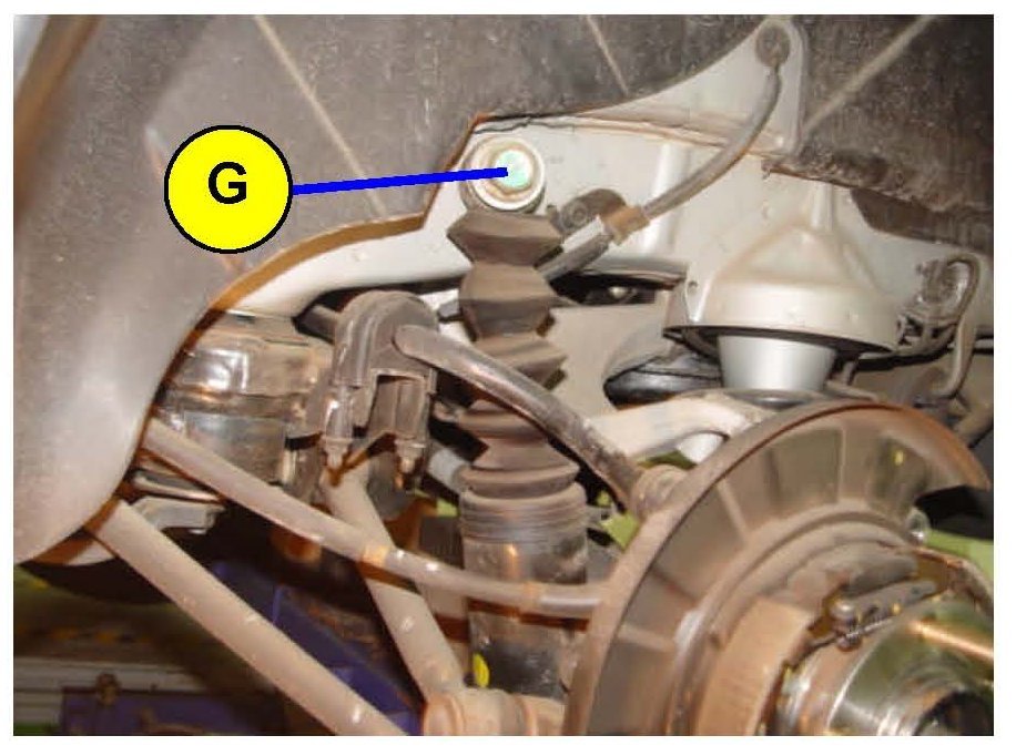

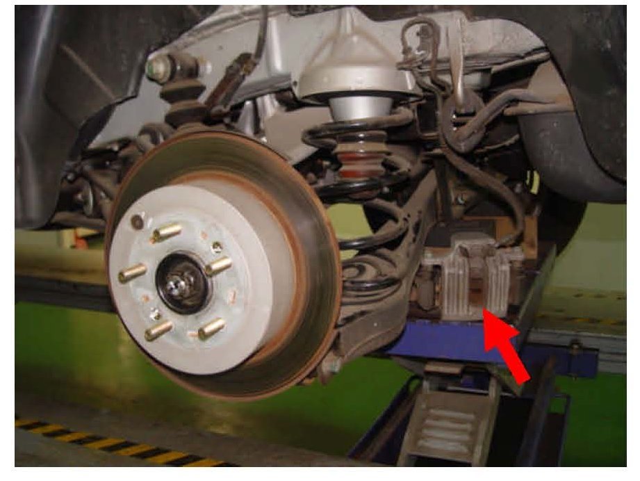

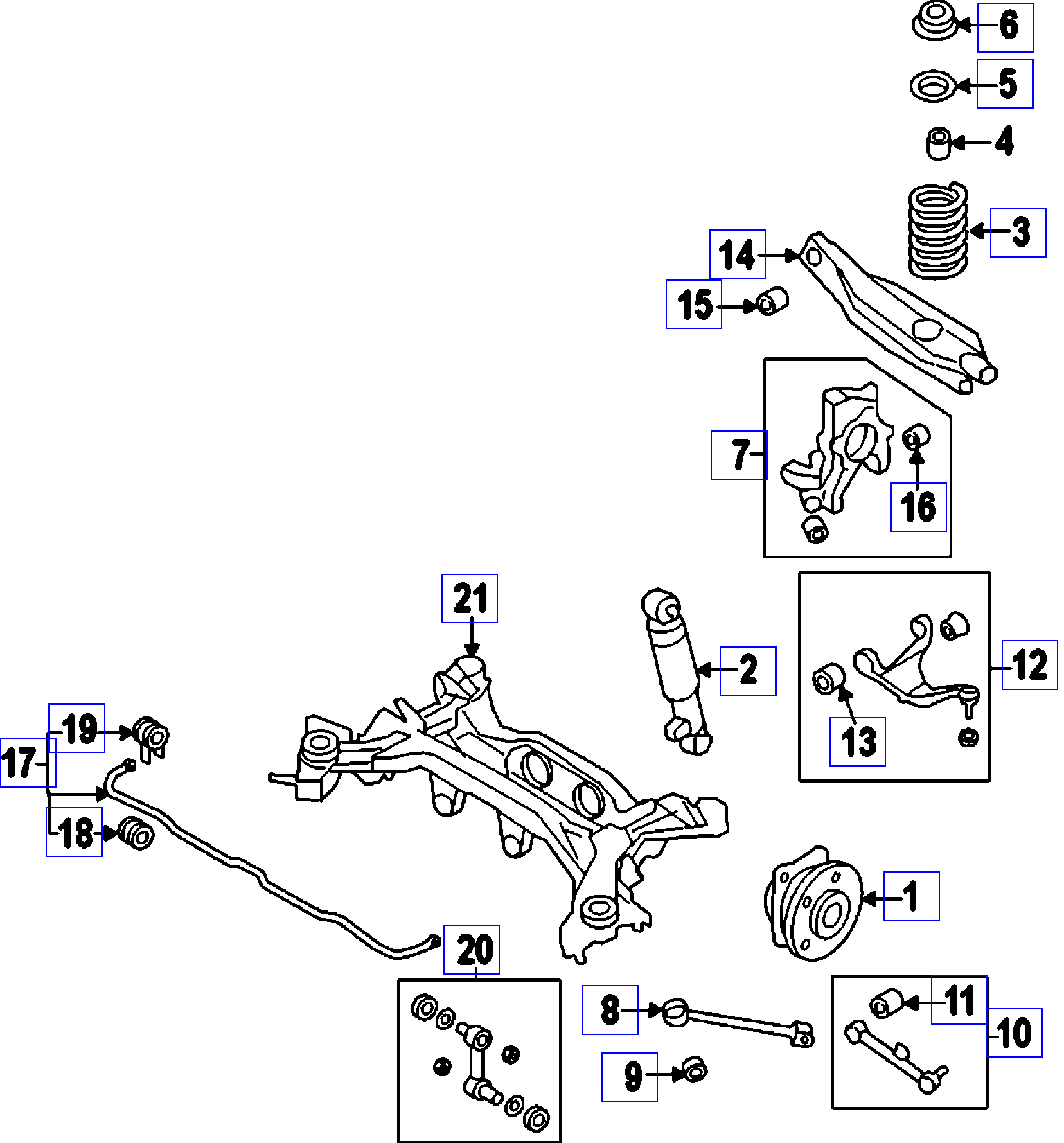

Most times, it is related to a bushing. However, the Canadian version of this vehicle has a technical service bulletin (TSB) regarding abnormal noise from the rear. I'm not sure if you are located in Canada, so I will provide the TSB. The attached pictures correlate with this bulletin.
Note: If you are not in Canada, the last picture I will attach is an exploded view of the rear suspension. You will see where all the bushings are located in the pic. You may want to try spraying them with a rubber friendly lubricant to see if the sound changes or goes away.

pic 1

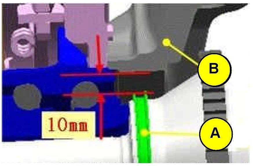

Some Santa Fe vehicles equipped with the 4WD system may exhibit an abnormal noise originating from the rear hub. This may be caused by a damaged rear hub bearing due to debris entering through the 10mm gap between the dust cover (A) and the carrier (B) on Santa Fe vehicles.

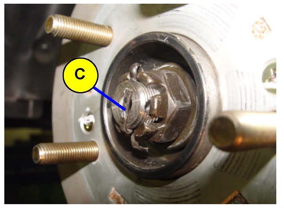

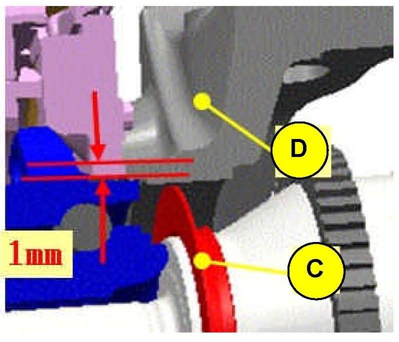

pic 2
This bulletin provides the procedure for replacing the rear hub bearing and installing an improved dust cover to prevent damage caused by debris. The new dust cover reduces the gap between the dust cover (C) and the carrier (D) to 1mm.
AFFECTED VEHICLES
Some 2007~2009 Santa Fe (CM) vehicles produced from Job # 1 to April 8, 2009.
pic 3
PARTS INFORMATION
NOTE:
Each kit includes the components required to perform the procedure on ONE side of the vehicle; dealers must order two kits to complete the procedure on both sides.

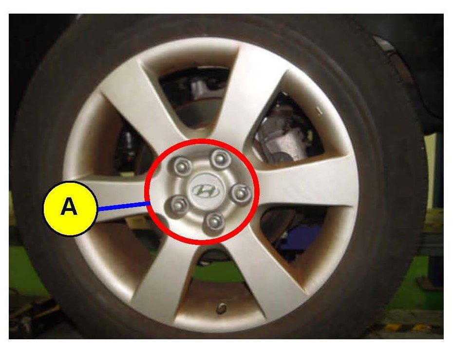

2.Remove the left rear wheel from the vehicle by removing the wheel lug nuts (A).
Tightening torque: 9~11 kgf.m(88.3~107.8 N.m, 65.1~79.5 lbf-ft)

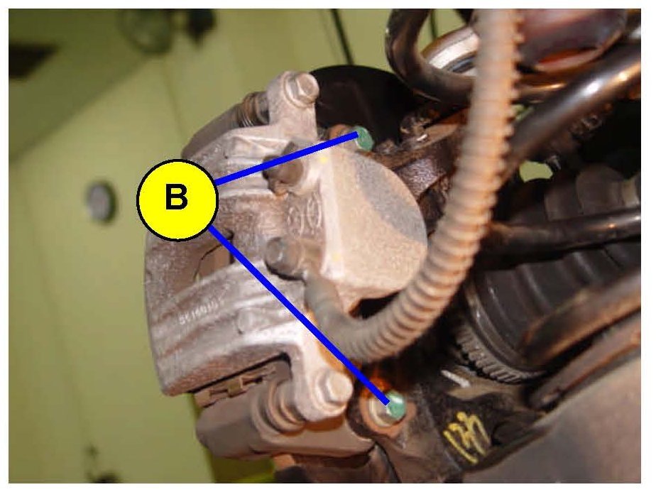

3.Remove the mounting bolts (B) to remove the caliper assembly.
Tightening torque: 6.5~7.5 kgf-m(63.8~73.5 N.m, 47.0~54.2 lbf-ft)

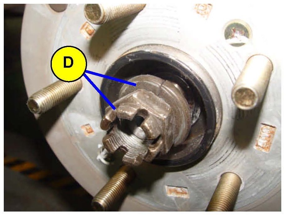

6.Unfasten and remove the castle nut and washer (D).
Tightening torque: 20~26 kgf.m(196.2~254.9 N.m, 144.7~188.0 lbf-ft)

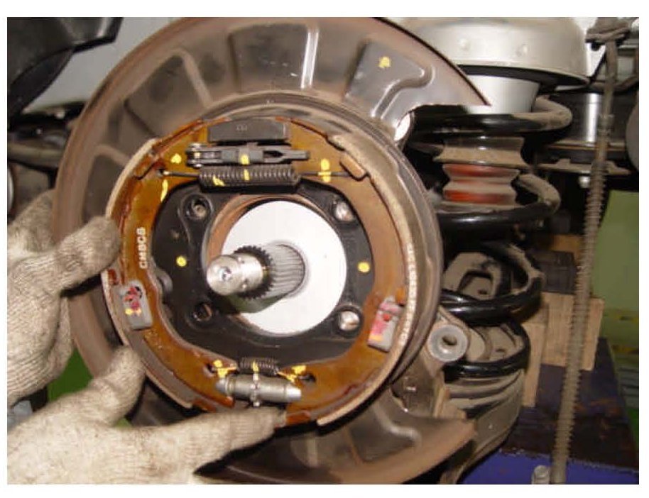

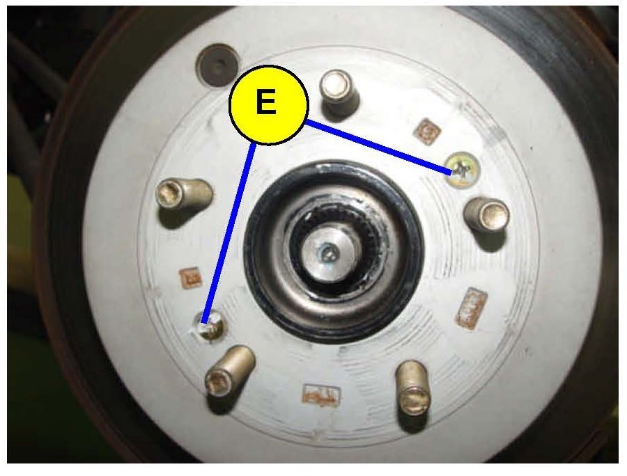

7.Remove the brake rotor by unfastening the two screws (E).
pic 10

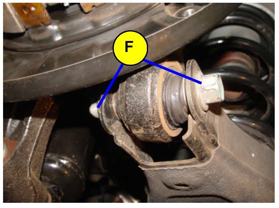

8.Using a jack, support the rear lower arm and remove the mounting bolt (F) facing toward the tire.
Tightening torque: 14~16 kgf.m(137.3~156.9 N.m, 101.3~115.7 lbf-ft)

9.Remove the rear strut upper mounting bolt (G).

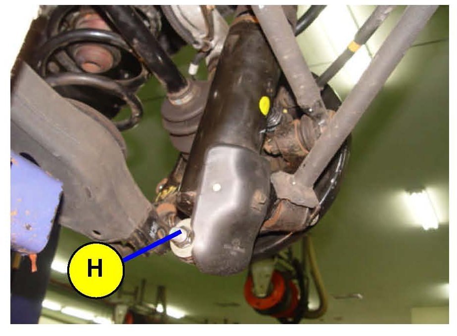

10.Remove the rear strut lower mounting bolt (H) and remove the rear strut assembly.
Tightening torque: 10~12 kgf.m(98.1~117.6 N.m, 72.4~86.7 lbf-ft)

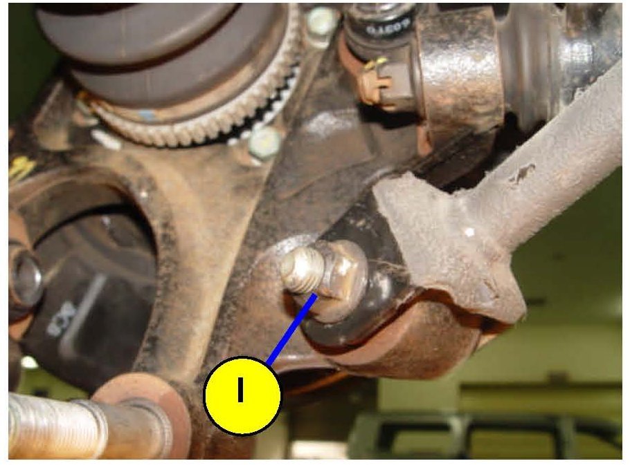

11.Remove the trailing arm mounting bolt (I).

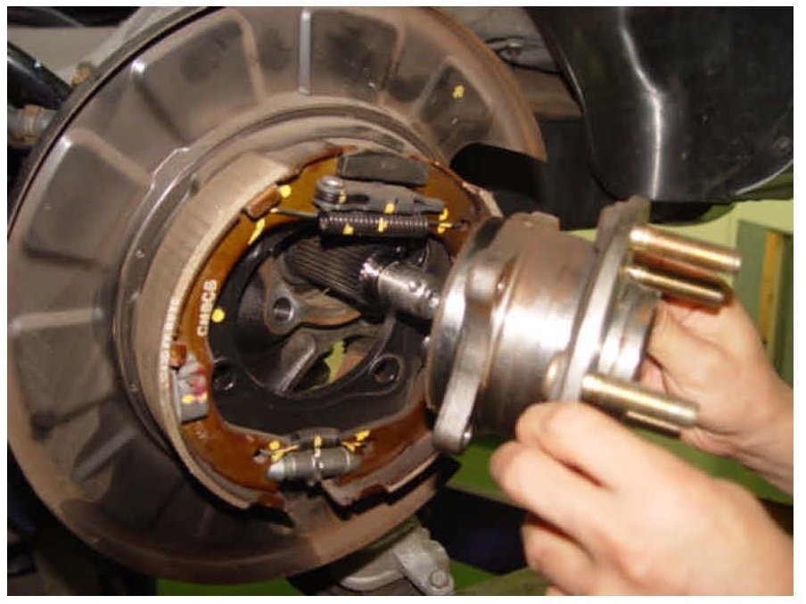

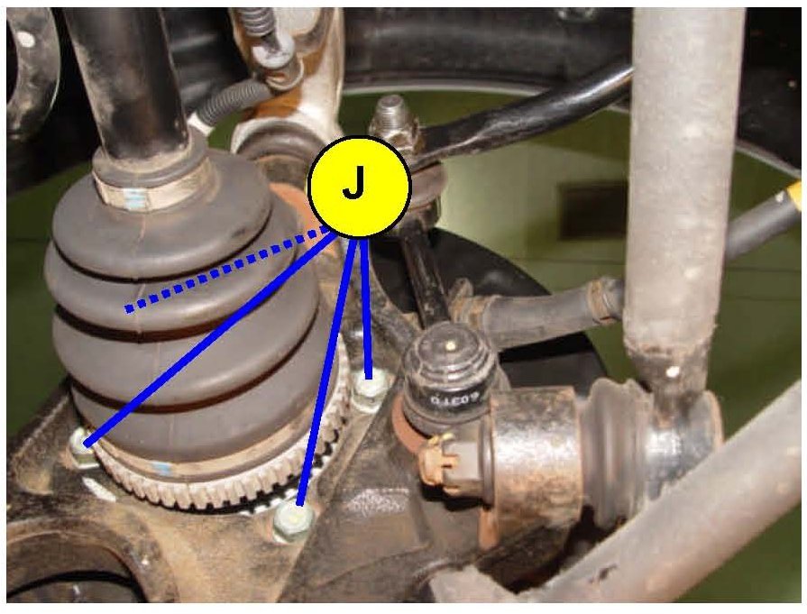

12.Remove the four rear axle carrier hub mounting bolts (J).
Tightening torque: 8~9 kgf.m(78.5~88.2 N.m, 57.9~65.0 lbf-ft)
pic 15

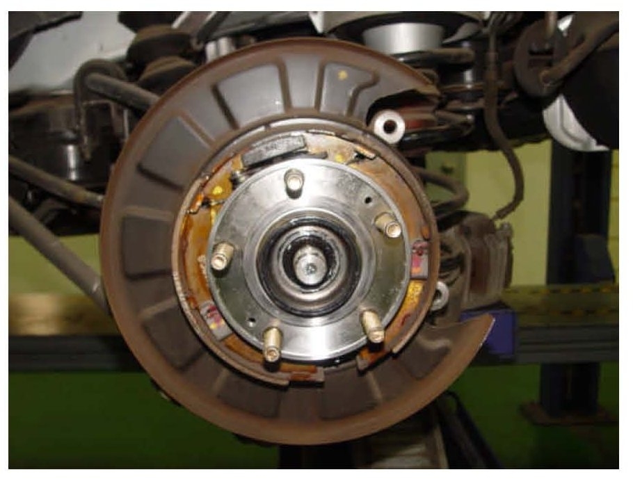

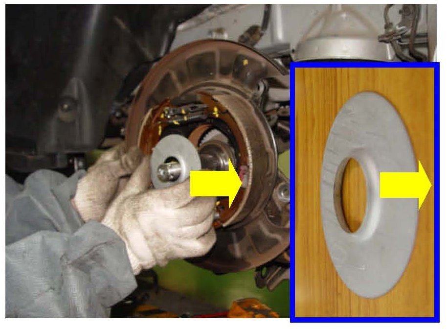

13.Remove the rear hub assembly from the vehicle.
pic 16
14.Install the new dust cover with the raised edge facing outwards as shown.
pic 17
15.Set the dust cover and parking brake into position.
pic 18
16.Install the new hub bearing.

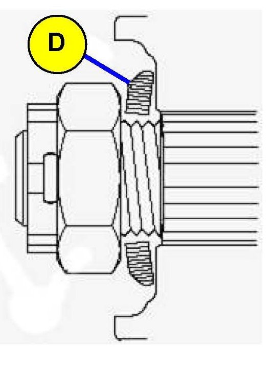

IMPORTANT:
^ The washer which accompanies the castle nut (D) must be installed with the convex side facing outwards.

Again, the last picture is the exploded view I mentioned. Let me know if this helps or if you have other questions.
