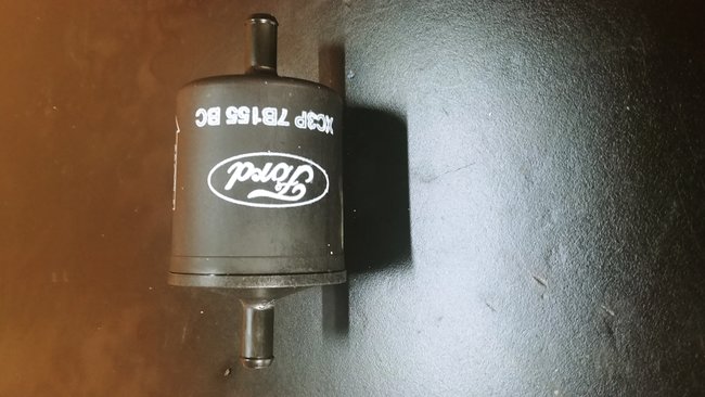

Sure. The updated part number is now a plastic filter marketed as a transmission filter. I assume the flow goes towards the power steering cooler?
Also you're probably right about the permanent crimping. But, I was able to get one end off when I changed the pump just to flush it out. You think I should just cut it? I'm a little nervous about losing hose. Maybe I could use diagonal cutters or something or I could get lucky with wrenching out the other side like I did previously.
Monday, June 7th, 2021 AT 5:51 PM
CANNON1349
  • 672 POSTS

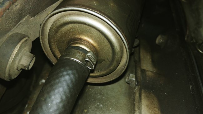

So I decided to go ahead and attempt replacing it, and I was able to uncrimp the hoses with diagonal pliers and re-crimp them on to the new filter. So far no leaks and looks good. New power steering pump still makes a little noise but nothing crazy. I did bleed the system with the wheels in the air.
  • 109,901 POSTS
Welcome back:
Looking at the pictures, I'm impressed you were able to reuse those clamps. Normally, they are a one time use. LOL Regardless, keep an eye on them for leaks, and let me know if things change. At this point, you should be good to go.
