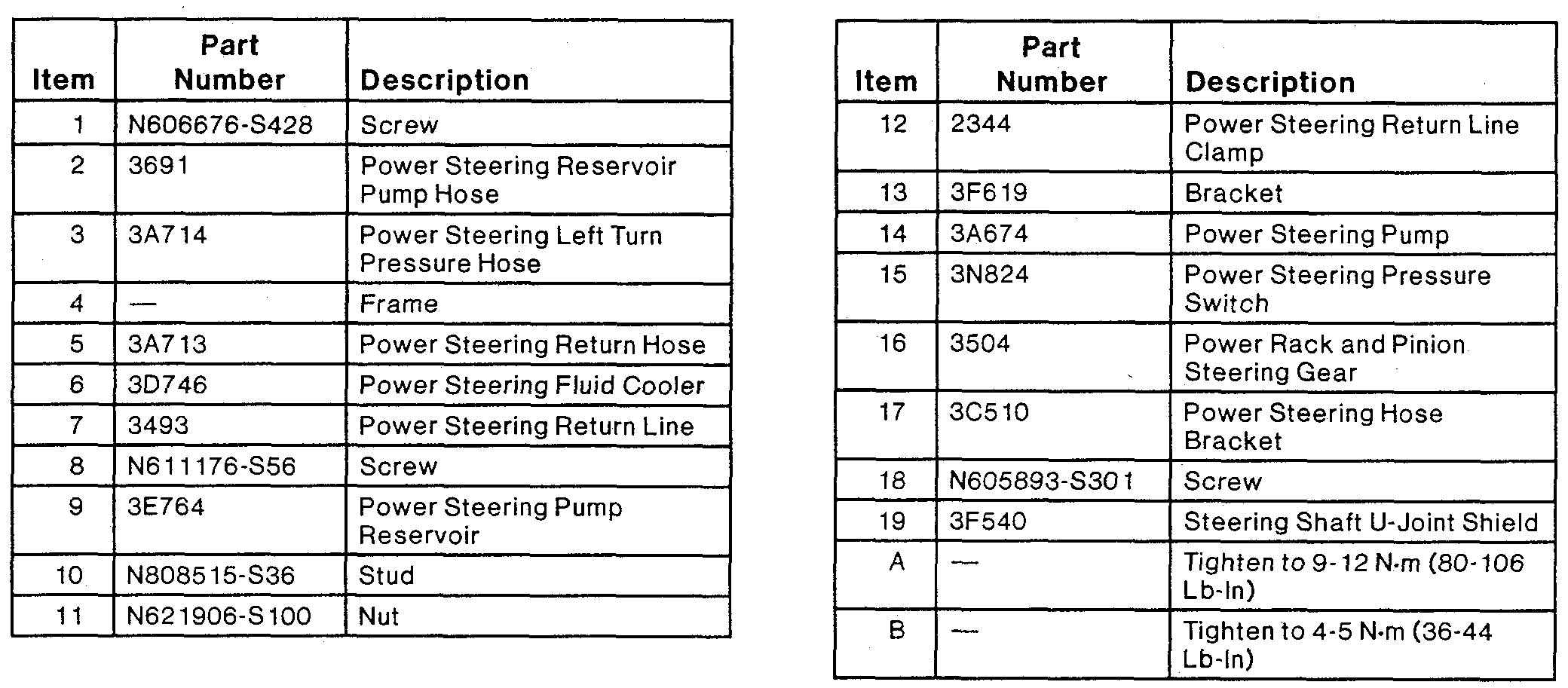

Here are the specific directions for your vehicle. The attached pictures correlate with these directions.
______________________________________________________________
REMOVAL
NOTE: The power steering pump is serviced as an assembly. If any service is required the entire power steering pump assembly must be replaced.
1. Make note of radio presets and disconnect battery ground cable.
2. Drain and remove radiator coolant recovery reservoir.
3. Remove drive belt.
Part 1 Of 2
Picture 1
Part 2 Of 2
Picture 2

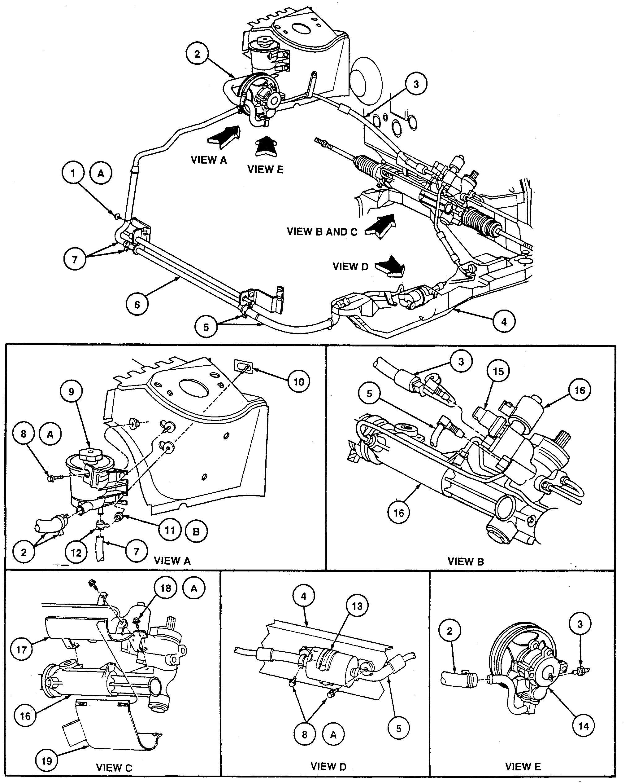

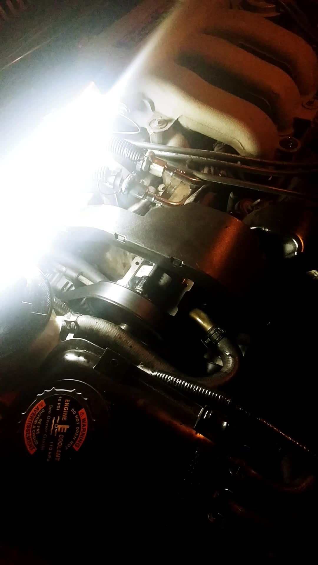

4. Remove power steering reservoir pump hose from between power steering pump and power steering pump reservoir. Drain fluid into a container.
Picture 3

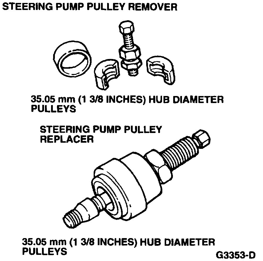

5. Remove power steering pump pulley from power steering pump using Steering Pump Pulley Remover T69L-10300-B.
6. Disconnect power steering left turn pressure hose from power steering pump and drain the fluid into a container.
7. Remove three power steering pump retaining bolts and remove power steering pump.

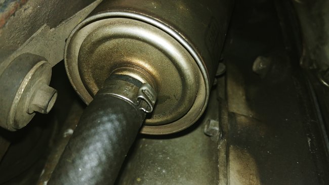

Yeah, I bought this filter a couple of days ago, but it is so much smaller than the stock filter. The hoses simply won't go together because of the lack of space.
Jun 7, 2021 at 10:51 AM
  • 110,240 POSTS

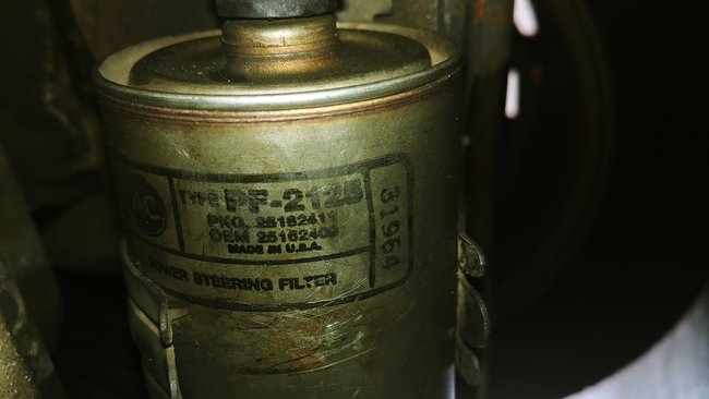

Is there a part number on the original filter? Is it a Ford filter (motorcraft)?
CANNON1349
  • 861 POSTS
Looks like PF-2125. AC Delco maybe, I attached a picture.
CANNON1349
  • 861 POSTS
Also, I heard the new pump making noise today. But only when the car is in park, and I turn the wheel to the left or right (not all the way) and rev the engine. When the rpm's make their way back down to idle speed, the pump makes that same high pitched buzzing noise until the idle rpm is reached. Does that mean I need to bleed it again? Also still no signs of leakage, fluid level is good.
  • 110,240 POSTS
Okay, the part (AC Delco) is a manufacturer for General Motors vehicles. Someone must have replaced it once before. I just spent an hour trying to find that specific part and found nothing. The only thing I can suggest is trying to fit the one you got.
As far as the noise, I'm starting to question if the filter you have on it is partially plugged and starving the pump for fluid. That may be why you are getting noise on and off.

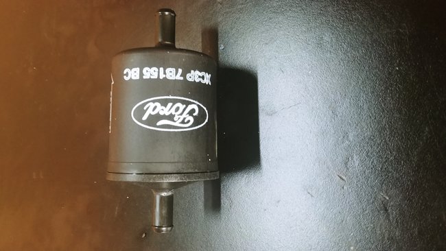

Well the part arrived and unfortunately they substituted it with the replacement part #. It should work, but I'm a little hesitant because there were reviews on Amazon regarding the plastic on the filter cracking open and losing power steering.
Also, how do you he the clamps off of this filter? They are not clamps with a screw, nor one where you can use pliers to press and loosen. They just have this little bow tie raised point on them and that's it.
  • 110,240 POSTS
Welcome back:
The one you got should be fine. However, I need a picture of the clamps you are referring to. If I recall, when Ford made these, it came with the entire low pressure hose (return line) because the filters were permanently crimped onto the filter. To replace the filter required the hose be cut and then the use of a band or worm clamps were used to reinstall the new filter.
I'm sorry to be a pain, but if you could upload a picture of the clamps being used now (the original filter) and a picture of the new filter you got, it would be helpful.
CANNON1349
  • 861 POSTS
Sure. The updated part number is now a plastic filter marketed as a transmission filter. I assume the flow goes towards the power steering cooler?
Also you're probably right about the permanent crimping. But, I was able to get one end off when I changed the pump just to flush it out. You think I should just cut it? I'm a little nervous about losing hose. Maybe I could use diagonal cutters or something or I could get lucky with wrenching out the other side like I did previously.
CANNON1349
  • 861 POSTS
So I decided to go ahead and attempt replacing it, and I was able to uncrimp the hoses with diagonal pliers and re-crimp them on to the new filter. So far no leaks and looks good. New power steering pump still makes a little noise but nothing crazy. I did bleed the system with the wheels in the air.
  • 110,240 POSTS
Welcome back:
Looking at the pictures, I'm impressed you were able to reuse those clamps. Normally, they are a one time use. LOL Regardless, keep an eye on them for leaks, and let me know if things change. At this point, you should be good to go.
