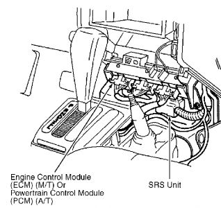

OTHELL TUCKER
We changed the fuel sending unit in the gas tank. This fixed the Engine Service Light and fuel gage problem. Then we got a new problem. The car stops running . Sometimes at idle and other timeS while driving. After a few seconds it starts back and goes again. We have three codes. P-0601 (cant remember the other ones), but have to do with the throttle body. Can you help? If I have to change the computer can I replace it with a used one and avoid going to the Dealer to flash it? I can't afford to change parts that dosn't fix it. The VIN # is 4S2CK58W0Y4339850
Dec 28, 2018 at 1:37 AM (Merged)
MERLIN2021
  • 17,250 POSTS
It would be good to have ALL the codes, but 600 series codes are computer problem codes, P0601 is a memory check sum error. A new PCM needs to be flashed, it can be done on or off the truck.
https://images.2carpros.com/forum/automotive_pictures/62217_rodeo_1.jpg
OTHELL TUCKER
I would like your idea of what may be wrong with the Rodeo? Can I use a used PCM and is there a way to be sure that's what I need ?
MERLIN2021
  • 17,250 POSTS
If your PCM is bad get an OBDII scan tool, these work on all cars sold in the USA since 96' scan the codes and post all found, Flashing requires more expensive scantools, about 1200.00 to 5000.00 and more! A junkyard PCM can work, but it needs to be from same make and model, auto trans 6 cylinder and so forth...
