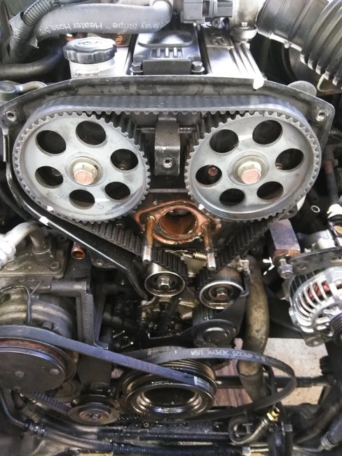

The small gear on the crankshaft doesn't want to budge. I can't find a puller that will fit this thing. It's so small and there is no room to get the hooks behind it with my regular gear puller. I'm trying to change the seal behind it. I'm assuming this is the front main seal? Do they make a special puller for this gear? Also I'd like to know instructions on changing the two camshaft seals. The timing belt look good it's had to have been changed. Also the water pump housing is still shiny like it's fairly new as well. Thanks. Jack

What you need to get is a steering wheel puller. They are small enough to fit behind the gear and between the obstructions. Most parts stores will lend or rent one to you.

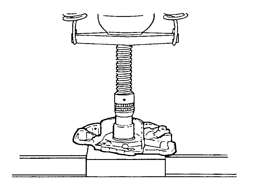

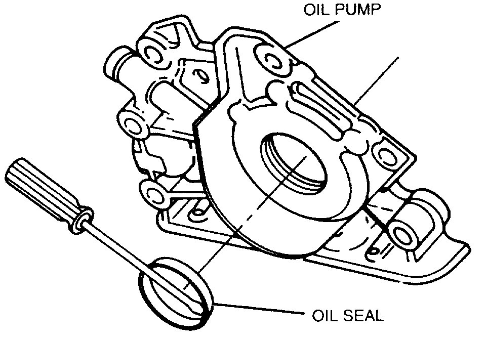

8. Cut the oil seal lip with a razor knife.
Picture 1
9. Remove the oil seal with a screwdriver protected with a shop rag.

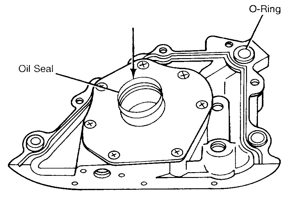

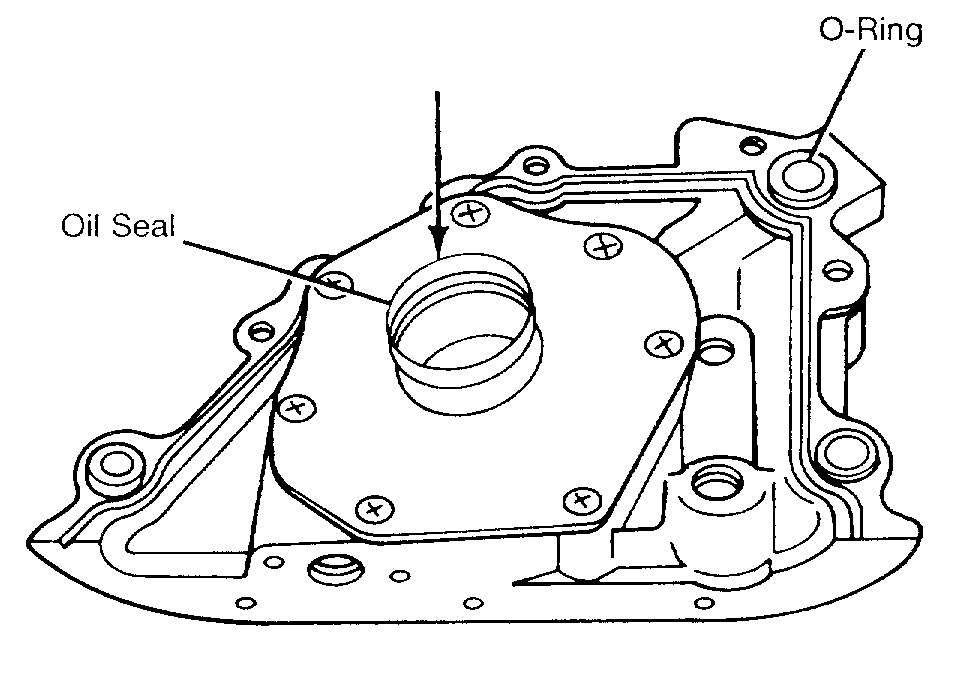

1. Apply a small amount of clean engine oil to the lip of a new oil seal.
Picture 2
2. Push the oil seal slightly in by hand.
NOTICE: The oil seal must be pressed in until it is flush with the edge of the oil pump body.
Picture 3
3. Install the oil seal into the oil pump body.

I'm not sure of the specific thread pitch. However, if yours bent, it sounds like they weren't parallel with where they screw into the crankshaft gear. Also, you can get a steering wheel puller that is a claw type. They are much thinner and will fit. The top of the puller, however, must not be larger than the diameter of the pulley. Most parts stores will have them. It is a standard item.
